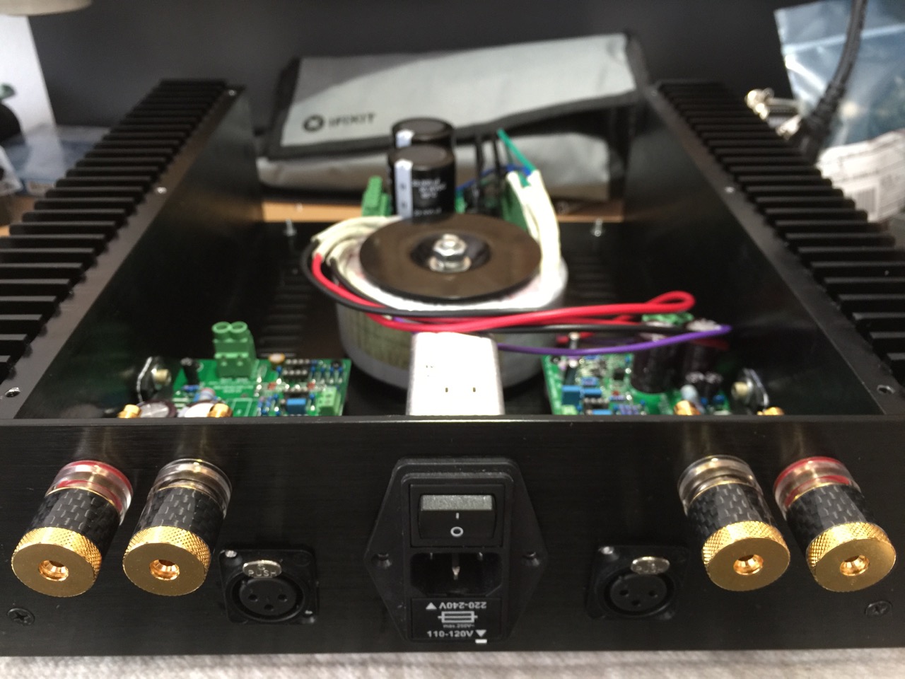

Hi 12B4A,
That looks very good, can I ask how you created the large cutout for the power socket? I have a similar case and would like to incorporate a fused socket.
Thanks, Ian
Thanks, Ian
I drilled many holes and used a fine blade coping saw to cut between the holes to make one large hole. I then used a high speed Dremel cutting bit (#196) to smooth out the sides. It wasn't a quick and elegant process at all. I'm pretty sure next time I'm going to see if I can get that kind of cutout properly cnc'ed.
Thanks, that's sort of how I was thinking of doing it but I was hoping you had a neat trick or tool for the job.🙂

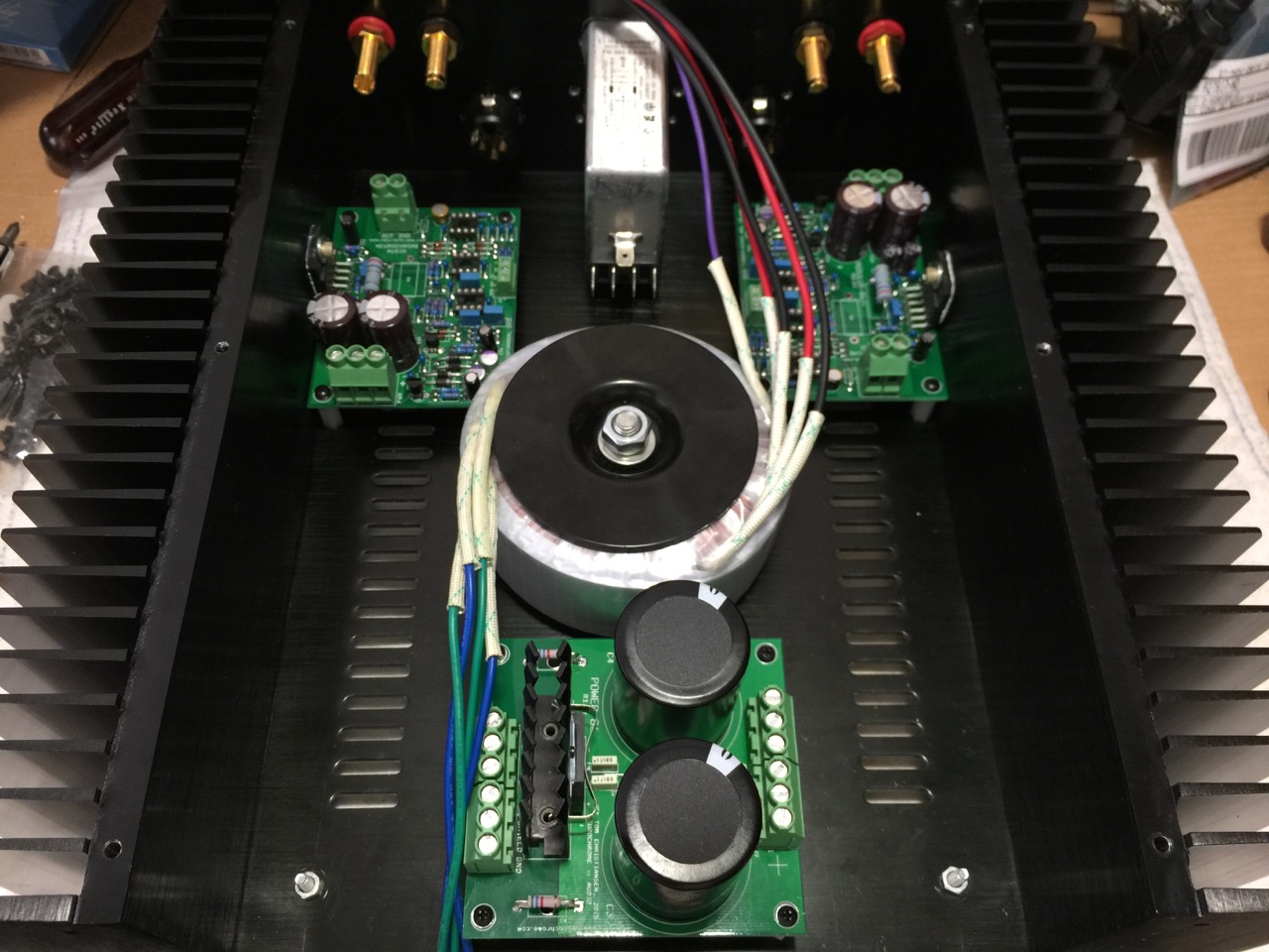

Reached a small milestone of sorts. All the metal work is done and everything fits together. There's still more to do electrically but it's a good day when the drill gets put away.
I suggest reversing the position of the xformer and rectifier board. First of all, you go from dirty to clean in a proper layout. Xformer is dirtiest. Perhaps even more important is that you want as short as possible distance between the reservoir caps and the amp pcb. Inductance is your fiend.
That's one approach. I usually drill a hole in each corner of the square outline and saw between them using a coping saw. I then use a file to flatten the sides and get the hole to its final dimension. Having access to a milling machine would be nice, but for the one hole per year that I need to make that way, the cut-n-file method works just fine.
For larger round holes, such as those for XLR connectors, I use a stepped drill. Works great, and unlike large HSS drills, there're no issues with the drill bit wandering creating a hexagonal hole.
Get a nibbling tool
Works great for thin sheet goods. For the 3 mm thick aluminum in the chassis I used, I doubt it'll work so well.
