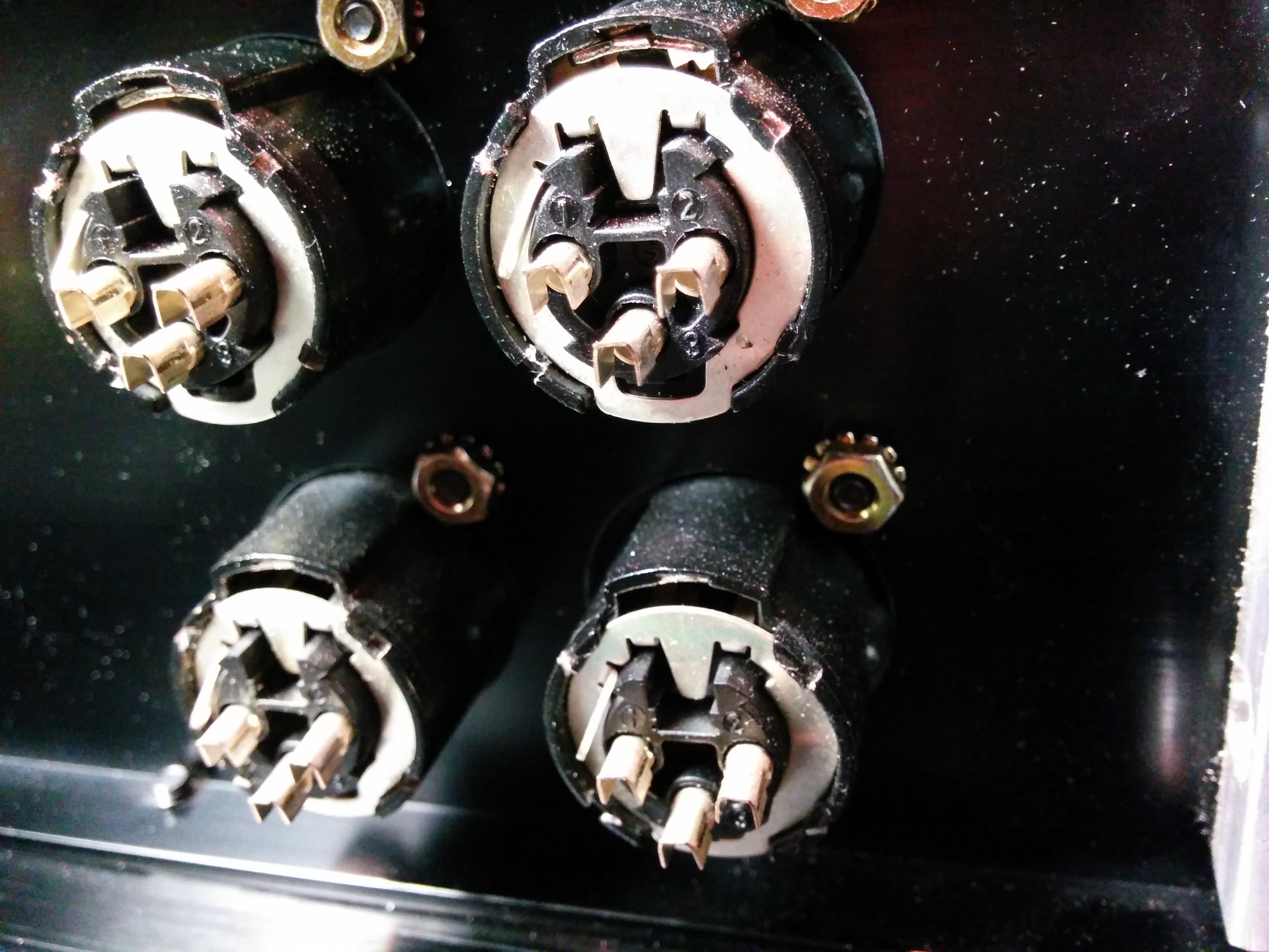

Does anyone know how these connectors on a Neutrik NC3FD-LX-BAG are intended to be soldered? There is an inner metal cup and an outer inverted u-shape metal part which looks like it's intended to be crimped. Am I supposed to strip the wire to the depth of both parts (about 8mm) or just to the depth of the inner cup? In other words, is the outer part intended to crimp the insulation, or to crimp the bare wire just to hold the it in place while its being soldered?

Instructions are on Neutrik website for EMC XLRs
This is apparently intended to be crimped, and there seems to be contact and a special tool needed.
The Neutrik XLR is the EMC line, and the full part is NC3FD-LX-HA-BAG. I tried to attach the pdf but the Forum will not allow it, so you need to go to the Neutrik US website and download it from there.
The Neutrik datasheet specifies the wiring as "solder contacts". The crimps seem too light to be the only means of connection. My guess is they are intended to temporarily hold the wire in place as it's being soldered.

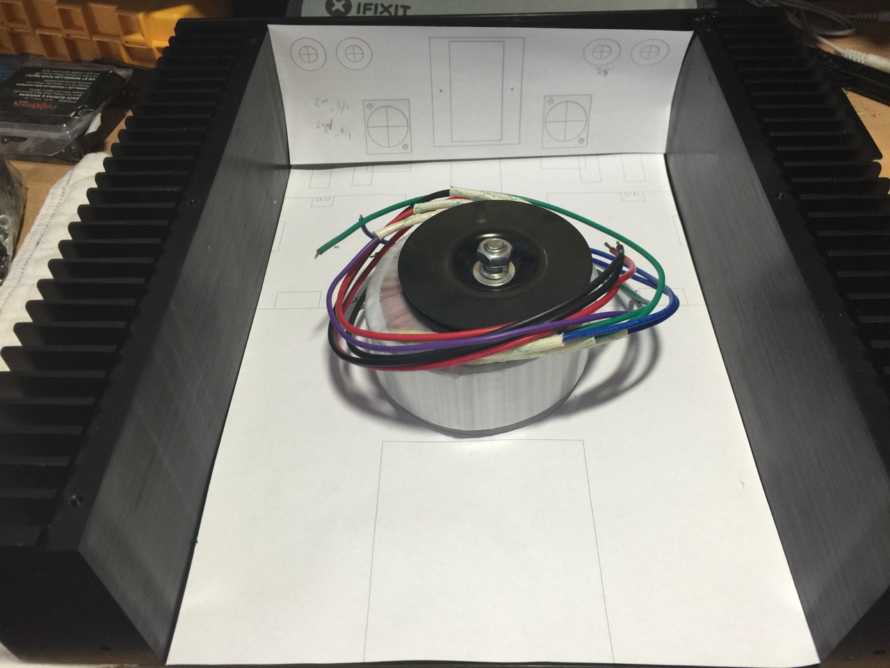

My build is starting to take shape but I would appreciate any constructive feedback before I start drilling. I went with the B3209A chassis from along. I had a different layout in mind before I had all the parts on hand but once they arrived I quickly discovered I'd have to move the PS board and xfmr.

Assemble the amplifier first and get it working properly.
Get the grounding sorted so that it plays with two input channels connected and no ground loops.
Once the bare amp is tested and playing properly, fold it up into the shape it will need to be in to fit the proposed chassis. test again that the new locations of the components have not interfered with the good performance.
Then buy a Chassis that fits around the final tested and working layout.
I've been studying Toms layout on page 89 of this thread, as I plan my build.
In looking at the pictures about 2 posts up from here (sorry OP, firgot yer name already) I see a couple things you may not have considered: 1 is that if you rotate the Power86 90 degrees you might be able to keep it on the center line, but I'm not even sure if that's important. The other thing I see is that in your other picture, with the trafo and power86 side-by-side, if you swap the two components, then the wire runs from the power86 to each mod86 will be closer to equal in length of wire, again I'm not sure if this is important. AndrewT helped me years ago by telling me to twist all my pairs of wires, I've found through trial and Andrew helping me to fix the error that having wires neat and tidy with zip-ties and all is in fact important, although I bet Tom's circuit is more resilient anyway.
These are some good comments. That would work rotating the power86 to keep the transformer mounted center-ish. My speculation there is that it would be beneficial to shorten the wire lengths between the power outlet to the xfmr and then to the P86 board while also keeping the rectification further away from the signal section.
I'm not sure what you mean with the side-by-side swapping suggestion since it seems that would just lengthen one end while equally shortening the other.
Yes, you're right, it's all a trade off.
What I meant is that on the mod86 board, if I'm seeing it right, the wire run from power86 would be an inch or so to the left board. However on the right channel the V+\- is on the other end of the amp board, so that wire run will be at least a few inches longer. Please don't think I know what I'm talking about, but I'm just saying that if the power 86 board is in front of the right side, then the wire run will be a few inches toward the back to the far side of that board, and also a few inches across to the left channel which has it's v+\- on the closer to the front of the amp. It just makes sense to me, given the option to have those power leads more similar in length, but I have absolutely no science in my brain to show if this would be beneficial. .....Sorry, I don't think I'm helping

I forgot to say, your idea above sounds smart to me. Then again I think that a lot of this doesn't really matter. Tom put so much hum-rejection and other things into the design of the board that I probably won't notice much any sonic differences in my choice of layout, long as I follow common sense.
I hope you'll post more pictures as you make progress. 🙂
Brain fart. I see what you were saying about the V+/- wire lengths. Good catch.
