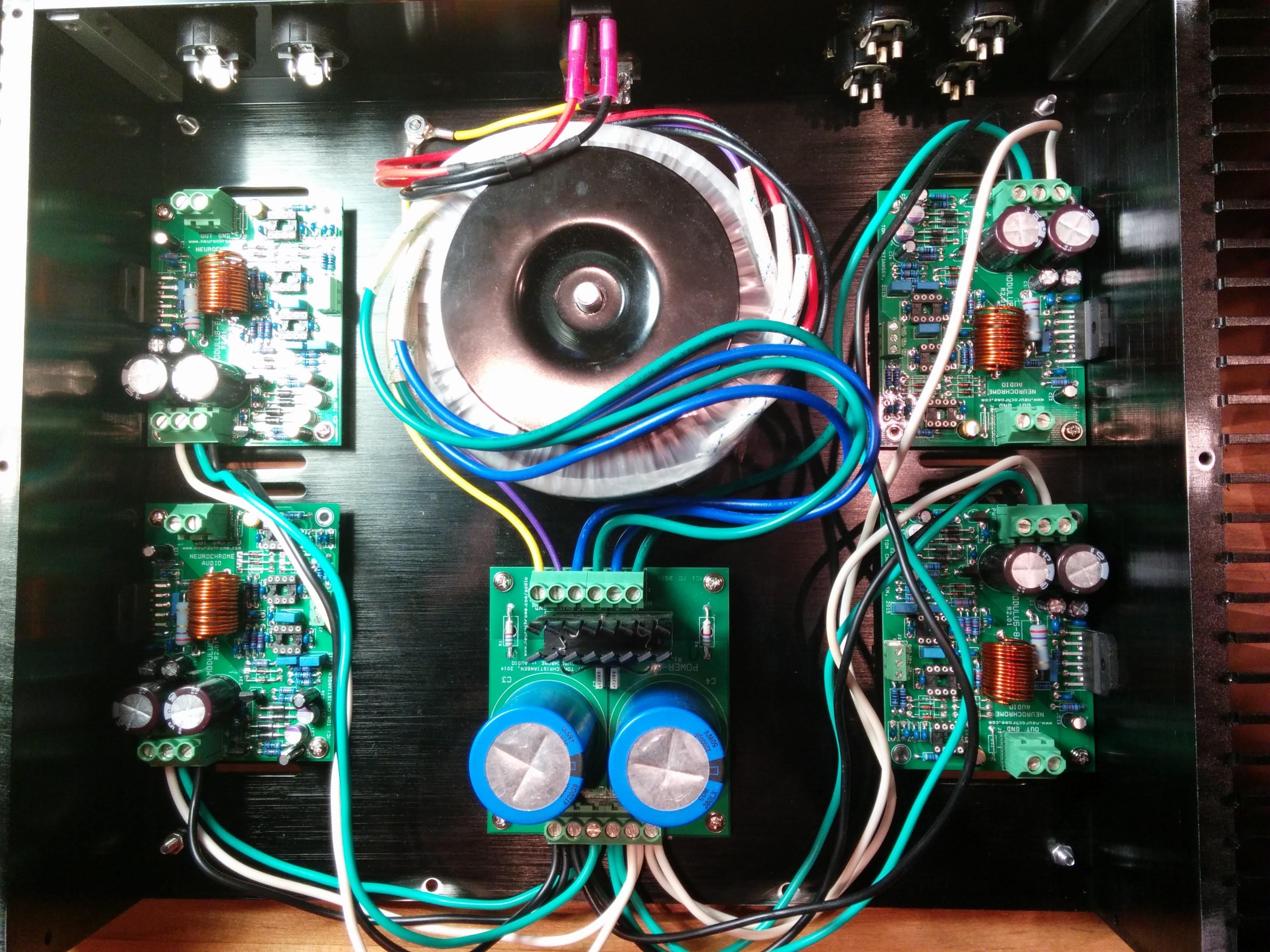

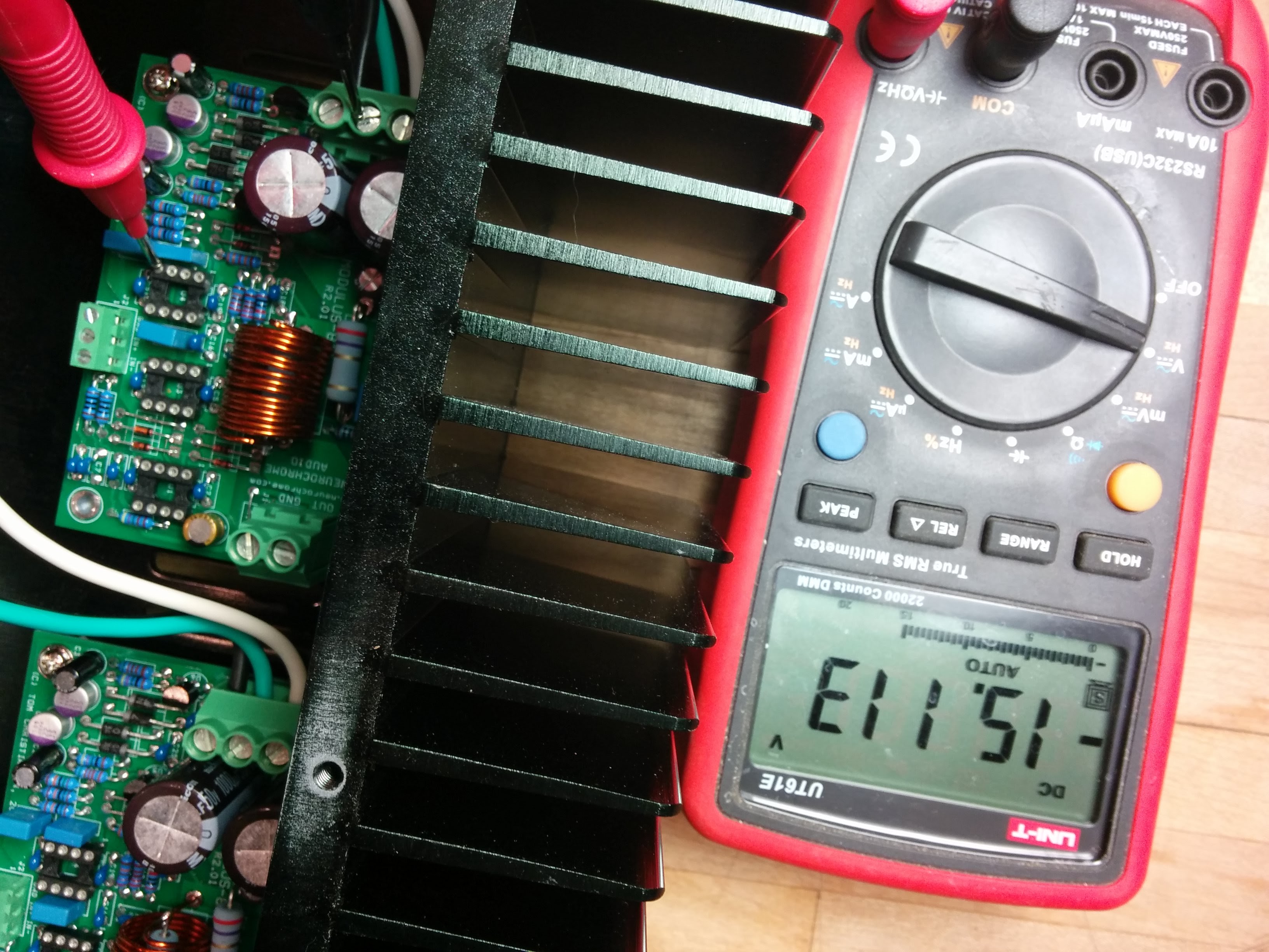

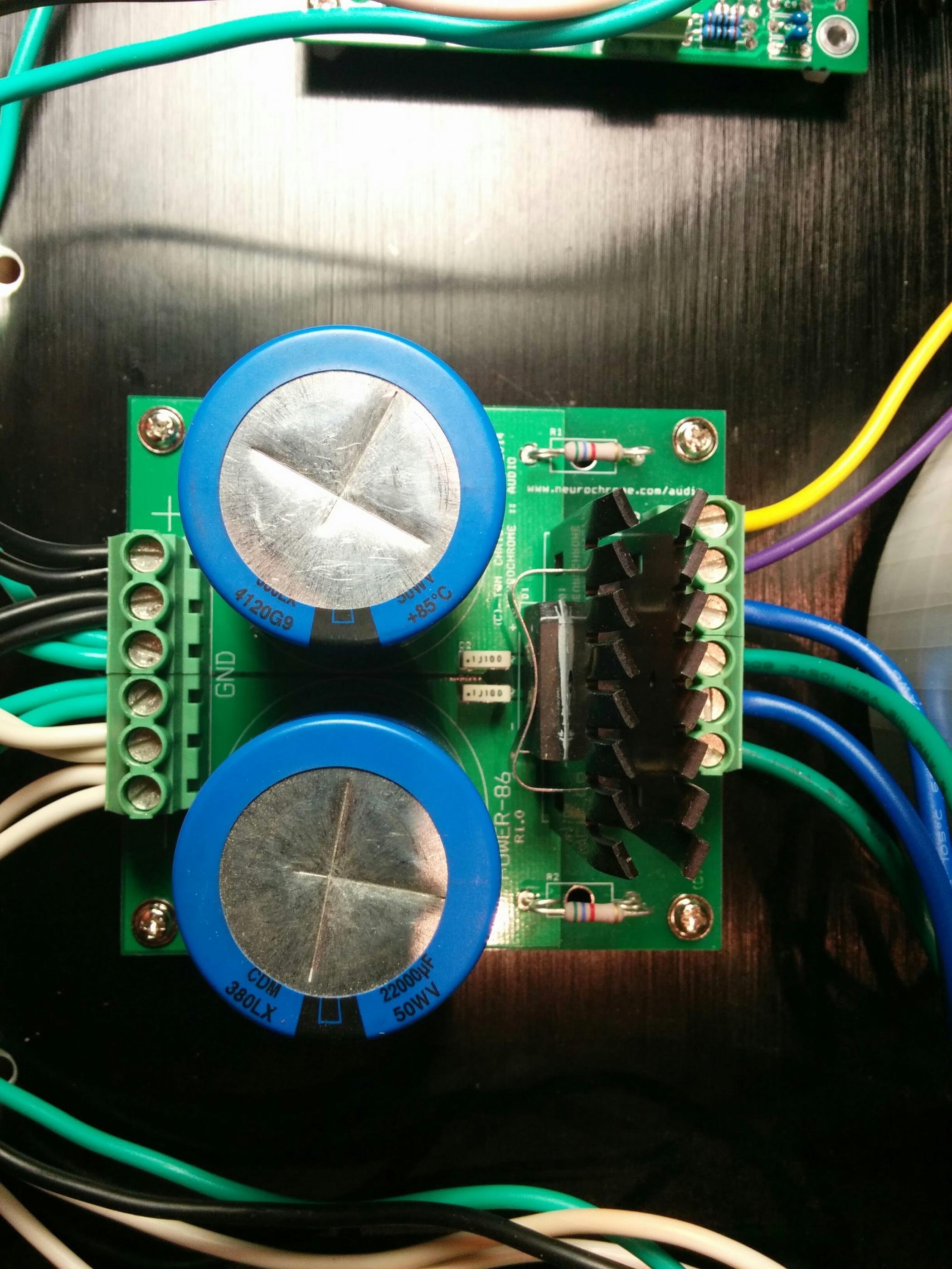

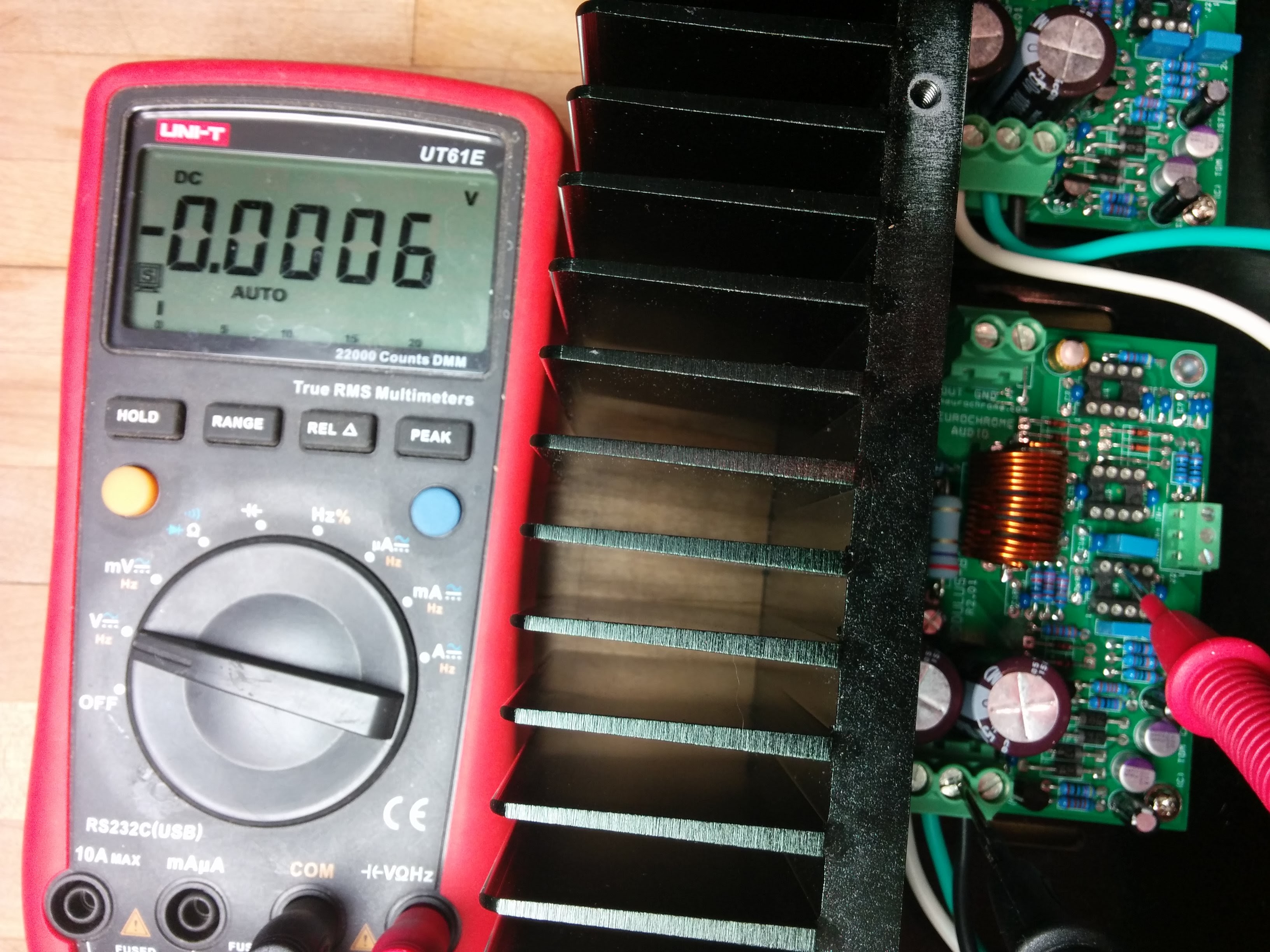

Hi everbody,
I have just performed the final check as instructed in the design doc and have a bunch of questions. This is my first amp build and am new to all this.
I am building a 4 channel amp. My transformer is an AS-3224. Here are my voltage measurements for number of channels connected:
0 +-35 V
1 +-32 V
2 +-28 V
3 +-22 V
4 +-15 V
I measured the voltage on pins 4 and 7 of U4 with empty U1, U3, and U4 sockets. The first time, with only 1 channel connected, I got -15 V on pin 4 and +15 on pin 7 (I don't believe I was dreaming). Testing the second channel I got +15 V on pin 4 and 0 V on pin 7. I re-tested the first channel again, and this time got 0 V on pin 7. I've tested all channels now with the same results, individually and with 2 and 4 channels connected.
I didn't expect the voltage to drop below +-20 V with 4 channels. Must I change R9, R20, and R22? Can I damage U5 and U6 by not making these changes? Neither are running hot.
What does 0 V on pin 7 indicate? I've inspected the boards and can't find any sign of a short. With 4 channels connected I get a dim glow on a 25 W bulb.
Is this how I'm supposed to connect 4 channels to a Power-86? Is +-15 V enough for my LXminis?
Photos attached.

The transformer is not big enough for 4 channels,. The power board is really intended for 2 channels also. I am not a "plans" owner but there must be on board regulators for the IC chips, the negative regulator is probably dropping out on low voltage supply.
Try with just 2 channels connected.
You will need a further transformer or alternatively a 600VA transformer plus another power board

I see now where you're measuring. I'm not sure what the reading is supposed to be there, but I think that's where the LME or THAT chip plugs in, and I bet voltage there is supposed to be low. (I think it was around that on Toms THAT I built, there's a voltage regulator or something in front of it). I don't think there's as much voltage drop as you think, just measuring in a different place.
I see your black and white wires, I assume V+ and V- . If you get a reading on one pin, but not the other (pin 7 zero,... Again I'm not sure what it's supposed to be, I assume -15) it possible that the black or white wire insulation on one side is preventing contact with the screws in the green terminal blocks?
I use the same transformer in my 4-channel build. That's plenty of power for a 4-channel amp intended for music reproduction.
0 +-35 V
1 +-32 V
2 +-28 V
3 +-22 V
4 +-15 V
That's ***WAY*** too much droop. We need to figure out what's going on there. Each board draws about 50 mA, so expect some droop from the ±35 V, but not 20 V of droop.
One thing I do notice is that the LM3886es aren't mounted on the heat sinks. They just lean against them. You have to drive a screw through the mounting hole in the IC package into the heat sink.
In an older revision of the Design Documentation there was a typo on the pin number. If you measure on the socket for the OPA2277, you need to measure on pin 4 and pin 8. If you measure on the sockets for the LME49710 or the THAT1200, you need to measure on pin 4 and 7. You should still get ±15 V.
If you toss me an email, I'll be happy to send you the latest revision of the design doc.
Don't make any changes. We need to find the root cause for why the amps are drawing enough current to cause the supply to droop.
Ah! Bulb tester is being used. Awesome. That probably prevented the fuse from popping.
Would you measure the voltage at the amplifier output connector?
Tom
