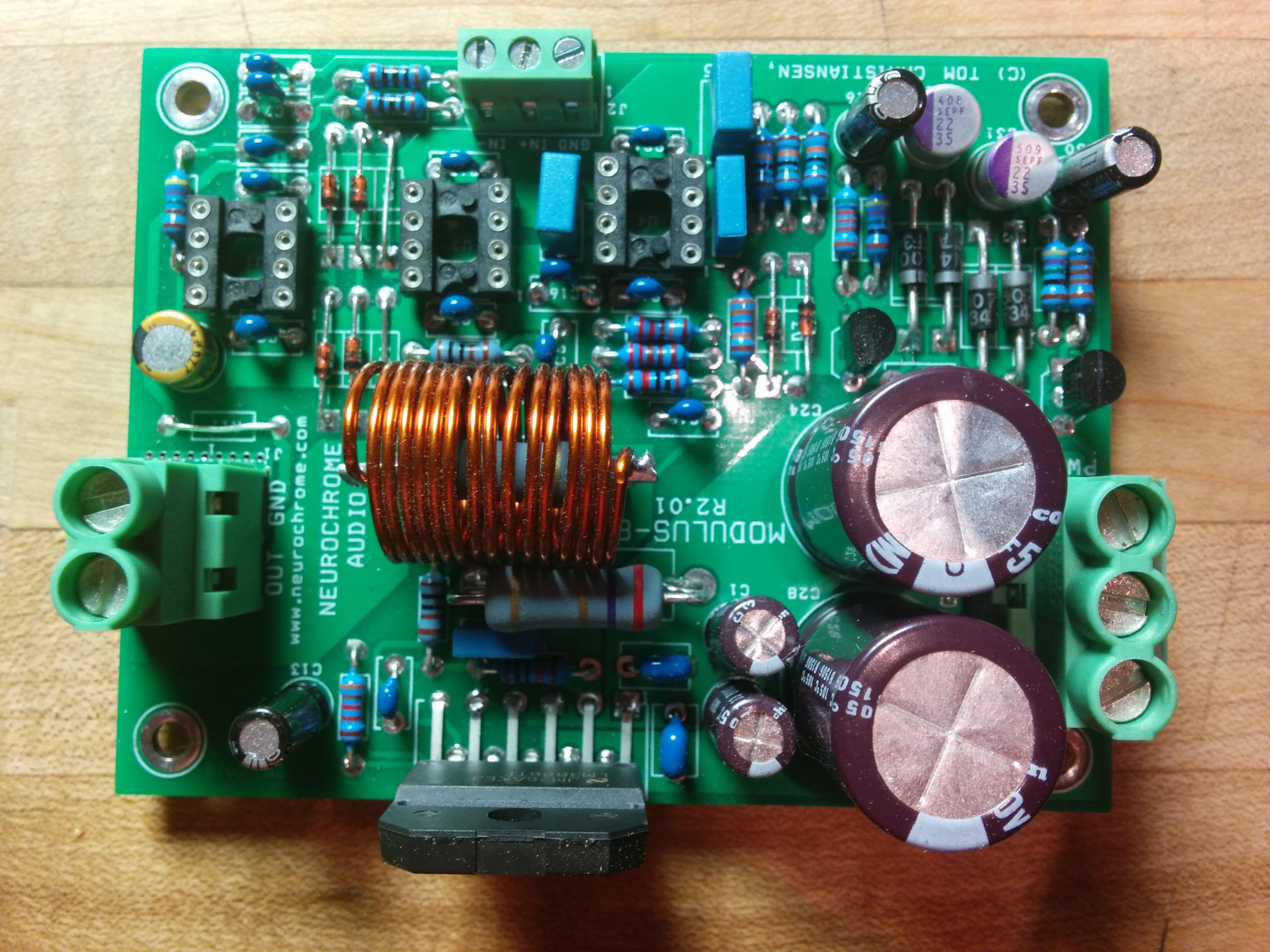

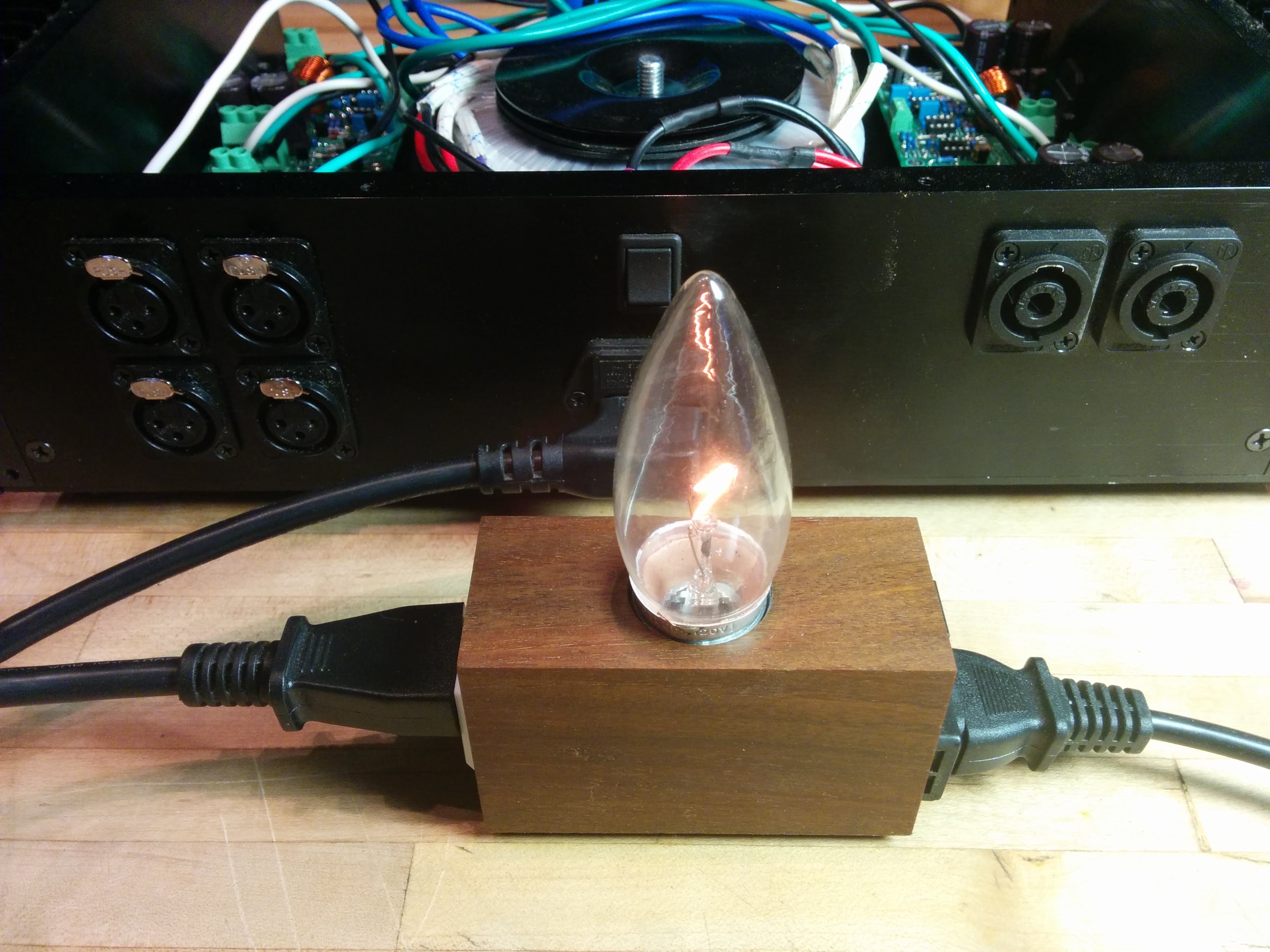

Attached, my take on a bulb tester and a closeup of a board.
That bulb filament is glowing more than dimly.
Why?
Whatever mistake I've made, I seem to have faithfuly repeated it 4 times.
What's the watt rating of the bulb in your tester? It could be too low for the combined idle current draw of the circuits. If so, the glow would be normal.

I started with a 150 W and moved down to 25 W. No glow at 60 W.
A dim glow from a 25W bulb implies just a few watts drawn, so you're probably OK there.

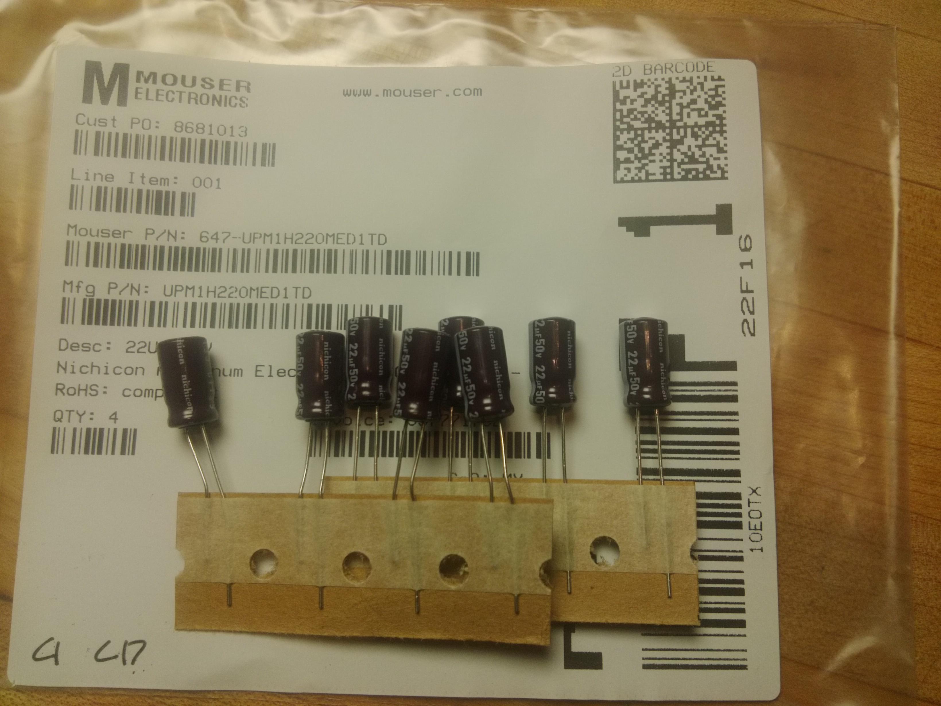

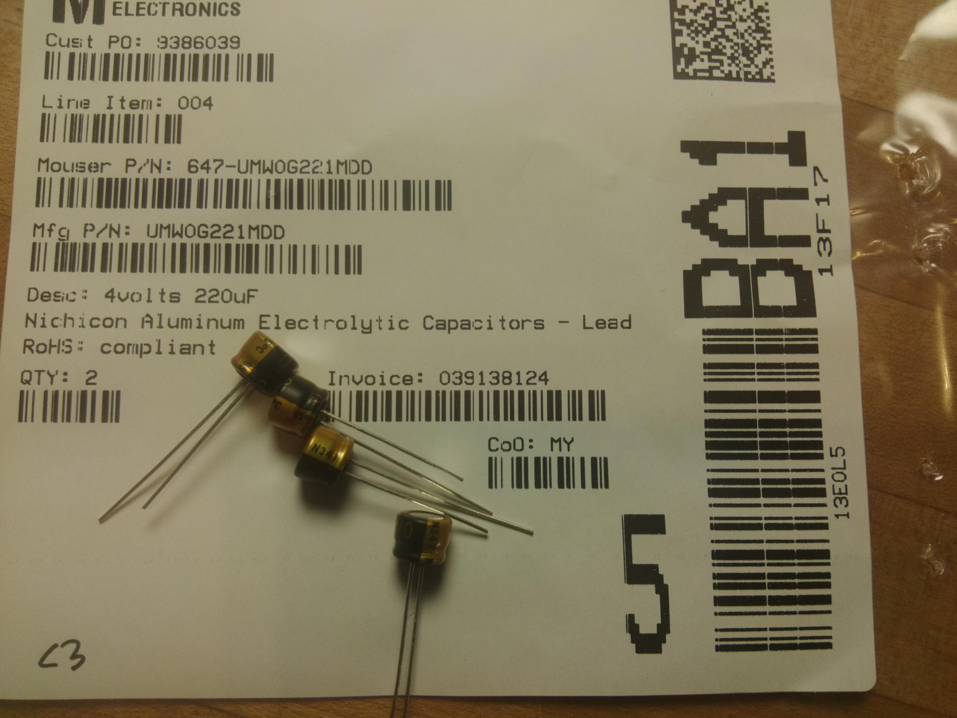

Comparing my boards to the photo at the top of the design doc, all caps seem to be oriented properly, but Mouser has clearly sent me different parts for C1 and C17, and C3. I am trusting they are equivalent. Photos attached.

C31 and C27 is the same part in bill of materials, but the markings on the caps I received are slightly different. I have 4 with 408 SEPF 22 35 and 4 with 509 SEPF 22 35 (I made two orders at Mouser)

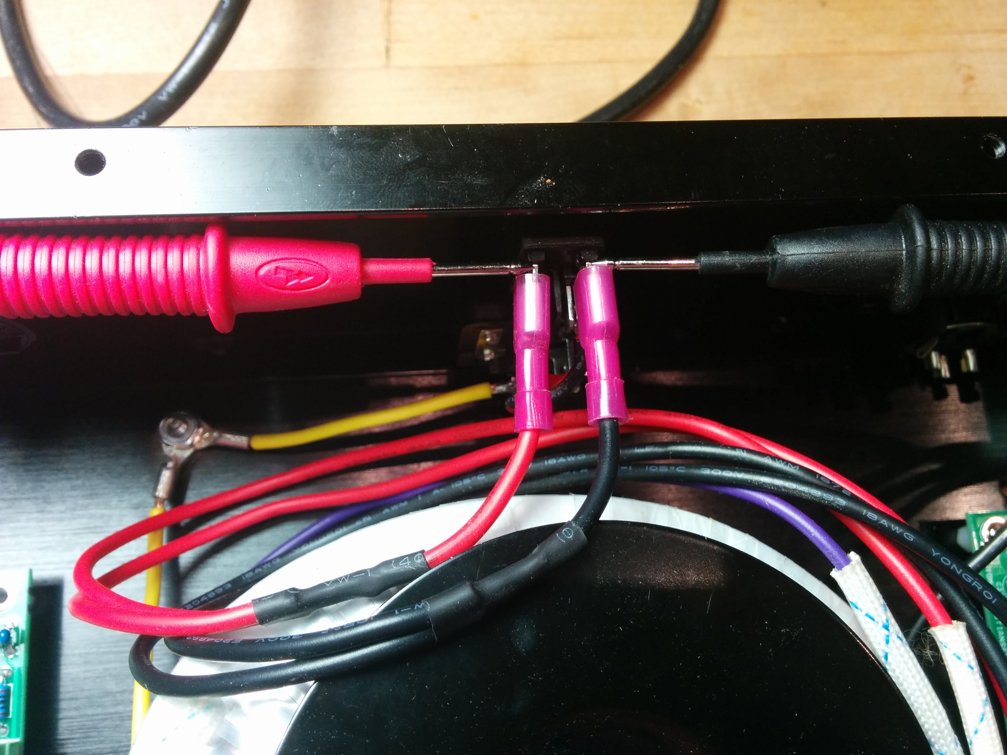

With a 150 W bulb get a full 120 V at the primary and +-33 V at each amp! Have I misunderstood how to use the bulb tester? Have I wired the tester incorrectly?

Do you mean like this (photo)? I get 80 V with a 25 W bulb and 112 V with a 60 W bulb.Look at the voltage at the transformer primary

Look's like there's no solder on the second pin from the right on LM3886 in the photo.

The Mains Bulb Tester is a way to avoid damaging equipment at first Power ON whenever a new or modified project needs to be first powered.
It allows one to find out if there are any wiring errors and eliminate them.
Michael and Dewa are asking the question to discover if you are asking the Mains Bulb Tester to do something it was NEVER intended to do !
The Mains Bulb Tester is NOT for normal operation.

The "Final Check" section of the design doc specifies two tests, one verifying the voltage has been properly regulated on the IC sockets, and the other testing the DC offset on the output of the amp. The doc recommends are current-limited power supply for each test.
My mistake was assuming I could measure the voltage on the input of the amp in the same context. It is clear to me, now that I think about it, that when the bulb is small it will significantly reduce the voltage supplied to the amp.
The LM3886 was soldered from underneath. The solder you see on the other pins was drawn through the holes. In retrospect, I would have off lifting the IC several millimetres above the board before soldering. Excess solder drawn through the holes of the back pins could bridge to an adjacent pin the way the way I did it. It also makes it more difficult to acurately mark the centre of the hole on the heatsink because the tops of the coils of the Thiele network get in the way. Too late for me now, I've clipped the pins.
It happens at times that Mouser runs out of parts or that a capacitor goes end-of-life. In those cases, I chose an equivalent or better part and update the project BOM with Mouser.
As long as they're both 22 uF, 35 V caps and fit in the board, life is good.
