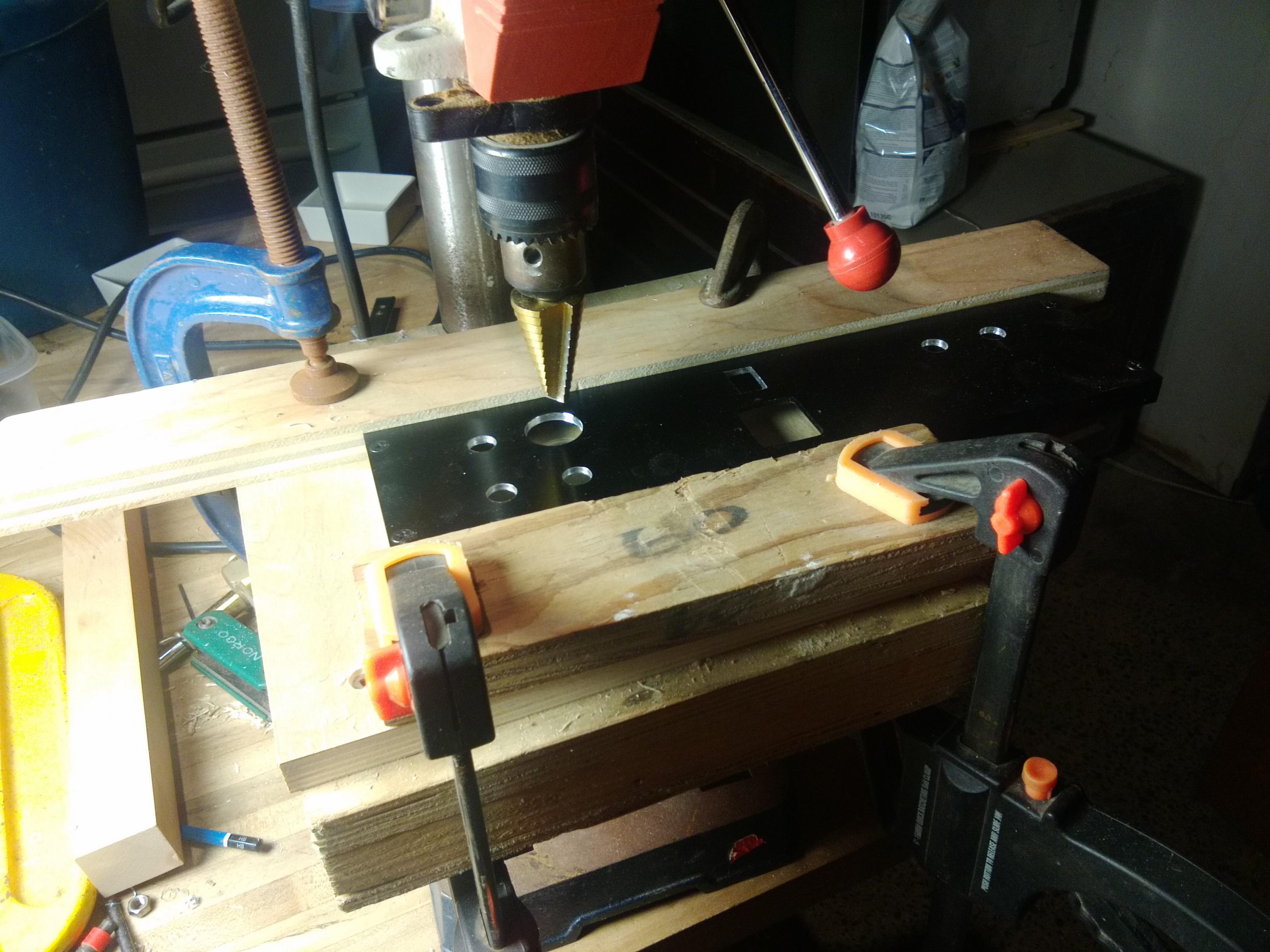

Having access to a milling machine would be nice, but for the one hole per year that I need to make that way, the cut-n-file method works just fine.
Along mentions in the ebay listing about custom cutting. I'll probably inquire for the next project if they have the right chassis. It might not be too much since they are already making the holes for their included IEC/fuse module.
I use both these methods............... I usually drill a hole in each corner of the square outline and saw between them using a coping saw. I then use a file to flatten the sides and get the hole to its final dimension...............
...........For larger round holes, such as those for XLR connectors, I use a stepped drill. Works great, and unlike large HSS drills, there're no issues with the drill bit wandering creating a hexagonal hole.
A selection of small and medium files and needles files helps a lot.

A hole buy enough for a coping saw blade in each corner and a coping saw which allows you to rotate the blade 90 degrees if the throat is not deep enough to reach the centre of the plate from the far edge works for me. Then, a sharp file does a quick job bringing the rough edge of to the line. I have a square file with an edge grinded smooth to work one side of a corner at a time.
Here is a photo of my drill press setup for the round holes.
Simple, clever . . . soon I will too 🙂 . . .I have a square file with an edge grinded smooth to work one side of a corner at a time.
A triangular file works too as long as you aren't particular about maintaining the radius in the corners.

If you want to do it the easy way, stick with round holes. I use a separate round fuse holder and round mains entry (Neutrik Powercon). The square switches, mains entry, etc are cute but do you really want to have to file all of these??? Ugh.

The $5 Radio Shack nibbler tool makes clean sharp corners for square or rectangular holes once you drill or punch main rounds out. Very handy. A much tougher pro version is available from Klein tools but for most thin aluminum panels my Radio Shack nibbler is great.
