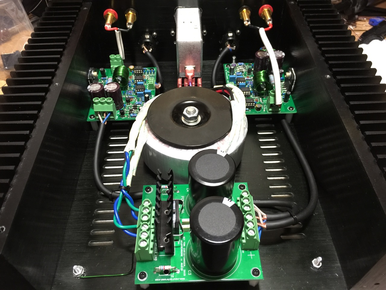

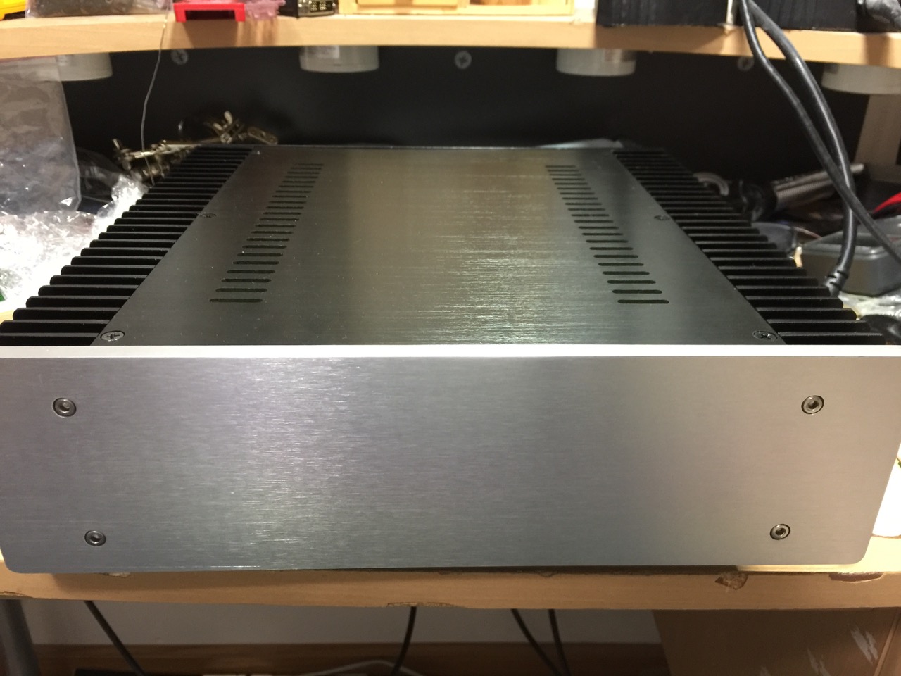

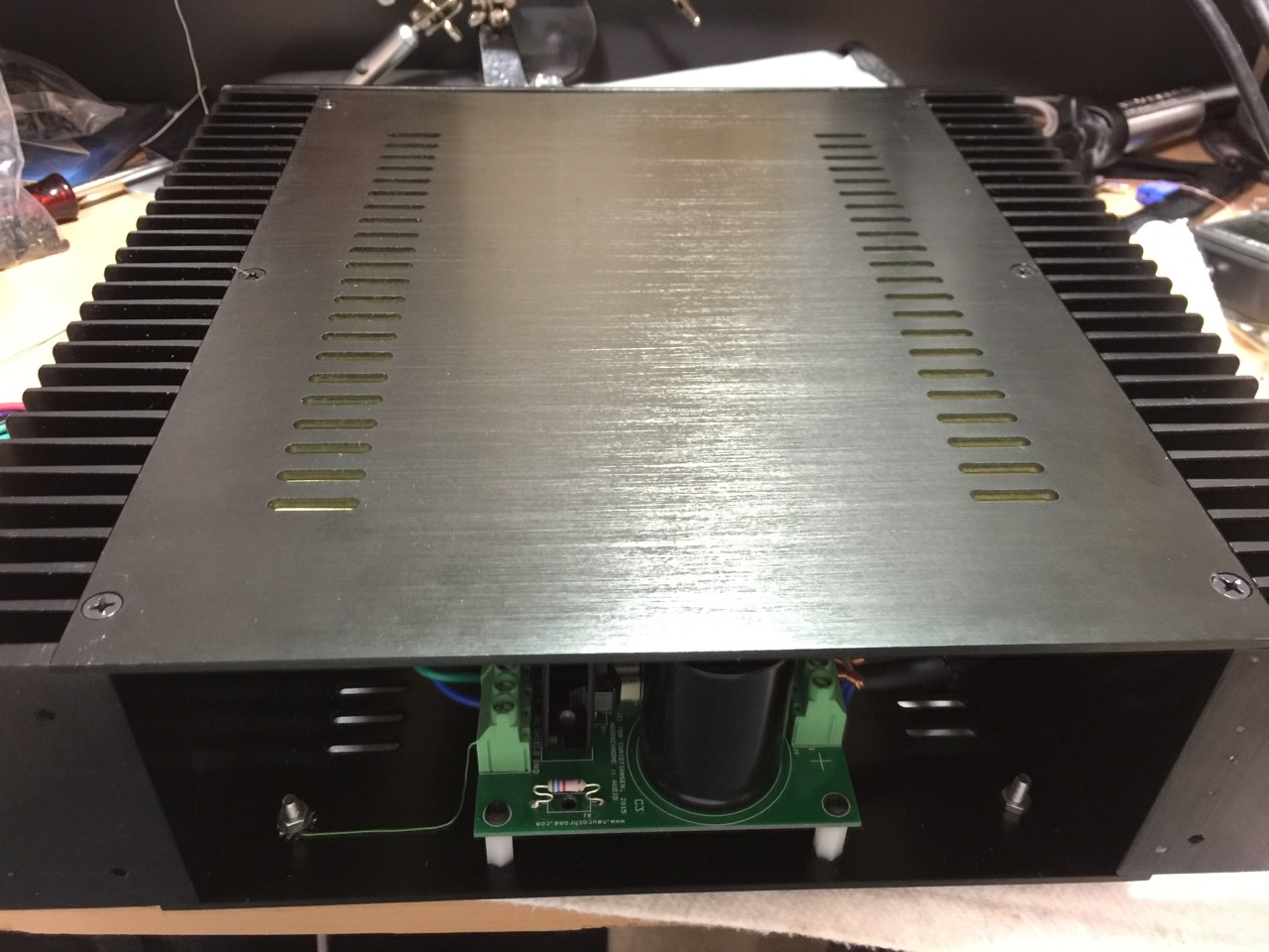

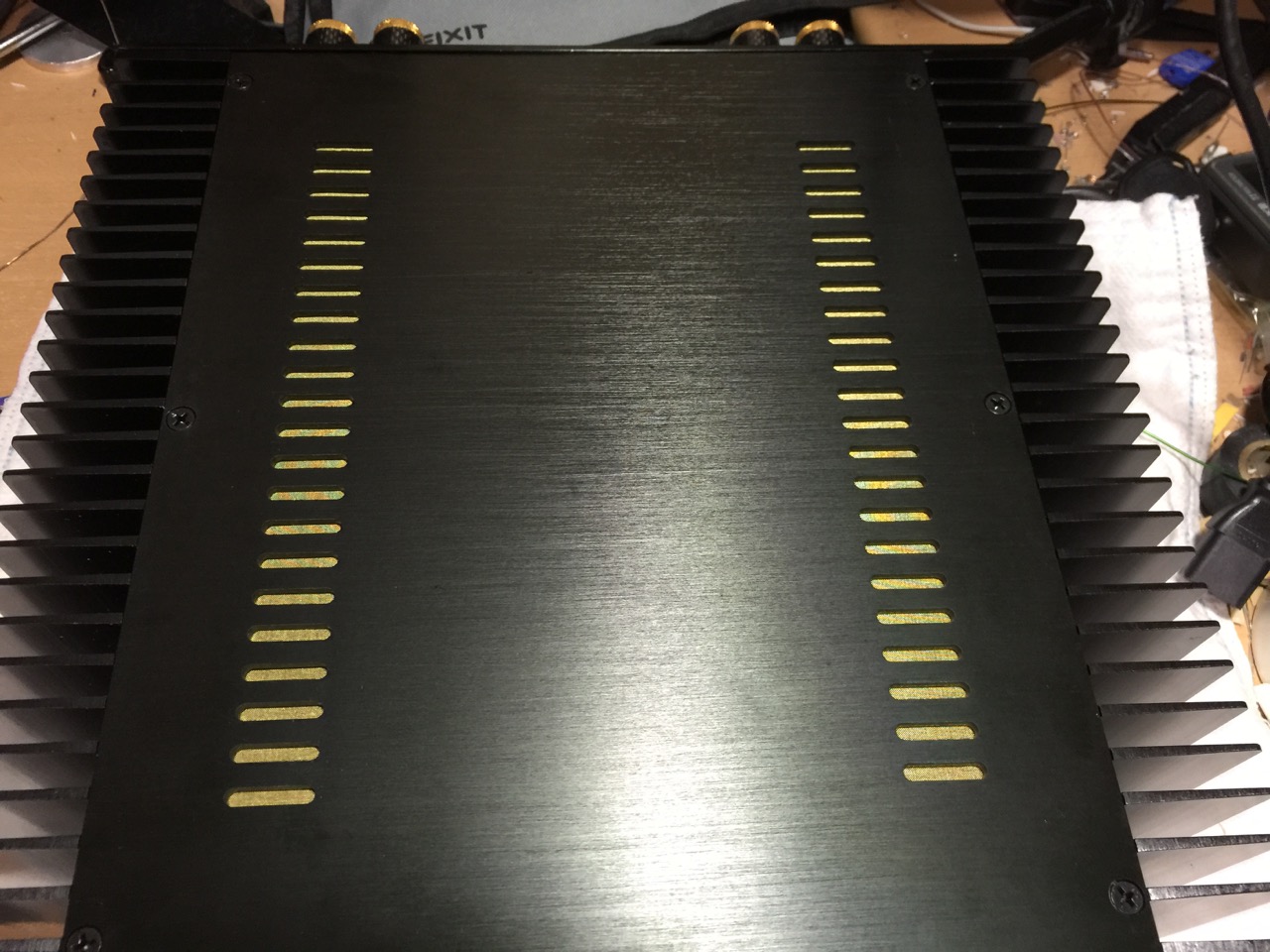

So here's the finished build. I'm happy the way it turned out.

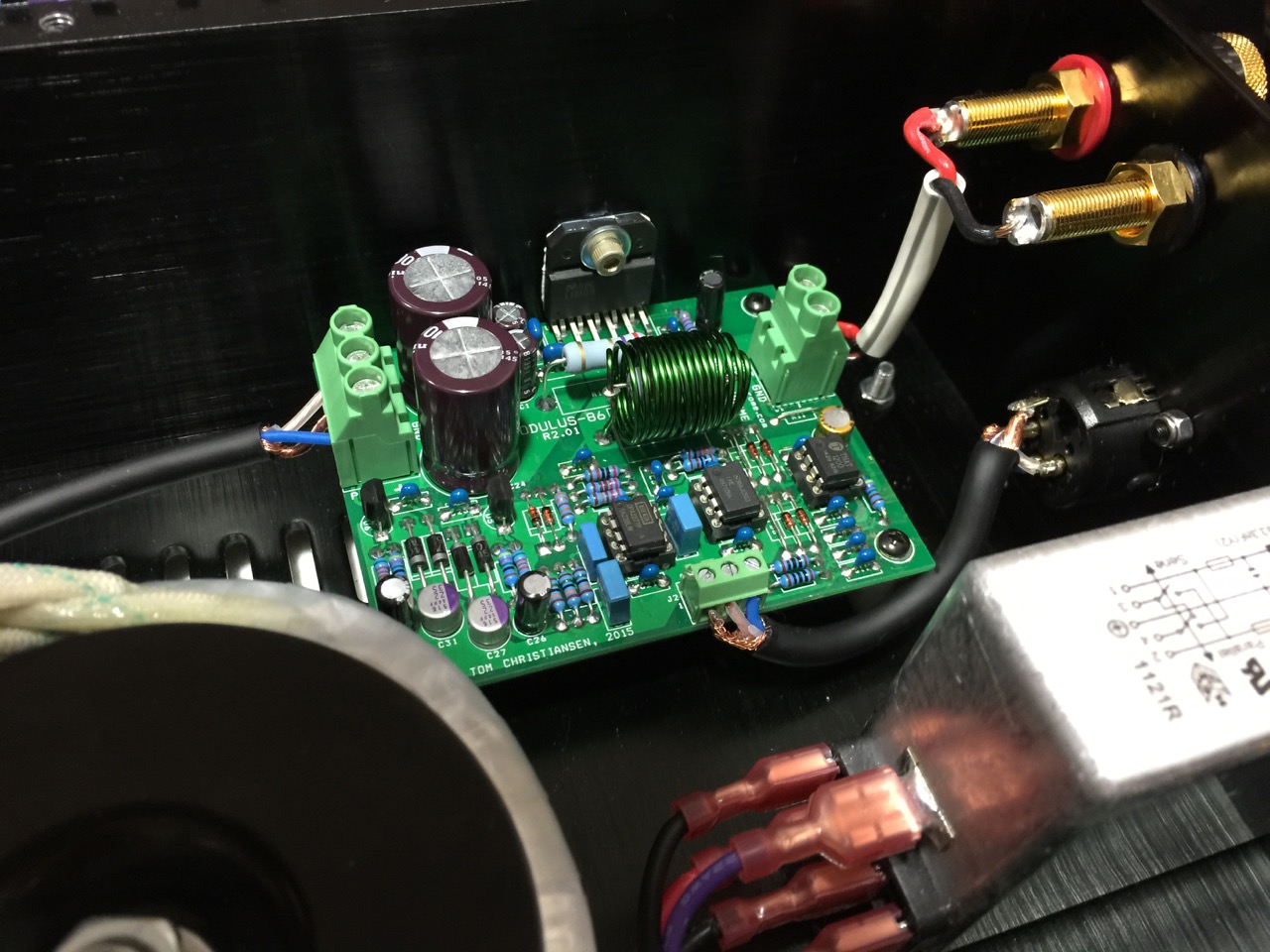

Great, clean work. I like how you chose green enameled wire instead of the ubiquitous red for your zobel.
Looks nice! I'd be happy too. I'm sure it sounds nice. What speakers are you driving with it?
I like it. Thanks for sharing. It always warms my heart to see my circuits completed successfully.

Well done 12B! It all looks very neat and well constructed. Are you going to give us your listening impressions? I've just finished redecorating our lounge so maybe it's time I concentrated on my build🙂

Great, clean work. I like how you chose green enameled wire instead of the ubiquitous red for your zobel.:cheers
I had to order a new spool so I figured I'd make the curtains match the carpet.
I've used them on some 89db bookshelves but right now they're on some Magneplanar SMMGs. My long term plan is to get some super efficient speakers which is why I was drawn to the Mod86's very low inherent noise measurement.

You made very thorough documentation to ensure that any semi-experienced builder can get it done. Just the provided links to already-filled parts list at Mouser takes out a good chunk of onerousness.
So far, it's just good clean amplification. I'd have to hook it up to some more sensitive speakers to get an idea of how clean.
Congrats again on your build. It shows that you put thought, detail, and care into executing your build. Glad you're enjoying good clean amplification 🙂
The clean circuit drew me to Mod86 as well, my tweets are Eminence ASD:1001, and IIRC they're 104dB.
I'm already looking ahead to my spring project, it might be Fostex FE206En (96dB). I would put them in Woden Design Vulcan. They look like a not "too" complicated to build (but will still challenge me), beautiful speaker, well reputed to sound great. -If you haven't seen Woden Design's Vulcan you should check it out.

Whoops, I meant Thiele network!

Nice work 12b.

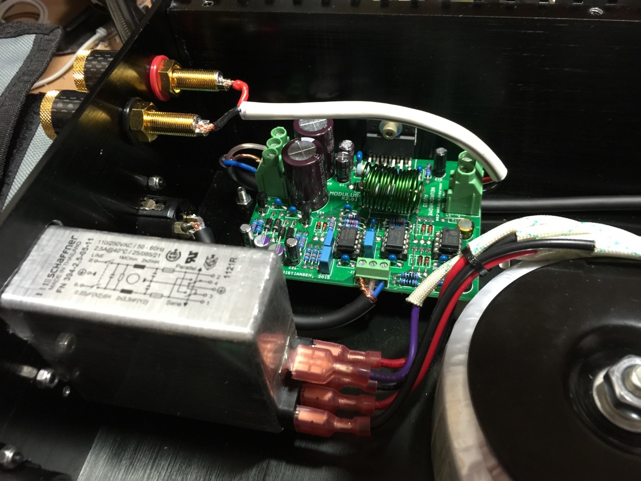

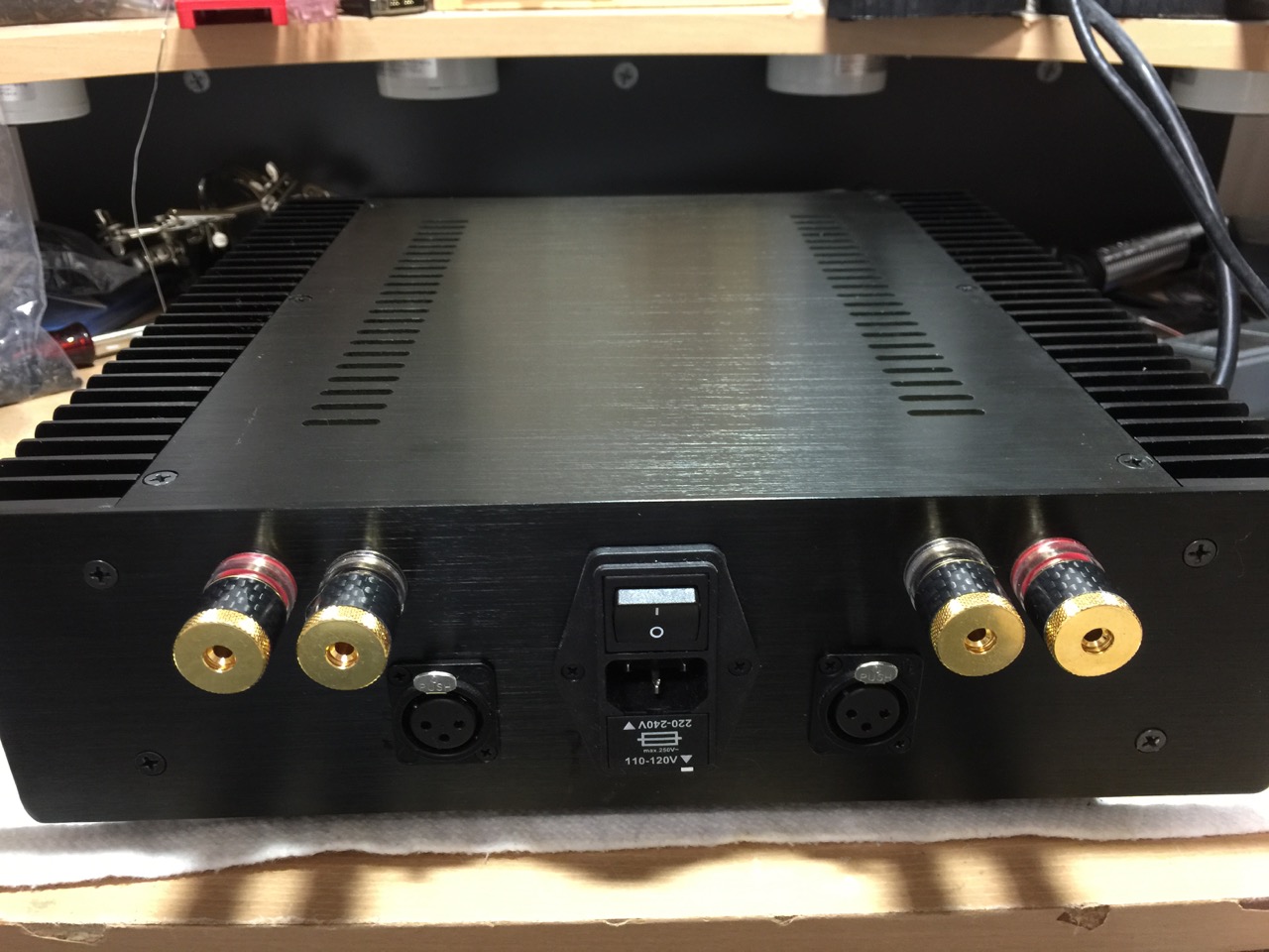

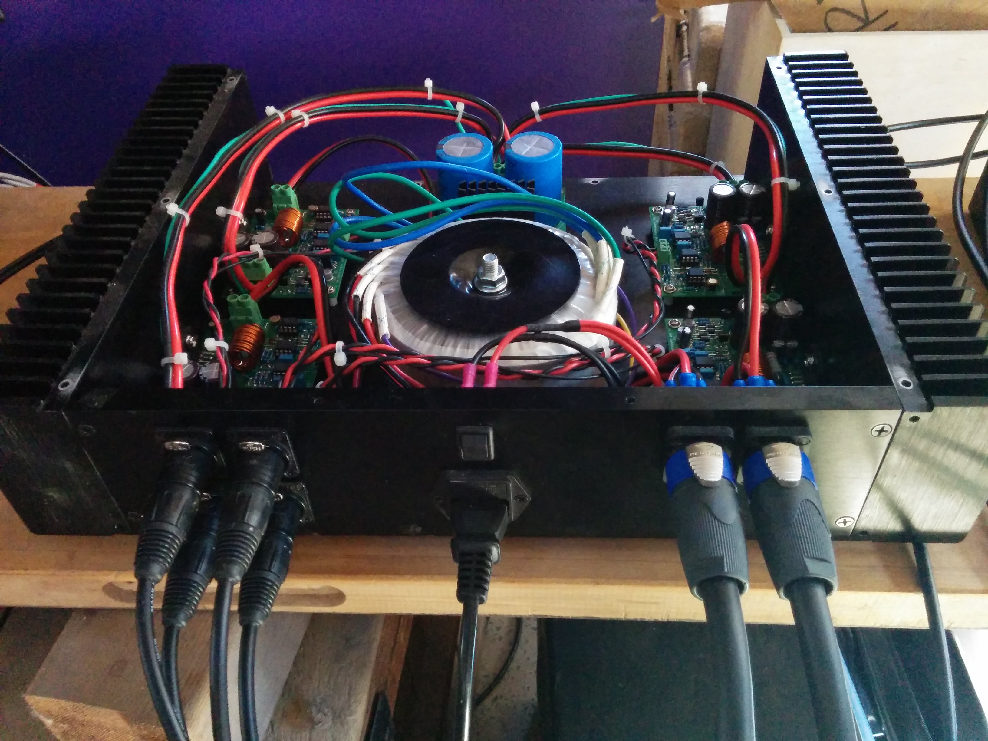

I like the symmetrical layout of your back panel. Not happy with how half my signal and speaker wire crosses over the transformer and power supply, I am considering drilling two more holes in my chassis to create an array of four on each side. The XLR and SpeakOn connectors both have D-shape cutouts and their positions could be swapped and the extra holes covered with dummy plates (Neutrik's DBA-BL). Not a lot of work to significantly clean thing up. Attached is a photo of the present situation.
Just one question, don't know if it's important. Have you used the same shielded cable to carry both the signal and power to the board? In Tom's Power86 design doc, he recommends 14 AWG wire to carry power to the Modulus86. The blue ang green secondary wiring on my Antek 3224 is also 14 AWG.
Equally striking are the matching black caps, cables, and ties. Gives the amp a "bad" look.I had to order a new spool so I figured I'd make the curtains match the carpet.
That's the same layout as I used. I measured the THD and residual hum on all channels. While there were slight differences between channels due to component tolerances, etc. all channels performed to spec. There were no obvious differences or patterns related to the board arrangement in the box that I could tell.
I'd go with as heavy wire as you can manage. When I built my 4xMOD86 amp, I couldn't source 14 AWG in the colours I needed, so I went with 16 AWG. My build will have a few mΩ higher supply impedance than had I used 14 AWG. Thanks to the stellar PSRR of the MOD86, the impact of this is negligible - within a gnat fart as Bill would say. 🙂

Nice work 12b.
Thanks! I lucked out on the color of caps. That's just what Mouser sent me from Tom's pre-set project list. Yes, I am using the same cable for power and signal. I'm not going to worry about less than a foot of 22 AWG wires in an amp that's probably never going to go over 5 watts a channel in my use case.
