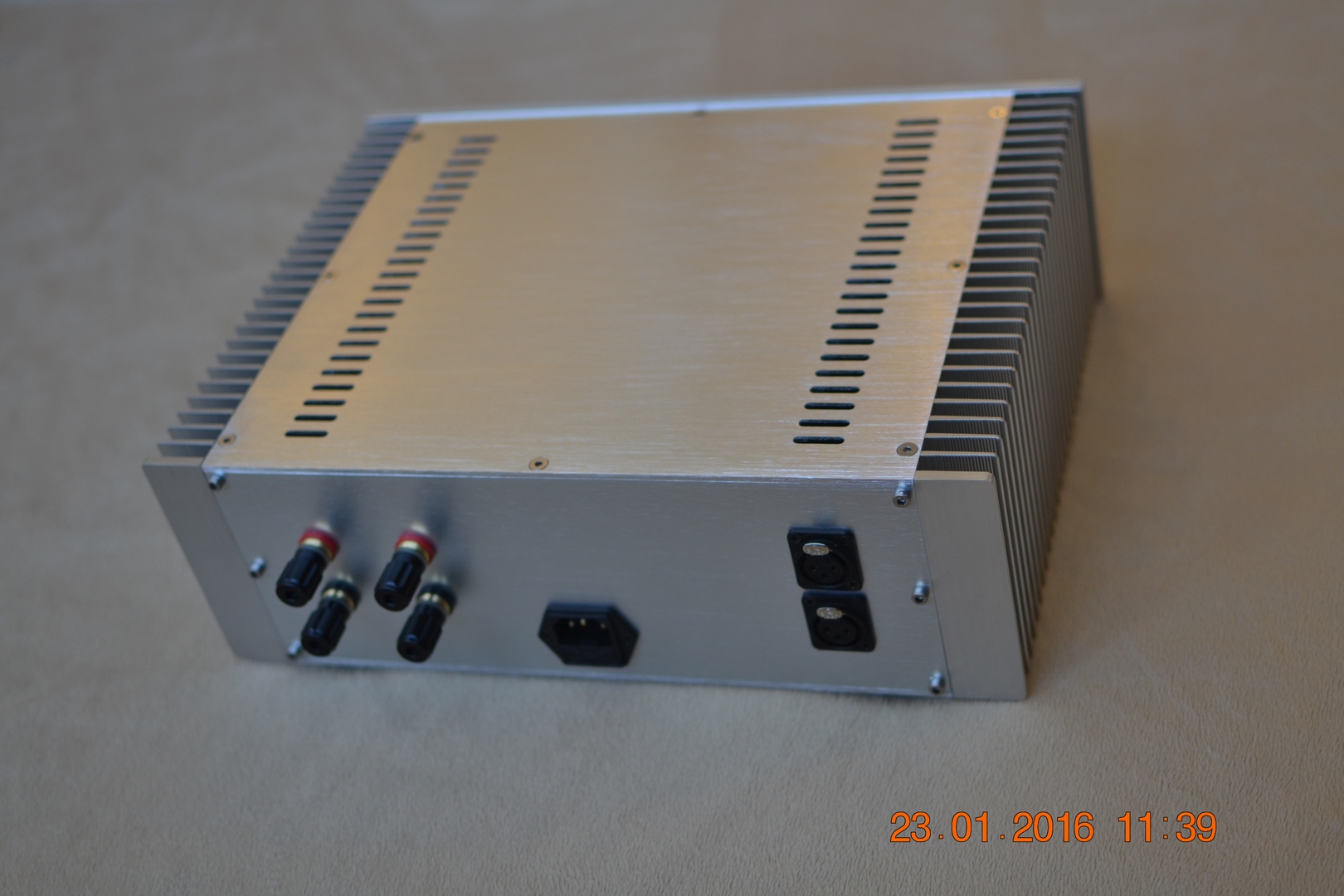

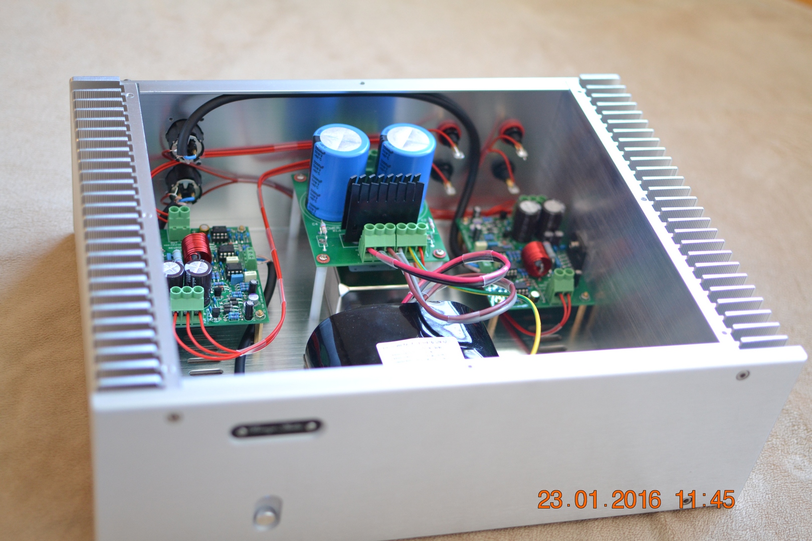

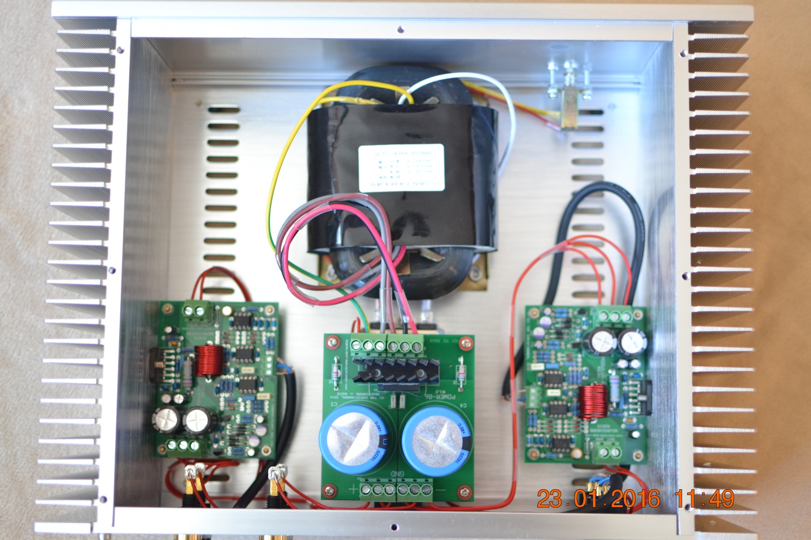

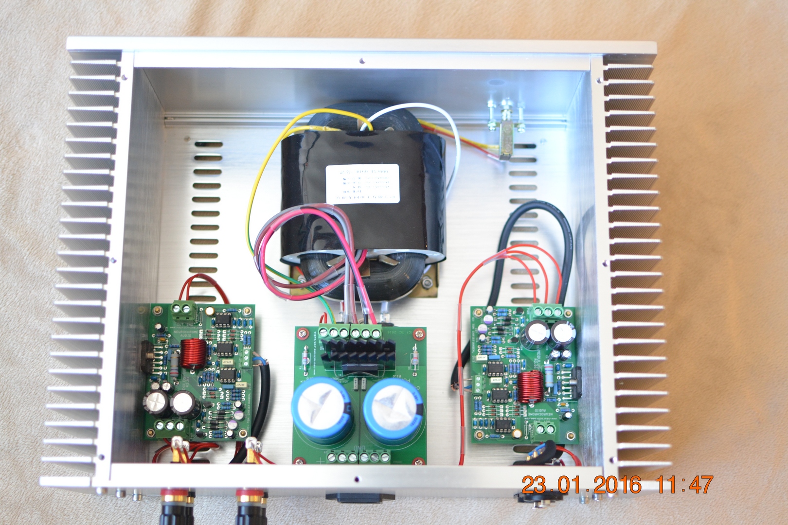

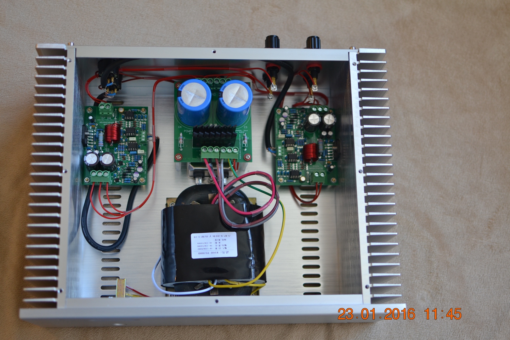

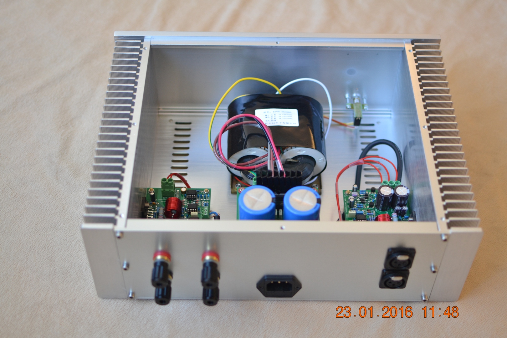

I've just finished my Mod-86 build and I am more than pleased to share it with all my friends here.
The case I used is BZ3612A. It has a perfect size. The heatsinks are cold to touch when music is played at my favorite level. I used THAT 1206 to avoid excessive overall gain and it works beautifully.
I added a two-stage EMI filter to clean AC and I ordered a 200W 22v x 2 R-core transformer from China. It was custom made for me for this amp.
I'd like to thank Tom for designing the great Modulus-86. The DC offset is 4mv at power on and it goes down to 0.0mv in less than 5 seconds. There are no speaker thumps at power on or shut down. The amp is dead silent, silky smooth and transparent. Listening to music puts a big smile on my face and it keeps reminding me of what an excellent job Tom has done for all of us!
Cheers to all🙂

R-core, very nice. I imagine that broke in to the triple digits after shipping for the transformer alone. I've seen those speaker posts before and would probably use them on my next build. Are those spades 1/4"?
Edit: BTW, I like how you mounted the PS board over the EMI filter(s) to save real estate.
Thanks zman01, I did not try disconnecting the EMI filter. I have a plasma TV that generates a lot of noises to my AC line. My experience with my previous amps and dacs tells me that when the TV is off, there won't be any need for additional EMI filtering. But once I turn on my TV, I will need to take extra measures to ensure the my sound doesn't degrade as much. The degradation is not perceivable by listening, but it shows up in all my measured test results
So I've made it a standard practice for me to add EMI filtering to all my dacs and amps. Mod-86 amp probably won't need additional EMI filtering, but I'd rather over-build where I can afford. It is only an extra $30 dollars for a good 2-stage filter.

Thanks 12B4A, the R-core and the case did cost a lot to ship from China. The R-core alone weighs about 2kg. But I am not particularly impressed with the one I received - to my surprise, it produces a very slight hum that is audible when I have my ear pressed again my case cover. Maybe there is DC in my AC line, but I don't know how to verify that. My other three 30 w R-cores that I use in my DAC are dead silent. Next time, I might try O-core.
The speaker posts are special light-mass pure copper posts that accept both banana plugs and spades. Their model number is EZ-301.
I bought them from Taobao:
EIZZ???????????EZ-301??????????????-??????
Yep, the EZ-301. That's the first site I've seen that has the actual mechanical drawings for it. Unfortunately, I can't see where it says how wide the connector blade is for inside the chassis. It seems likely it is a 1/4 inch.
Hi 12B4A, I measured it for you. The connector blade inside the chassis is 6.60 mm (wide) x 1 mm (thick). It does look like it will fit a 1/4 inch spade connector. I never thought about using a spade connector because I don't have any, but it is actually a pretty good idea to use spade to avoid soldering. The speaker posts are coated with gold, so it should work very well with a gold coated copper spade or with good crimping.
What spade connector do you have in mind? I might use such a spade in future🙂
As long as the spade doesn't just scrape off the gold. Gold is known for being nearly impossible to get to stick to anything. Probably because it doesn't have space in the valence band for more electrons.
I'd just solder to the connectors. That would make one connection. With the spades, you'd have two connections (wire - spade - connector).
