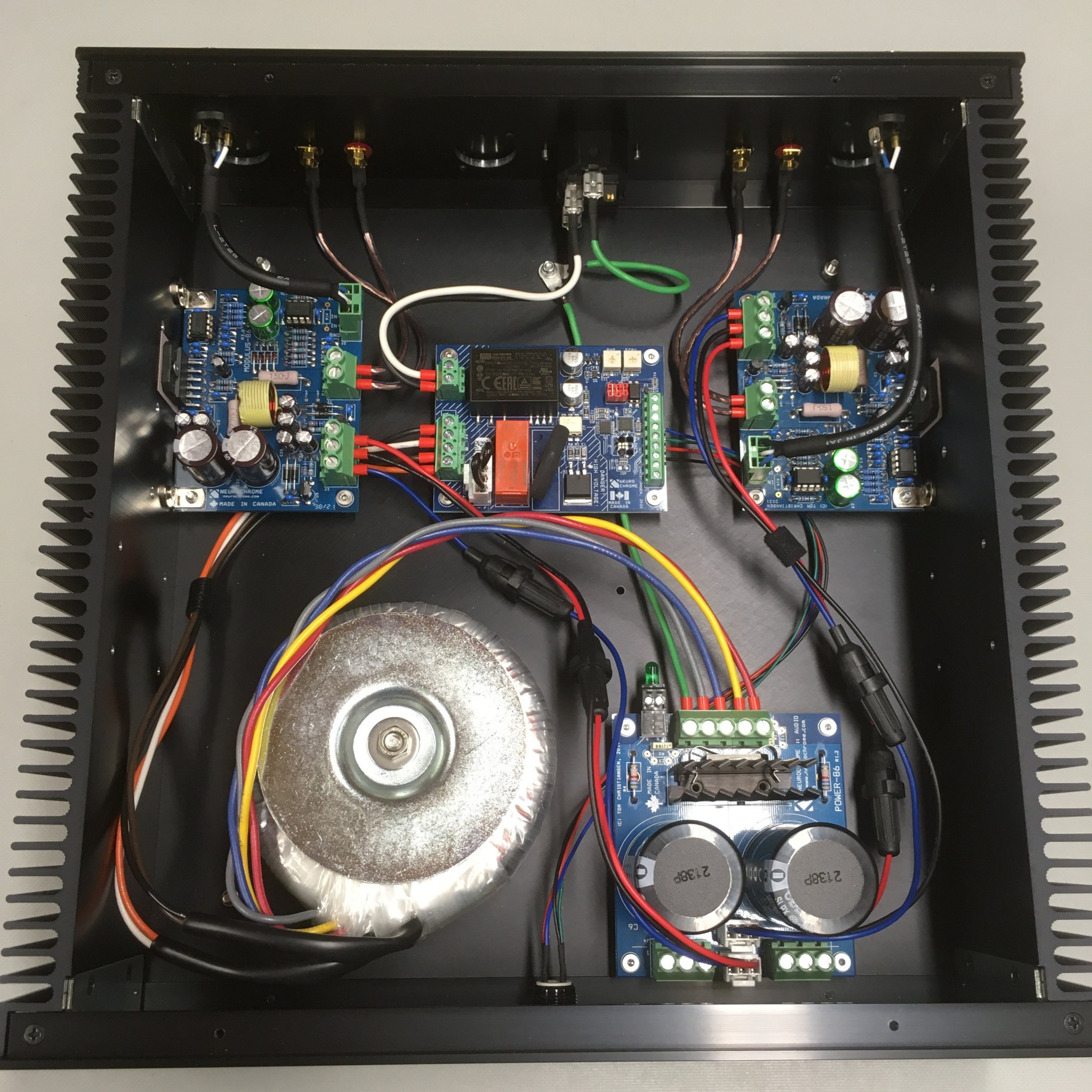

I would drape the drain wire with some heat shrink and add it to the crimp connection on the spade connector that connects to the mains ground. You can connect it where you currently have the wire nut but that just makes the 'antenna' (i.e., the drain wire connection) longer, thus, more likely to radiate EMI.
I'm thinking/hoping that you just used the wire nut as a place holder. They're really not appropriate for use inside equipment.
For everyone else's benefit: Note that shielded mains wire is NOT required. Regular wire works just fine.

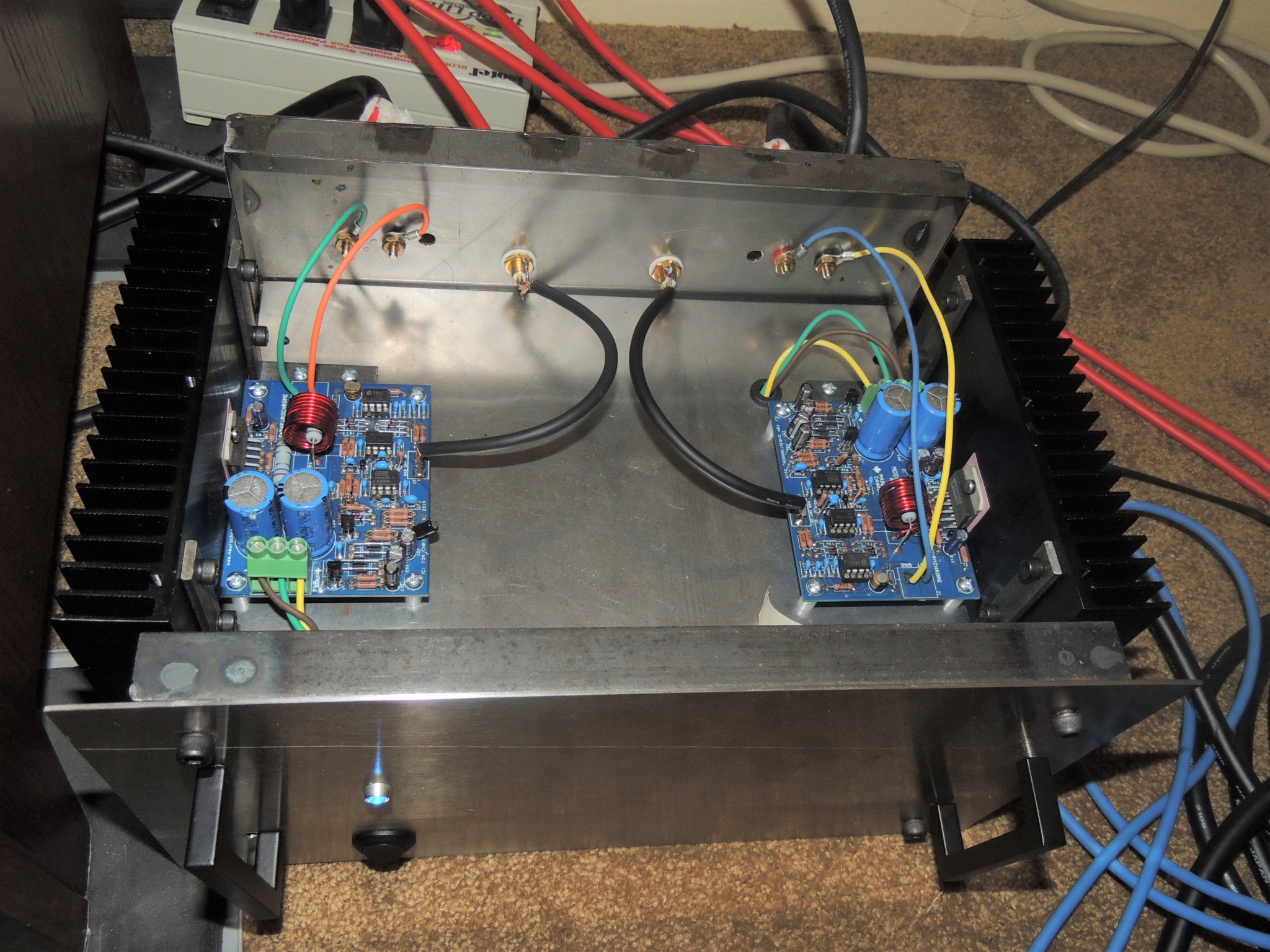

Not to diminish the discussion about the commercial chassis, which are nice, I include a photo of my Modulus-86 project with a home-made chassis. I bought the boards (version 2.40) over a year ago but was slow in finishing them. The LM3886 ICs were sold to me for cost by a very kind member of the DIY audio community. The components are certainly a tight fit on the board. I used a flashlight to inspect the undersides of the boards to make sure I had no solder bridges. I put sockets in the gain resistor location, currently set for about 26 db gain to accommodate using my Openamp 1 phono preamp’s output which is controlled by a pair of 1000 ohm Bournes conductive plastic pots. I use an Ortofon 2M Black cartridge with this preamp.
I bent and welded the chassis from 18 gauge sheet metal with the front panel being a leftover piece of 16 gauge stainless (with a scratch in it) for a commercial kitchen counter. The handles were on sale for $1.49 at Menards. The panel supporting the amplifier boards is removable with the power transformers and rectifier boards mounted in the bottom part
of the chassis. The project is in the “recently operational” stage and obviously needs bodywork and paint.
This amplifier sounds absolutely wonderful. Great resolving power. Acoustic instruments have weight and impact and tonal correctness. Great ambient information (which I assume some people call “soundstage”). The speakers I am using are Magnepan MG 0.7s. I am very pleased overall with this project.
