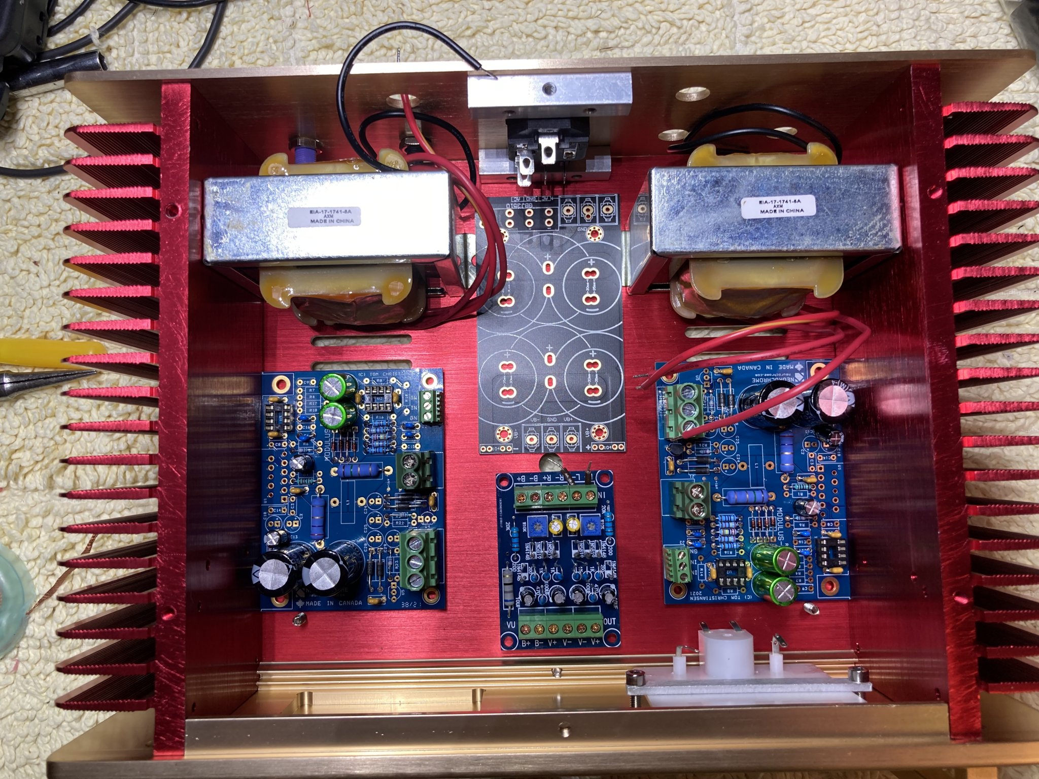

Of the options you present I prefer Option 2, though I would consider mounting the rectifier on the bottom panel between the transformers. Then run the mains wiring straight up the middle of the chassis. Here's my rationale:
Option 1 doesn't allow you to get the wires into the terminal blocks. No bueno!
Option 3 runs the wires for the rectifier (nasty pulse currents) right over the input circuit for the left channel. That'll give hum.
Option 2 does have the (EI core!) transformer right by the input circuit on the right channel, but given the choice between having some stray electromagnetic field from the transformer engage with the input circuit (Option 2) and having the EM field from the rectifier currents do so (Option 3) I think Option 2 has the lower chance of inducing hum. That said, the right channel in Option 2 will measure worse that the left because of the coupling from the transformer. Sorry. Physics... 🙂
Placing the rectifier between the transformers in Option 2 and rotating the PSU board such that the wiring to the rectifier is as short as possible will limit the loop area in the rectifier harness, thereby minimizing its coupling into the rest of the circuitry. Keep the wires short and bundle them together with zip ties.

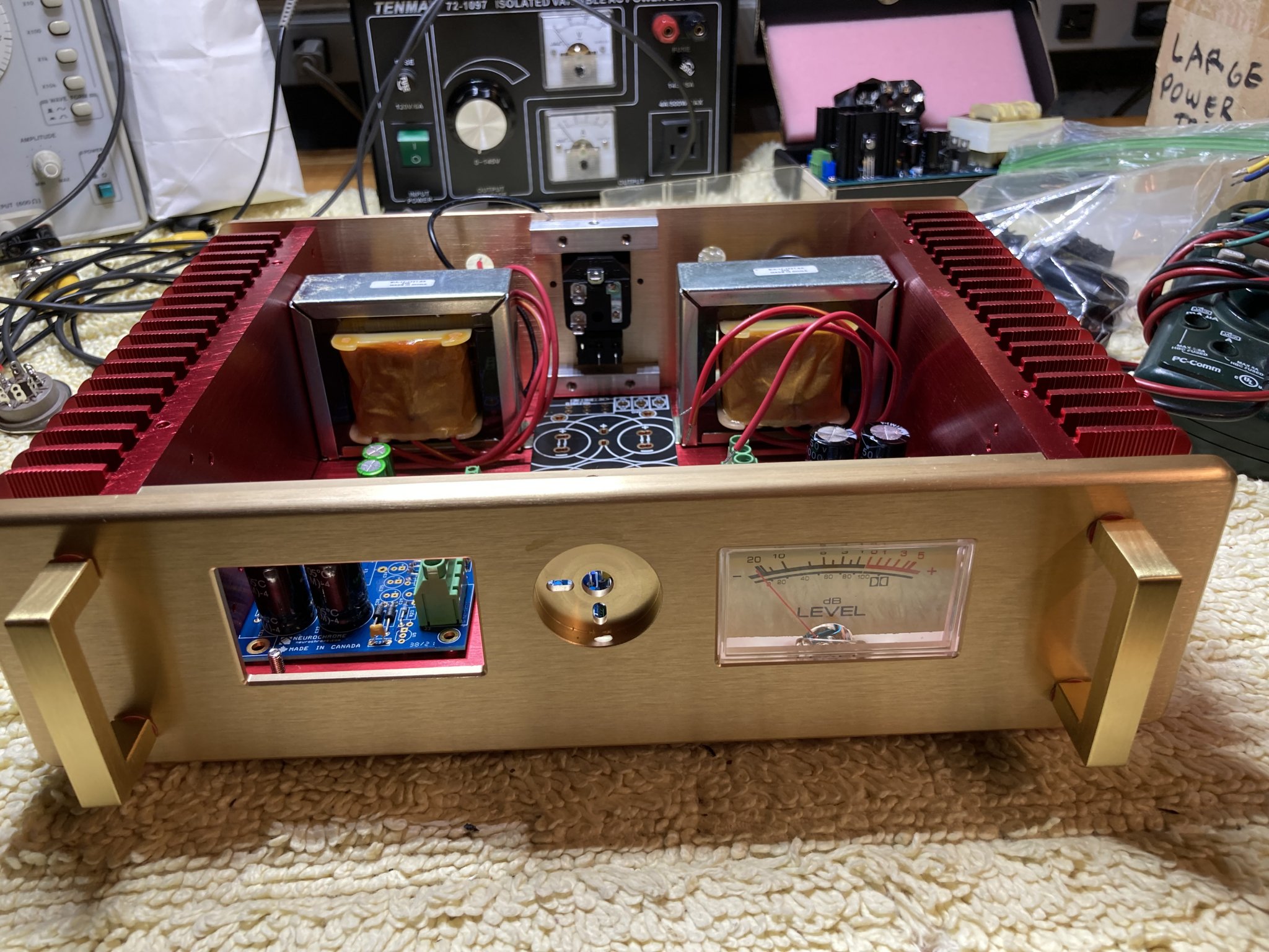

Option 4 (below) is what I will use. A couple little notches filed in the heat sinks allows the transformers to slide under the heat sinks for cap board clearance. Mount the cap board so the rectifier is at the rear. My inputs will be above it but there will be a couple of inches.
Alternatively, I could put the transformers at the front with the rectifier all the way at the front.

Obviously the LM3886 chips are not quite centered. I'm not sure where the sweet spot is to optimize heat sink utilization vs. getting the one channel input as far away from a transformer as possible.
I used the previous boards where LM3886 wasn't centered, and realized too late the case I bought was cute, but really small. So I just mounted one board upside down to center the LM3886 on the heatsink. I used angle brackets to secure the boards to the heatsink.
Nice layout except it forces the input wiring to run right over the transformer. I'd rotate it 180º, but that's me.
You could also keep the layout as-is and run the inputs using StarQuad cable. That along with the differential input of the MOD86 will eliminate any hum induced on the wiring - assuming you have a source with a balanced/differential output.

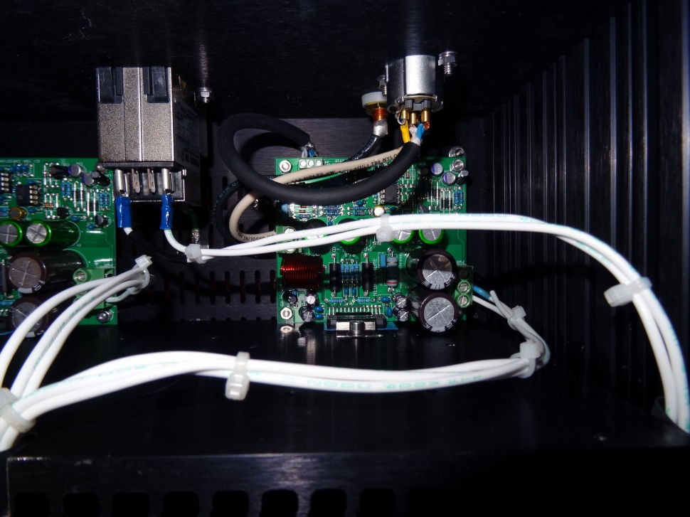

Based on your recommendation to keep AC leads away from inputs I think the attached photo shows the AC leads are too close and parallel to the input wires and should be moved.
One saving grace is that you're using balanced inputs (and presumably a source with balanced output). The CMRR of the differential receiver in the Modulus-86 will attenuate any hum induced on the input wiring by 80+ dB. That said, the wires do run right over the input section of the Modulus-86 board.
The transformer primary carries the same nasty charging currents as the secondary, albeit reduced by the turns ratio of the transformer, so it's only the second-worst offender for EMI. I'd rate the secondary wiring (basically anything that connects to the rectifier) as the worst offender. This is why you want those wires tightly bundled (as you have them).
So you have a choice. On one hand your amp is assembled and performs well. You mentioned that you have no hum in the speakers - or at least no hum that can be attributed to the amp. So doing nothing is a perfectly valid option. Ain't broken. Don't fix. But on the other hand you could probably get measurably better performance if you moved the AC mains wiring so it runs down the middle of the chassis even if that puts it in close proximity (and parallel to) the power and output connections for the amp modules. If you choose this route, just make sure to protect the wires where they go through the milled channel in the heat sink.

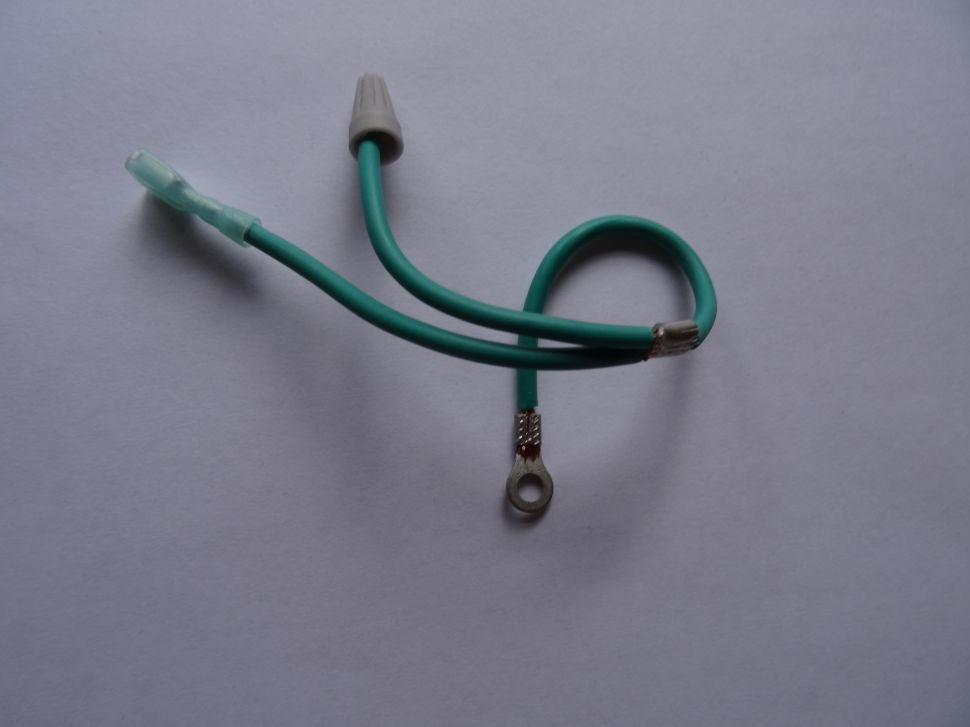

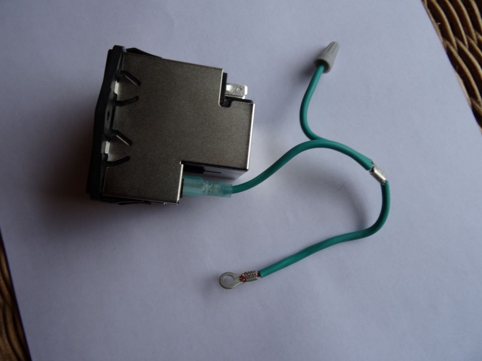

I just replaced the AC leads to the IEC with Belden 8719 shielded cable and would appreciate some guidance in grounding the drain wire. The photos show how I thought it could be connected to the same chassis grounding lug used for the IEC ground wire. The drain wire would be connected to the wire with the wire nut. Is this approriate?
