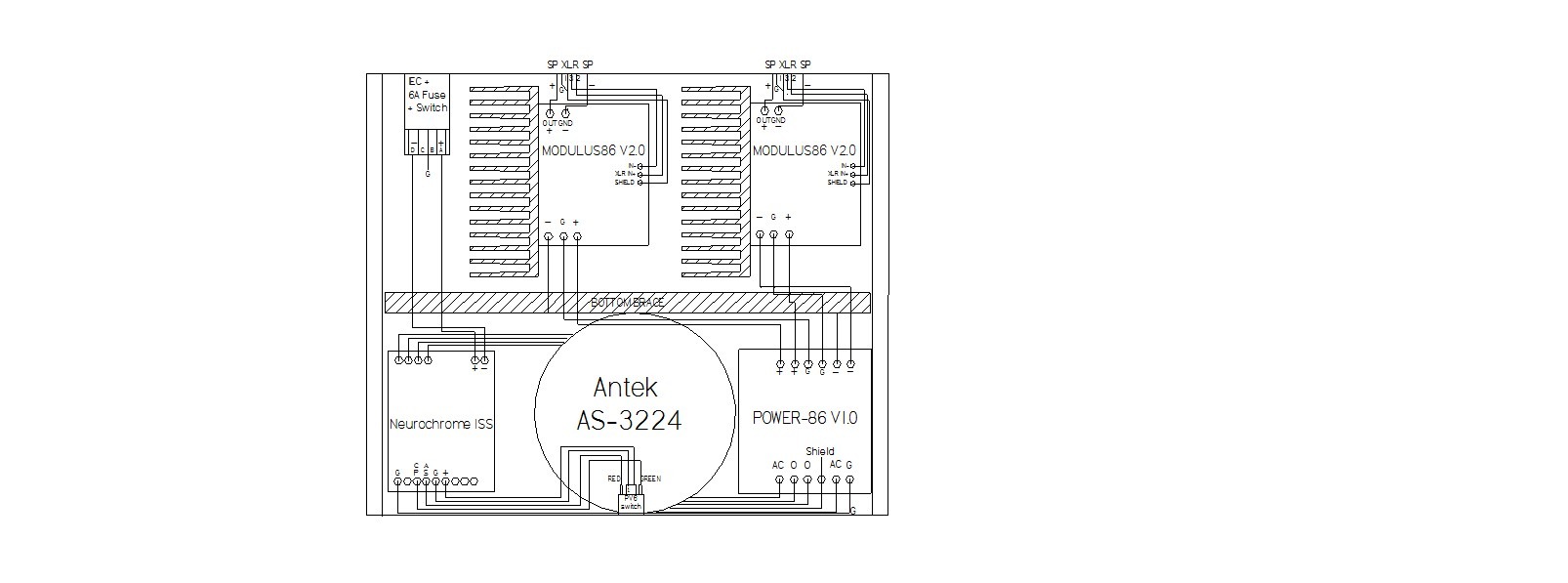

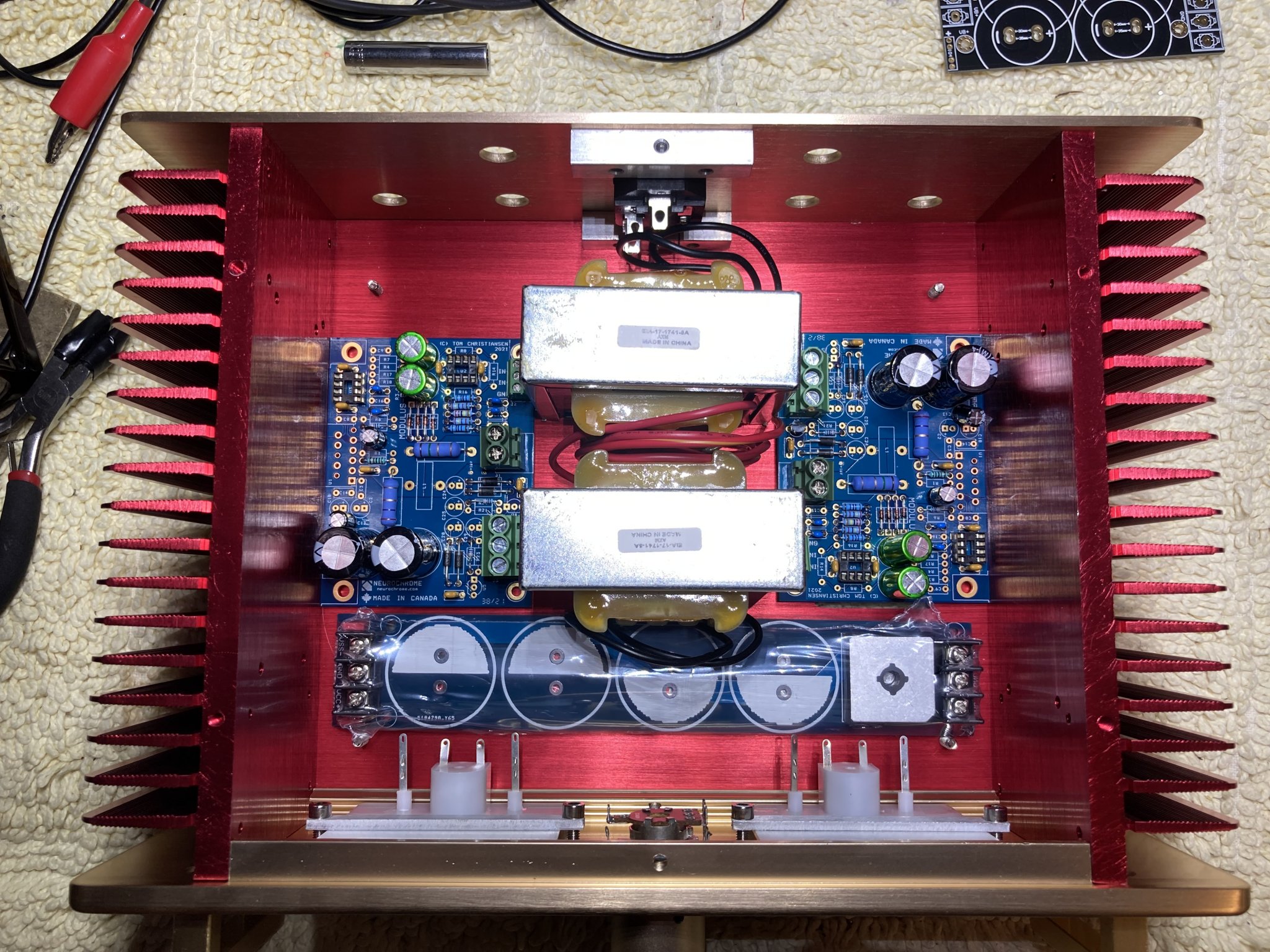

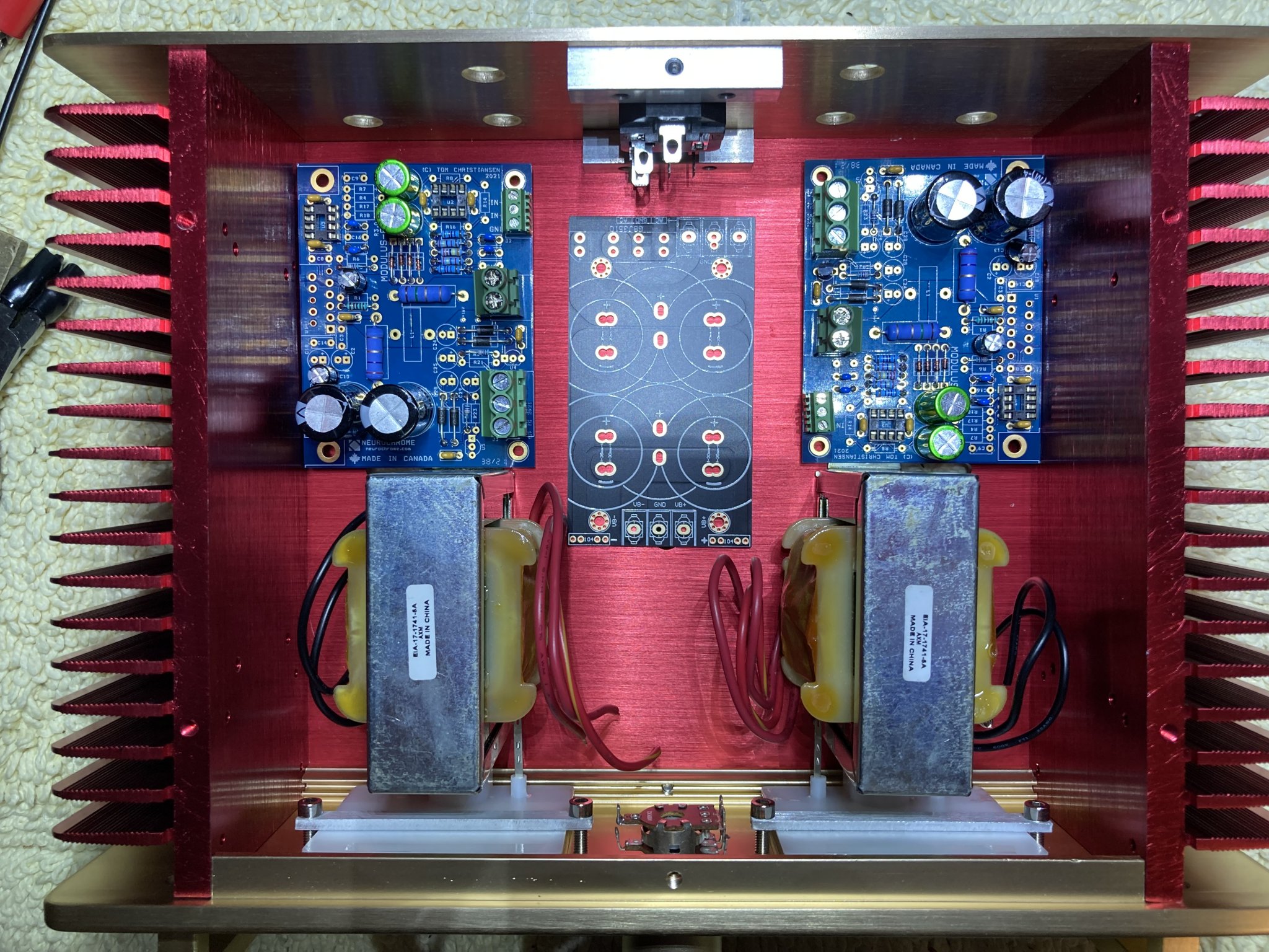

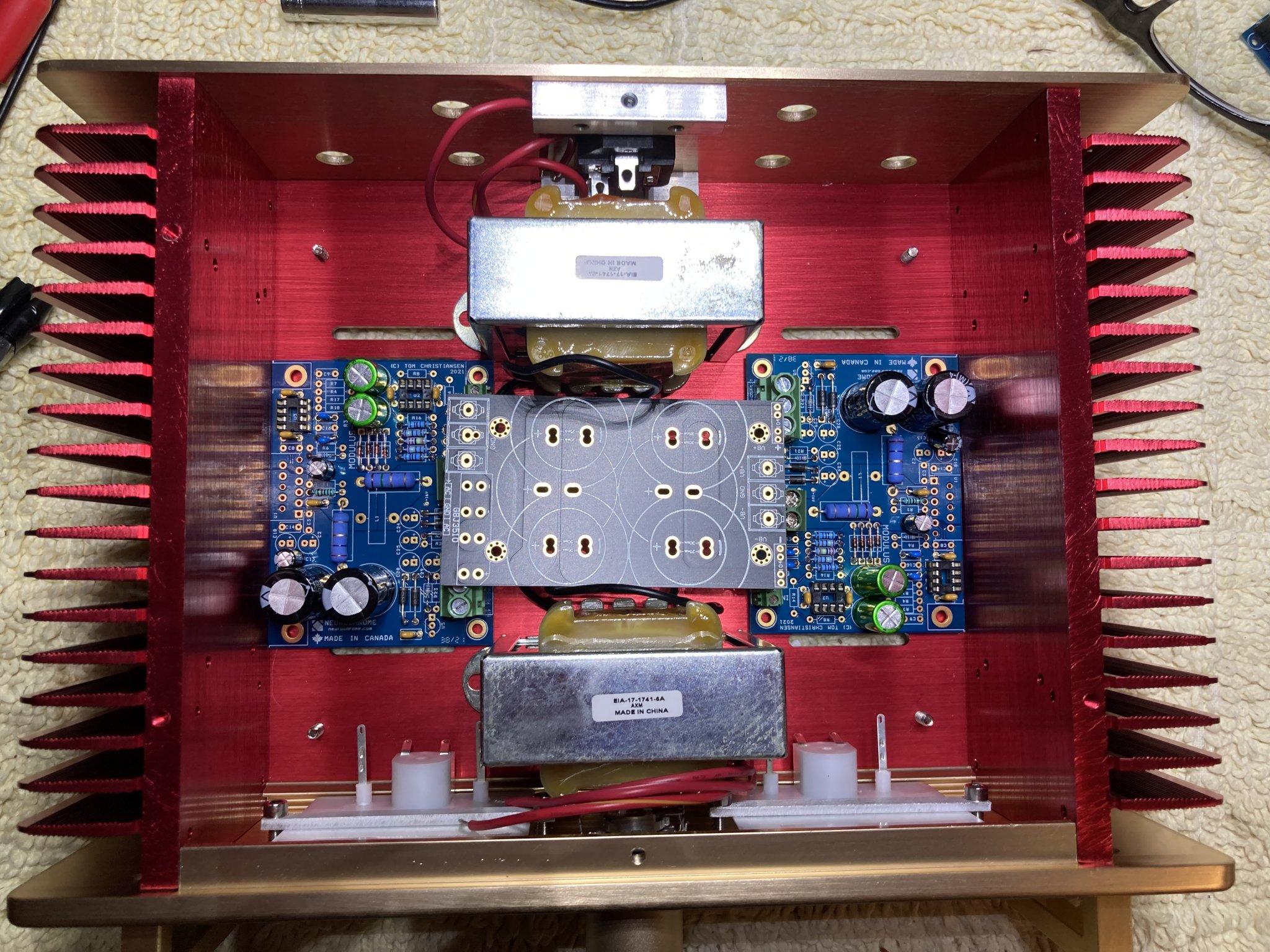

I'm trying to cram a dual Mod86 into this cool chassis. However, I think the possibility of hum pickup from the power transformers is huge.
Comments? In order, I would like options 1,2,3.

How tall is the chassis? One option could be to mount the MOD86 boards vertically and secure them with long standoffs to the rear (or front) panel.
Of the options you present I prefer Option 2, though I would consider mounting the rectifier on the bottom panel between the transformers. Then run the mains wiring straight up the middle of the chassis. Here's my rationale:
Option 1 doesn't allow you to get the wires into the terminal blocks. No bueno!
Option 3 runs the wires for the rectifier (nasty pulse currents) right over the input circuit for the left channel. That'll give hum.
Option 2 does have the (EI core!) transformer right by the input circuit on the right channel, but given the choice between having some stray electromagnetic field from the transformer engage with the input circuit (Option 2) and having the EM field from the rectifier currents do so (Option 3) I think Option 2 has the lower chance of inducing hum. That said, the right channel in Option 2 will measure worse that the left because of the coupling from the transformer. Sorry. Physics... 🙂
Placing the rectifier between the transformers in Option 2 and rotating the PSU board such that the wiring to the rectifier is as short as possible will limit the loop area in the rectifier harness, thereby minimizing its coupling into the rest of the circuitry. Keep the wires short and bundle them together with zip ties.
Tom

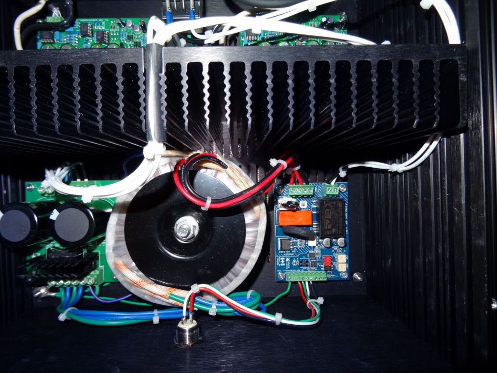

I would snip the ground wire from the ISS to the chassis. The ISS does not need to be grounded and cutting that wire would eliminate any leakage currents from the mains filter in the SMPS on the ISS.
You could argue that the mains wiring should run down the middle between the heat sinks for similar reasons as in my advice just above. On the other hand: Do you have audible hum in the speakers when you're using this amp? If not, don't mess with it. Ain't broken. Don't fix.
