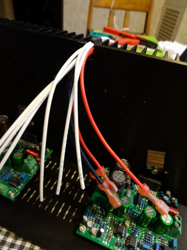

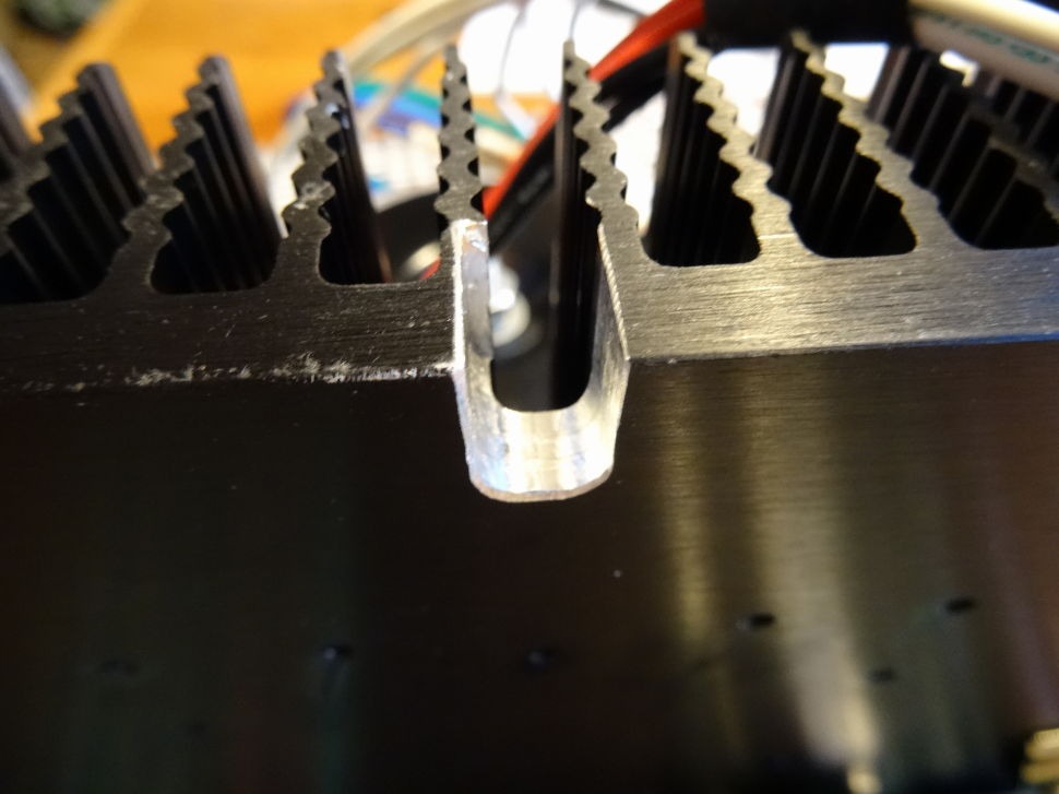

So I'm finally building my Parallel86. I milled a channel in the top edge of the heatsink for running wires from the Antek to the AC power module. While doing that I made it a bit wider and deeper thinking it would also be a good place to run wires from the power86 to the parallel86 boards. I rounded all edges of the channel but thought it would be good to run the wires in heat shrink tubing as extra protection. Turns out all four AC leads and six power86 leads fit in one piece of heastshrink tube. Is there any issue running all the wires togehter?

All edges of the channel were filed and sanded very smooth and the heatshrink tube is very thick with internal adhesive. I don't think there will be any chafing. Over the last six years It has always been a pleasure and learning experience talking with you. As always I thank you for your help.
