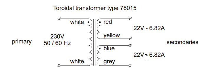

Hi everyone,
In the past week I build two modulus-86 and one power-86.
My transformer (I had it already for another project is a 300VAC 2 x 22v Amplimo transformer.
For the moment the 300VAC is more than enough and because it is 2 x 22V it should work.
Windings are as follows:
According the Antek AN 2222: red=green 5, yellow= blue 6, blue=green 7 en grey=blue 8.
When I connect the transformer the result is 60v DC output (no load). Measured between V-(J4) and V+(J2)
What am I doing wrong?
Cheking the schema of the Power-86:
2-3 are conneceted, yellow(blue6) is connected to blue(green7) and doubling the voltage.??
Thanks for any tips or solutions.

What are you expecting? 22v ac will be rectified to (approx) 30V DC so as between two rails you should get 60VHi everyone,
Ad.
So, you say, this is correct and I think you are absolutely right! I made some wrong thinkingWhat are you expecting? 22v ac will be rectified to (approx) 30V DC so as between two rails you should get 60V
Stupid me. 🤣🤣
Thanks, I am back to earth again...😊

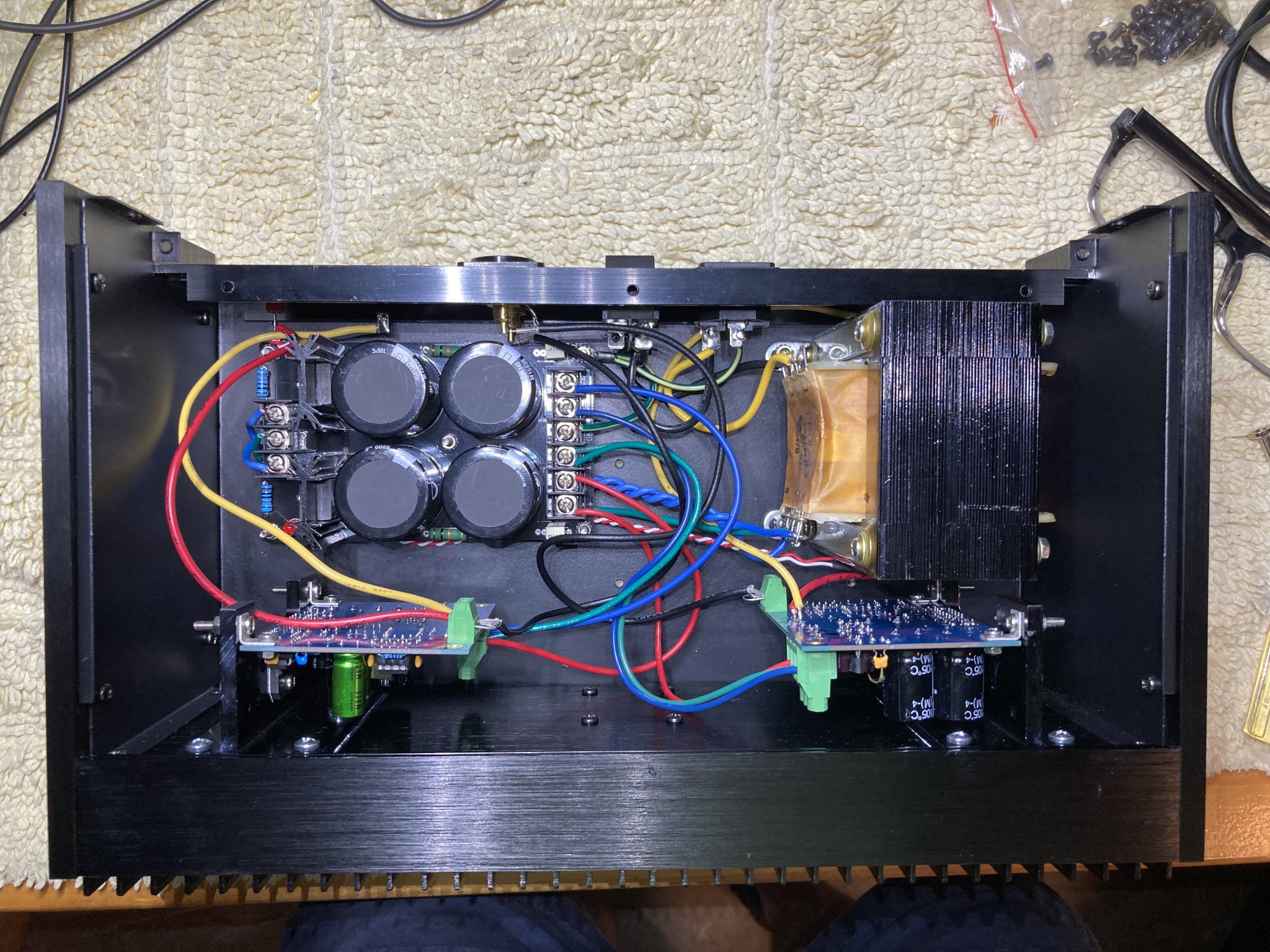

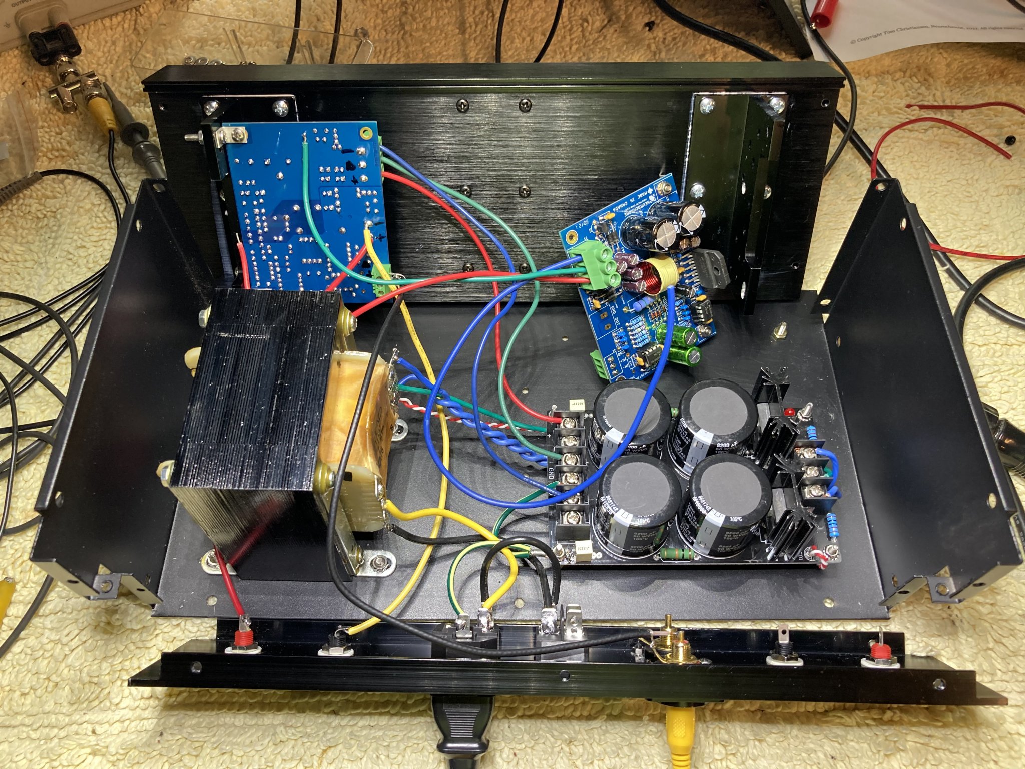

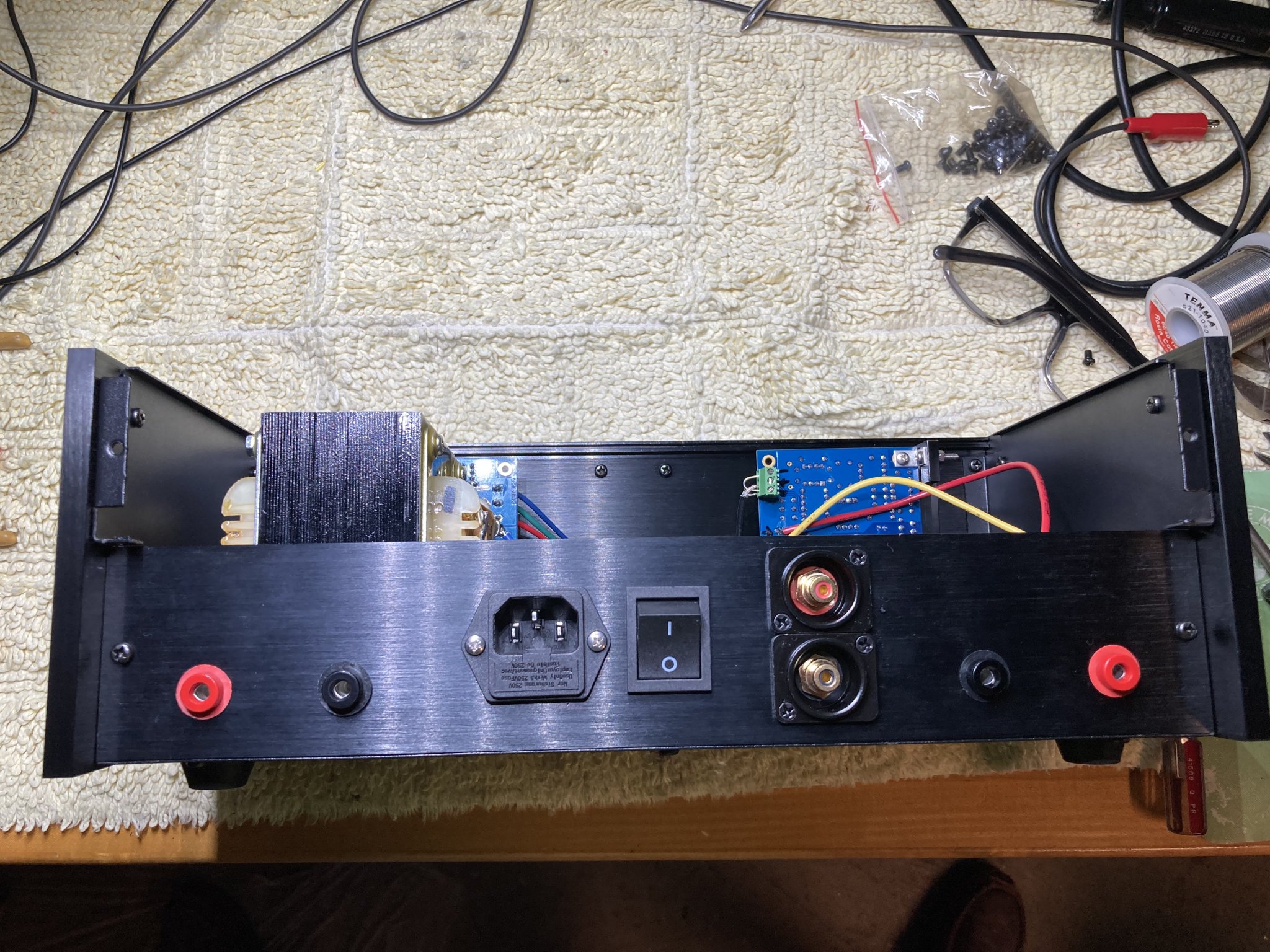

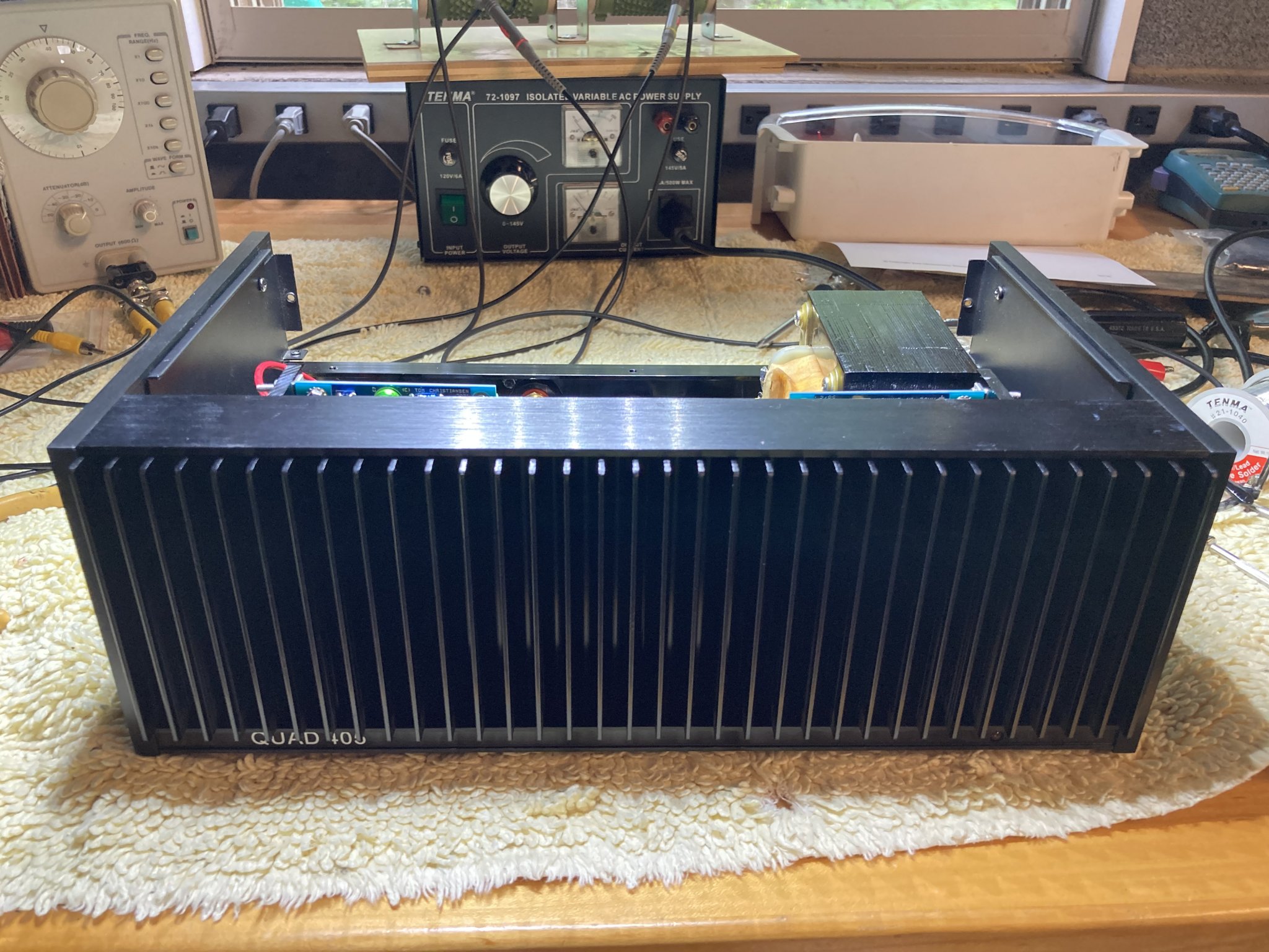

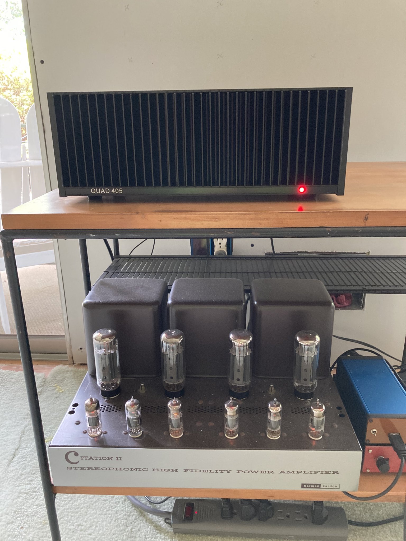

Modulus 86 2 channel build using Quad 405 chassis.
Chassis: Quad 405 reproduction chassis from aliexpress with additional Quad brackets to mount the Mod 86 boards. Rear panel modified to hold Neutrik type inputs. I'm planning on balanced inputs eventually after I construct a balanced preamp and aquire a balanced DAC.
Transformer: Triad F-215U 24-0-24 vac 196 VA gives +-32VDC under full load with 47 rms/channel both channels driven into 8 ohm loads.
Cap board: Generic.
Sounds: Perfect it seems. The best sounding solid state amp and probably best ever sounding amp I have ever heard.
Background: I'm a 65 year old BSEE who abandoned a Dynaco ST400 (200wpc) solid state amp for tubes decades ago. Looking back it had massive crossover distortion that, when I acquired high efficiency speakers was bested by a 12 watt per channel solid state Realistic Radio Shack amp. I have made dozens of tube amps so I decided to hear a state-of-the-art solid state amp. The Modulus 86 is no comparison to the SS amps of yore and bests most if not all of the tube amps I built or still own.
Many thanks to Tom Christiansen for offering this to the DIY community!
Tom Lang, Asheville, NC
