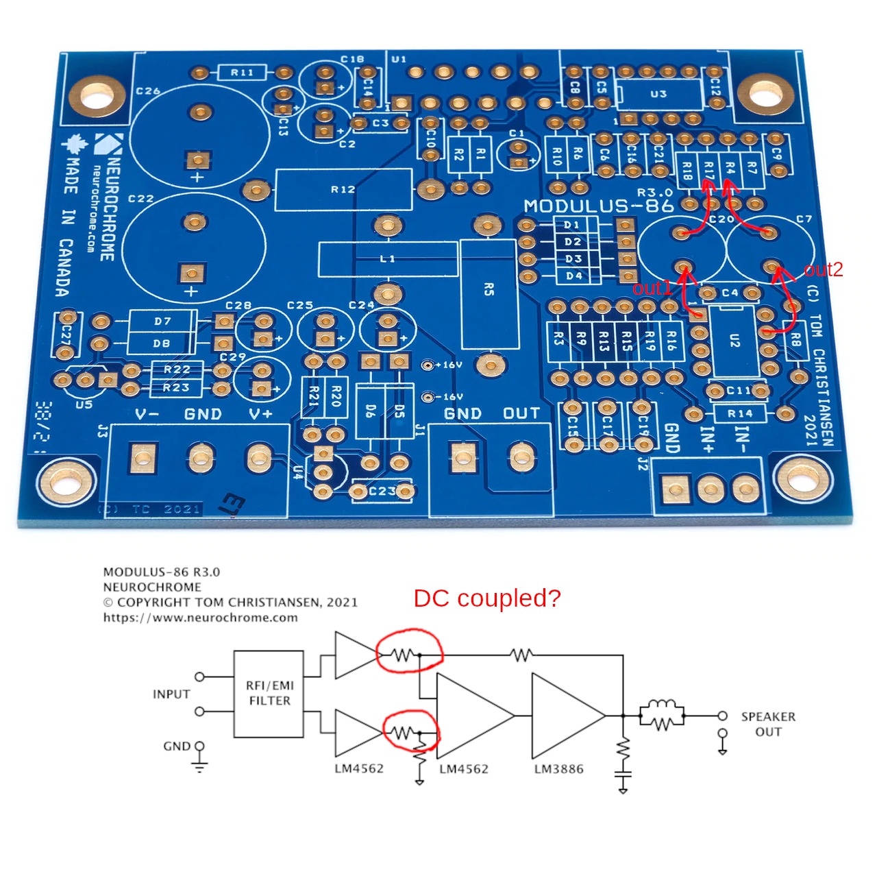

By the way, on an unrelated note, I was just looking at the Modulus 86 diagram today. I noticed that the outputs of the buffering opamp U2 appear to be AC coupled via C20 and C7 to U3. However, the overall circuit topology provided doesn't seem to reflect that?
Shouldn't those two resistors marked be capacitors instead to indicate AC coupling?

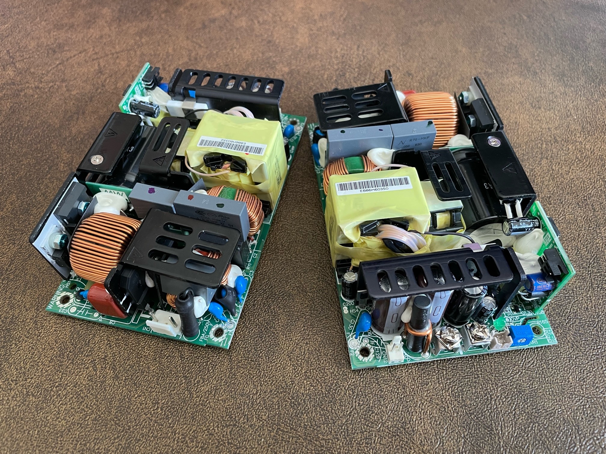

The Mean Well RPS-400-27 will work well. You can adjust a pair of them to near ±30 V and get 40-45 W into 8 Ω, 60-65 W into 4 Ω. The RPS-400-36 is the one where about half of builders have reported audible whine. Most were able to solve this by turning the voltage up to 40 V. One case required a heatsink mounted power resistor across the supply rails to bring the power supply out of "whine mode".

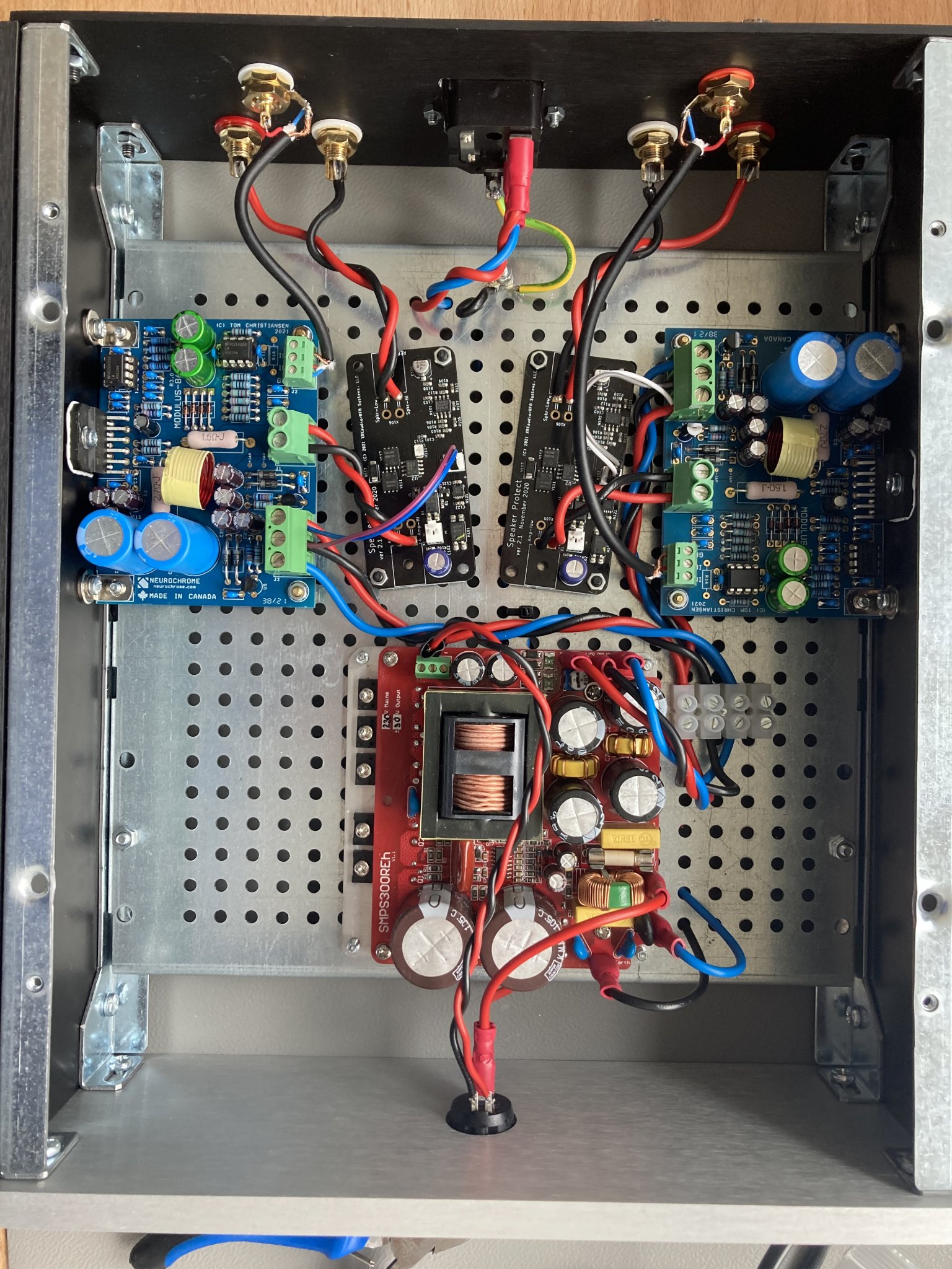

The Connex SMPS300REh is good too. It's a further development of the SMPS300RE. If you're thinking to go that route, definitely get the REh version. It comes mounted on an aluminum plate that you mount to the chassis. That allows for heat dissipation and increases the reliability of the power supply.

I have a pair of like-new RPS-400-27 supplies, free to a good home, just cover shipping.

For what it's worth, I built my Mod-89 with the Connex SMPS300REh to very satisfactury results. Keeping in mind that my speakers are a fairly easy load at 8ohm and 96db (manufacturer specs), and I don't listen to very loud volumes usually.
You can, but you get 2 kΩ input impedance. Few sources can drive that well. You also lose the option to have a gain other than 20 dB.On Modulus-86 Rev. 3.0, can i bypass U2 (U2,R3,R8,R9,R13,R14,R15,R16,R19,C4,C11,C15,C17,C19) and connect inputs directly to C2 and C7? What is the purpose of this input buffer. I mean what will be the downside if omit it? Correct me if i am wrong but it doesnt effects the THD+N?
