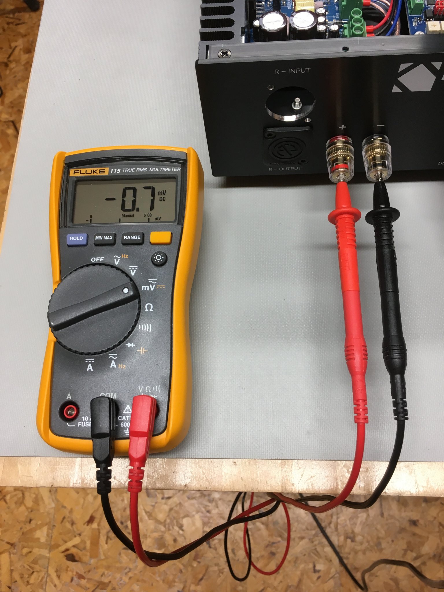

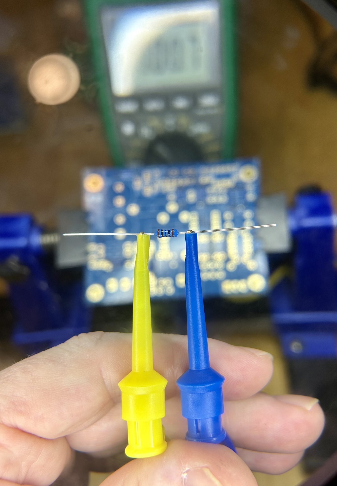

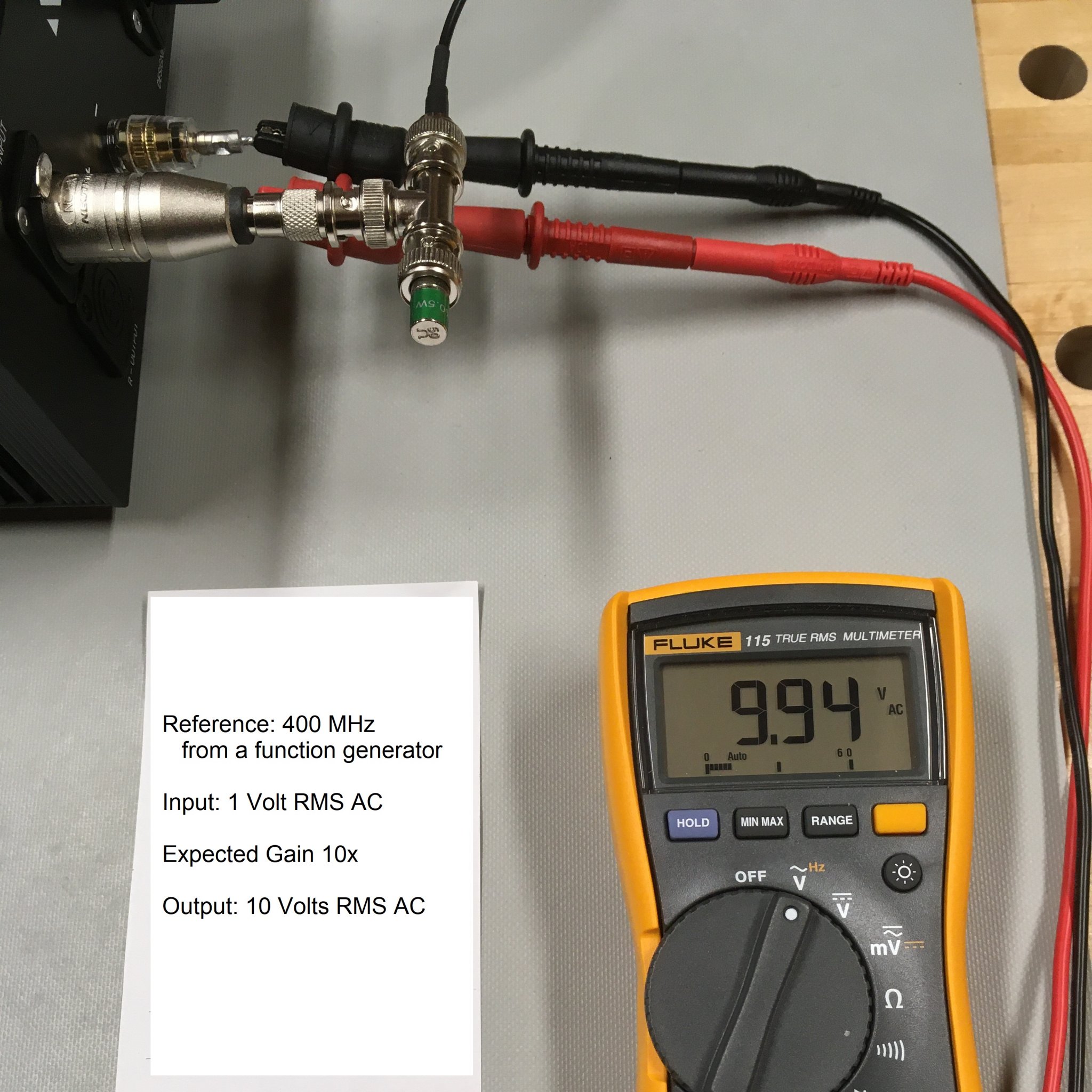

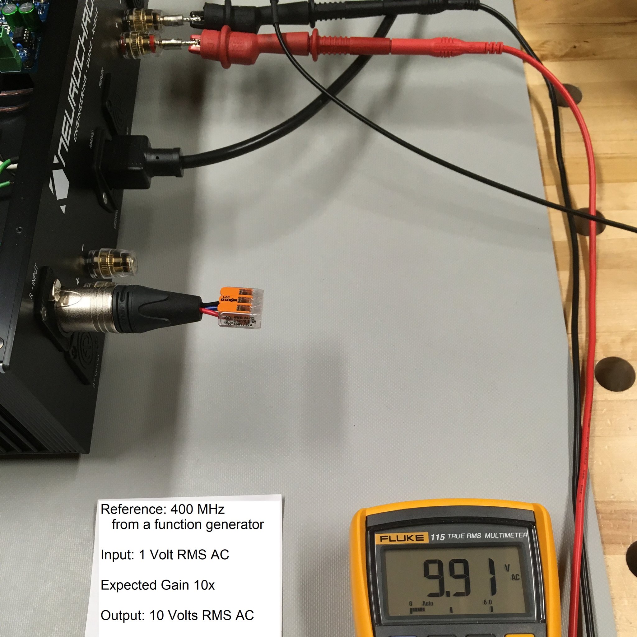

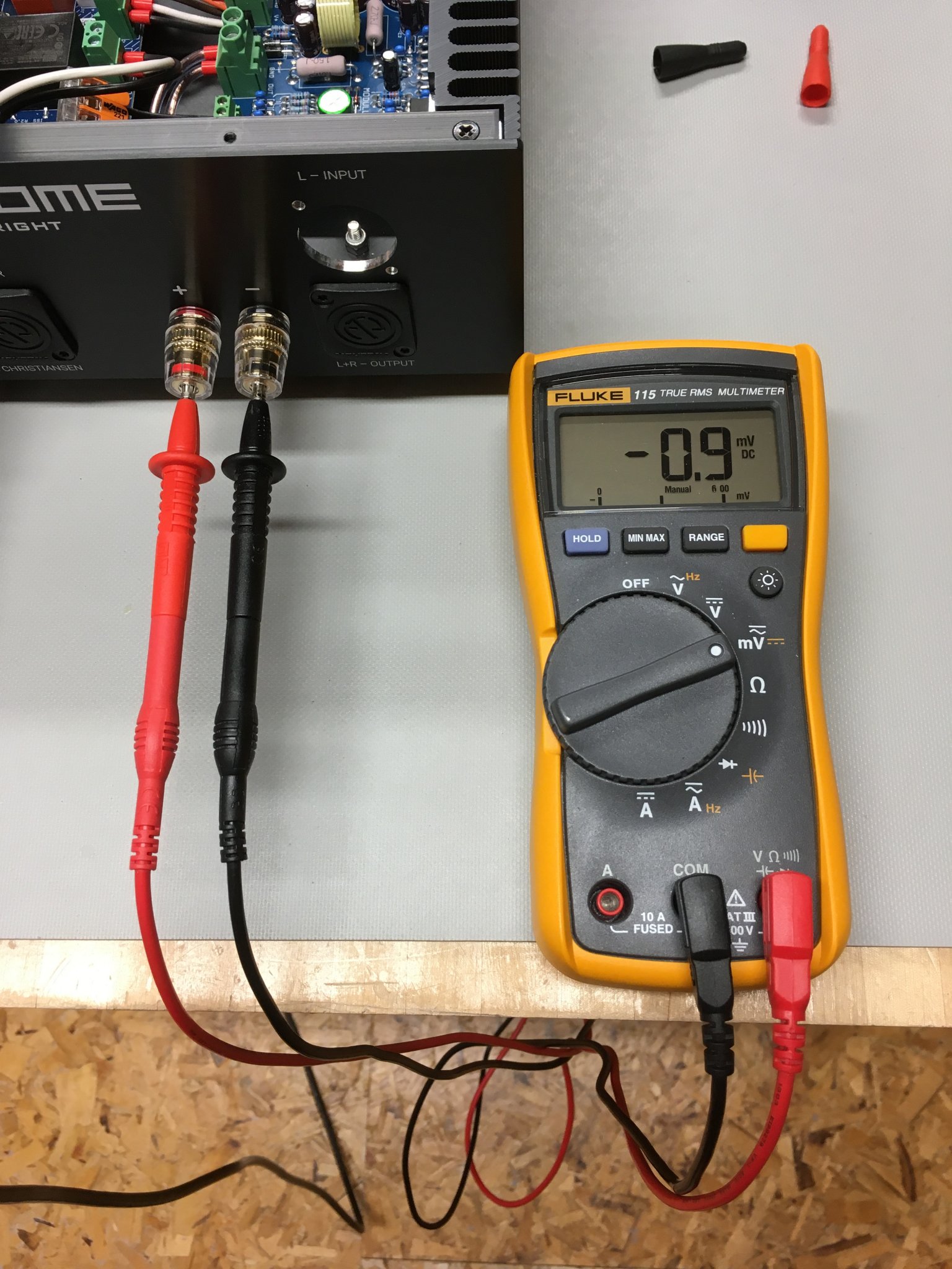

Test Results DC Offset and Gain

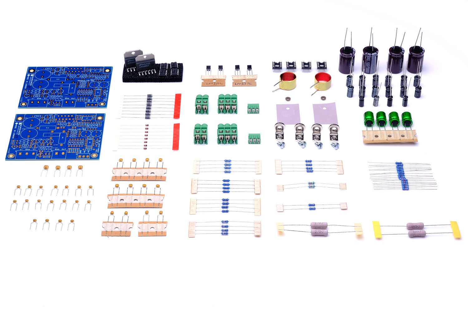

Hello,
What is a good alternate for the LM337LZ/NOPB LM317LZ/NOPB pair?
The usual safe suspects like Mouser, Digikey or Newark don't have them in stock and delivery is 2024.
Not sure if I trust TEM or LCSC to ship legit parts, any alternate sources likely to ship not fakes?.
Capacitors UPW1H102MHD and UPM1H220MED1TD are also out of stock in 50v, but it looks like 63v are in stock and are the same dia with the same lead spacing.
Seems like everything else is in stock for the Modulus-86!
Thank you,
David.
Just search for LM317L on Mouser/Digikey/et al. Select TO-92 (or TO-92-3) for the package and enable the "in stock" filter. Do the same for the LM337L.
Currently Mouser has 67,116 of the LM317LZ by STMicro. How many boards are you planning to build? 😉
The LM337L is trickier as I think TI is the only manufacturer. Mouser has 3900+ in stock of the LM337LZ/LFT3 from TI.
The capacitors are easier. Any substitute will work as long as it's the same capacitance, same diameter, same pin spacing, and same or higher voltage rating. For the ceramic capacitors you also need to pay attention to the dielectric. If I specify C0G/NP0 you do want C0G/NP0. X5R, X7R, and X8R are interchangeable.

Wow. Sourced and sorted for basically the raw parts cost.
Yeah. I may have to nudge the price up a bit if/when I get someone else to pack the kits for me. At one point Digikey offered to package orders as kits as well. That could be an option as well if the cost is reasonable. It all depends on how well the kits sell.
Right now the limiting factor is LM3886 availability. I have some orders in with Digikey. One of those was placed a year ago and I would imagine that it'll ship sometime soon. The last update from Digikey basically said, "we'll ship when we have parts - whenever that might be".

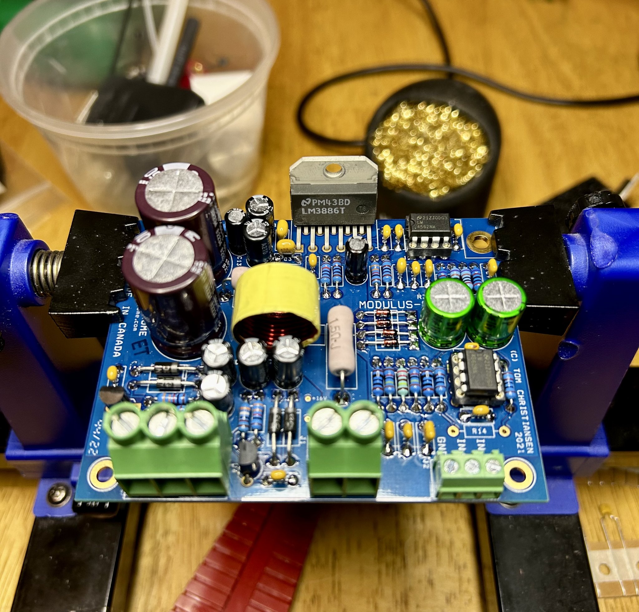

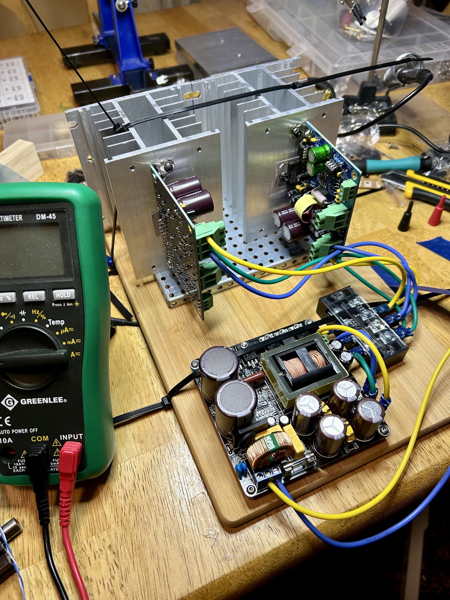

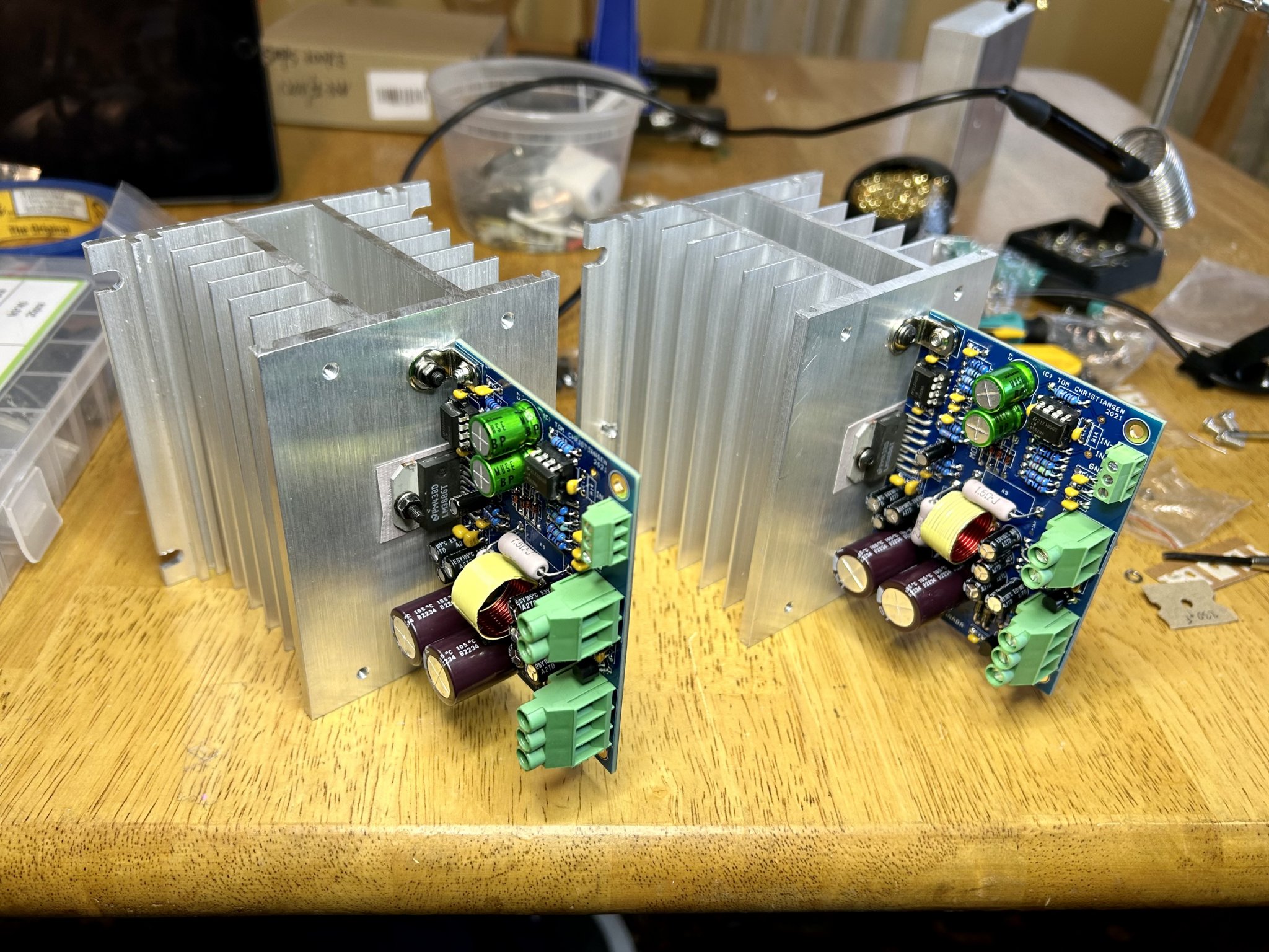

I managed to make a huge mess on my table and made it to first power up with no magic smoke!
+/-36VDC going to the boards. Virtually zero DC offset and AC noise at the outputs. I have yet to rig up some sort of input connection. I have to give my back a break, though. :spin: Success so far, more progress tomorrow. This arrangement is definitely just for testing. I’ll sort out a chassis later.
Who am I kidding? Tomorrow!? Ha! 😆

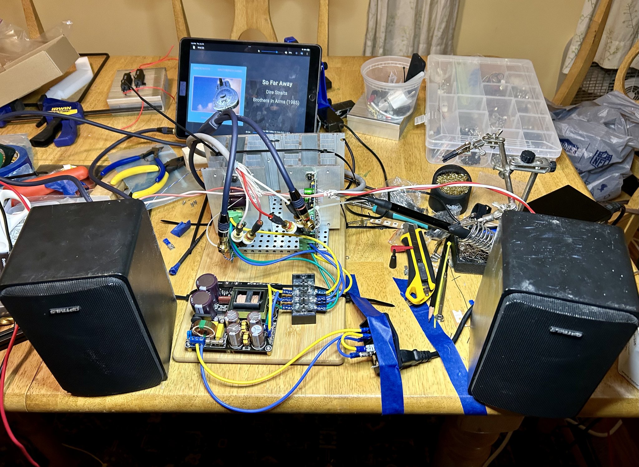

Everything works very well. Sounds very clear and detailed through my test speakers. Even with this absolute rat’s nest of wiring, it’s ABSOLUTELY SILENT when the music is paused. And when it’s playing… Wow. Now I know what an ultra-ultra-low distortion amplifier sounds like. 😎
I believe I have a keeper here. VERY welcome in the von Ahdio HiFi Stable.
I gotta sort out a chassis ASAP.
Thanks again, Tom. The Modulus86 is a DIY gem!
