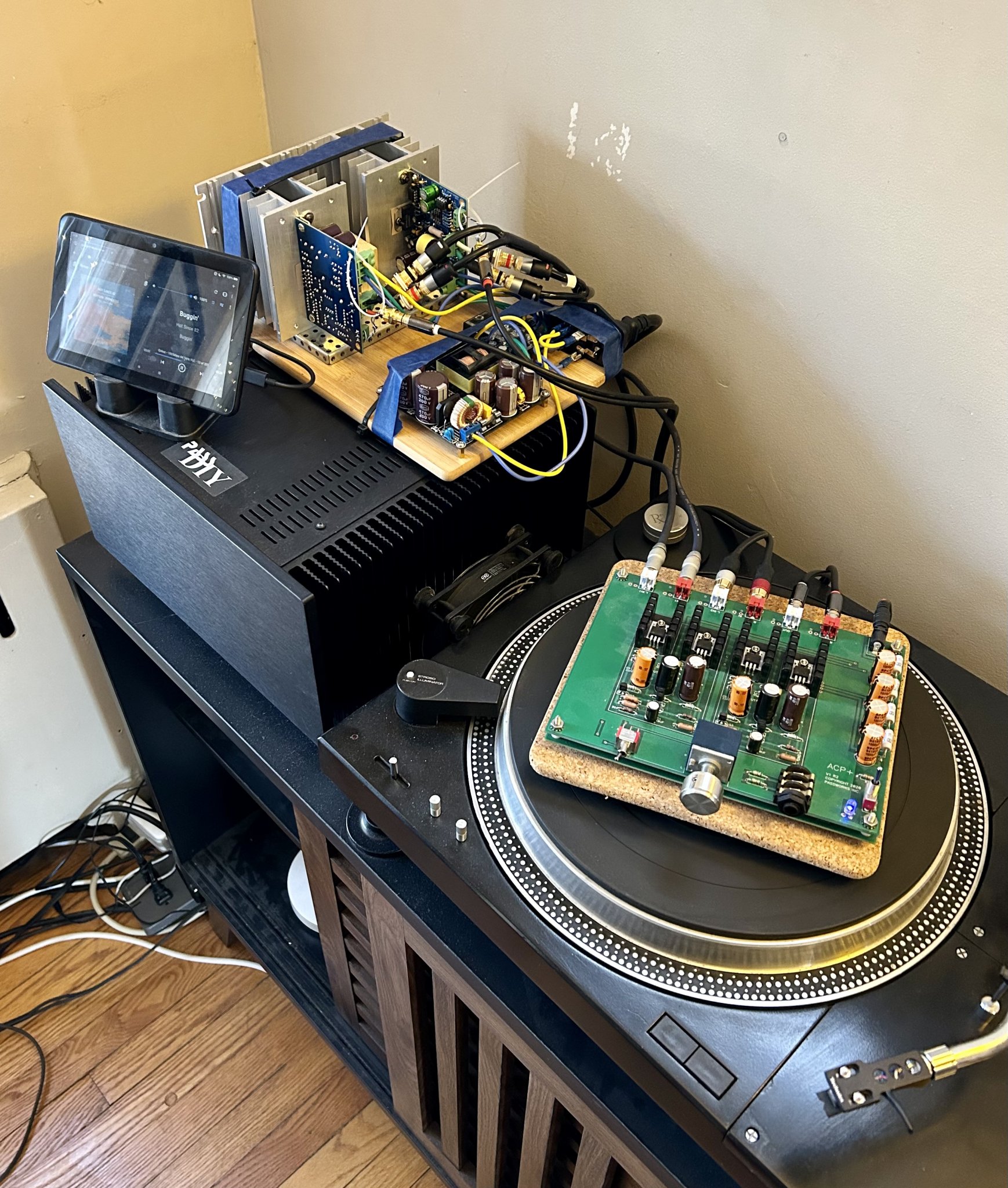

Everything works very well. Sounds very clear and detailed through my test speakers. Even with this absolute rat’s nest of wiring, it’s ABSOLUTELY SILENT when the music is paused. And when it’s playing… Wow. Now I know what an ultra-ultra-low distortion amplifier sounds like. 😎
I believe I have a keeper here. VERY welcome in the von Ahdio HiFi Stable.
I gotta sort out a chassis ASAP.
Thanks again, Tom. The Modulus86 is a DIY gem!

This picture gives new meaning to breadboarding.
That's great to hear. Thank you for sharing.The amp has FAR exceeded my expectations, which were admittedly high based on reading about the Modulus amps for years.
Meh. Safety-smafety!As long as I build an appropriately safe enclosure for it.
You might want to unplug the mains power for the turntable. I don't want to imagine what'd happen if someone turned that on by accident.

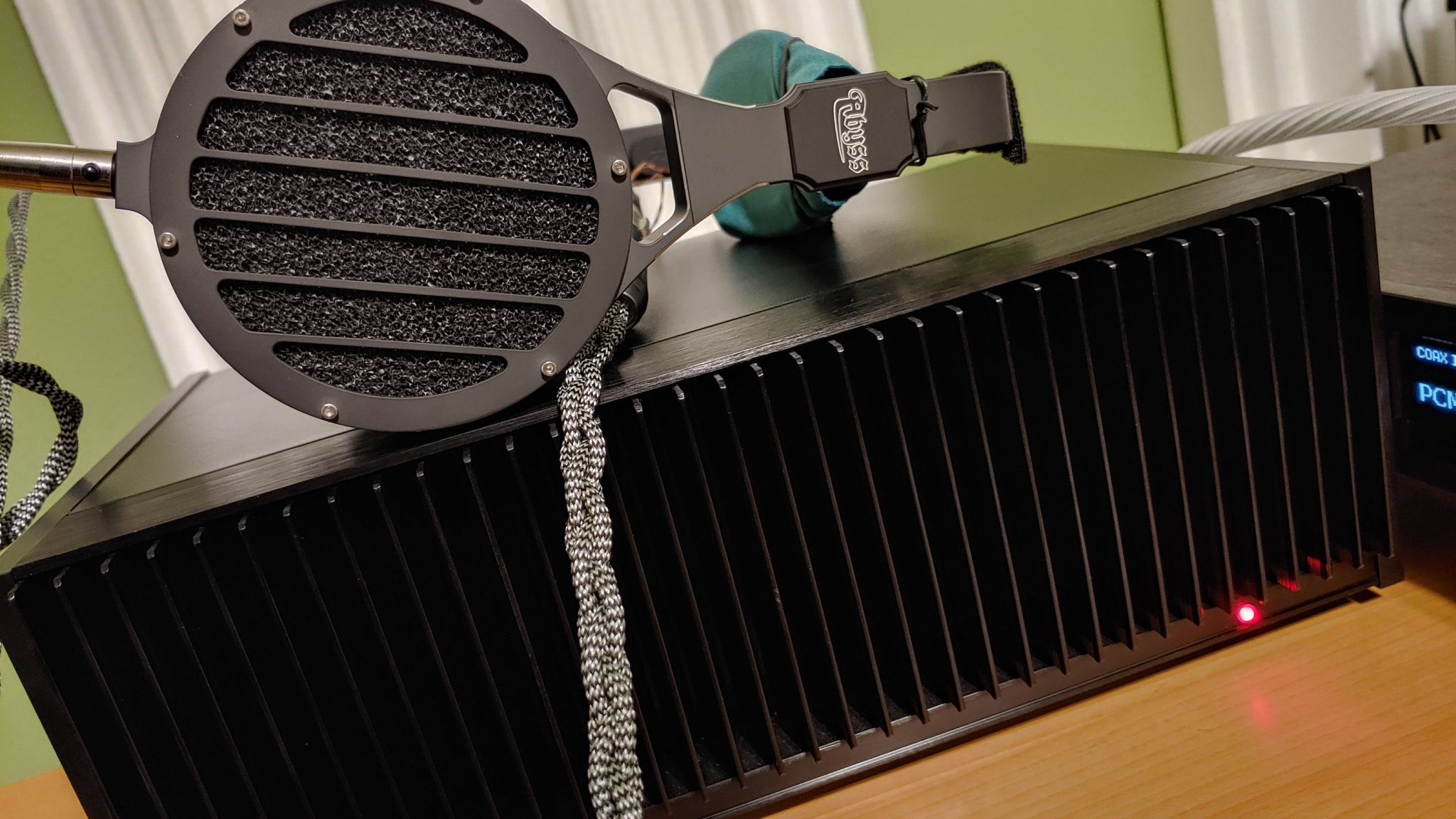

I was lucky enough to pick up a Neurochrome Modulus-86 (in Quad chassis) from this site. Probably not its intended purpose, but I can report it drives Abyss 1266 Phi TC headphones (47 Ohm, 88 dB/mW) extremely well, sounding especially tremendous playing electronic/EDM/Metal

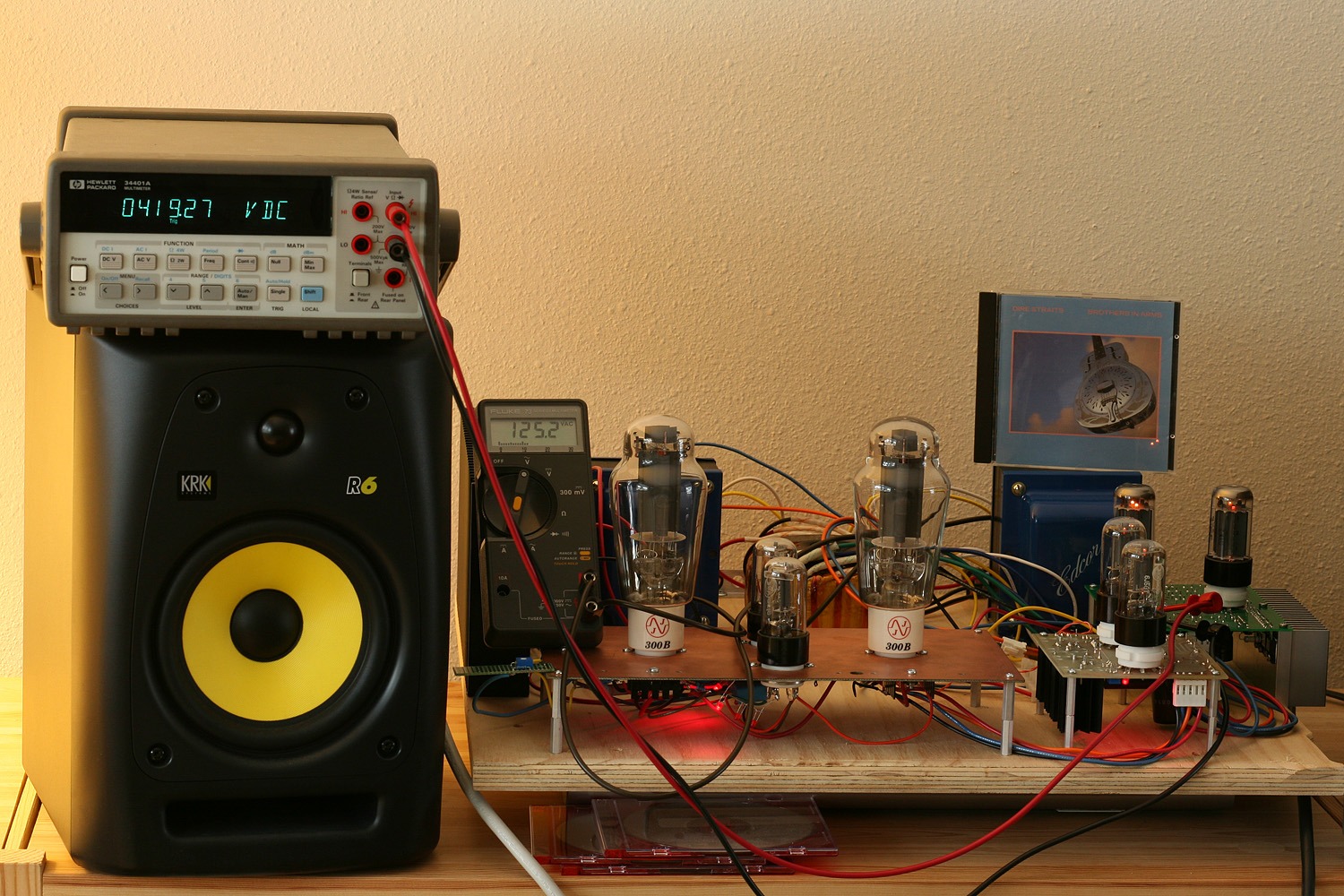

I got a bargain! It does make one wonder..What did you replace it with??I built that. It was a fun build and the chassis looks good, has plenty of heatsinking, and is reasonably priced and fits the components well.
I really didn't replace it with anything. At 66 years old I've been "electronic-ing" for more than 50 years. Decades ago, I replaced a solid state amp with a tube amp, didn't look back and I've built many different tube amps since then.
So I decided to try a state of the art solid state amp. The Mod86 is the best solid state amp I have ever heard. However, it doesn't sound (or look) like a tube amp. I realize tube amps have a higher noise floor and more distortion. As an engineer, I keep having to validate my choice of tube amps in spite of data to the contrary. Building this was to be a data point in that validation. It was. My ears and eyes voted tube amps. YMMV.
hi, where can i find a store for that chassis? thank youI was lucky enough to pick up a Neurochrome Modulus-86 (in Quad chassis) from this site. Probably not its intended purpose, but I can report it drives Abyss 1266 Phi TC headphones (47 Ohm, 88 dB/mW) extremely well, sounding especially tremendous playing electronic/EDM/MetalView attachment 1143792
