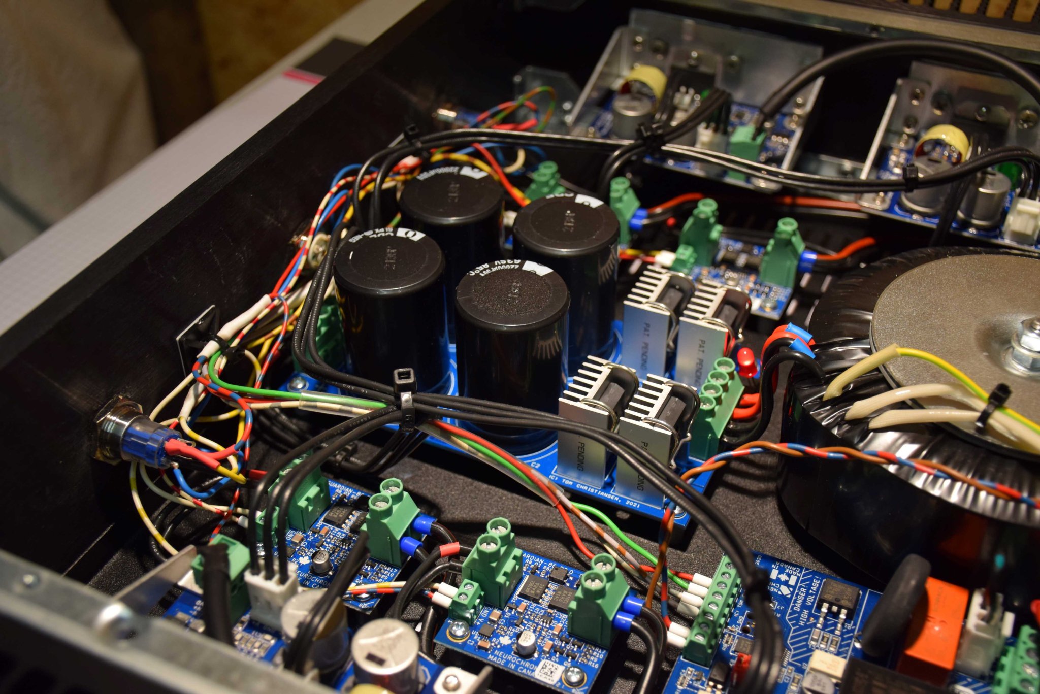

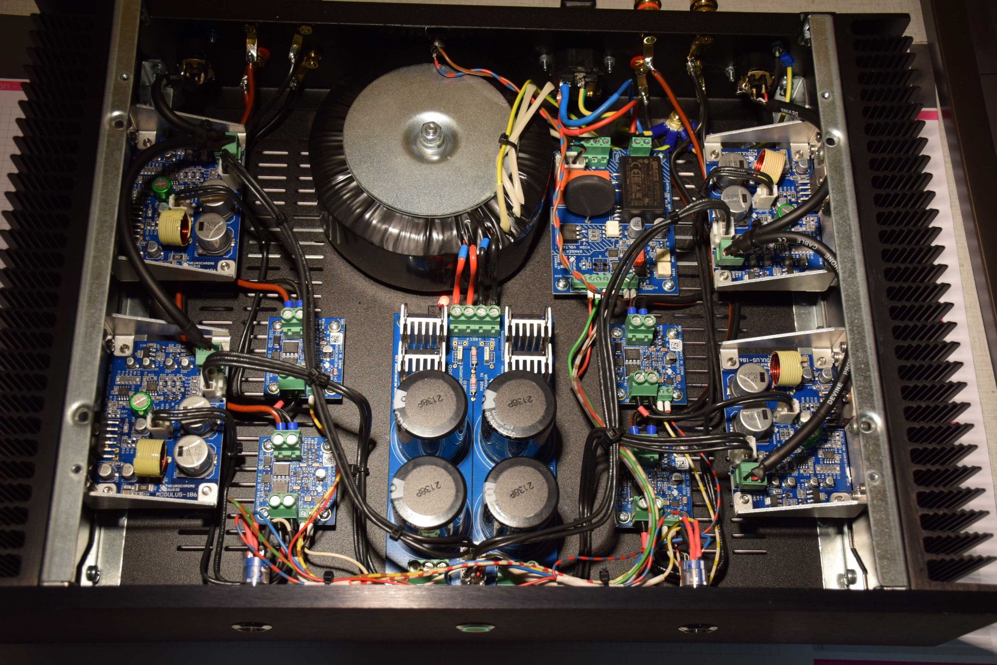

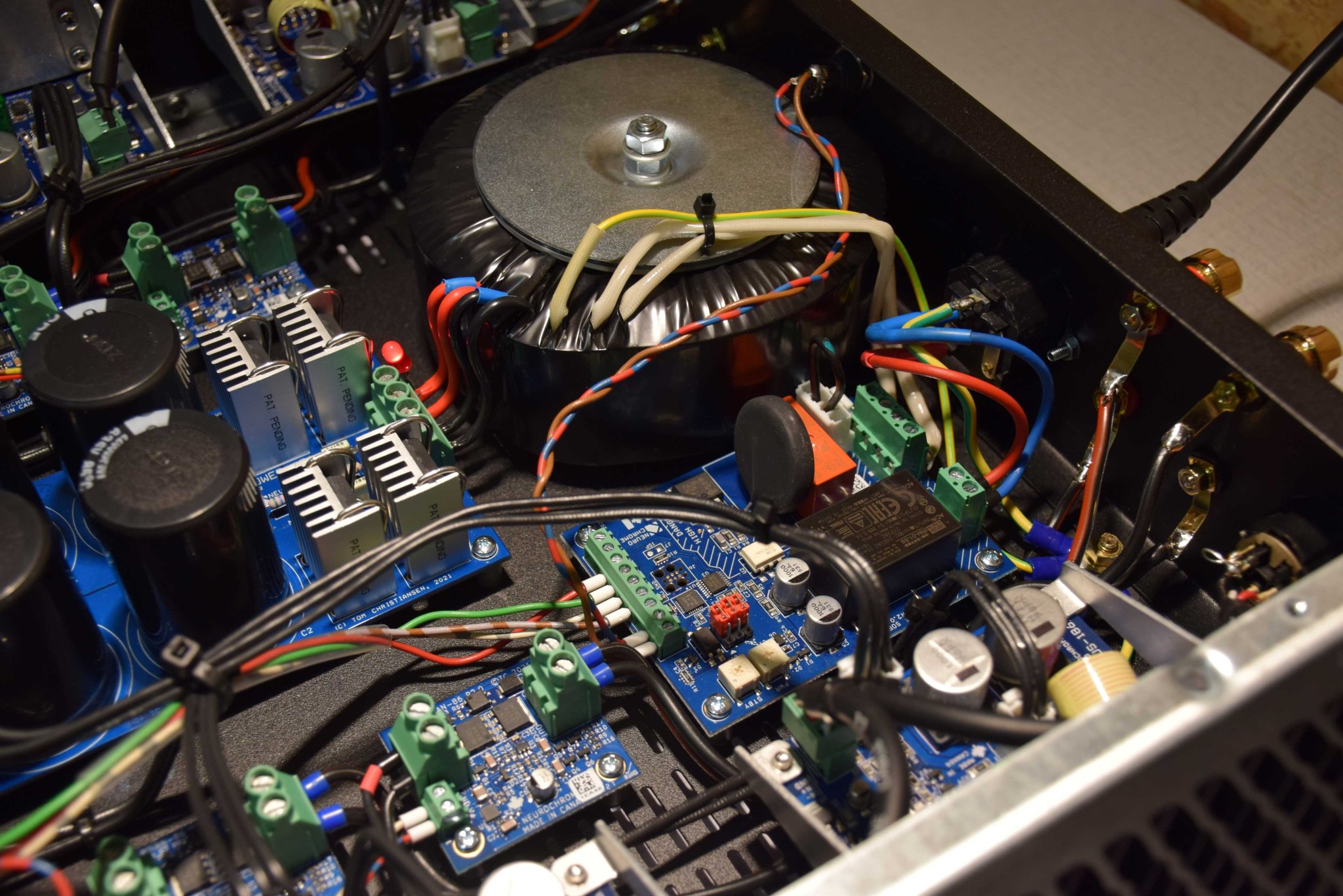

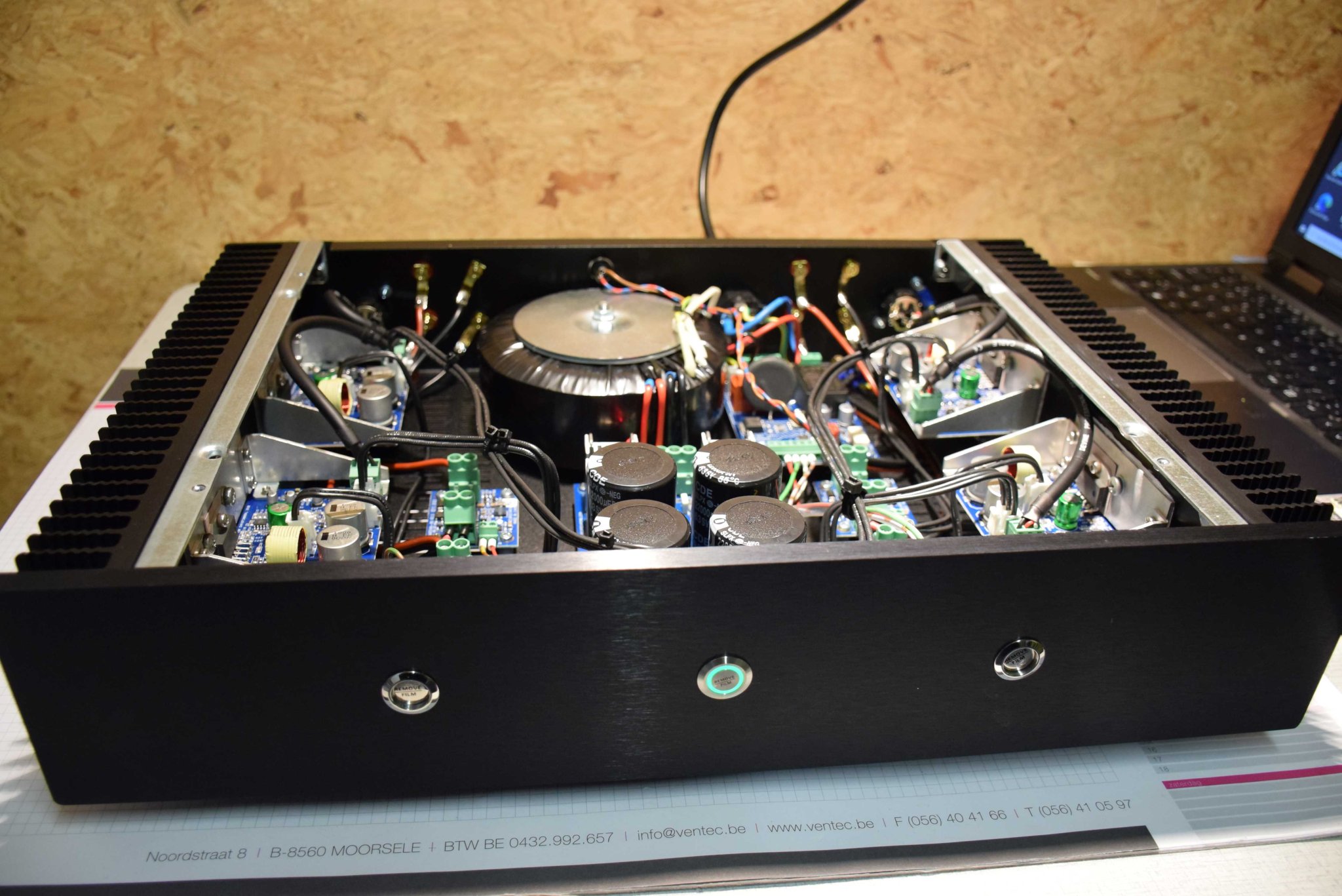

Last friday was the moment for the first listening session with my new build Neurochrome Modulus 186 DS.

As for the build :
Yes, it takes some metalwork skills and tools , a stable drill for the 16mm holes in the frontplate, and a good file and some patience for all connections on the back panel, but pleasure was mine.
Just followed the very well detailled documentation and the Neurochromes videos on YouTube.
Speaker pair selection ( A or B or A+B) is done with 2 DPST-switches ( latching ) on the Guardians input. No clicks or pops at all when powering up ( thanks Tom).

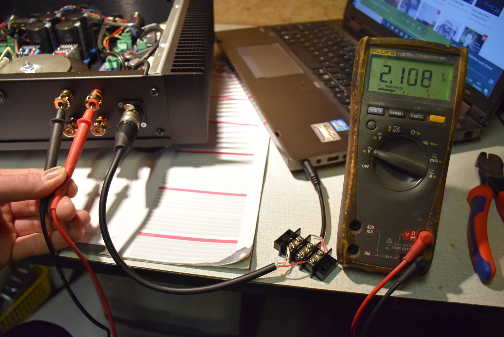

Final test results :
Toroidy Audio Grade 400VA – 2x 22V + Power 686 : +- 32V
DC-Offset (4 modules) : -2.7 / -2.4 / -0.3 / -2.7 mV
Gain ( 400 Hz ) : Input 105.1 mV → Output 2.1 V
Set-up : Laptop - Steinberg UR22mkII – Neurochrome 186 DS – Mezzo Galactica
