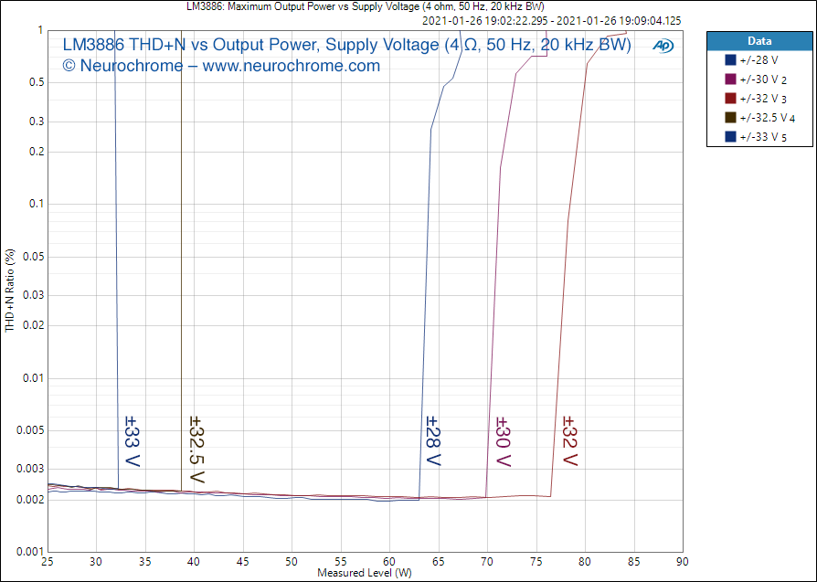

Looks like Connex can do +/- 32 on SMPS800RE. How would modulus 86 perform at that rail driving 4ohm loads?
That's right on the hairy edge. The LM3886 I measured started to show degraded performance at ±32.5-33 V.
I think the Connex has a trimpot on it for adjustment of the output voltage. You could get a ±32 V version and just turn the voltage down a smidge. You might want to double-check with Connex to make sure this is possible.

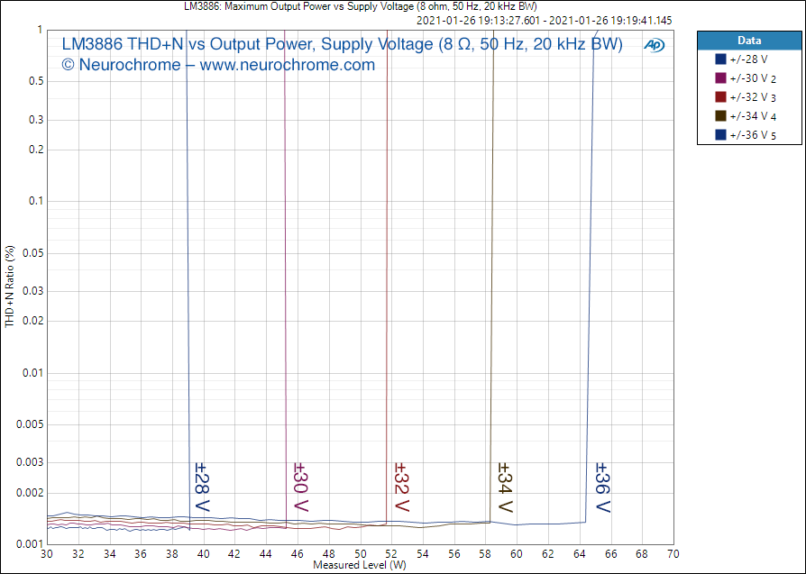

@tomchr Tom, I have a clarification question about Mod86 performance and +/-36VDC supply.
I know the LM3886 will be current limited with +/-36VDC and 4 Ohm load. However, I know I would never use more than 10 watts or so in my normal listening. If the speakers were 4 Ohm (I don't have or use any currently like that), would lower max output affect the performance of the first 10 watts of output? Or is any load at 4 Ohm just not recommended above +/-32 VDC?
The first 10 W is probably OK, but you'll have 3-6 dB lower headroom than you would had you used ±30 V.
Hopefully these two pictures are worth a thousand words each:
A_LM3886_ Maximum Output Power vs Supply Voltage (8 ohm, 50 Hz, 20 kHz BW).png
A_LM3886_ Maximum Output Power vs Supply Voltage (4 ohm, 50 Hz, 20 kHz BW).png
Tom

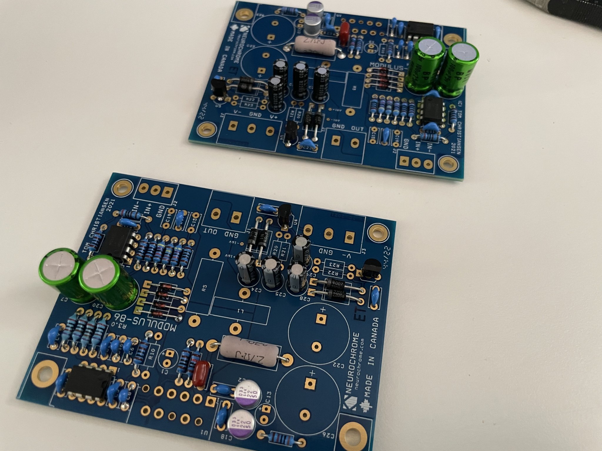

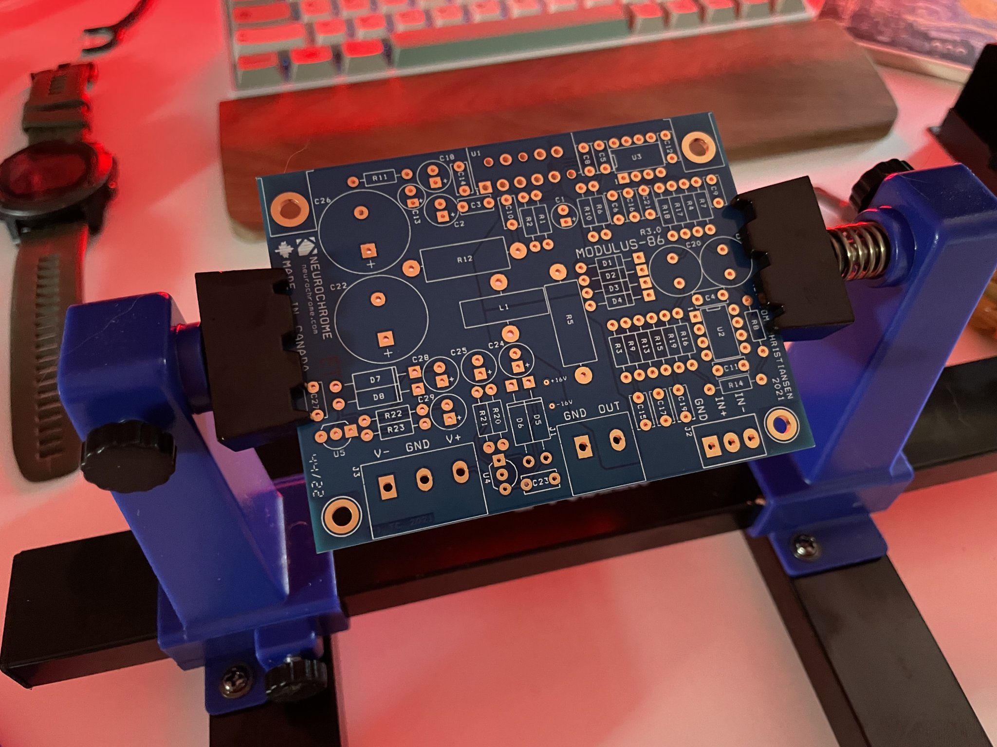

The build is coming along…
Replaced few parts, like
  • input impedance resistors to 47k
  • film type cap for Zobel network
  • Panasonic aluminum organic polymer caps for LM3886 decoupling
  • Upped LM317 and 337 regulator caps to 47uF
Now just waiting for the rest parts in the mail…
Super excited to give this one a listen once it’s done!
