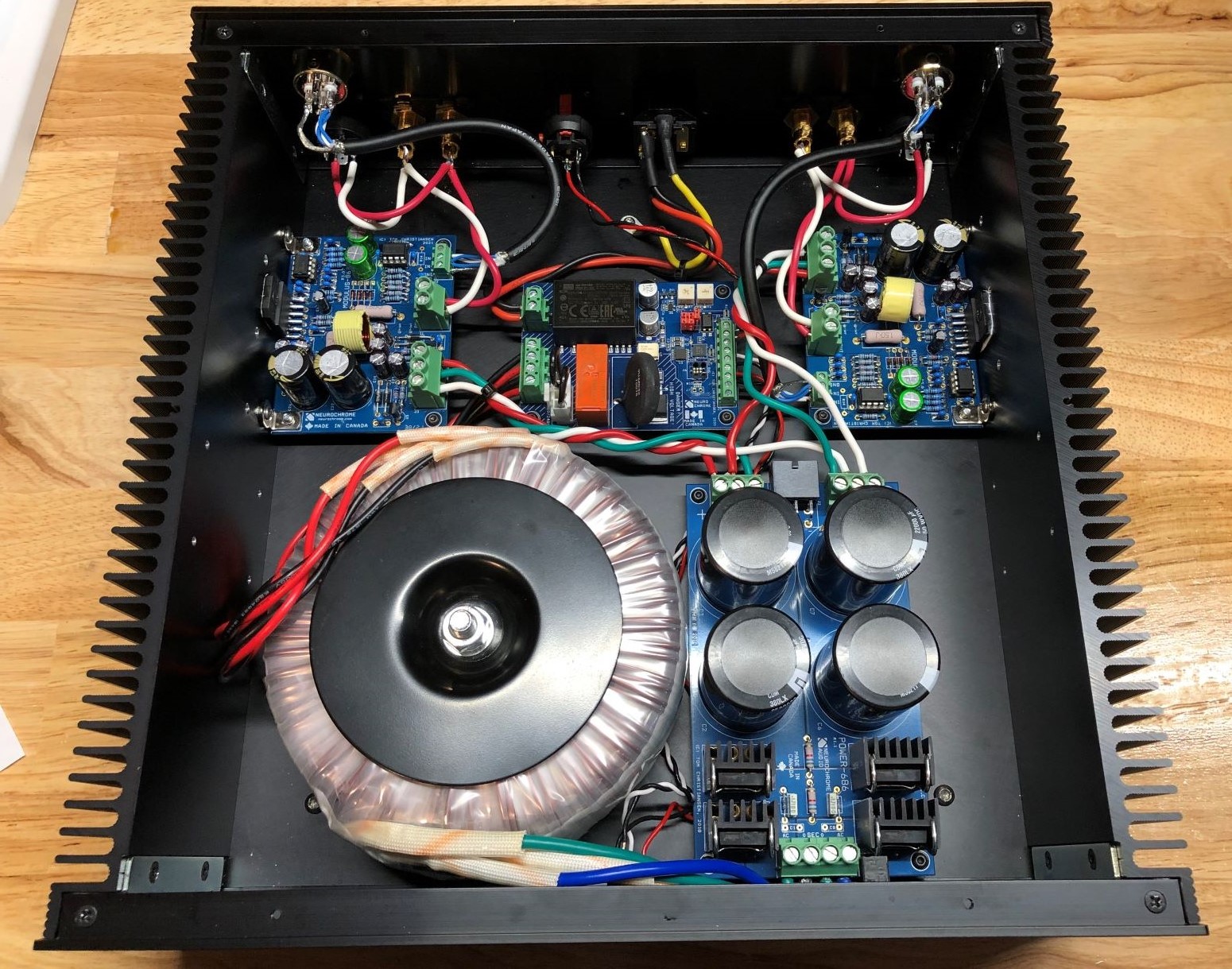

Hi Tom, I got a little tired of the groud loop I had a problem with in my combination First Watt B1 Korg pre and Mod-86. So it was on ice until now. I changed the volum pot in the pre and grounding in the pre as I thought it could be the problem. Then I went the whole way with diodebridge/resistance/cap between signal ground and chassis in the mod-86. The combination of this pre and mod-86 still had problems. The I tried grounding the - ( negative) out (at the phono plug in mod-86) first to chassis and then via diodebridge/resist… etc. The issue dissapered and great music resulted.
It seems that the output of the mod-86 is not grounded at all via the power supply ground as I thought it was, I use plastic print standoffs. So I need to connect one of the minus/ground (1 & 3 are connected at the print as Im using rca phono out and not xlr ) to ground/chassis.
Maybe in the manual page 39 the rca shield should have black dot to illustrate it needs to be grounded to chassis.
I have played a variety of music and the combination B1 Korg ( adjusted to very moderate amount of 2. harmonic) & Mod-86 is great. Im using this on my uppgraded Carlsson OA-51 speakers in our living room. My Altec A5s are out of sight 🙂 in my den in the cellar, look forward to try the combo there.
You may note that in the diagram on page 39 (Rev. 2.4 doc) the power supply ground (i.e., the centre point between the reservoir caps) goes to the same grounding point on the chassis as the mains ground. You need to make that connection with a wire.
I would never rely on standoffs for grounding. Not in an audio circuit anyway. In RF circuits you sometimes have to use standoffs or RF gaskets for grounding.

Hi I do ground the powersupplies, however probably because the B1Korg and the dac Im using use simple switching supplies with no ground connection I need to ground the mod-86 rca out - in this way. But it dosent matter Im happy with the sound 🙂
As long as you're happy life is good. 🙂
I have seen SMPS-powered line-level audio circuits output hum if their chassis wasn't grounded. In my case I ended up grounding the chassis to the RCA input ground. I wonder if that's what's going on for you. Basically by grounding the RCA you end up grounding the Korg chassis and the hum goes away.
