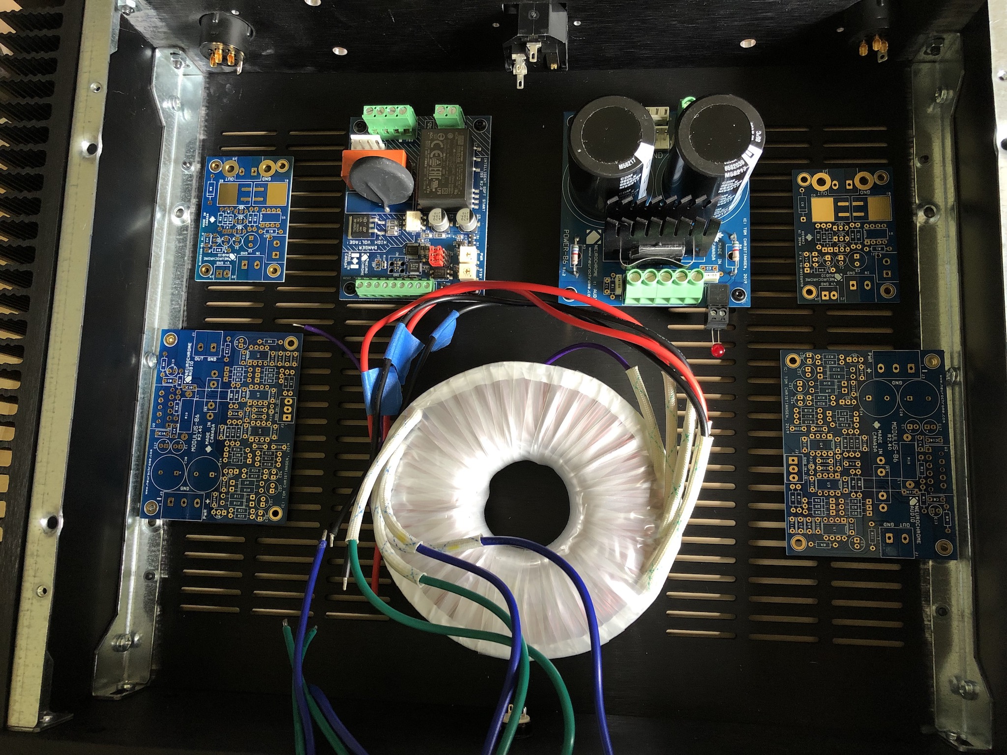

I'd rotate the ISS 180º so the wiring to the transformer can be shortened. And rotate the transformer 180º too for the same reason. Don't forget that you need at least 10 mm standoffs on the ISS for electrical safety.
One trick I like is to mount the Guardian-86 on the heat sink, but what you have will work just fine. That works really well with the Modulus-186 and -286 as each heat sink basically becomes an amplifier + protection circuit module.
Looks good otherwise, though.

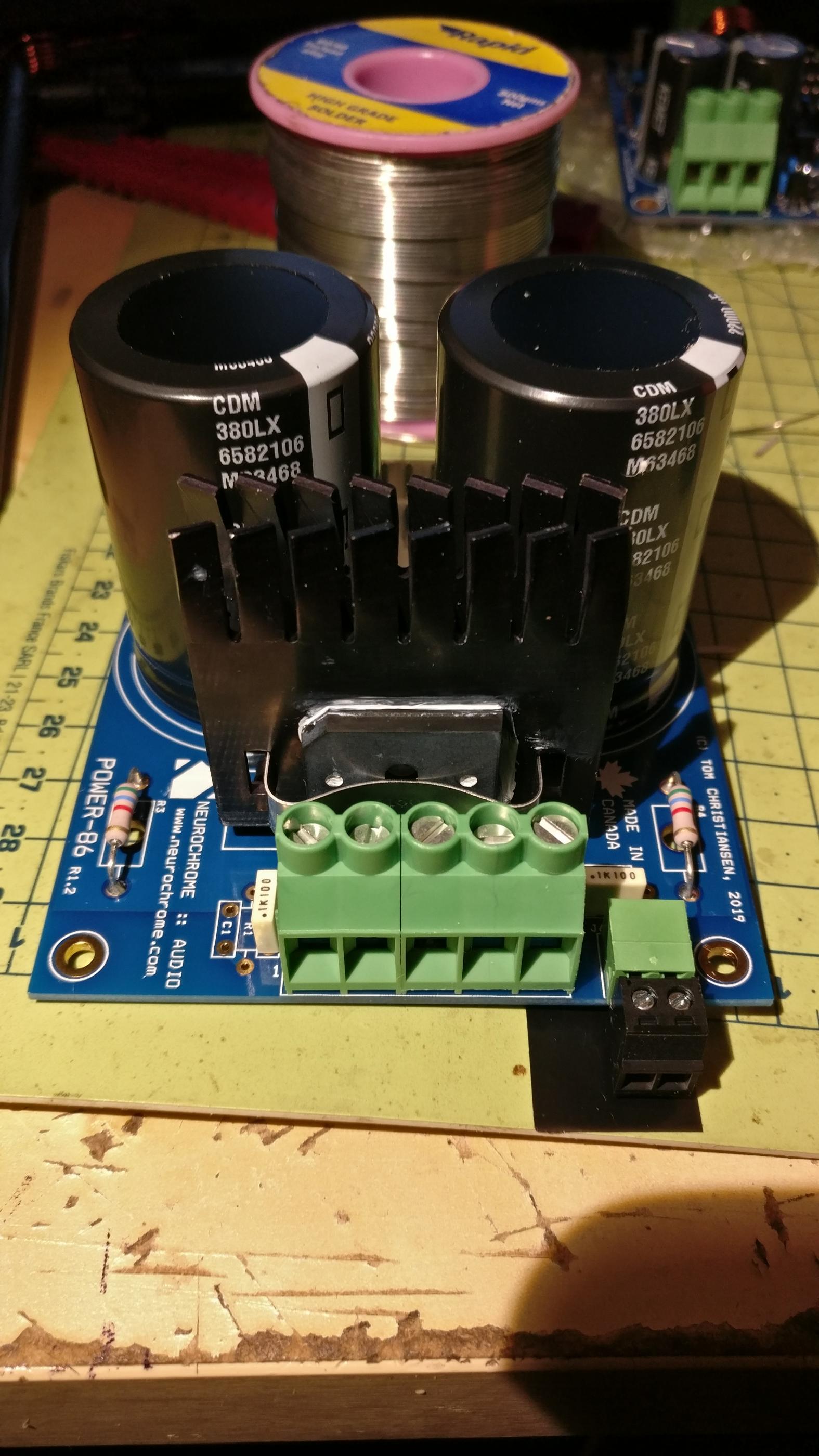

All parts have now arrived, power-86 is assembled. Just the LM3886 are not soldered yet, first I want to mount the boards onto the chassis base with the heatsinks in place to make sure they are positioned correctly.

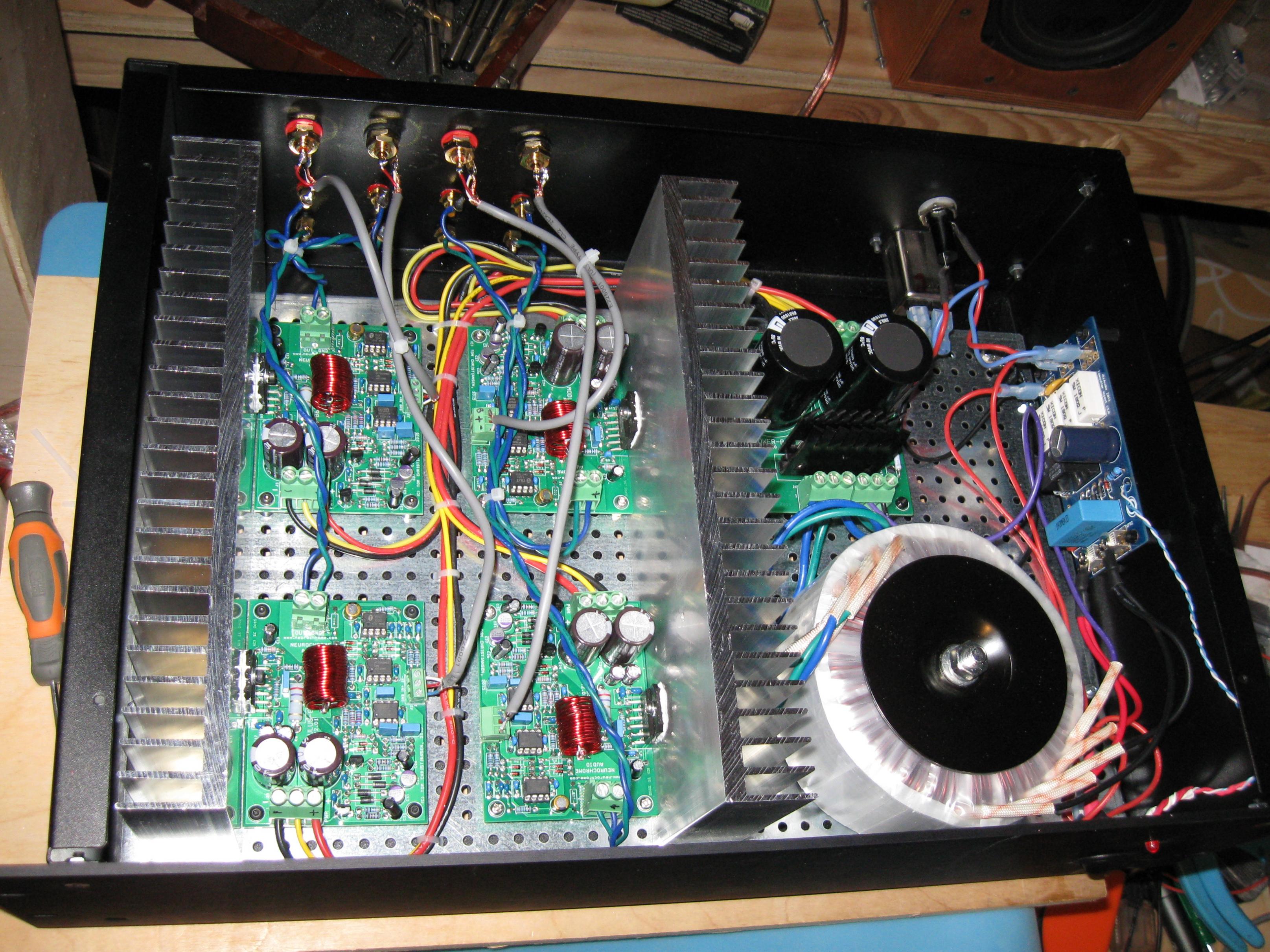

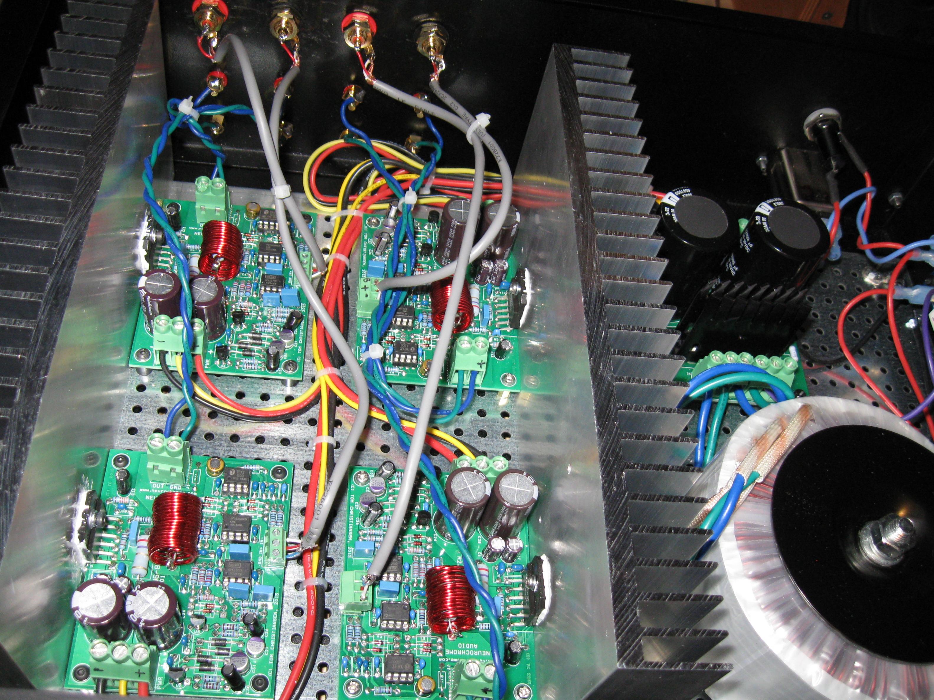

4 CH Mod 86 finished
Just finished a 4 Ch Mod 86 build. Purchased an unstarted kit from another DIY member.

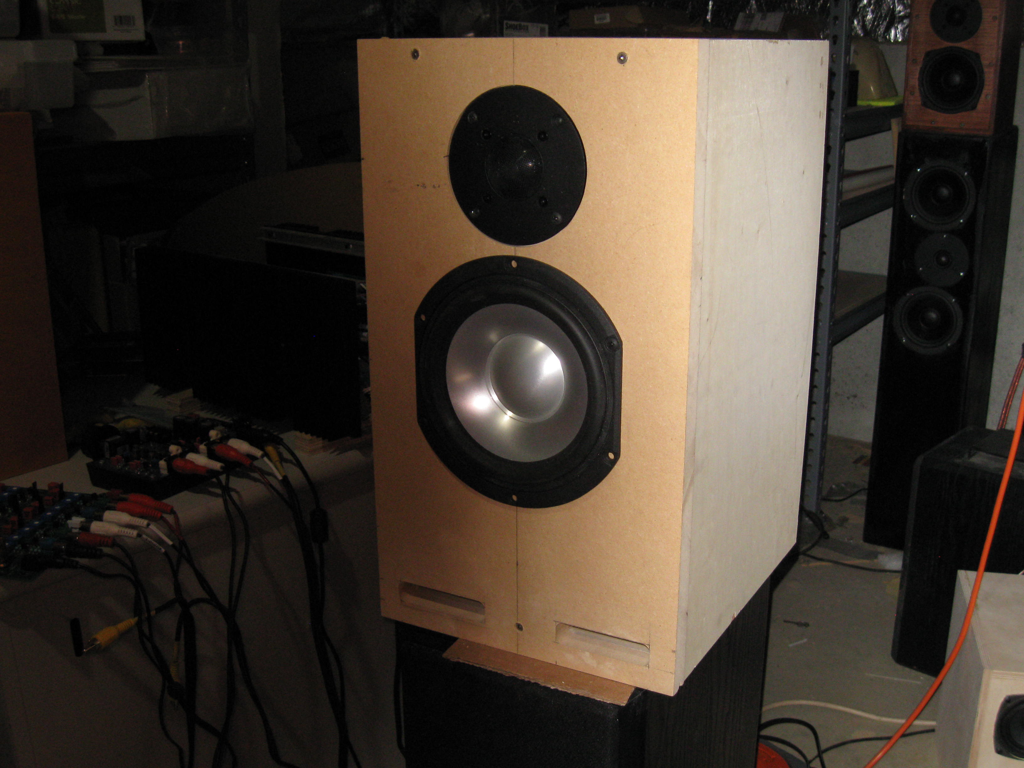

It sounds really sweet. I am using it with a DIY 6-24 BI amp crossover from the store and some speakers of my own design.

Speakers are 2 way with peerless woofer and Dayton tweeter in an 18 liter box with slot ports. If you would like to know more about the speakers I can dig up the design info.

Nice build! It's good to see the older green boards in action. There aren't too many of those around.

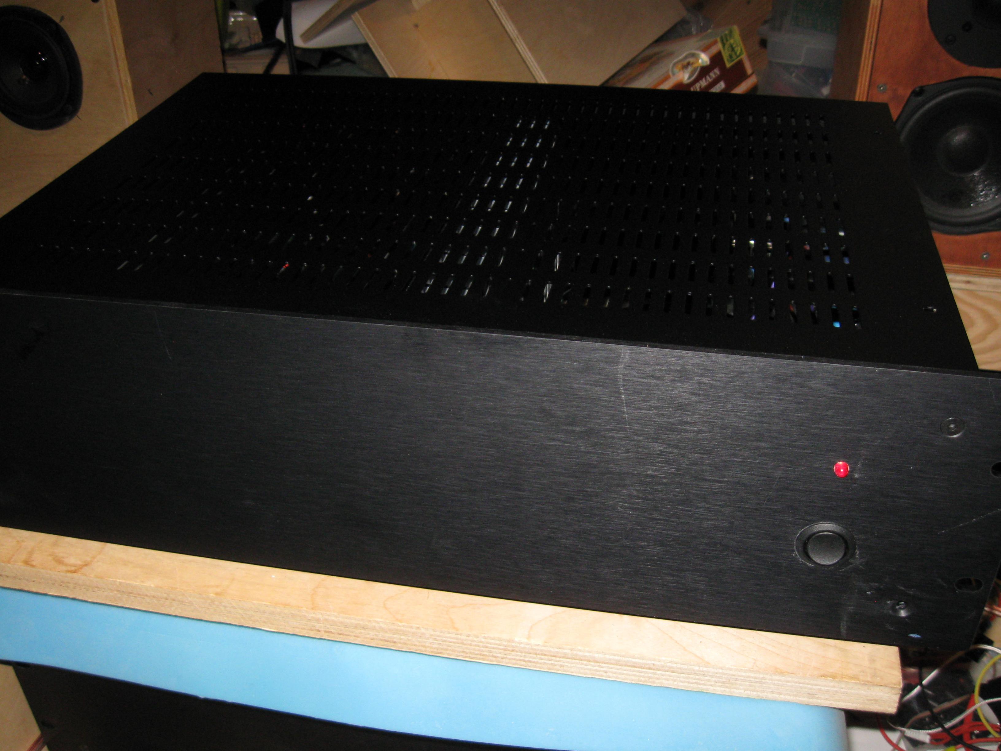

4. I would like to see the amp in and out fully assembled, is that amplifier case available for purchase ? Or at least the front/back panels ?

I'm happy to sell the chassis. It's $449. That's actually below what you'd pay if you were to order one directly from the manufacturer!
