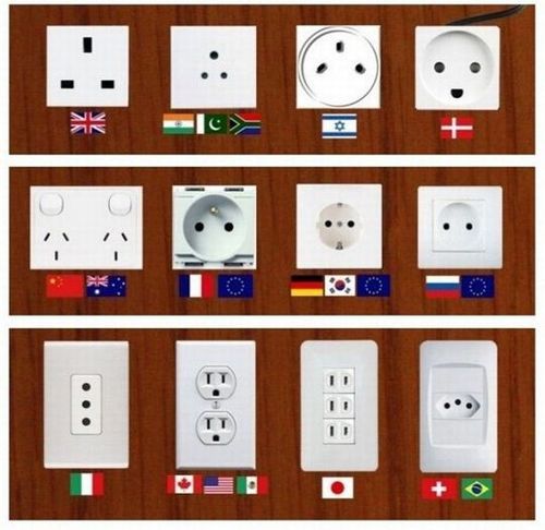

Right, here's a noob question:
The mains input and output of softstart modules and other devices are always marked life and neutral. Here in the UK the mains plugs are designed so you can only plug it into the socket in one direction. The european plugs (Germany) have 2 earth pins and can be plugged in the other way so life and neutral are switched.
So why are life and neutral marked on the boards if they can be switched?
Growing up in Germany we sometimes had mains noises in TVs or radios so you heard a click when the fridge started or a light was turned on or off. Plugging the mains into the socket the other way sometimes fixed the problem.
I'm aware this is a really basic question so feel free to link some wiki pages, I'm happy to read if pushed into the right direction. But i think this might come in handy for the mod86 build.

Correct me if I am wrong, but you do not have a 110 hot and a neutral at the wall in europe, but instead two 110 hots 180º out of phase and a ground.
Is this correct?
David.
Europe (at least Western Europe) uses 3-phase power, so each house is fed three phases and a neutral. Lighting circuits are connected between one phase and neutral and provides 230 V. Circuits for heavier loads (washers, dryers, stoves) use the three phases with 400 V between phases. There's typically a GFCI in the panel that protects the entire house.
In addition there are shaver outlets that have a small (10 VA or something) isolation transformer built-in.
Contrast with North America where each household is fed from a 240 VCT transformer, so two phases of 120 V and a neutral.
Tom
I mark live and neutral on the boards because it is safer to connect the circuit that way. The ISS, for example, switches the live connection while the neutral just goes from input to output.
Some argue that a double-pole switch is required for mains switching in the EU, but that's not entirely true. You can get away with a single pole switch as long as you provide an IEC power inlet and state that the cord must be unplugged before the power is considered to be off.
Tom

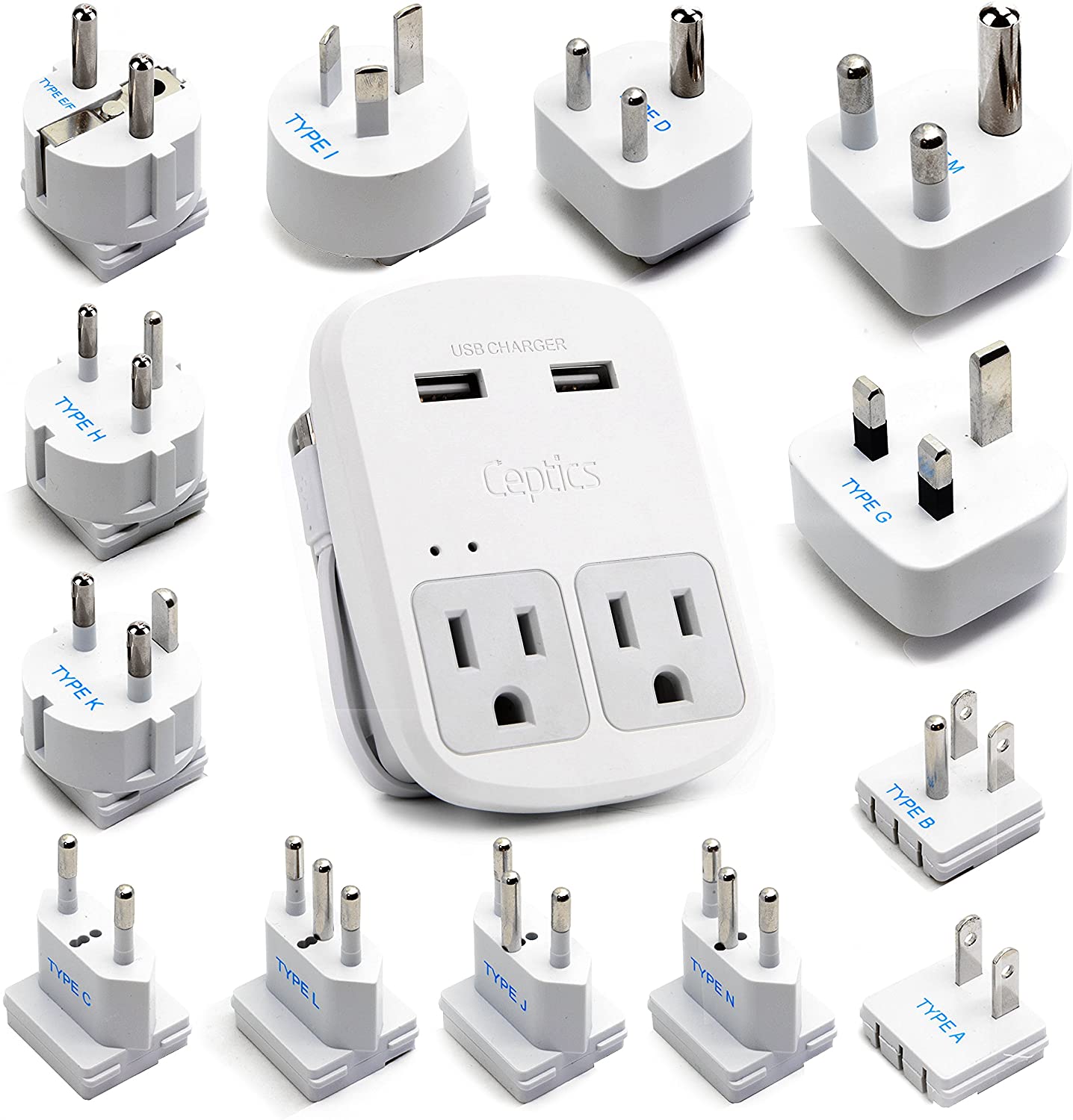

I may be moving back to Germany at some point, I'm tempted to get a few UK sockets installed in my house so one can rely on life and neutral being in the same position. Or at least mark life and neutral on the existing sockets.
Oh man this AC stuff is not making much sense to me yet. I wish I my interest would have been there 20 years earlier.
Live and neutral should still be in the same spots on the German outlets. At least the outlets I grew up with in Denmark were clearly marked on the back with P (phase) and N (neutral).
More current installations use a 3-prong outlet. The Danish one has three prongs on the plug. Some EU countries - including Germany - use two-prong plugs with a ground connection on the outside of the plug. Other EU countries use a two-prong plug with a hole for a ground prong that sticks out of the socket.
At least now that the UK is out of the EU, all of EU is now 230 V mains voltage. The UK maintained their 240 V even though everybody else harmonized to 230 V. Most of Europe used to be 220 V.
Note that the electronics (usually) don't care about live and neutral. Getting live and neutral connected correctly is mainly a safety thing. There are some cases where the neutral is connected to the secondary of an SMPS with a capacitor to reduce noise. I would think that for those cases, you do need to get the live and neutral connected correctly for the equipment to pass the EMC requirements.
Tom

The German plugs look like the one in the top left corner of your 2nd picture and they can be plugged in both ways 180° turned. Like the UK shaver outlets with only 2 pins. The earth pin is on both sides of the plug.
No worries, my brother in law is a physics teacher. I'll have to get him to put me through year 10 again. 😀
