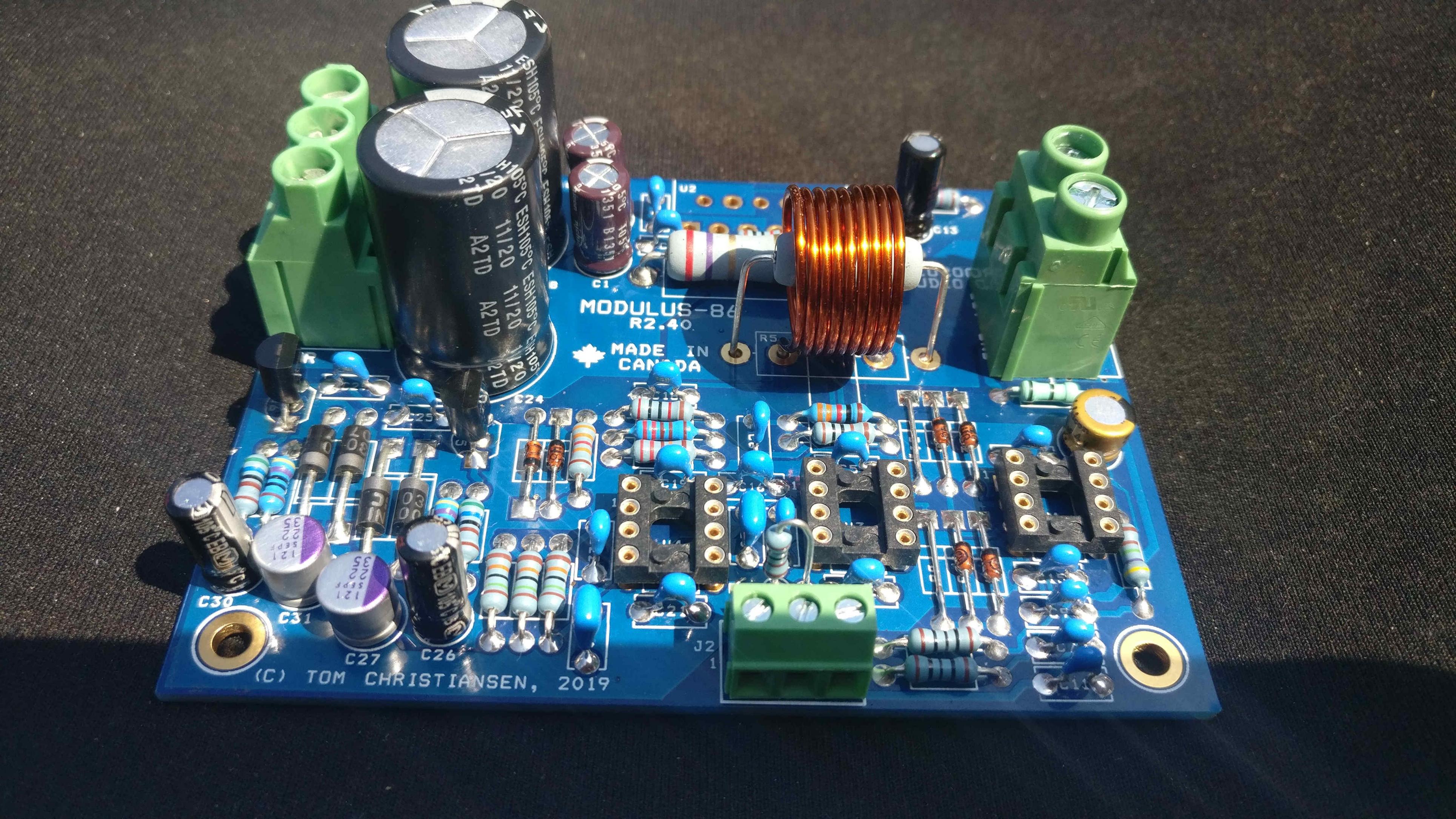

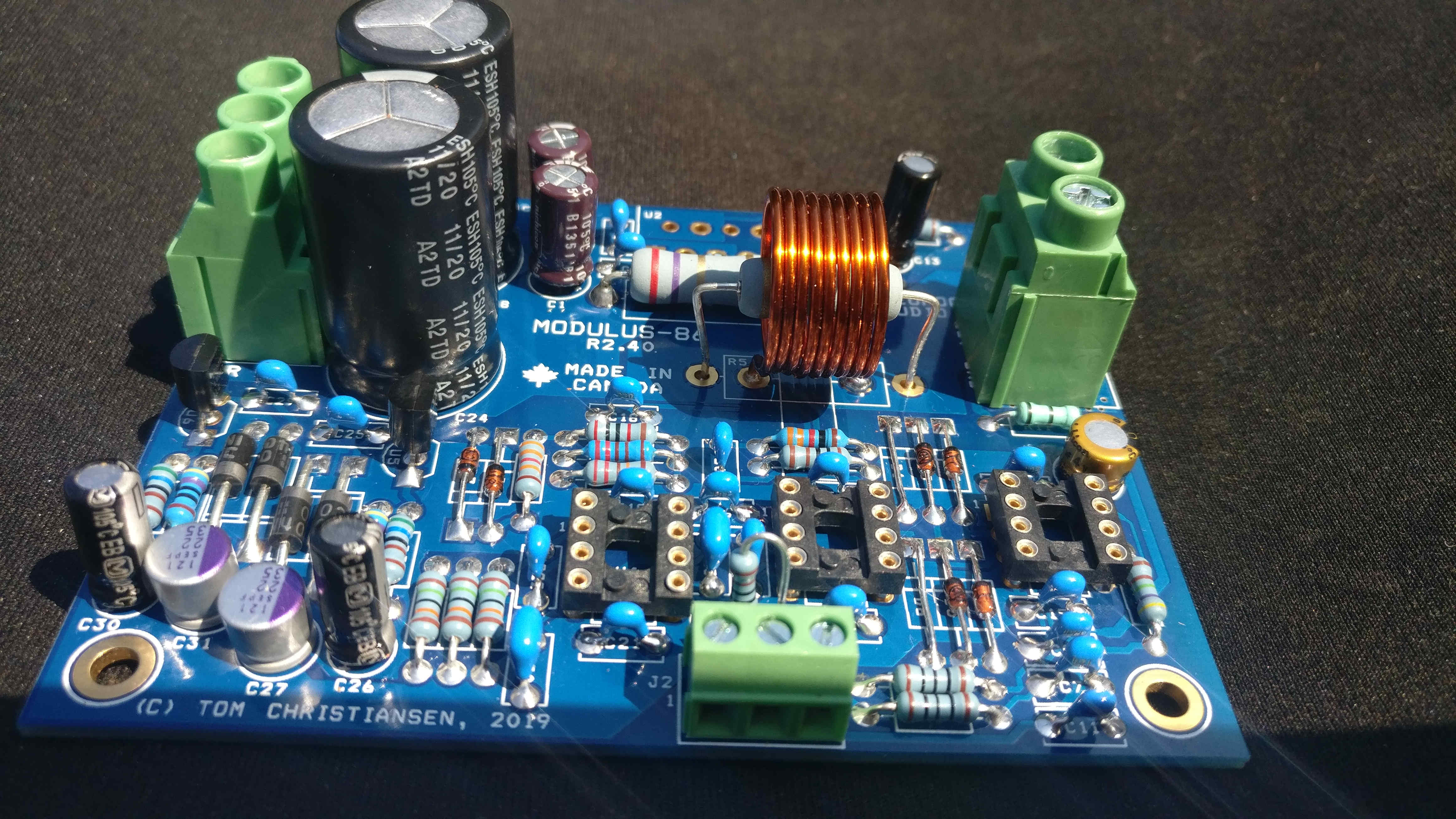

Progress!
Made some progress, just a 180pF cap and the LM3886 missing.

There absolutely is a checklist. See page 31 of the design doc. (MOD86 Rev. 2.4) 😉
Tom
Hi Tom,
I hope you're not reading this before you return from your camping trip!
You must be thinking I'm not reading the documentation but I am! The procedures described in your last post and in the documentation are a bit hardcore for me at the moment. I'm slowly beginning to understand the transformer / power supply / amp relation but there are lots of missing basics for a person who exclusively played with DC circuits in the past. I just ordered the Power-86 board and from the documentation I hope to get more info that helps me to fill some of the blanks.
I've seen some posts about limiting current with a light bulb and have to find an idiot proof procedure so connecting it to the mains won't be the last thing I do. Any device with capacitors that size require to be handled differently once charged. And my nerves are not strong enough to just discharge capacitors with a screwdriver shaft (as seen on youtube).
Stefan
I camp in areas that are outside of cellphone range, so I have no data connection. That's by design. As soon as the data connection is there, so is the temptation to check email. I find that a couple of days without internet access does wonders for my mental state.
The term Big Bang Testing often comes to mind for me when powering up an amp the first time. It's a term I borrowed from software development, where Big Bang Testing refers to writing all the code before testing it. It's a recipe for failure.
Rather, software development uses unit testing (and other methodologies). Basically, each module is tested before it's linked to the other modules and the whole system is tested.
I think we can borrow that and apply it to hardware engineering as well. Here's how:
First connect the transformer primary to the ISS (if applicable) or mains inlet. Then connect the secondary to the Power-86/686 board. Connect your power switch and standby/on indicator(s) to the ISS (if applicable). Now verify that you can turn the power on/off with the power switch. Verify that you get about ±30-32 V on the output of the power supply. The voltage will be a bit high because the supply is not loaded.
Turn the power off and wait for the power supply caps to discharge. Do *NOT* use a screwdriver to short the caps. First off, it's not necessary as there are two bleeder resistors on the Power-86/686 which will discharge the caps and, secondly, because it's really hard both on the caps and on the screwdriver. Note that you need the LED fitted on the Power-86/686 in order for the bleeders to work. If you don't like the LED, you need to connect the two terminals on the LED connector with a piece of wire to allow the bleeders to do their job.
Once the supply has discharged to below, say, ±5 V connect the amp modules. Be careful with the polarity as reverse polarity will destroy most of the silicon on the boards.
Power up again and test the DC offset and gain as outlined above.
Light bulb testers can be handy in case you have a short-circuited power supply or a mis-wired mains transformer. I personally don't use one. I just use a fused IEC inlet and rely on the fuse to do its job if I mis-wire something.
Tom
