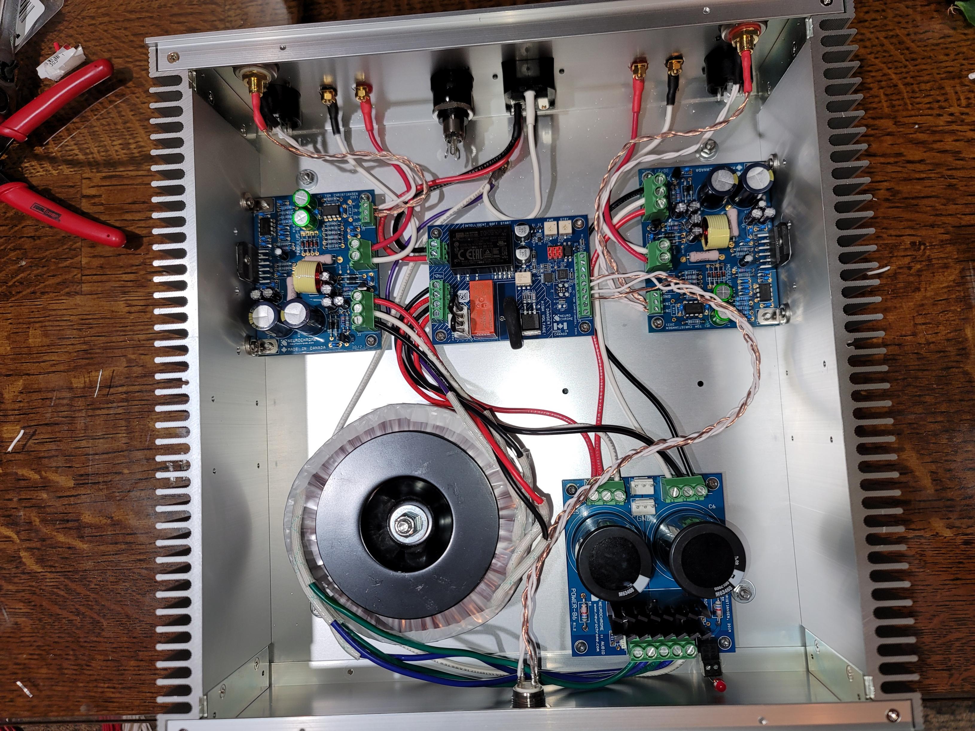

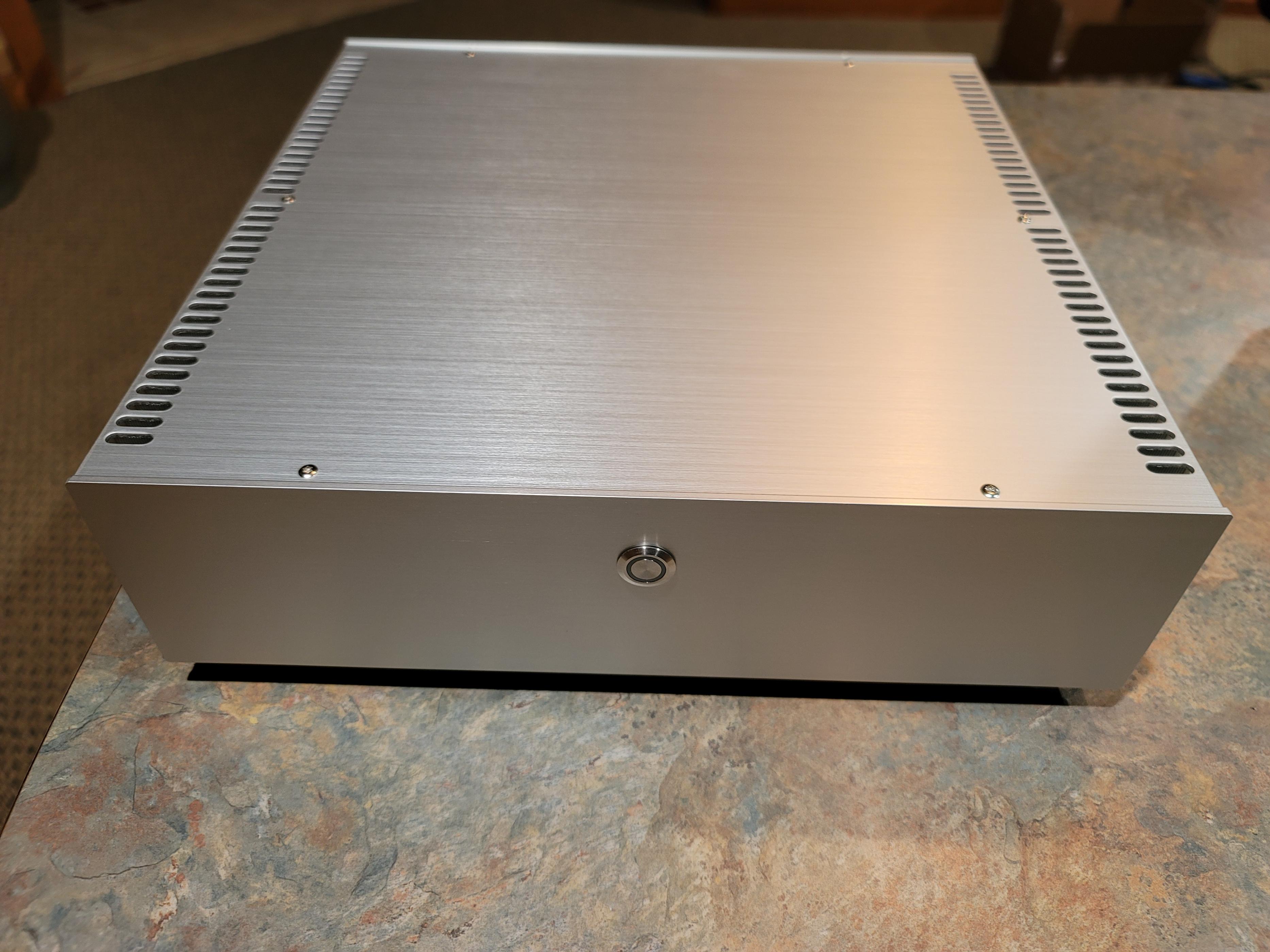

New Mod 86 build from a newbie
Hello, I'm new to this site but spend quite a bit of time over on Audiocircle. I ran across a post from mkrawcz over there discussing how good some of the chip amps were. I was considering the Folsom 7293, but felt that the documentation was probably a little too spartan for someone with limited electronics knowledge to complete. Mkrawcz encouraged me to try the Neurochrome Mod 86 v3 - so I did!
Tom over at Neurochrome was fantastic to deal with. I probably exchanged around 30 emails with him from start to finish regarding what I needed to order, where to get substitute parts, and a few questions on the build itself. He was very patient with me and I was able to complete this build having very little electronics knowledge and not a huge understanding of how the amp actually works.
The chassis he sells is very high quality and looks nice as well as provides for a very tidy build. The sound of this little amp is fantastic!! I'm using it on some GR Research NX-Treme's and it sounds every bit as good (if not better) than the $4600 Primaluna Evo 300 that I also have.
Thanks Tom and mkrawcz for your help and I'd encourage anyone to give it a try if you're looking for a fun build and excellent sound.

I think this is the first documented Modulus-86 Rev. 3.0 build. Nice work. Thank you for sharing.
Personally I would have put the power switch on the bottom, but I guess it's up to you. 🙂
I will have these chassis listed on my website before too long (hopefully). I'd probably sell more if I actually had them listed.
Tom
Thanks again for all your help with this Tom. It was a fantastic experience from start to finish building this amp. I have a relative who likes it enough that he is considering going with the 286 or 686.
I don't spend much time on this forum as I said - so I had no idea this was the first documented build. I saw there were 574 pages and I assumed there were dozens if not more already documented. Must be previous versions.
Since this must be one of the first ones built with the new revision I guess I'll say a little bit more about the sound. The amp sounds really fantastic. I compared it to the PrimaLuna Evo 300 and also a Lyngdorf TDAI-2170. The Mod86 doesn't have the "warmth" of the PL - but it is very natural sounding. It is also cleaner, tighter, and faster than the PL with a dead silent background. For the most part I would say that I prefer vocals and string instruments on the PL and for everything else I prefer the Mod86.
The Lyngdorf has always been one of my favorite pieces of gear, but for whatever reason it just doesn't speak to me with the new NX-Treme speakers. I was pretty startled to find that I preferred the sound of the Mod86 over the Lyngdorf in every way. Not by a huge margin, but enough to be noticeable.
I have a Doge 8 tube preamp arriving tomorrow and I plan to pair that with the Mod86 to see how much that tweaks the sound.
Tom - one suggestion I would have if you ever make a revision on the chassis design - I would separate the binding posts a little more - they are very close together. I actually had a bit of a scare when I was breaking in the amp - I came downstairs and nothing was playing from the right channel. I checked and the weight of my speaker cable had rotated the spades enough that they were touching. I fixed the cables, turned it off and back on - still nothing. I unplugged it, opened up the case and couldn't see anything that looked fried, so I hooked it back up and miraculously it worked and has been ever since. A further separation of the binding posts of even 6mm or so would have prevented that from happening. Now I'm more careful with it and plan to switch to the SpeakOn connectors when I have a chance to terminate some new cables.
