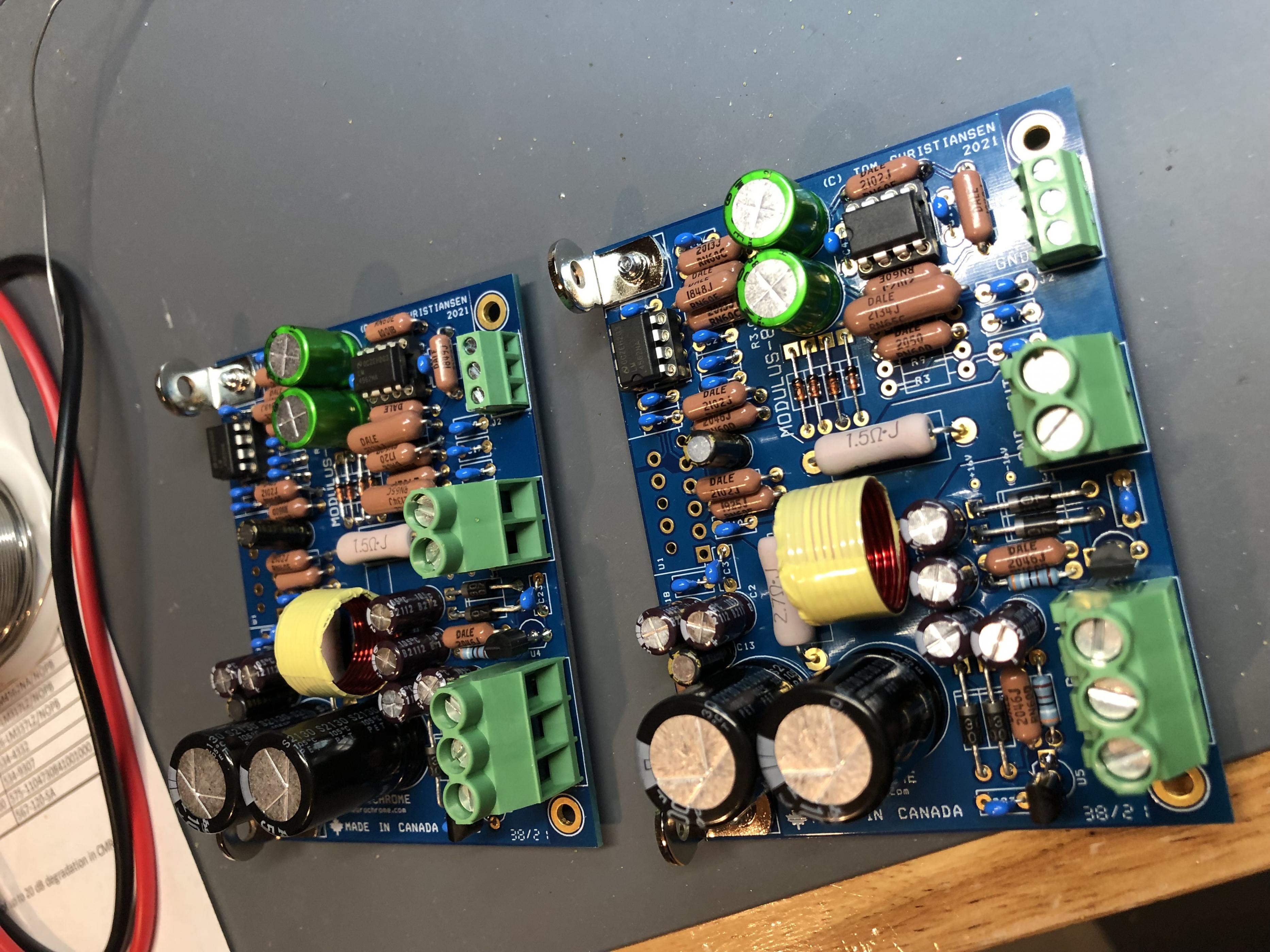

I decided to play around and build another set of mod86 boards. I was curious if Vishay-Dale resistors would yield and improvement in sound quality, and they did. There is even more clarity. Not sure why, it could be that they are lower noise, or that they have no magnetic metals unlike the KOA Speers, or the fact that the values I ordered all measured almost perfectly.

vendor for Vishay-Dale?
Mouser, Digi-Key, or Parts Connexion, or other smaller boutique supplier?
Which model did you use? Vishay/Dale have so many lines: 1%, 5% MF, wire wound inductive, wire wound non-inductive, etc.
All information will be very much appreciated to help me source resistors.
