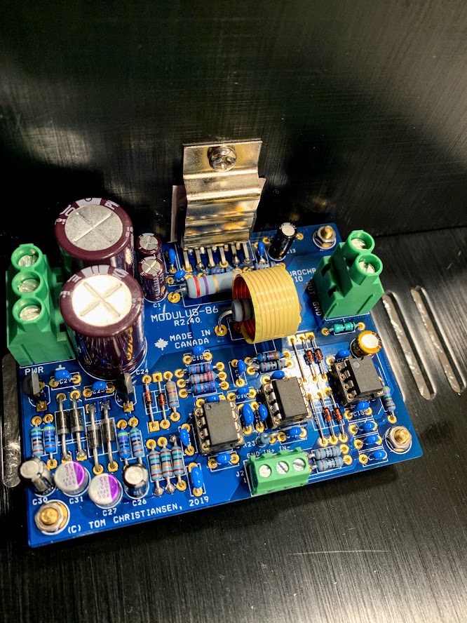

I've been working on the build for a while and finally got to power it up. One channel works fine and the DC offset goes to 0. The other channel on the other hand is not working properly. The DC offset is around 5V which is not good.
I checked and rechecked all the solder joints, the top and bottom of the board, compared everything between the working on non working channel making sure the capacitors, diodes and everything else are put on correctly and everything seems to check out so I'm at a loss as to what is going on.
on the non-working channel, the LM3886 gets real hot. Even R10 gets really hot, like blimey hot. D2 and D5 are measuring 12.5v and D3 and D4 are measuring 15.5V - 16V. Those are different than the working channel.
What do you think might be going on?

I agree. 5 V offset is pathetic. Let's figure out what's going on. Gross errors like that are usually caused by a bad solder joint, accidental part swap, or by an IC pin that didn't make it into the socket. I've seen cases where the IC pin curled up under the IC and didn't get into the socket.
Sounds like you have some oscillation going on. It looks like R1 has been damaged. At least the enamel has cracked and flaked off in one end. That could set the LM3886 up for oscillation, so I suggest replacing that.

To start, I'd measure the "±15 V" supply. You should have around ±15 - ±18 V on those supplies. You can find them on the OPA2277 (pin 4 should be about -16.5 V and pin 8 should be about +16.5 V). You will have some variation due to component tolerances and such, but the voltage should be within the ±15 to ±18 V range.

I checked the solder joints top and bottom and re-soldered many of them just in case and it's still running hot. I checked all the resistors and they seem to match the working board but i also noticed R1 looking chipped or something so I'll replace that. I'll also try pulling out the opamps and re-seating them and see if that works, check the voltages, etc/

You can power up the board with all the opamps removed, actually. If that works, the error is somewhere in the small-signal portion of the board (i.e. among the opamps and associated components). With all the opamps removed, you should have below 100 mV of DC offset on the amp output.

I followed Tom's instructions to pull out the op-amps and after doing that, the problem was gone. I then put them back in and removed them one by one to isolate which one it was. After figuring that out, I figured it had to something around the opamp. From the very beginning of the build, I told myself if I made any mistake, it would be that I put one of the blue capacitors in the wrong place. They are so tiny and hard to read and therefore would be the hardest to troubleshoot. I pulled out the magnifying glass and headlamp and started inspecting each one . C6 ended up being some random capacitor that didn't match anything else in the entire build. So I would like to think that Mouser just put the wrong one in the bag but the truth is that I probably made the mistake.
After replacing it, the amp fired up perfectly.

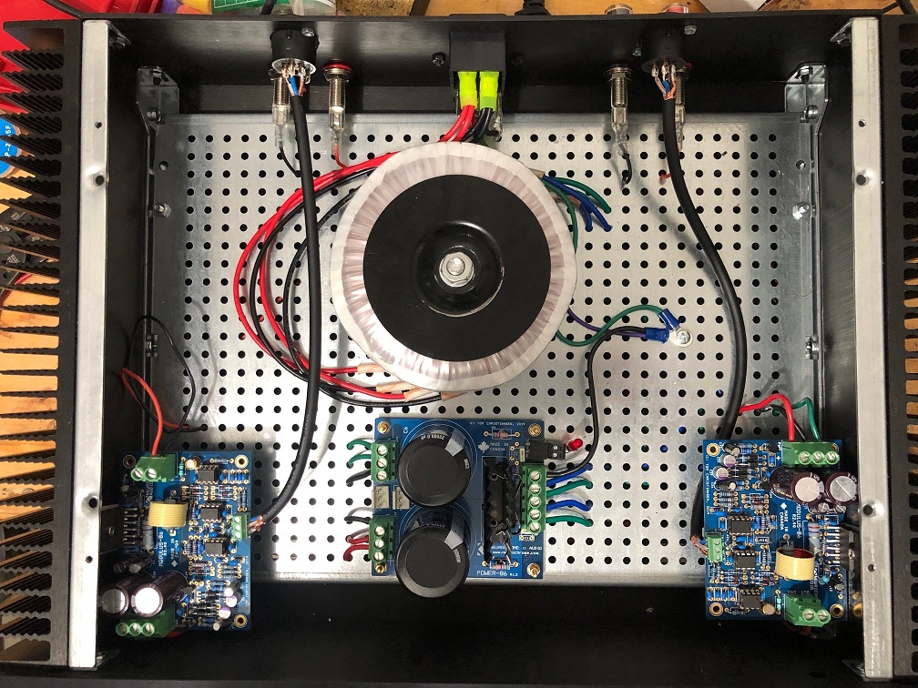

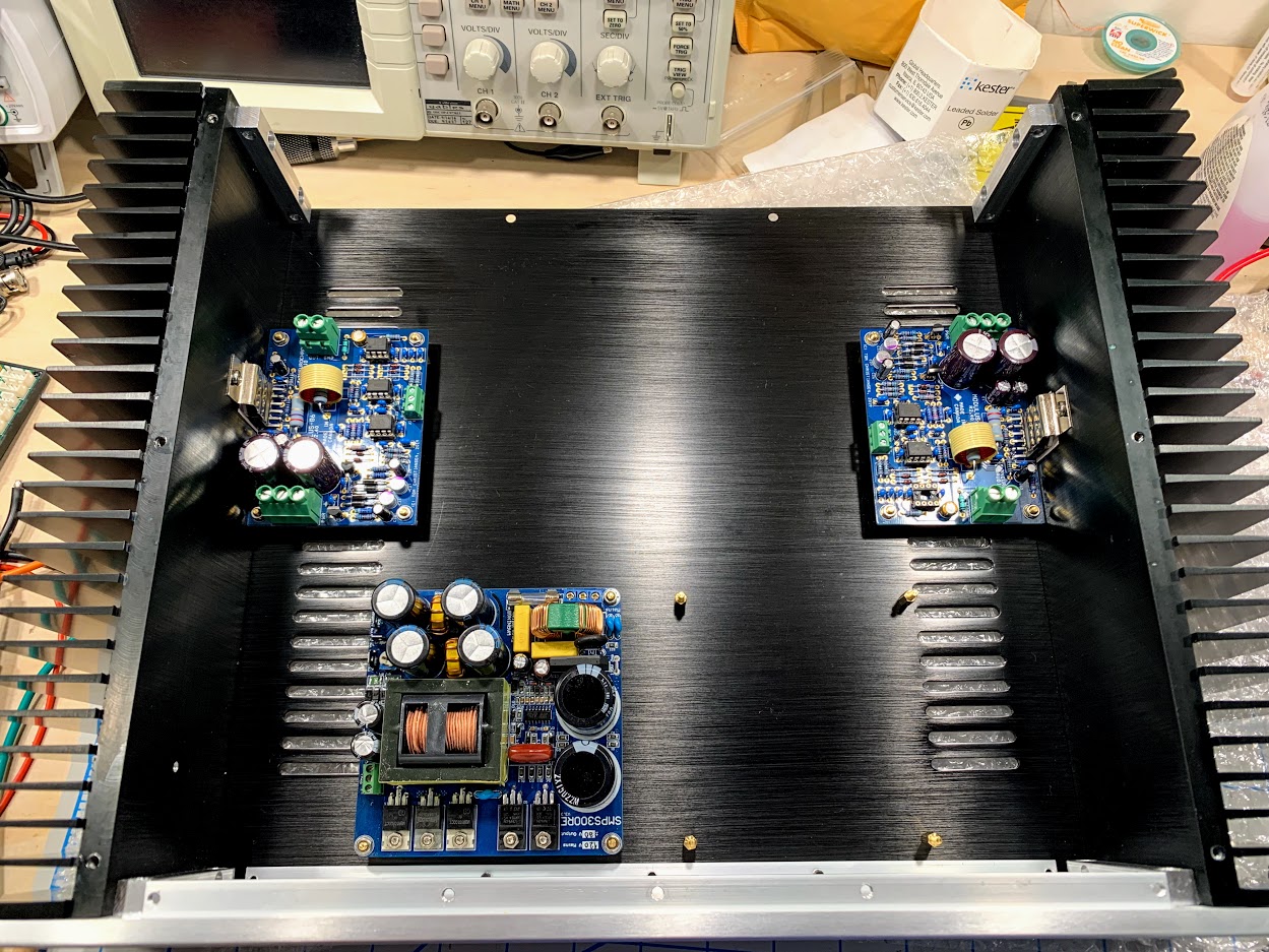

I used the 2U Dissapante and had them cut the holes on the rear panel. I created the CAD design which was a first for me and I didn't screw it up so was happy about that. I went with the larger chassis in case I ever wanted to add more channels in the future.
