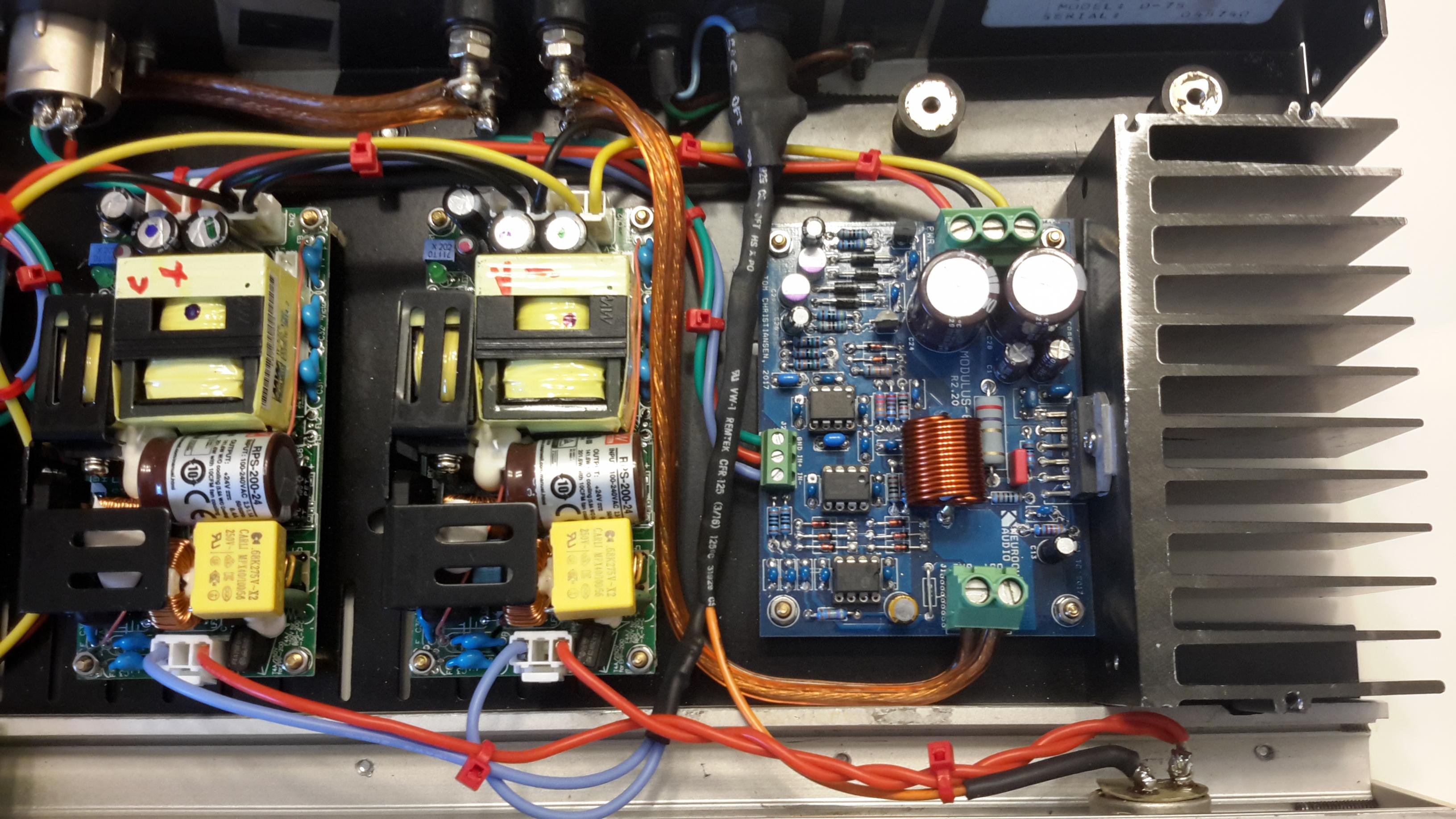

RPS 200 Power Supplies
I built one dual Mod-86 powered by Mean well RPS-200-24 power supplies, and a quad Mod-86 powered by mean well RPS-400-27 power supplies. The RPS-200 run much cooler than the RPS-400. Both systems are able to run at high volume with out any power supply issues. Best regards.
Very cool!! Thank you for sharing. I really like Mean Well. Their products are well spec'd and meet their specs. I've also had the opportunity to deal directly with their customer support / applications team. They respond within 12-24 hours even to a small company like me, and respond to questions that many others would ignore, such as "which temperature sensor do you use?".
It's good to hear that the RPS-200 is useful for the MOD86.
BTW: If you get the chance, I'd suggest adding some heat shrink on the connections for the mains switch.
Tom
