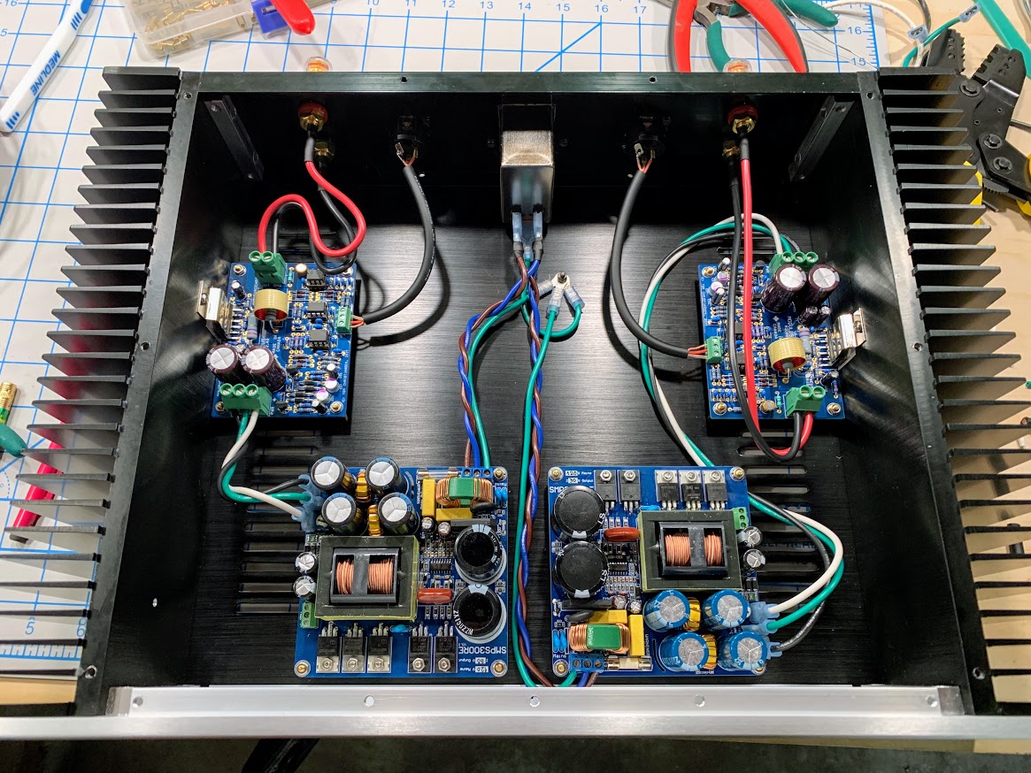

I finished my build yesterday and spent the day running music through it. Very impressive Tom! Like others have said, its dead quiet with no music playing and sounds fantastic. I'm the worst at describing how things sound but I'll try. Everything sounds so clean and effortless. I think this is as close as I've been to achieving the "wire with gain". My speakers are Klipsch RP-600M's (96dB sensitivity) so the amp has an easy job driving them.
I know that building it dual mono is totally overkill but it let's me sleep better at night. Pretty sure the SMPS is happier and will probably last longer with such an easy load. Thanks again Tom for your fantastic design. If anyone reading this is on the fence about building the Mod86, just do it! It's the best amplifier I've ever had.
pelayostyle,
Neat build you got there! And yes, the dual SMPS is overkill 🙂, nonetheless nicely done.

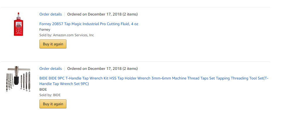

I used the 2U Dissapante and had them cut the holes on the rear panel. I created the CAD design which was a first for me and I didn't screw it up so was happy about that. I went with the larger chassis in case I ever wanted to add more channels in the future.
How was drilling the mounting holes in the riser plate/heatsinks? Building mine into a pair of 3u dissipantes, I know it's super overkill but I'm eventually going for a full LX521 build.
It was really easy for me. I bought some cheap tool off amazon to drill the hole then tap the thread. So far its worked every time using M3 thread size however i question how durable this tool will be over the long run. Based on how often I need to use the tool, it works for me just fine.
Here is a picture of the exact tool I bought and the lube.
