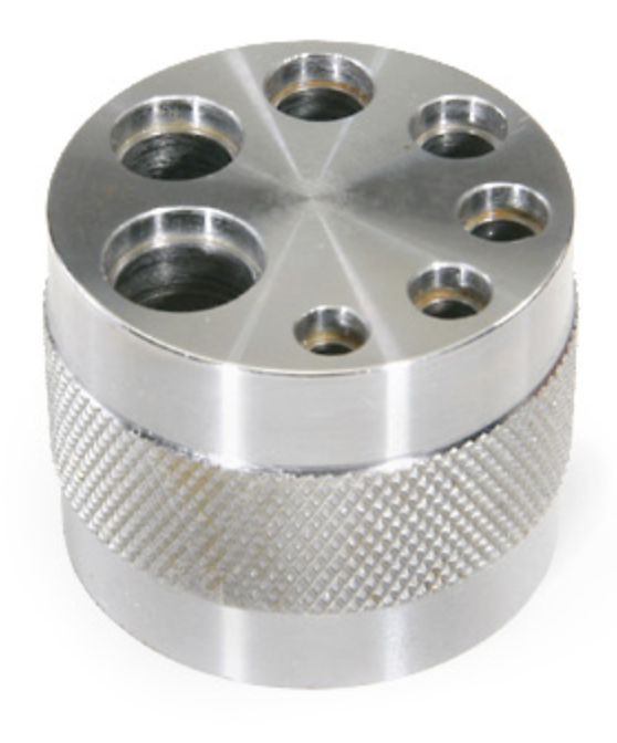

Well... It depends. If you plan to drill straight through the heat sink, it doesn't really matter. However, if you plan to drill blind holes, I recommend using bottoming taps. And be careful... Learn to feel the difference between the cutting action and the bottoming out of the tap. You really don't want the tap to break as you will never get it out.
Should you be so unfortunate to have a tap break in the heat sink, your best bet is to grind the stump down so it doesn't protrude from the heat sink, turning the heat sink 180º and starting over. At least that works as long as your holes aren't on the centre line. If you use sharp taps, cutting fluid, and the appropriate drill size, you should be fine.
I also highly recommend using a tapping block. You can make on easily if you have a chunk of hardwood or metal and a drill press.

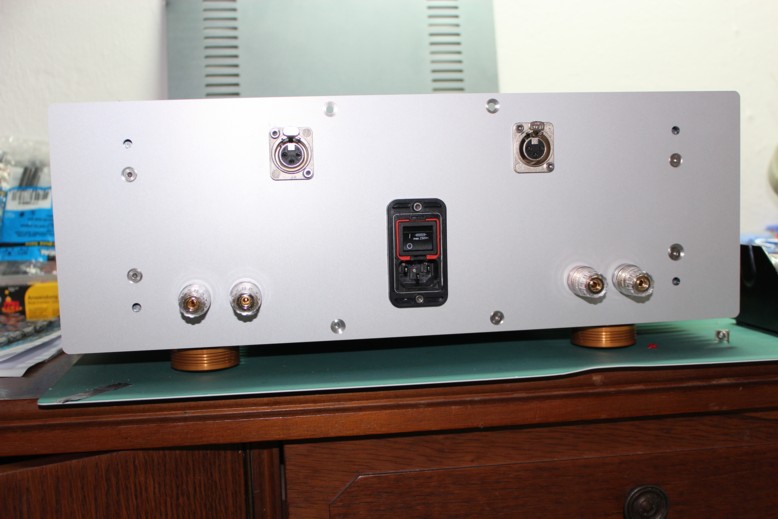

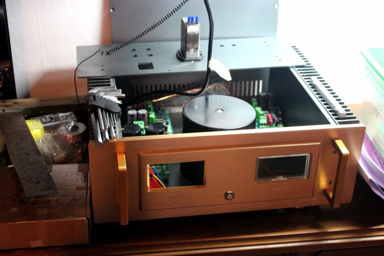

Well Tom, my friend, I know it seems like it's been forever since I bought those boards from you, but I'm here to announce that the PARALLEL-86 LIVES!!!
Sorry about the name on the front of the case, but it was Chinese surplus.
I got two of these; one down, and one to go. Four channels total. They'll be used on the Linkwitz LXmini.
This is only my second amp build. Scrabbled together a MOSFET job back in 2011 and 2012. Unfortunately, was forced to leave it back home in the USA when I ventured across the Big Pond in 2014 to help care for elderly relatives.
Because my first effort was so junky inside I was simply determined to take my time and make this one look at least half-way decent.
It also sounds heavenly Tom. Thanks a million!
