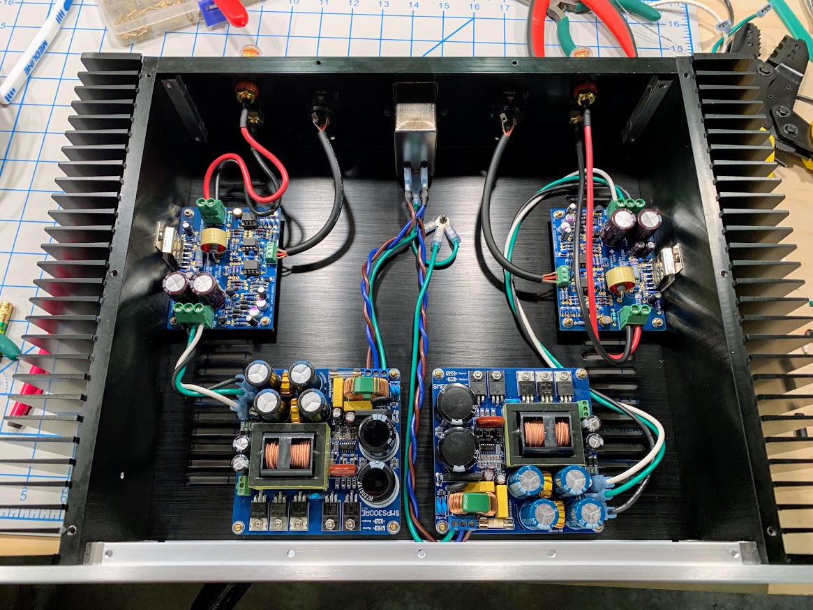

I want to make a Modulus 86 stereo amp.
Any of you who have compared Toms linear Power 86 to Connex SMPS300RE ?
I made a dual-mono Modulus-86 a while back. I already had a SMPS300RE laying around from a previous project so I figured it would be a cool idea to buy another and go nuts.
In many builds you would get better channel separation with a dual-mono build. That's because you eliminate any interaction through the power supply by building dual mono.
For the Modulus series, there's no real benefit to the dual-mono configuration - at least not in terms of amplifier specs - as the power supply rejection ratio of the amp is incredibly high. However, as you point out, you do likely get a benefit in terms of longevity as each power supply only sees half the load.
Either way. The supplies are cheap and light and your build is well executed, so why not... 🙂
