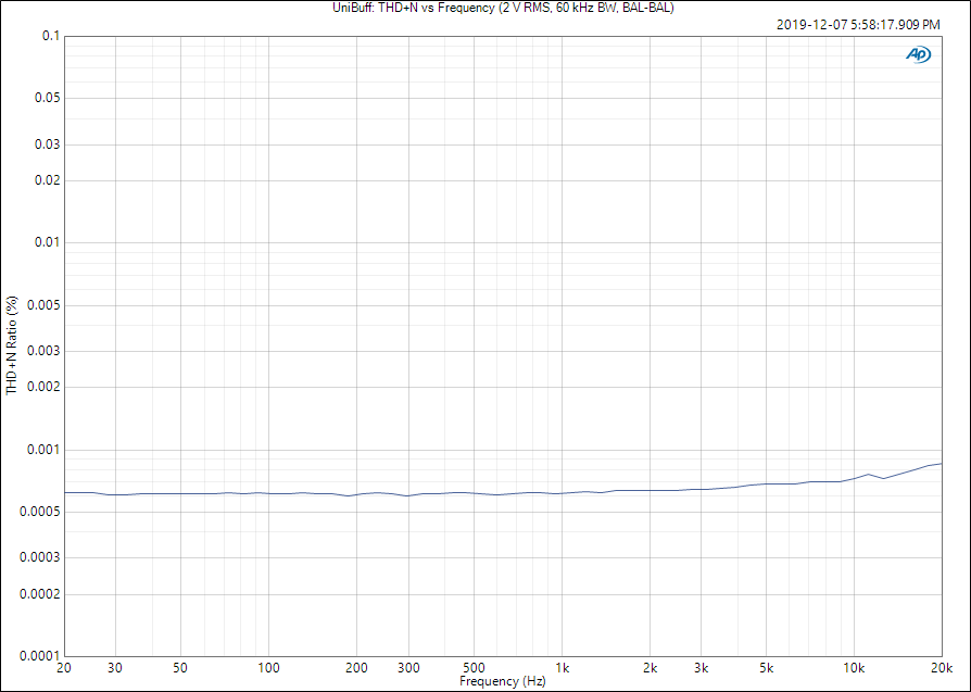

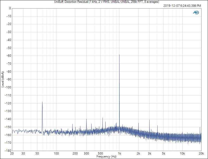

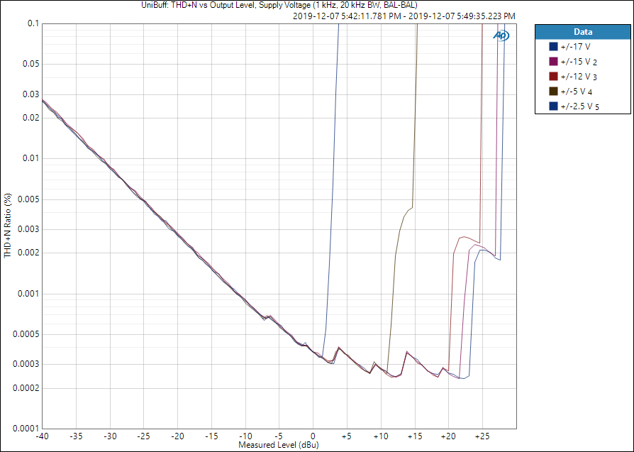

Hi Tom,
Looking at the 4th attachment would seem to suggest 0.0006% THD approximately, worse at higher frequencies of course. I really don't think it is reasonable to expect your distortion is running around -140 dB, given that the passive components would be adding their own distortion rates. What ICs were you using? They may also be under-performing.
Having said that, the performance is very, very good. I am interested in your project.
-Chris
-Chris
Um. No... It shows 0.0006% THD+N.
I use metal film SMD resistors with low temperature coefficient and low voltage coefficient. I further design the circuit to minimize any perturbation to the signal that the passives might cause. The amount of distortion they add is negligible, even at the -140 dB level.
You're certainly in your right to be skeptical of my -140 dB THD measurement. That was hard to do! I ended up using an active 1 kHz notch filter designed around an LME49720 and a handful of 0.1% tolerance metal film resistors and polypropylene capacitors. Using it and my "Victor's Oscillator", I verified that the distortion of the oscillator was below -145 dB.
I then adjusted the oscillator for 2 V output on the Universal Buffer and connected the notch filter between the Buffer and the APx525. The resulting THD residual is shown in the attached FFT plot.
I did verify my THD measurement with a passive (twin-T) notch filter as well. The main drawback of the passive filter is that it attenuates the harmonics, so one needs to compensate accordingly when reading the plots. The active filter I used for the FFT measurement of the Universal Buffer has negligible attenuation (< 0.5 dB) of the harmonics.
I'm using the LM4562/LME49720 and the LME49724. You can find the block diagram on the Circuit Topology tab of the product page.
I never thought I'd hear -140 dB THD called "underperforming". 🙂 The LME49724 is spec'ed for -130 dB at heavy load (down to 600 Ω). I'm measuring at light load (100 kΩ) where its distortion is lower. Same for the LM4562/LME49720. All this is covered in the notes column of the spec table.

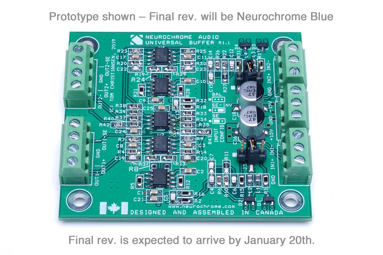

I've attached the board picture and the two measurements we're talking about to give people in this thread enough context. I welcome the conversation, but suggest we scoot to the Universal Buffer thread for further discussion related to it: Universal Buffer achieving -140 dBc (0.00001 %) THD

3 in, 1 out.
I presume I'd need more than 1 PCB?
What's the power requirements of such a thing.
Edit: Ignore me, just had a good look at the PCB.
2 in, 2 out with 15v supply required.
