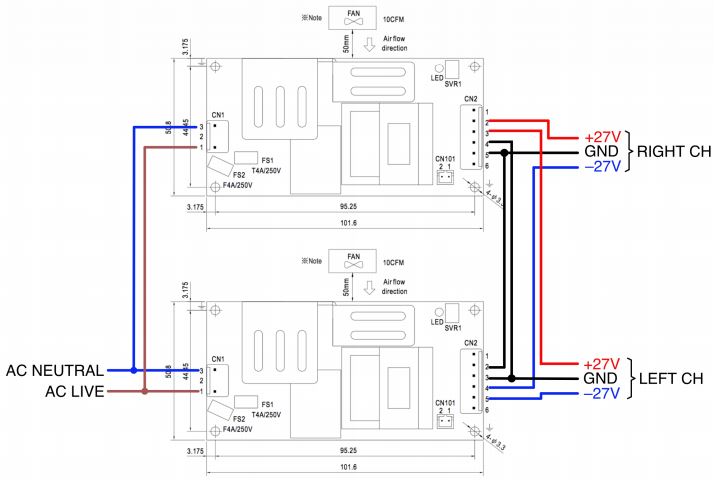

Hi Tom. Decided to get another SMPS300RE and go with a dual mono build. Question though. Does this same scenario apply for me too? Can I just power each channel with its own power supply?
You need to create ±27-30 V for the Modulus-86. The Mean Well supplies provide +27 V, so two are needed to create ±27 V (plus-minus twenty-seven volt).
The Connex SMPS300RE provides ±30 V, so it can plug directly into the Modulus-86. One SMPS300RE (±30 V) is enough for a stereo Modulus-86 amp. If you'd rather build a dual-mono amp, you can use one SMPS300RE per channel of Modulus-86.

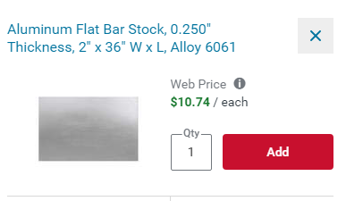

I fooled around with the idea of an Adapter Plate. This was just 2" wide aluminum bar stock, 1/4" thick. It had mounting holes which match the diyAudio Store's Universal Mounting Specification (link), namely holes drilled in a rectangular pattern, 40mm x 80mm, same as UMS. I used a #29 drill bit for these holes to create some "play" in case my alignment was imperfect.
Now you mount the chipamp PCB to the Adapter Plate, and then mount the adapter plate to the heatsink. Using plenty of Thermal Grease of course.
Advantages: you never drill the heatsink, only the (inexpensive!!) adapter plate. So you get as many do-overs as you need without ever endangering the expensive heatsinks.
Disadvantages: (1) Now you're drilling seven holes and tapping three of them. That's more work than the conventional approach which drills and taps only 3 holes. (2) Extra cost of buying the aluminum bar stock. I bought 2" wide by 36" long from Grainger.com, which is enough to make seven adapter plates. It cost eleven dollars, image below.
_

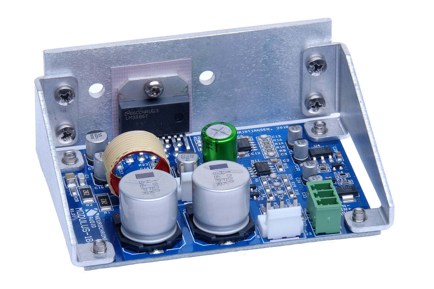

I know a couple people have build these amplifiers into a Dissipante 3U chassis, I'm assuming that I can't use the holes in the driver plate, does anybody have any mounting/case advice to share for using this chassis?
I'm usually able to find a position on the inner mounting plate where all the mounting holes of the board overlap with metal in the plate. Drill holes there. Then drill and tap the heat sink for the LM3886.
An alternative is to get the chassis without the inner plate and just drill into the bottom panel. That's pretty easy to do. Then drill and tap the heat sink for the LM3886.
Yet another alternative is to make an L-bracket out of 1.6 mm aluminum (0.064"). You'll want the short side of the L pointing down along the heat sink and mount the PCB to the long side of the L for support. Then drill and tap the heat sink for the LM3886 (or line up the LM3886 with one of the UMS holes and design the L bracket such that you can use some of the other UMS holes to hold it).
The key is that you want to support the circuit board at all four mounting holes and you want the LM3886 thermally connected to the heat sink.
I've used all three options above. I usually wait until the very end to solder the LM3886. This makes sure it lines up with its mounting hole. I also have a few rounds of dry-fits to make sure everything fits.
Tom
