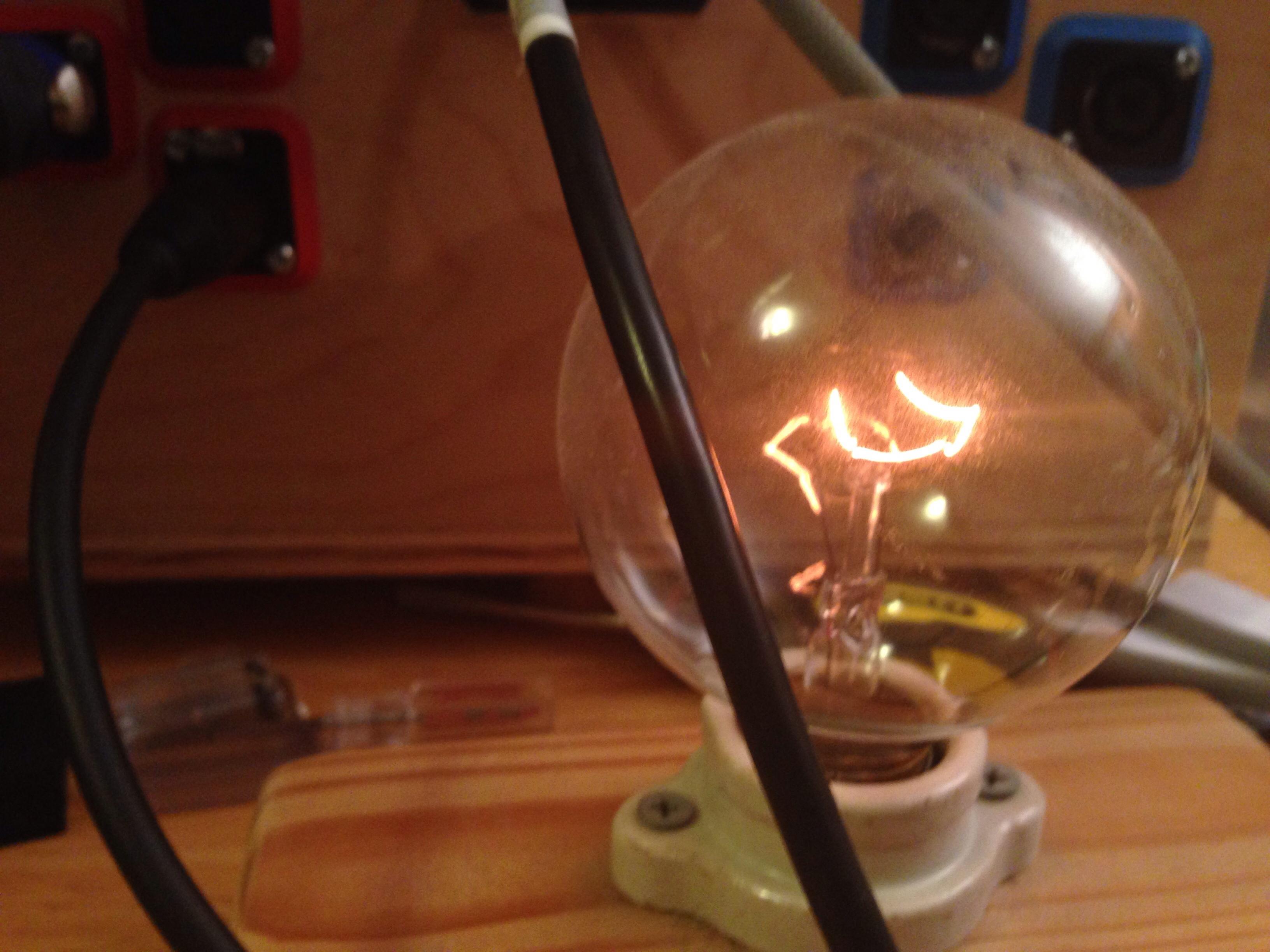

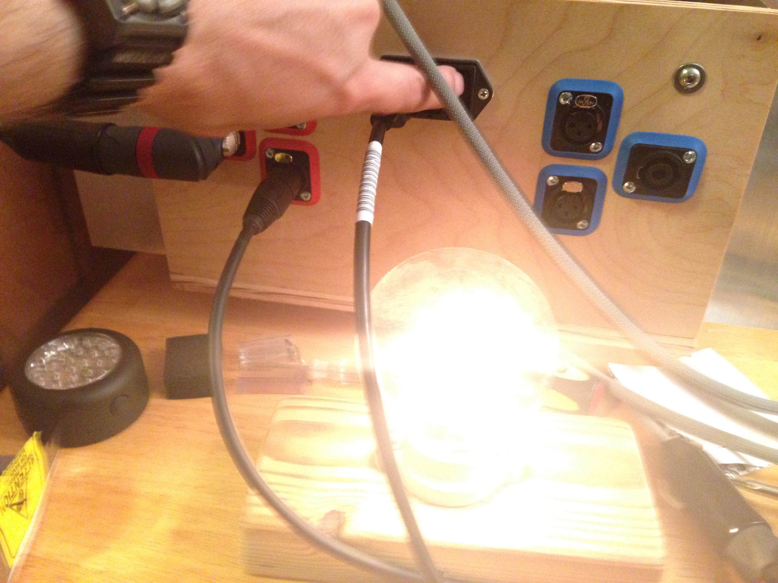

My one concern, is when I had all 4 mod86 connected, I had a very dim glow on my lightbulb in series with mains. When I had one mod86 at a time connected the light was dead black (except of course for the initial flash of the caps charging)
Is it normal to see a little glow simply because of the multiple boards drawing more than one board alone?
Considering that I don't have any information on the bulb or what you consider "dim", I can't answer that. However, ***IF YOU CAN DO SO SAFELY***, you can insert an AC ammeter in series with the mains connection and measure the current drawn by the amp from the mains.
Considering that each MOD86 draws 55-60 mA typical and the turns ratio of the transformer is about 120:44, I'd expect 4*60*44/120 = 88 mA of current drawn from the mains.
I suspect the amp is working fine and the lightbulb tester is causing enough voltage drop on the primary of the transformer to cause the output voltage of the Power-86 to drop.
Are you able to safely measure the voltage going into the transformer? I'm guessing it'll be around 80 VAC due to the voltage drop across the bulb tester.
If the mains inlet to the amp is fused (and if you follow my design documentation, it should be), you can also take the lightbulb tester out and plug the amp directly into the mains. You should then see about ±30 V on the supply.
An intermediate step would be to use a higher wattage (lower resistance) bulb in the lightbulb tester. Try with a 100-150 W halogen bulb. You should see a higher output voltage on the Power-86.
There should be absolutely no need for you to change the power transformer. I use an Antek AS-3222 in my amp and am getting the ±30 V I mention.

You're a genius Tom. I didn't realize the lightbulb would limit so much.
Without the bulb I get +/-32.5V at the output of power86 board, with all four Mod86's connected. So that's good too.
Measuring AC Amps, I don't believe my multimeter does that. I have some large junction blocks so I could rig an apparatus to securely hold the wires and do it safely if I had the right meter. My multimeter has three poles to plug into, COM the black one always goes there, then Volt/Ohm/mA is the one I mostly use, the third one is labeled 10ADC (10A/250V Max),... So that's only for measuring Amps Direct Current, and I should not use it to measure Amps Altranatung Current, right?
The bulb I have is 40 watts I think, and it is very dim, difficult for a photo to render a good likeness because the variable of exposure and brightness on your screen will make you wonder. I have two pics for comparison, one is the flash while the caps charge, we'll call this the reference photo, because you can imagine that's pretty bright like a reading lamp for just an instant, the second photo is the dim glow with amp at idle.
Honestly, because each board individually did not illuminate the test light at all, I'm feeling confident all is well anyway.
