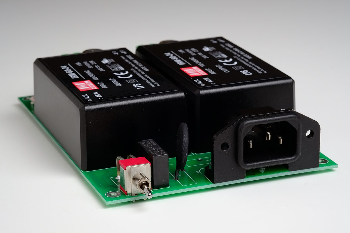

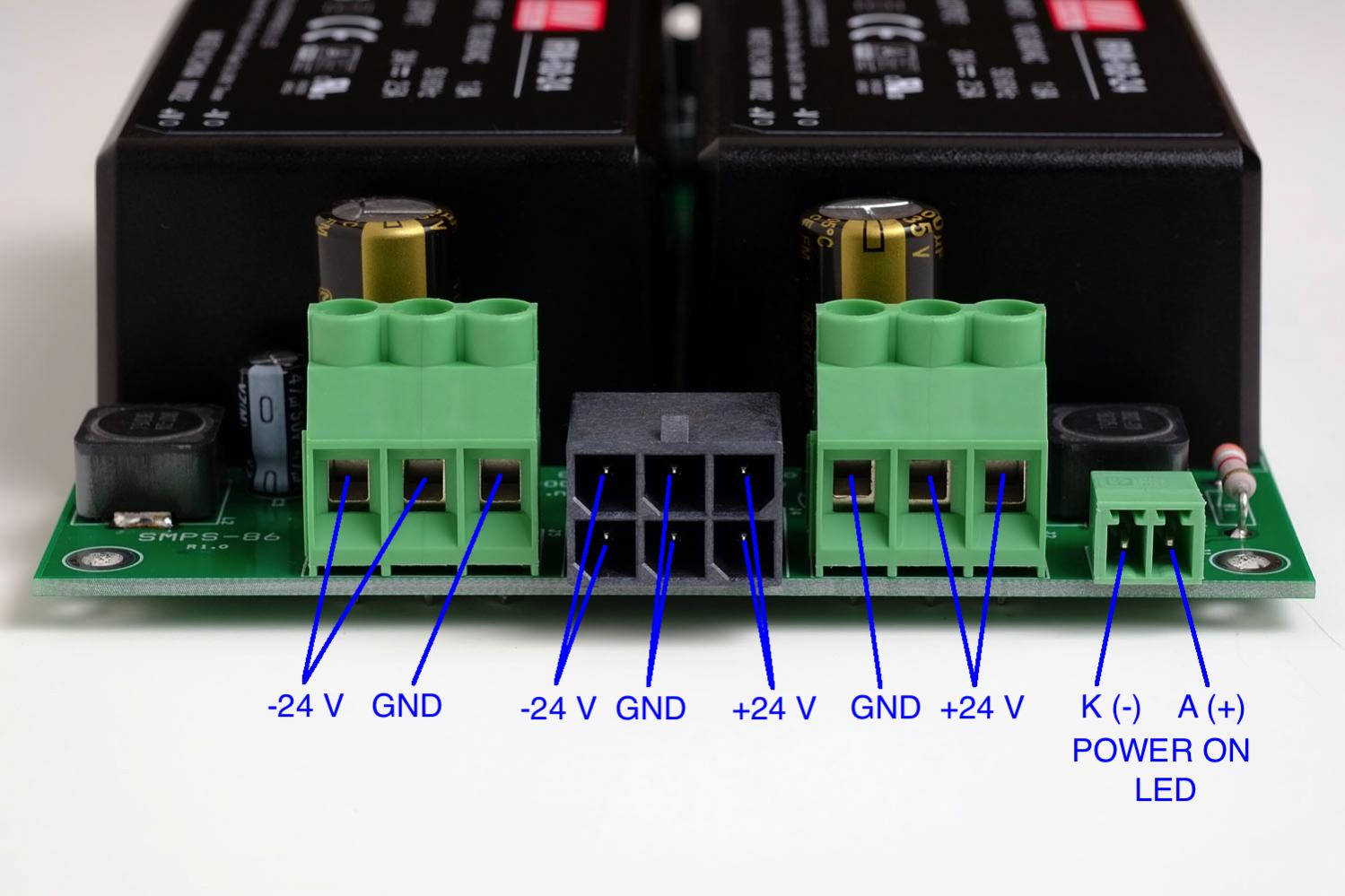

Latest member of the Neurochrome product portfolio: SMPS-86.
It's intended to be panel mounted on a panel no thicker than 4.0 mm. International mains in. ±24 V out. 2.85 mV RMS (20 Hz - 20 kHz) output noise.
For more information on the SMPS-86, please see its product page: SMPS-86: Switch-mode power supply for audio amplifiers.
Tom
Well done Tom, the SMPS looks nice.
Having the IEC socket and switch pre-installed is a nice touch. Also like the idea of power LED connecting socket - will make connecting a front panel power LED very easy.
Looks like you have listened well to your customers. 🙂

Thank you. Mains wiring is intimidating to many, so letting me do that relieves some anxiety for some people.
I rather like the little EURO-style connectors. They're super easy to work with. The mating plug has screw terminals, so you attach your wire there and done! Having the ability to unplug the LED is handy during the assembly stages of a DIY project.
The SMPS-86 saves you 30 % on the parts budget compared to a Power-86 with a 160 VA Hammond toroid that is available world wide.
