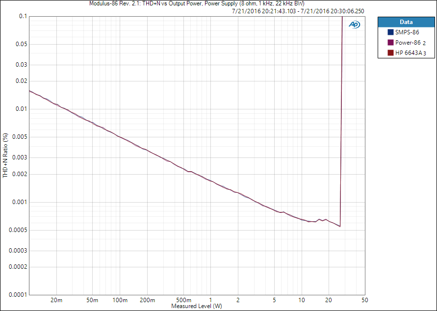

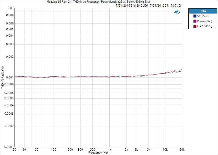

Measurements of MOD86 Rev. 2.1 and SMPS-86 attached. There is no meaningful difference in the performance of the MOD86 when powered by a well regulated lab supply (HP 6643A), a Power-86 + toroid (adjusted to ±24 V out at full output power), and the SMPS-86.
MOD86 + SMPS-86, Power out into 8 Ω: 28 W
MOD86 + SMPS-86, Power out into 4 Ω: 42 W
If you don't need a ton of power and would like to skip the mains transformer and all that mess, the SMPS-86 is a good way to go.

  • Modulus-86 Rev. 2.1_ THD+N vs Frequency, Power Supply (25 W, 8 ohm, 60 kHz BW).PNG
  • Modulus-86 Rev. 2.1_ THD+N vs Output Power, Power Supply (8 ohm, 1 kHz, 22 kHz BW).PNG

My Mod86 has an Antek AS-3224 and Power86. Based on the above post it seems that if I replaced those components, with an SMPS-86, the wattage @ 8Ohms would drop from about 40 to 28 and at 4Ohms it would drop from about 68 to 42. Is that correct? Would the dead quite quality and other spec.s be the same?
Correct. The output power drops to 28 W (8 Ω), 42 W (4 Ω) with the SMPS-86 due to the lower output voltage.
With the SMPS-86, I measured 42 µV RMS (unweighted), 33 µV RMS (A-weighted) of output noise.
I looked briefly at the output mains hum. -110 dBV with the SMPS-86.
It does indeed look like the Modulus-86 really doesn't care what supply you use. The output power is lower due to the lower output voltage of the SMPS-86. This means the amp hits clipping at about 1.5 V RMS input. These are the only changes I foresee in the spec table when switching from the Power-86 to the SMPS-86.
