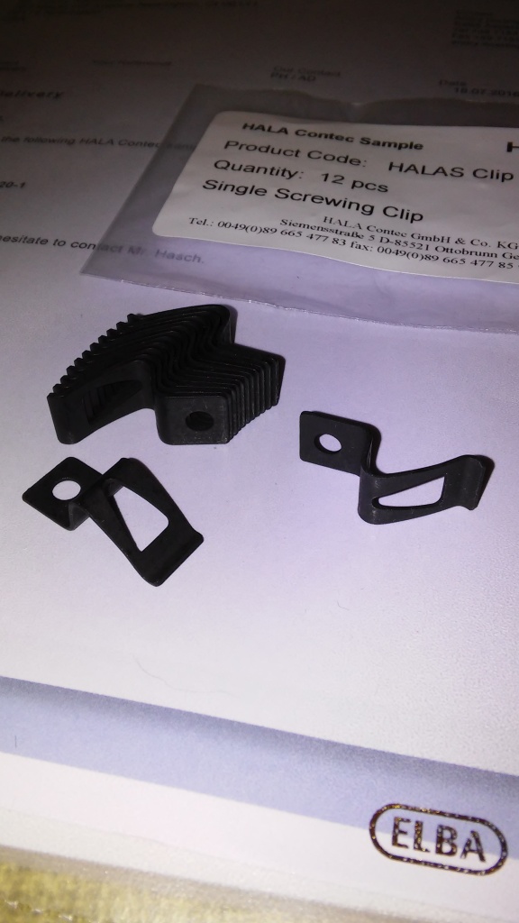

I may have mentioned I found info, on the web, about IC clips made by HALA. They make one specifically for TO-220 ICs. They and all their distributors seem to be in Europe. I sent them an email asking where I could by a small quantity of about 12. I didn't get a response.
Surprise...FEDEX pulled up yesterday with a package from Germany. They sent me 12 free samples, their 2016 catalog and a nice letter signed, by a live person, in ink. It listed the name of the person to contact If I had any questions.
It appears they are a large company specializing in thermal interface materials. The clips I got, are very well made and have an anti-corrosion coating. The mounting and IC contact surfaces are parallel and flat. I put all 12 on my granite surface plate and no wobble.
I'm not tied to them in any way...just was impressed with the scope of products and the quality of what I got. Here are a few pics. The 3rd pic is looking straight down at 10 bunched together. The geometric repeat-ability is quite good.
Dang! Isn't it amazing what you can get if you ask nicely? They look like nice clips. They'll come in handy for your Parallel-86 build.

The pics of the lm4870 made me think it was not a TO-220 but the data sheet cleared up that misconception. I now know it is a TO-220 package, so the HALO clips will work with it, but you knew that.
The data sheet recommends a couple of ways to secure an lm4870 to a heatsink. One is like the Rowland pic, with a bar across it. Instead I'll make use of the HALO clips, using two per lm4870. They will mount, via two holes I'll tap in each heatsink, just above the top of the lm4870. That should spread out the clamping force, as well as a bar would, plus nothing to make.
What matters for the clips is the width of the package and the thickness. The thickness of the TO-220 is 3.56 to 4.82 mm (according to JEDEC). The LM3886T and LM3886TF are 4.5 mm ±0.12 mm thick (according to TI). So the LM3886 will fit fine with a TO-220 style clamp.
The LM4780 is 0.177" ±0.005" (4.5 mm ±0.13 mm) thick (TI). So that'll work with a TO-220 clamp as well.
That is by far the best idea!
Technically, neither the LM3886 nor the LM4870 is a TO-220. They are in the style of the TO-220, sort of the stretched limo of the TO-220 world. The clips should still work.

I also thought there might be some risk with screws, in the mounting holes on the LM4870, shorting out on the uninsulated back. When I was thinking of using a bar, like the Rowland pic and, mentioned in the LM4870 data sheet, I was going to make the tapped holes outside the LM4870 perimeter and use a wider bar.
Then I got the HALA clips and as mentioned I'm using two per LM4870. That will provide clamping pressure across the wider LM4870. Also both the LM3886 and LM4870 data sheets show the same main body thickness of .177+-.005. I think two HALA TO-220 clips should be ideal.
