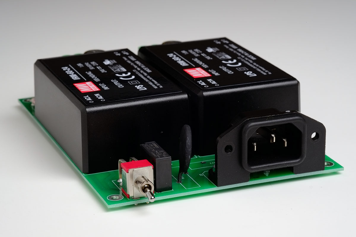

Latest member of the Neurochrome product portfolio: SMPS-86.
It's intended to be panel mounted on a panel no thicker than 4.0 mm. International mains in. ±24 V out. 2.85 mV RMS (20 Hz - 20 kHz) output noise.
For more information on the SMPS-86, please see its product page: SMPS-86: Switch-mode power supply for audio amplifiers.

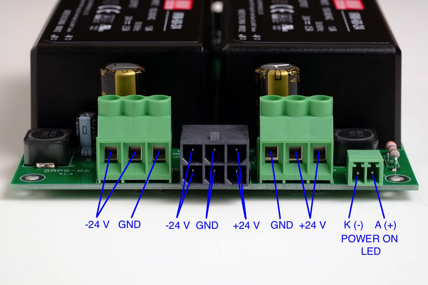

I guess I just missed the edit time-out. DOH! The attached picture shows the pinout of the connectors and terminal blocks on the SMPS-86.
The output voltages are provided on terminal blocks with a rising cage clamping mechanism. These terminal blocks accept wire up to AWG 10 (5.2 mm2). The output voltages are also provided on a Molex MegaFit connector for better compatibility with the LM3886DR. The power on indicator LED is connected via a EURO-style connector.
