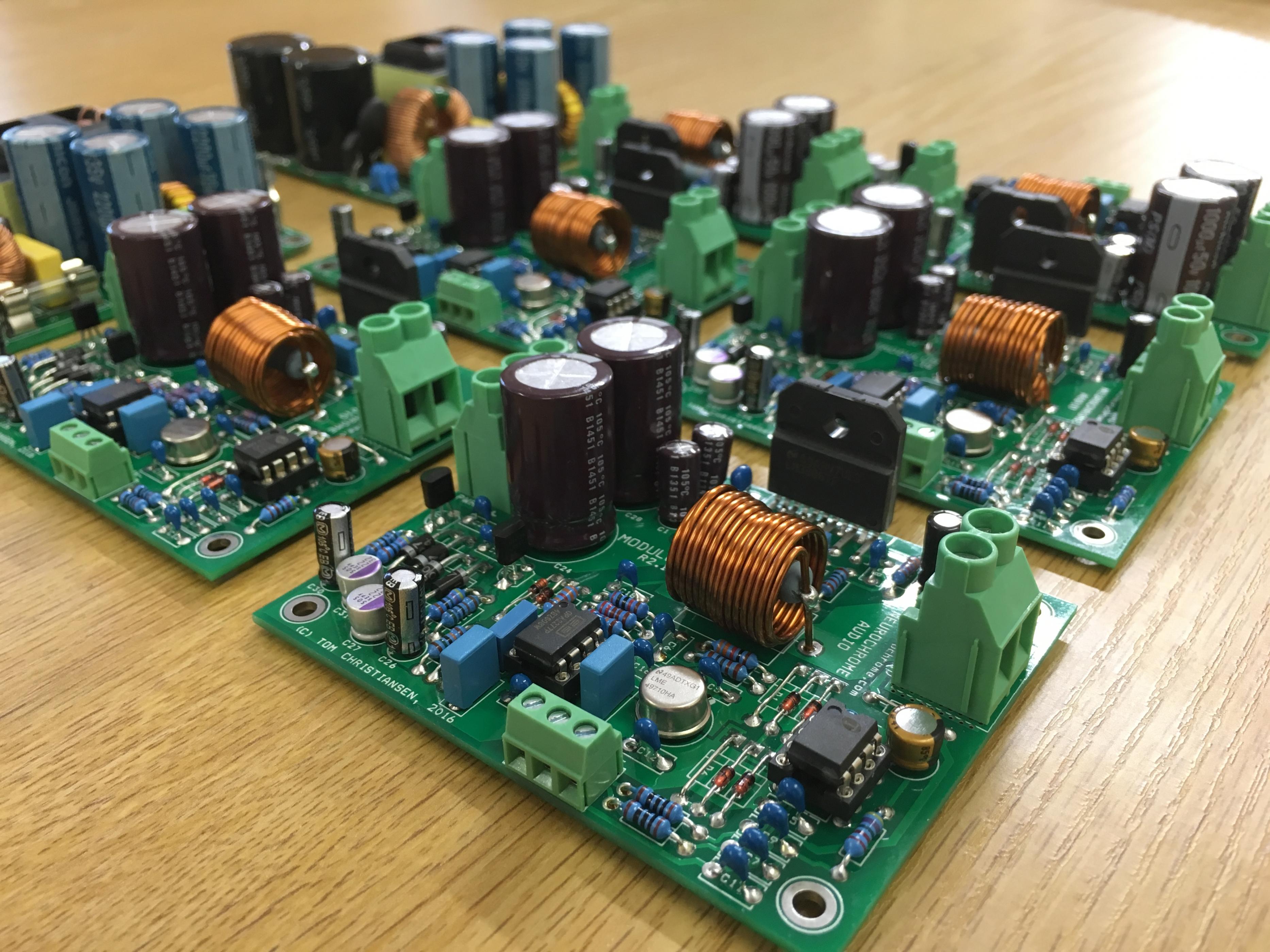

I've just finished the build of six Modulus-86 boards. Initially they were for a LX521 build but they have now been redirected to a church organ replacement project using a dozen drivers from Common Sense Audio. I have one or two joints to check over. Otherwise the build has gone very well indeed. Thanks Tom for a wonderful kit!
