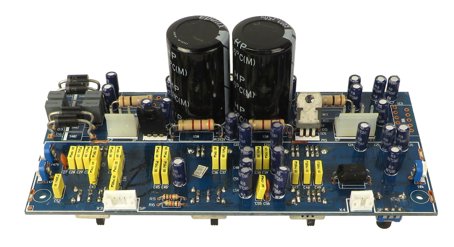

Hi Tom, I'm glad to help.The wonders of spring steel....
I still reckon it's worth a try to fit a small 'pad' of some non ferrous/non magnetic material between the spring clip and the top of the chip.
I have encountered situations where the spring clip is slightly twisted and this exerts uneven pressure across the device, with slightly uneven HS paste spreading....changing the pressure contact point to small and central would cure this possibility.
Raising the ferrous spring further away from the 'chip' may be of benefit also.
Any possibility of seeing closer detail ?.

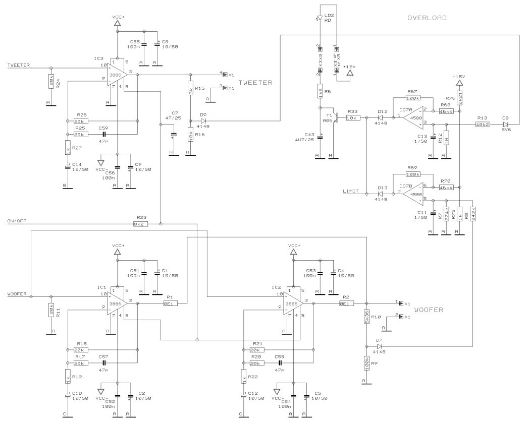

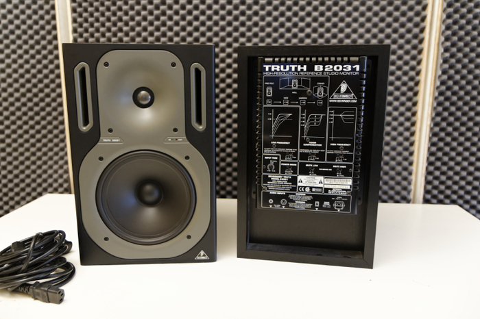

I have two pairs of Behringer B2031A as per the schematic above, and I am interested to modify one pair of amp modules according to your advices.
Notably there are no output networks.
If the clip is bent, it would be wise to throw it away and blow $0.20 on another clip. In fact, I bet if you call up Mouser and let them know that you've received bent clips, they'd probably ship you another one for free.

No, but reading the LM3886 data sheet thoroughly will get you most of the values. The rest you'll have to find here in various recommendations made both by AndrewT and me.
My boards should drop straight in, assuming there's room in the chassis.

Spring steel bending often is not precision.If the clip is bent, it would be wise to throw it away and blow $0.20 on another clip......
In my experience they are never bent exactly straight/parallel.....I have fixed thermal failure faulty gear because of this.
There are divided 'finger' springs and single contact point versions that are better.
A 'modification' single correctly placed contact pressure point would eliminate any doubt.
What's to lose ?.Should I say anything? 😉

For now, I have tweaked (ie totally changed) the internal acoustic damping arrangement and driver connection wires, but have very deliberately totally refrained from touching the electronics for the purpose of keeping the electronics in stock/factory condition.
The stock PCB layout/components is from hell.....BUT with a bunch of tricks (240V screened iso transformers, balanced audio feed, isolated USB Dac running on car battery power, my interesting filters, etc....) the sound of this system is seriously way cool.
These speakers have gone mostly as far as they can easily on the 'passive' side, and now is time to finesse the electronics.
So, this thread and your input inspires me to quite easily component add/swap out shift one pair of modules up a gear, win win, all good, thanks.

There are all the 'taming the LM3886' pages on Tom's site and all the posts in the chipamp forum. Plenty there for the DIY'er.
I would be very pleased to buy Toms boards, but I already have two sets of typical 'prosumer' 3886 based monitors with inbuilt line level crossovers/protection.To be honest if you have to ask with high performance composites you probably won't get it working as well. Took me about a nanosecond to realise I couldn't get within 10dB of the performance Tom has with the mod, let alone measure it. Made the boards a no-brainer to me. YMMV.
I don't expect to gain all that Tom has achieved, just a review of what the Behringer guys left out and optimal circuit values.
Yes, much reading of others experiences with 3886.There are all the 'taming the LM3886' pages on Tom's site and all the posts in the chipamp forum. Plenty there for the DIY'er.
For now I am keen to further optimise what I have....ie tweak one pair of modules and leave one pair in factory state and then do the comparisons with factory cabinets and tweaked cabinets.
How important is the Thiele series output network when running 10" speaker wires and standard dynamic speaker drivers ?.
