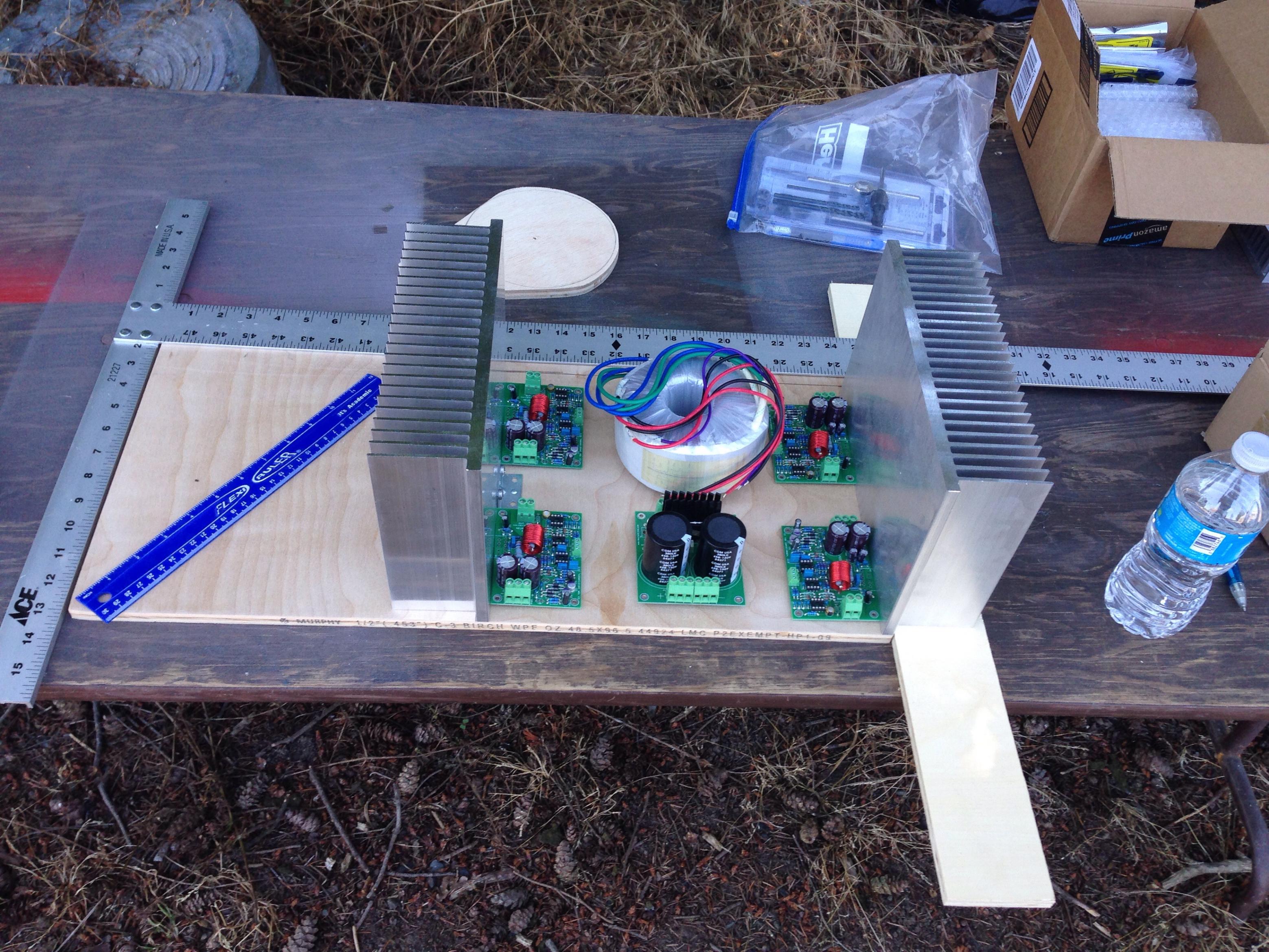

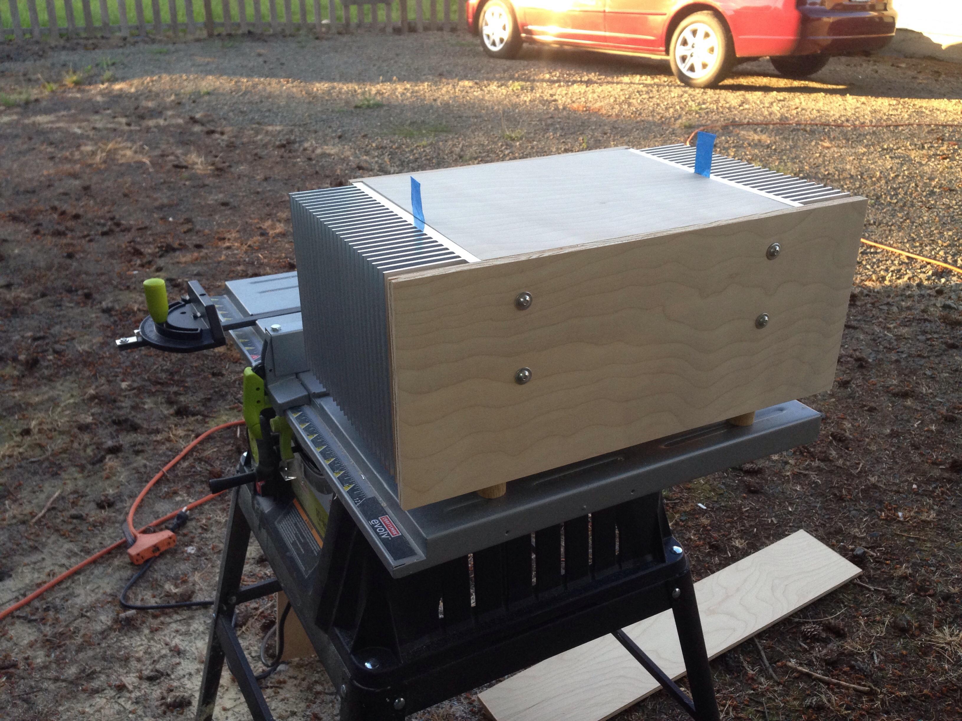

Finishing up
Finally things have settled down, and the weather is good enough to be in the shop.
The original plan was for a six channel Mod86, but I switched speakers to LX-MINI's (love them BTW). I only need 4 channels now. That's the reason the heatsinks are oversize. I think it looks cool though.
Myself, I like the look of wood gear, I think it's classy. I line the inside of the box with thick aluminum sheets for safety (PE).
Here's the chassis I made. Just need to do some wiring now.
Can't wait to be rid of my big-box-store crapo receiver. Soon

Nice work. You might as well sell your receiver now! Tom's designs mean business!
Regarding your PS, I hope 20,000 uf per rail (from what I can see in your pic) is enough for 4 boards...
For a four channel amp used for bi-amping, such as for use with the LXmini, one Power-86 with the default 2 x 22000 uF is plenty.
In case of more power hungry low-impedance speakers, such as the SL Orion or LX521.4, I suggest no more than two MOD86 boards per Power-86.
Tom
I like it. It looks like an amp that means serious business. That seems fitting for the performance level. 😀

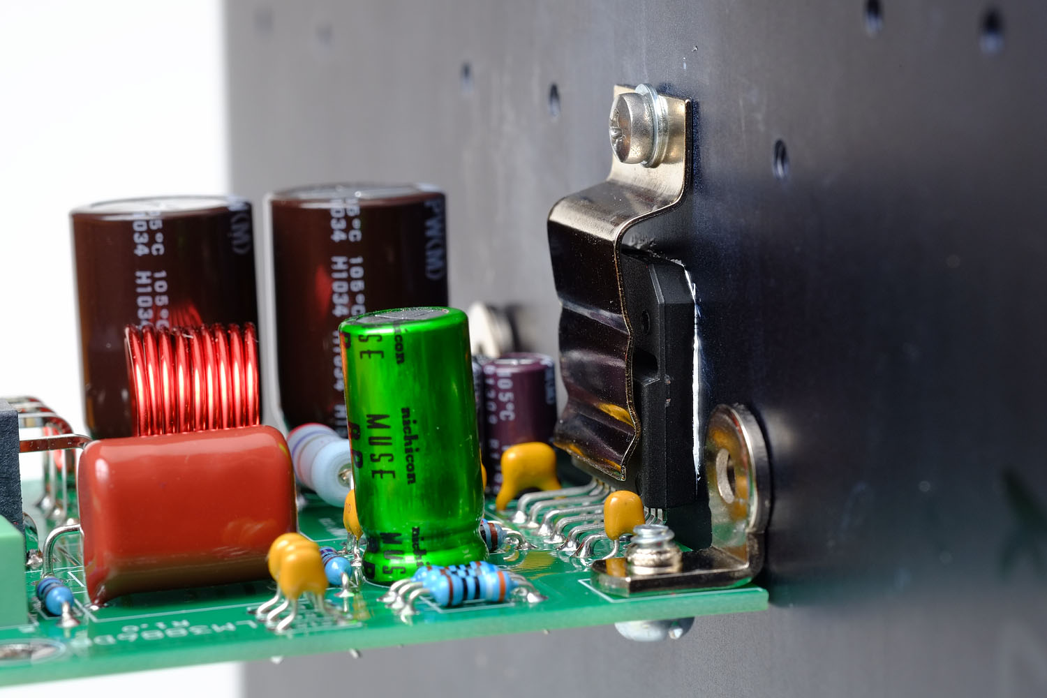

The wonders of spring steel. Aavid P/N: MAX08NG (available at Mouser). A thin coat of Wakefield 120 thermal grease on the back of the LM3886, digitally distributed (i.e. spread with a finger). Clamp positioned to put pressure roughly on the middle of the fat part of the LM3886TF package. I get 45 W (8 Ω) and 80 W (4 Ω) with ±30 V supplies.
The image shows the position of the clamp on my new LM3886DR amp.

Those clips definitely look worth a try, a nice way for the average DIY 'er to avoid the pitfalls of the screw-through-tab technique. Out of curiosity I checked DigiKey and they stock them also.

That looks cool. Super convenient for a test bench I imagine, but I'm not a designer, so that's just a guess.
I really like those little L-bracket things holding the pcb to the heatsinks.

The clips are easier both for testers and builders. The hole placement for the mounting screw is nowhere near as critical with the clip as it is when you use the mounting hole in the LM3886. The clip also ensures a good clamping pressure all across the LM3886 package. As long as the LM3886 is mounted perpendicular to the PCB, the clips also make it possible to solder the IC to the board, drop the board into the enclosure, tighten the mounting screw on the clip and be done. That's much easier than the dry-fit, solder, disassemble, apply thermal grease, reassemble process I've recommended until now.
I do too. They're a little cumbersome in the PCB layout process as they do need to align precisely with the back of the LM3886, but they are so much easier for the builder to deal with.
