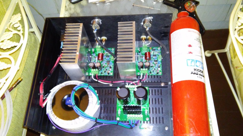

Tom, I set my meter to test continuity of connections in my, finally completed, Mod86 stereo amp. As I’ve mentioned, in my previous posts, I’m still wet behind the ears when it comes to electronics.

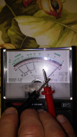

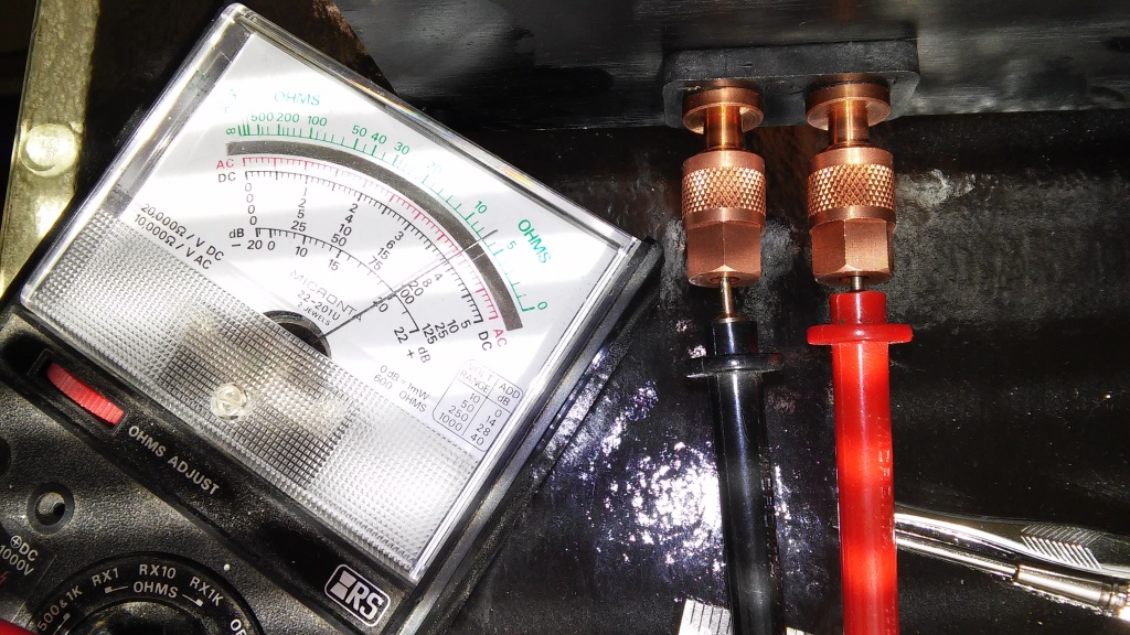

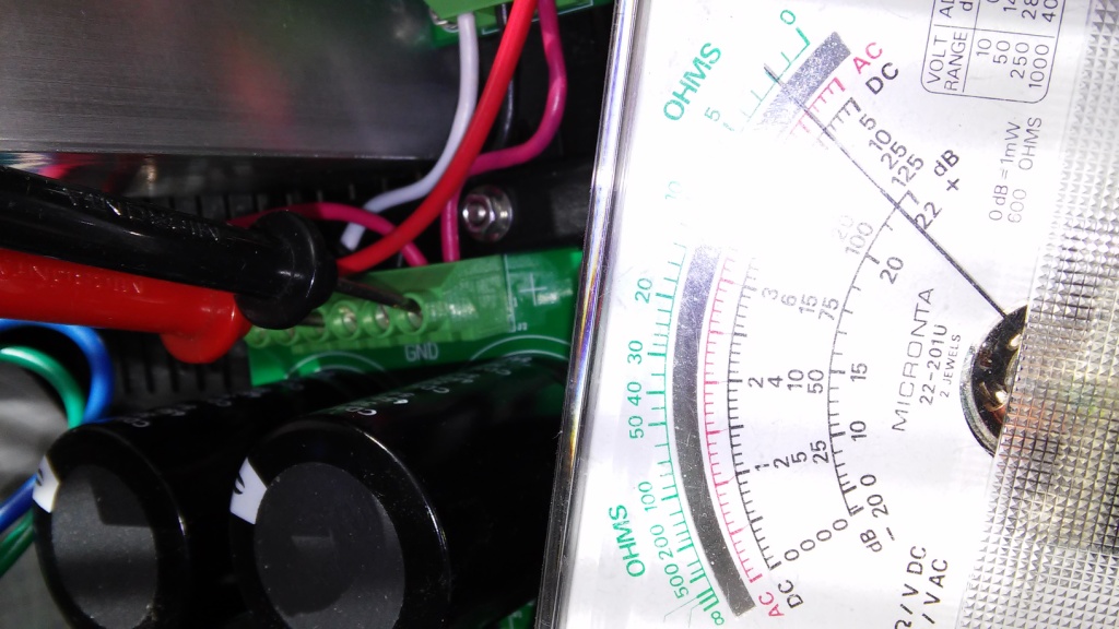

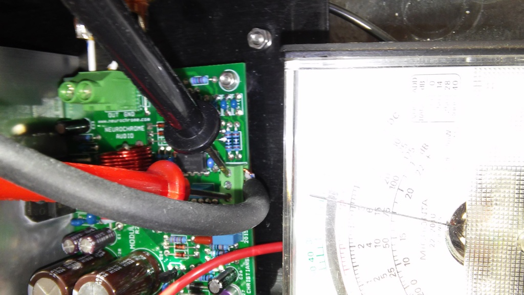

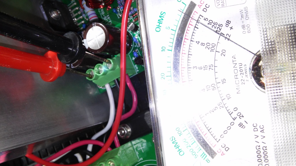

I didn’t expect to find continuity between the all component connection screws. The pics show the typical results with probes in contact with the screws and meter readings. You can see that the readings varied at different connections. Are these correct? I don't want to plug it in until it's right.
I also have about 5 more pics with the probes at different connections showing slightly different readings. I can post those if you like.

You'll get weird readings when you measure the resistance across things, in particular with the circuit off.
I tested the modules before I shipped them to you, so if everything is connected correctly, it should power right up. As far as I can tell from your build picture, everything is connected correctly. I'd say, make sure the mains inlet is fused and power that sucker up. Use a lightbulb tester if you'd like a little extra protection. AndrewT can tell you all about it, or you can have a look here: Lightbulb Tester.
If you prefer to test in blocks, and I'd recommend that, I suggest disconnecting the two amp modules from the power supply. Cover the wire ends with electrical tape so they don't short to each other or the chassis. Then power up the amp. You should be able to measure aloud ±30 V on the output of the Power-86. The voltage may be higher than that as there's no load on the supply. Turn the power off and wait for the caps to discharge. Then connect the amp modules. Power up again and measure the output offset. Should be well below 1 mV after 10 seconds. Mine measure about 45-50 µV.

I checked resistance of binding posts on two other amps I have, that work great, and got the same meter readings. I'm going to get a fuse tomorrow and fire it up. The wiring is all correct and there are no loose strands to touch anything. Checked that with a lighted magnifier.
From what I saw, the readings are probably fine. They're several ohms higher than the absolute short you show with the probes touching each other, and a high power circuit will likely measure something like that with the power off.
Also, you should NOT try to measure RESISTANCE when the circuit is on! You might know this already, but it can be easy to forget. Don't ask how I know.
My reason for the pic of the probes touching each other was just to show that the meter was reasonably calibrated. I just fine tuned the cal and the readings, while not an absolute short on two of the three input connection screws and binding posts, match exactly on both channels. And again the, less than absolute short, readings on the binding posts exactly match the binding post readings on the other two amps. I'm quite sure everything is as it should be. I'll bet if I took the covers off the other two amps, and checked the comparable two input connections, I would get the same readings as the Mod86. It's time to bundle and tie wrap the wires.
