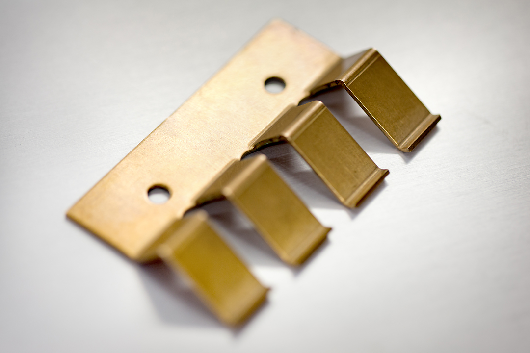

The above two spring clip types work very/perfectly well, BUT they are made of steel....IMHO/IME steel is not advisable directly over the actual amp chip.
If that titanium scrap is springy enough, I would try making a suitable copy of the lower pic.
These screw fixed spring clips allow easy removal/refit of the pcb/3886 to the heatsink.

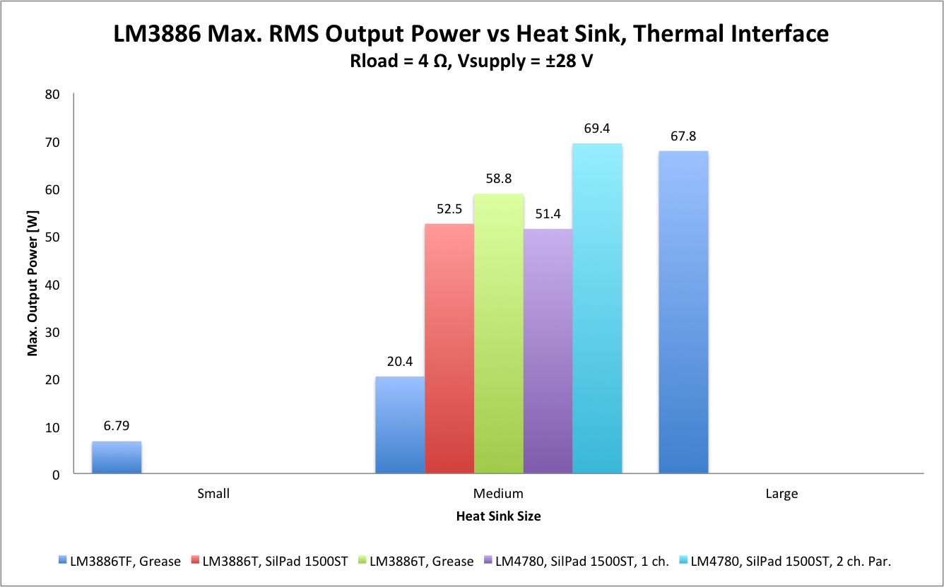

Thanks for the quote. I was the one conducting that experiment. The heat sink sizes were:
- "Small" = 13x13 cm aluminum sheet, 1.6 mm thick.
- "Medium" = Pentium Pro heat sink (Compaq P/N: 219222-006 NNE)
- "Large" = Heat sink specified at 0.4 ºK/W (about 2 kg of aluminum!)
Unless you're messing with RF ICs with built-in VCOs, I wouldn't worry about steel touching the top of the package. I do agree that the spring clips are pretty awesome. I see them used everywhere.

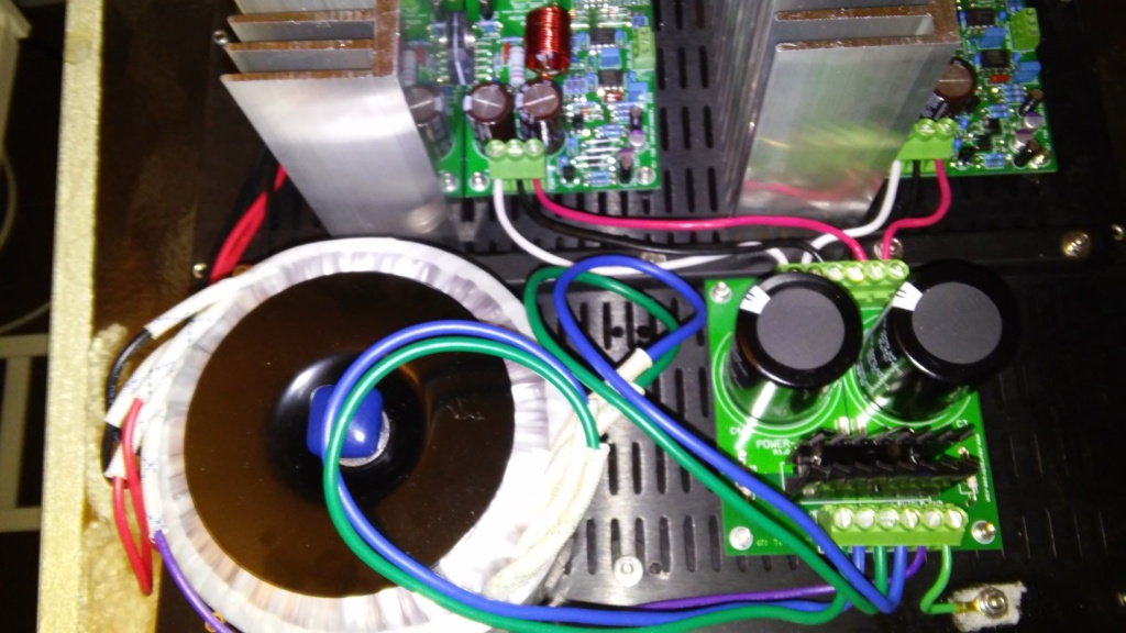

Pic shows my wiring of transformer to pwr86 and prw86 to mod86s. All are 14awg and wires from pwr to mods are very short so won't lend themselves to twisting. Transformer wires are much longer but I get the impression that having the wires in intimate contact should be sufficient. that true? If so, I have lots of small tie wraps to hold wires together. I could even tie wrap all four transformers wires together if that is a better approach. Please let me know if I should bundle or reroute transformer to pwr86 wires away from the transformer?
Looks very nice to me. I'd try to shorten the transformer wiring a bit. Mostly out of concern that one pair will get pinched between the top of the transformer mounting bolt (nice blue pad!) and the top plate of the chassis. On the longer run to the MOD86, I'd add a couple of wire ties.

I didn't want to shorten the transformer wires in case I use it for something else or sell it. The top cover is 1 3/4" above the top of the blue bolt cap. I will add many wire ties. I bought way to many a few years ago. I am going to add two of those $.020 TO-220 spring steel clamps. I'll just feel better.Looks very nice to me. I'd try to shorten the transformer wiring a bit. Mostly out of concern that one pair will get pinched between the top of the transformer mounting bolt (nice blue pad!) and the top plate of the chassis. On the longer run to the MOD86, I'd add a couple of wire ties.
