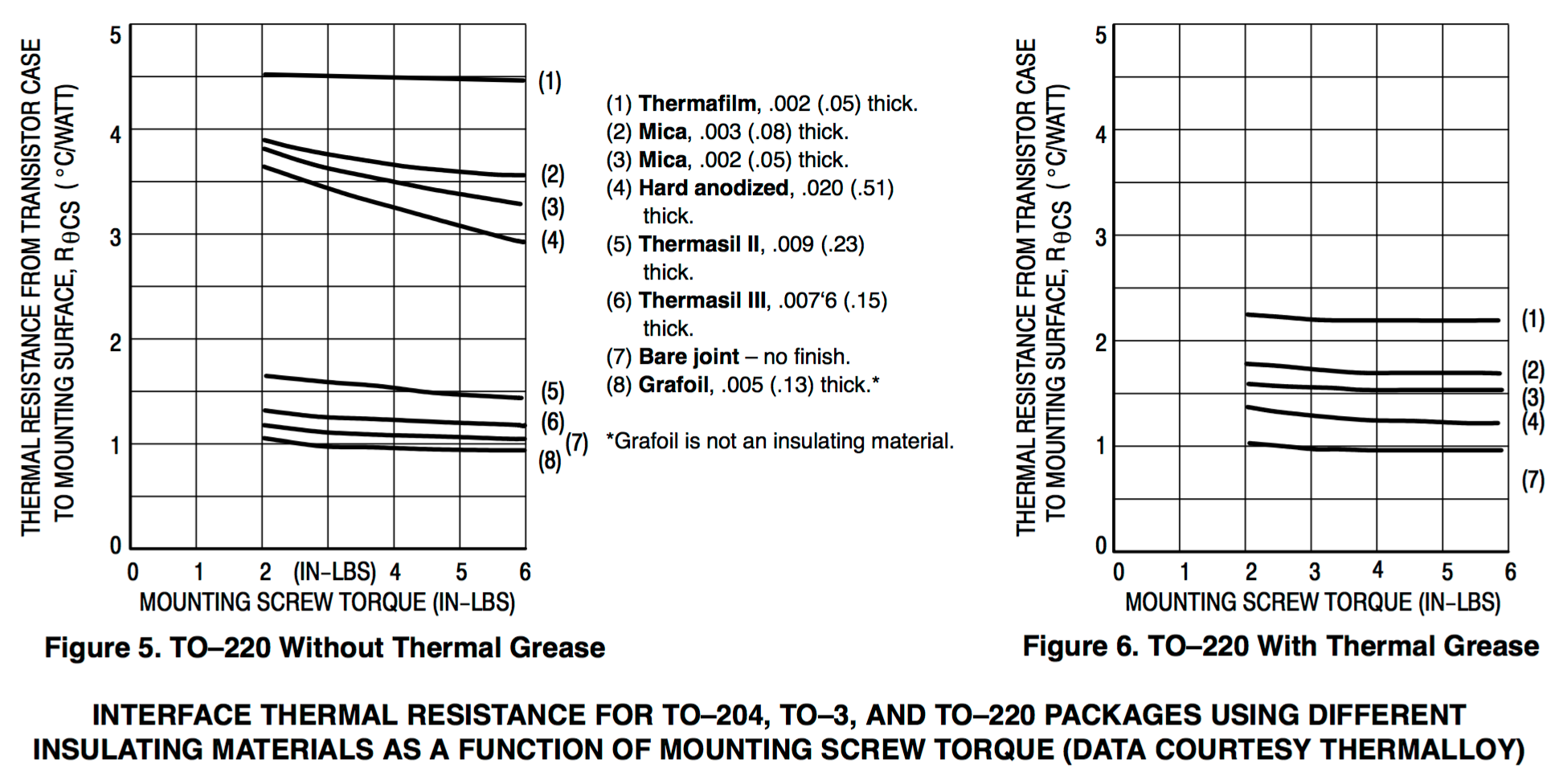

However if the idea of using the goop is to eliminate air gaps how can one possibly know if this was accomplished?
I'd consider the fact that I can take an LM3886 amplifier and reproduce the data sheet performance with the goop but fall 20 % short on the output power without the goop to be a hint.
If surfaces are not perfectly flat and clamping force is not optimized how can one possibly know if they have the optimal contact or a thick layer of goop.
I guess it's just one of those unknowns in life that people choose to live with. It's not like we're trying to build a space shuttle here.

Actually, if one can still find the classic application notes on heat sinking from Motorola and Burr-Brown (two that I recall), they specified Belleville washers to apply the right amount of force without ramming the mounting screw as far as possible. Heat sink mounting kits from companies like Thermalloy (including insulating washer, 'silpad', screw, nut and washer) use split lock washers. These two examples should indicate the amount of mounting force necessary.
The spring washers or split lock washers are common in Europe, actually. On this side of the pond people seem to favour the serrated lock washers. Go figure!
On-Semi has the most comprehensive guide to semiconductor mounting that I'm aware of: http://www.onsemi.com/pub_link/Collateral/AN1040-D.PDF
According to figures 5 and 6, the thermal resistance doesn't seem to vary a whole lot once the mounting screw torque exceeds 3-4 in-lbs (0.34-0.45 Nm in human comprehensible units).
One could pick up a set of torque screwdrivers and just torque the mounting screws. I've often drooled over the Wera 7440/41 set.

Henry, exactly my point. There has been little new in the world of 'standard' heat-sinking in a good 50 years. The "ON Semi" app-note that Tom dug up is, in fact, a very old Motorola app-note that was 'rebranded' when ON was split off from Motorola.
Yes, it is useful to minimize the thermal resistance at the device-to-heat-sink interface, but that doesn't improve the other thermal resistances in the thermal circuit -- (1) thermal resistance between transistor junctions and the surface of the IC package and (2) the thermal impedance between heat sink and the ambient air. The most useful thing to do, and which is in the DIYer's control is to reduce the impedance of the heat sink, either by larger/better size/shape or better ventilation.
Tom has a very good section on his web site (and in the construction manuals) about choosing heat sinks. Ultimately, your amp's output capabilities are limited by maximum supply voltages, output current limits, safe-operating-area (SOA) of the output transistors, etc., even with 'ideal' heat sinking. Taking 'extreme' measures beyond standard 'best practice' to improve the device-to-heat-sink interface provides minimal additional benefit.
Yeah... If the laws of physics have changed recently, I certainly misted the change notification.
Thank you.
Exactly. Surfaces free of nicks and gouges, thermal goop, and a machine screw will do. Anything beyond that won't matter even one imperial gnat fart.
