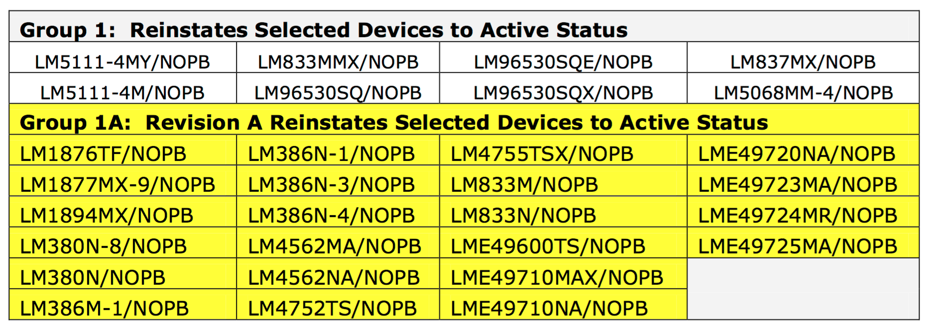

Good news of the day: It looks like we'll get the LME49710NA (8-pin DIP) back as well as a couple of the other LME-line ICs.
The full note of pardon is here: (.pdf)
A screen shot of the important bits is attached.
I'm not planning any changes to the Modulus-86 as a result of this. I'll stick with the TO-99 can. It performs very well. Ain't broken. Don't fix it. 🙂

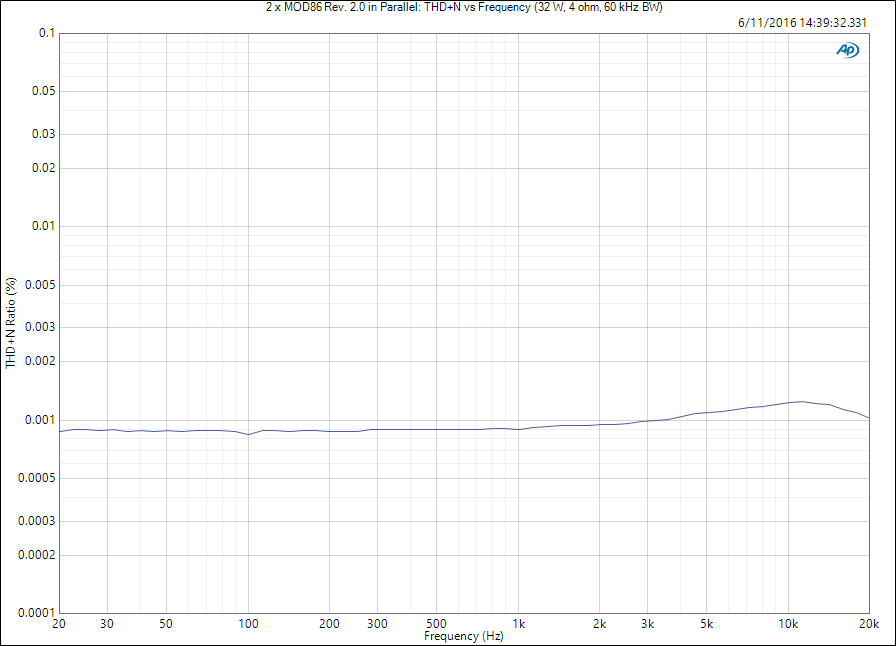

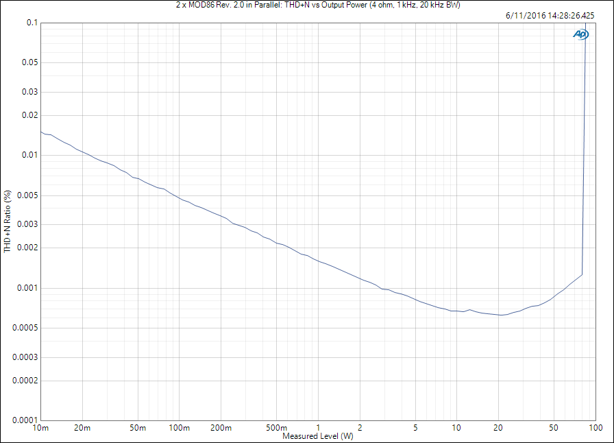

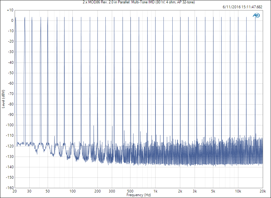

So I'm having a little fun in the lab...
As promised, I decided to see what kind of performance one could get by coupling two channels of Modulus-86 in parallel. It turns out, quite good performance, actually.
In The Good Old Days™, i.e. the days of the Modulus-86 Rev. 1.0, putting two channels of MOD86 in parallel was supported on the board. It was a modular amp, hence, the Modulus name. Nobody seemed to build them that way, however, and the ballasting resistor needed for parallel operation does add directly to the output impedance, so in Rev. 2.0 and beyond, I took that option off the menu and pointed people to the Parallel-86 instead. Now with the LM4780 being obsolete, I found myself mulling over what would happen when two channels of MOD86 are put in parallel.
I used my 4-channel Modulus-86 Rev. 2.0 amp for this test. I connected a 0.1 Ω, ±1 %, 3 W resistor from the (+) output of each channel to a common point, the new speaker (+) output. I connected the two output grounds together to the new speaker (-) output. The resulting performance plots are attached. I didn't do a full test suite on this, but the initial results certainly look promising.
For those looking to build a MOD86 with two channels in parallel, I suggest the following:
Tom
- Change R12 and R13 to ±0.1 % tolerance types.
- Instead of the Thiele network, populate one 0.1 Ω, 3 W, ±1 % tolerance resistor (metal film preferred) in the spot for R5. I used Mouser P/N: 66-LOB3R100FLF.
- Move the Thiele network (L1, R5) to the Speaker (+) output terminal.
- Connect the outputs of the two MOD86 channels in parallel to the output connector and Thiele network with matched wire lengths between the two channels.
Tom
