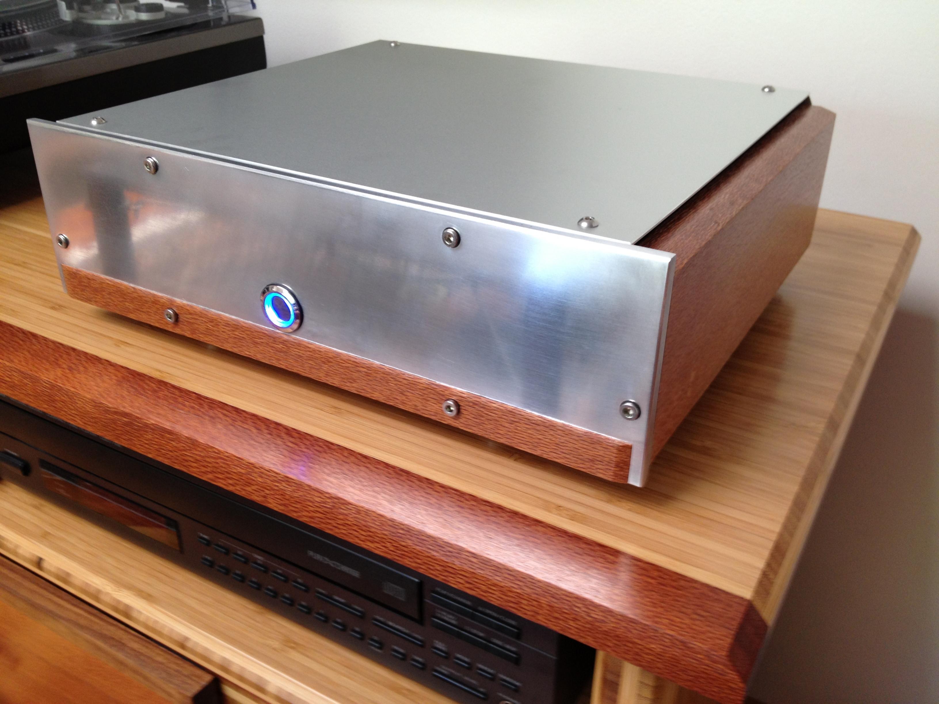

Long term use impressions
Have been playing my build for about 18 months now and thought one individual's day to day experience with the amp could possibly be of interest to someone on the fence for building one. I have early V1.0 PCB's purchased in late 2014 and know there are tweaks and improvements since then.
Some thoughts:
The sound is very, very good, "clean" might be a single word description. (sorry, not feeling any audio-spew verbiage at the moment so will spare everyone any attempt at that)
Well documented straightforward to build.
It's a bargain - I am hard pressed to imagine doing better at anywhere near this cost or even multiples of the cost. (full disclosure - Mod86 is in my rack next to some expensive tube gear. They're both wonderful and I feel fortunate and perfectly happy listening to either amp, but if one needs great sound at reasonable cost it's no contest)
Reliable - have had zero issues or fussing.
Runs very cool, room temp almost (I did use oversize heat sinks, 10" x 3.25")
I play a lot of vinyl and quite like the Mod paired with my tube phono stage.
It punches above its weight for power rating and have had good success pushing speakers I normally play with 100 WPC amps.

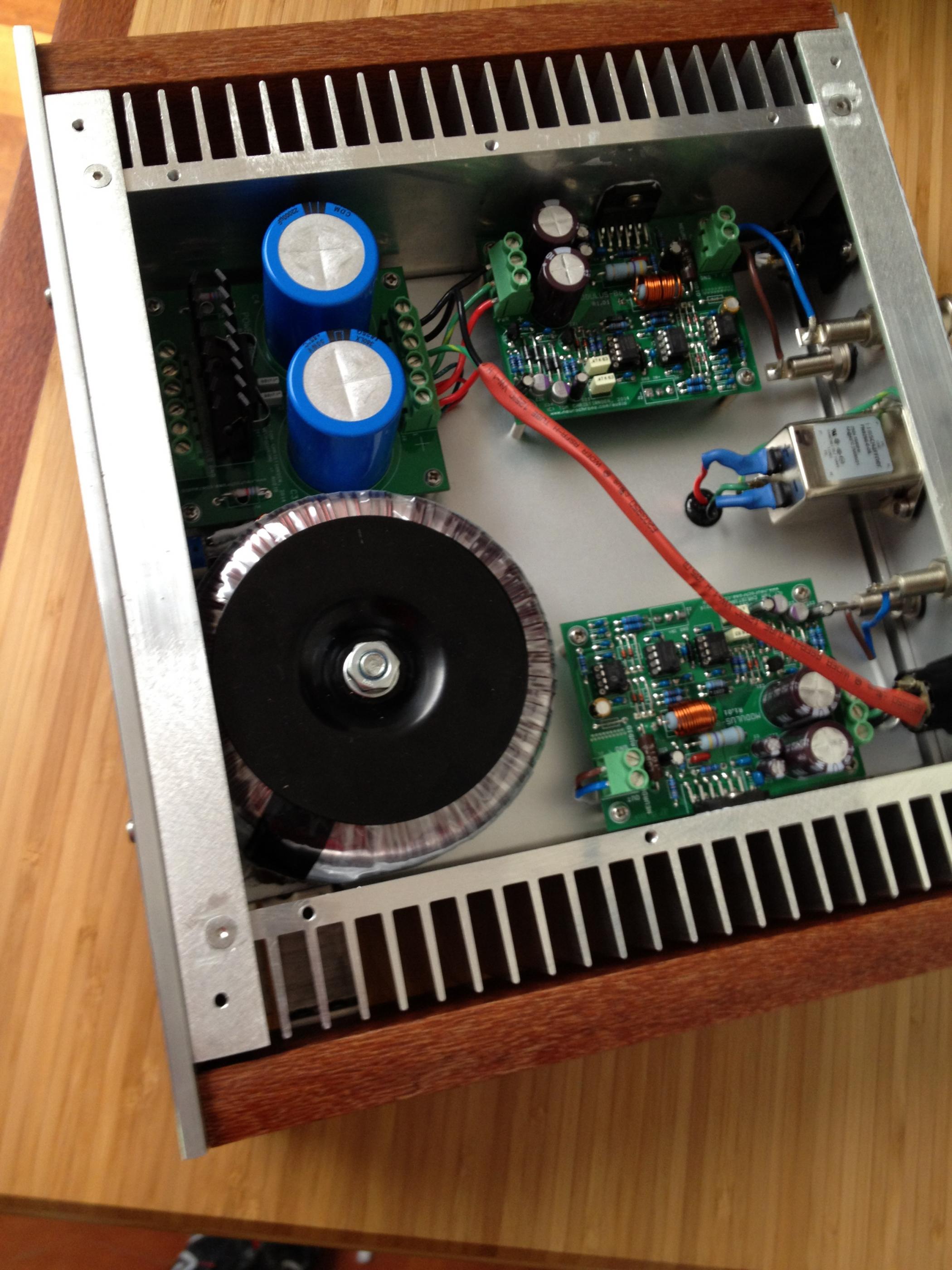

Initially posted impressions about a year ago. Everything has proven really solid and this is a massive thread so re-attaching photo of my scratch build enclosure and layout that (minus the wood bits, those were difficult to integrate) was really pretty simple to fabricate: Used two 10" Heat Sink USA pieces as side frames then drilled, tapped and bolted on some 3/4" angle stock front and back then added panels. As stated above, very happy with thermal management and am convinced oversize heat sink was good choice for long term durability.
Outside the heat sinks I think it was maybe $20 for aluminum from the local sheet metal place and some fussing with drills and taps.
It's a great product - thanks Tom

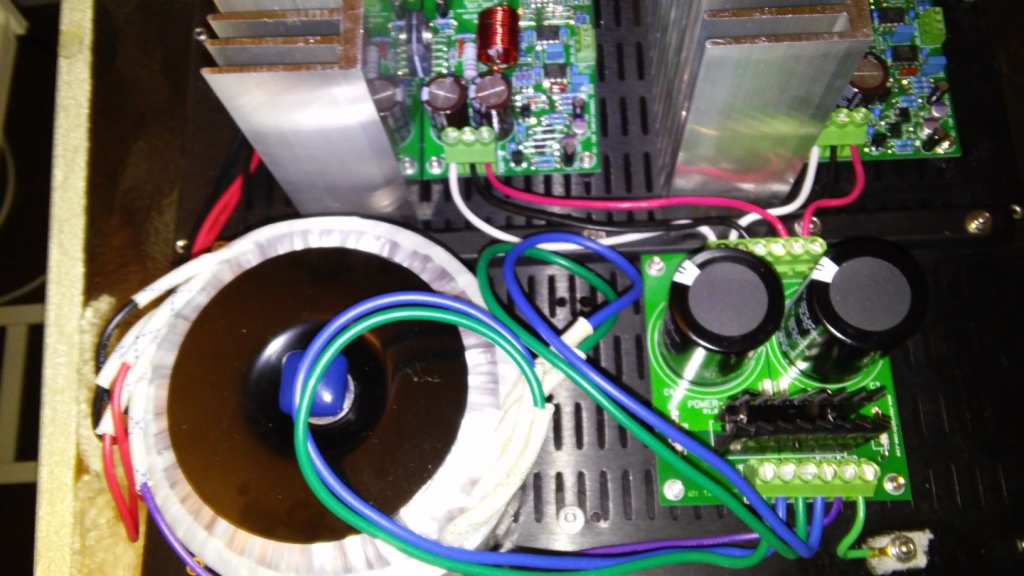

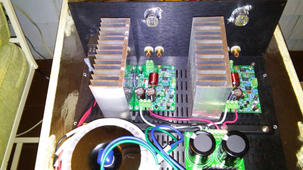

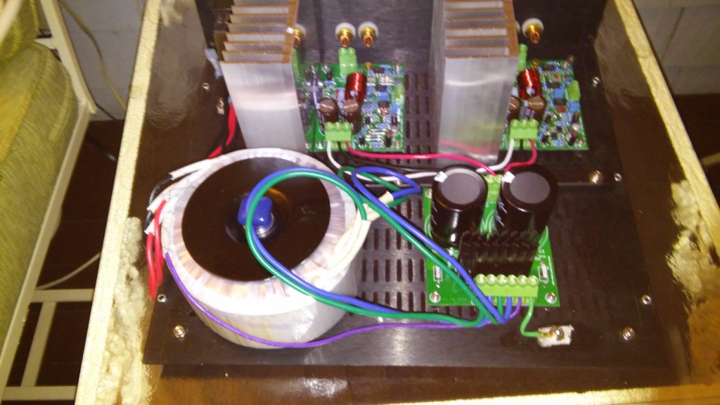

latest pics
Here are latest pics with some wiring completed. Can't solder since my station is dead. Should I get a good condition Metcal or a new Hakko?

The right is too short...would need new wires. The left side might allow two turns. I'd much rather use shielding I have. I love using stuff lying around instead of tossing it.
I wouldn't worry too much about twisting the wires. Do keep them tightly coupled (so tightly bundled with cable ties) but don't obsess too much over twisting the wires. Unless you get a really tight twist, you'll likely do more harm than good by twisting the wires. Also you need to get both the VCC and VEE coupled tightly to ground. That's nearly impossible in a 3-conductor twist.
Unless your shielding material is thicker than 10 mm, don't bother. The skin depth at 20 Hz is over 10 mm in copper. You'll get no meaningful attenuation unless you use material that's at least one skin depth thick.
The most important wires to keep tightly coupled are the wires coming out of the transformer (both primary and secondary). That's where the charging currents for the main supply capacitors flow. Those currents are short pulses, so if anything couples to the rest of the circuit, it would be those. The currents from the Power-86 to the Modulus-86 boards is averaged quite a bit by the supply caps on the Modulus-86 boards.

You really should twist those wire pairs and triples together, it will help minimize stray reactance's and EMI.
Like this: View attachment 554762
Mike
I agree.
Twist EVERY Flow and Return Pair. Mains, Speaker, Signal, Power.
I don't agree with Tomchr on this ( and I don't have any numbers to prove my contention)
one (1) twist per 2" (50mm) is better than no twists. You don't need 4 twists per inch to get good averaging of the fields for good attenuation of emi.
Cat5 uses tight twisting because the pairs are in contact with each other AND it is designed for >100MHz signaling.
