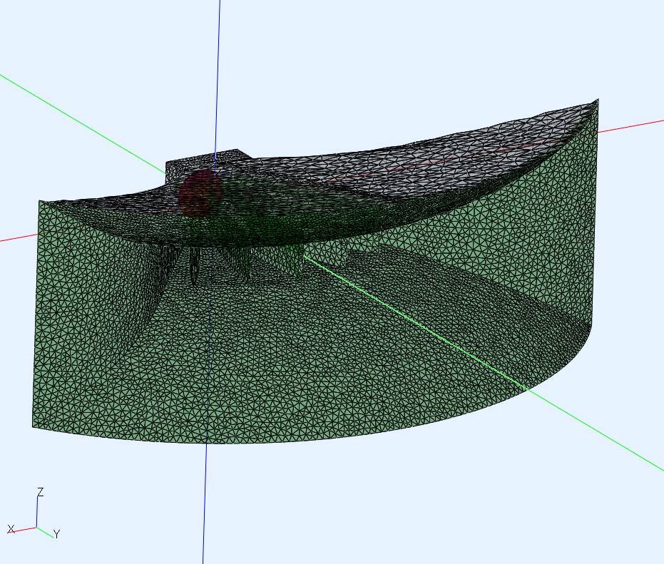

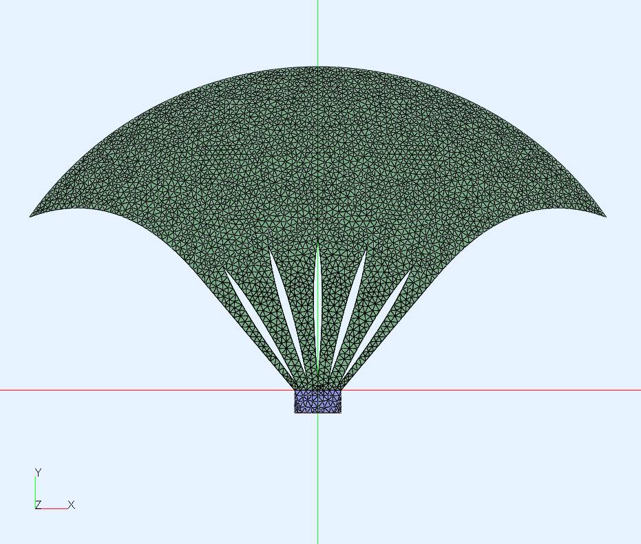

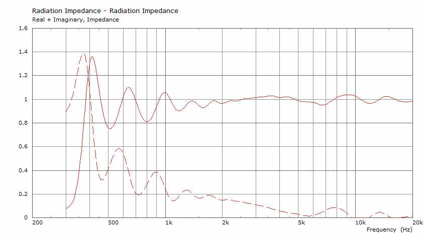

AKABAK sim : Radial Finned Horn + D2200Ph
This horn model originated from off line collaboration with @docali and @fluid that initially started with Yuchi A290 radial finned horn models. It resulted in some interesting improvements and I was curious about how one of these horns would perform with my D2200Ph driver for my midrange.

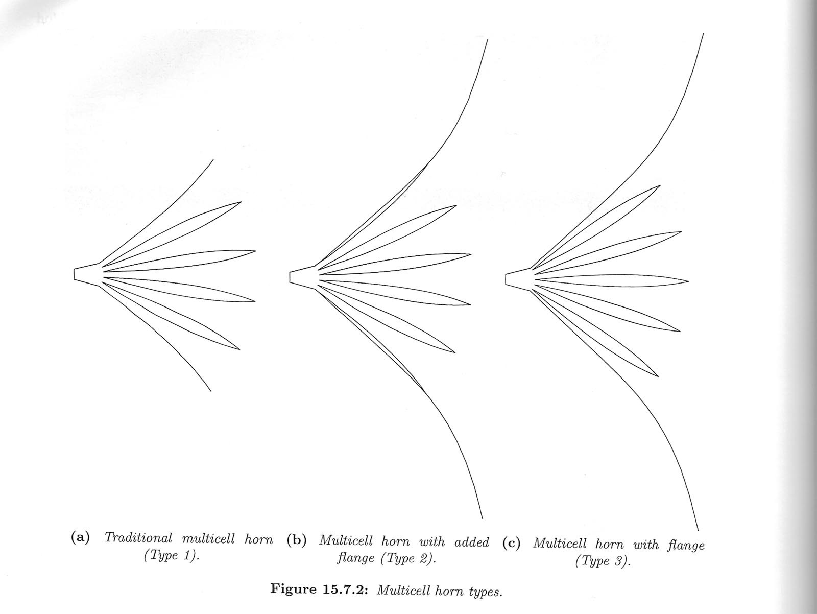

The fin arrangement (pic#3, type "c") was taken from High Quality Horn Loudspeaker Systems (Bjorn Kolbrek / Thomas Dunker) and the horn surfaces were calculated using @docali's calculator (spreadsheet) and surface reconstruction to STEP by @fluid. The RadImp (pic#4) and polars (pic#5,6) show the horn loads quit low and has relatively constant directivity.

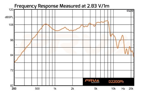

This sim uses the throat velocity profile taken from a D2200Ph PWT measurement (velocity curve in previous posts). This radial horn loads lower than the previous ZXPC horn, so now the D2200Ph bump (~600Hz) is visible (also shown with notch filter, pic#7) in the system axial SPL curve. The radial horn loads lower than the driver is capable of (it rolls off ~400Hz), and the driver also limits the HF performance (rolls off ~8KHz). PRV only provides test data for this driver on an exponential horn (pic#8, and I did ask them for PWT data). This system is easily capable of covering my midrange needs without excessive EQ as the system's axial SPL curve can be predicted using the driver's throat velocity curve in a simulation.

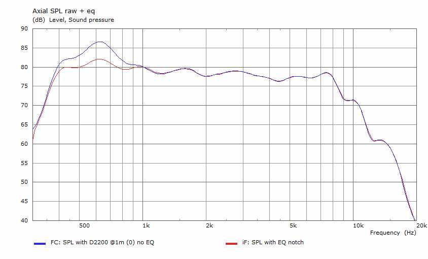

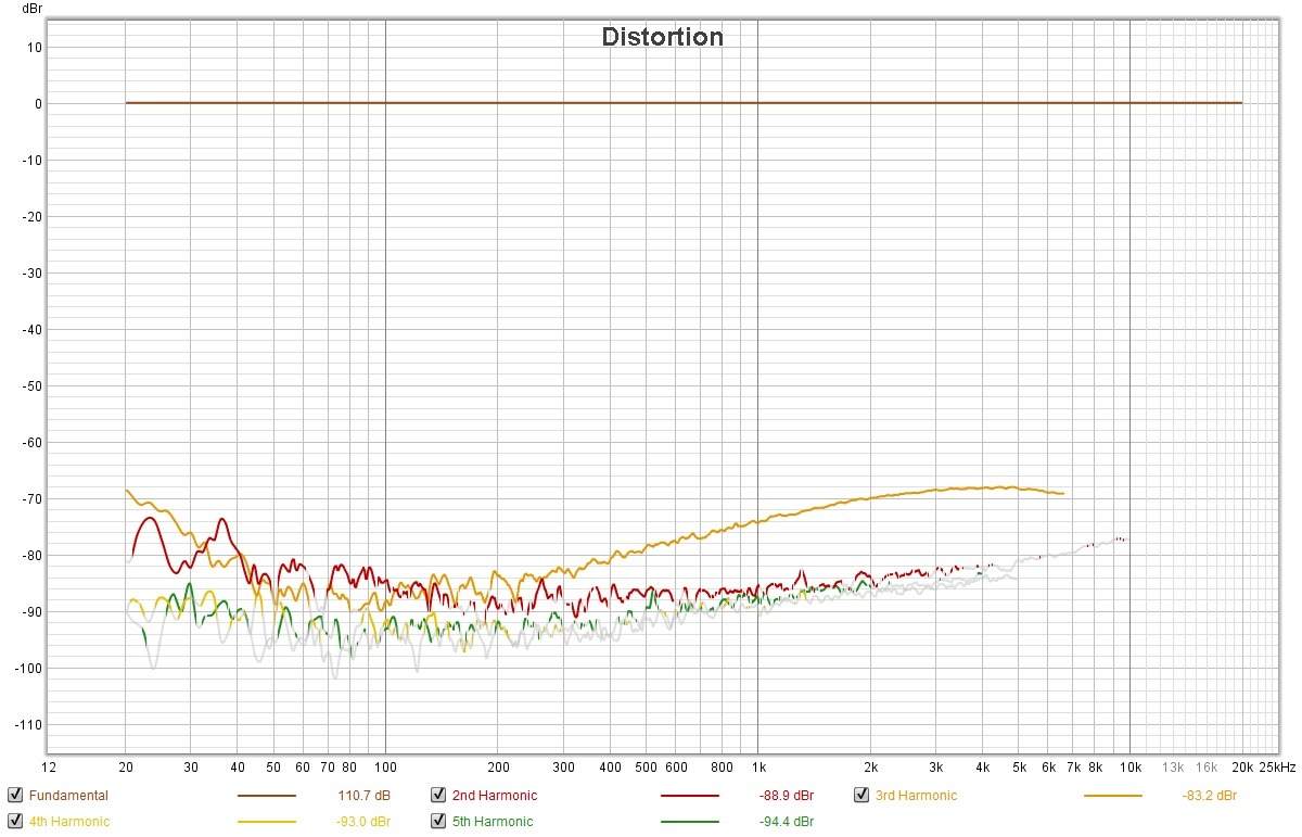

I was getting some ground loop noise (hum) while testing and tried to eliminate it. I bought a budget 2 channel TosLink DAC so I could break the electrical connection between my PC and filter + amps. Works great, no more noise, its silent now. However,... as soon as I listened to it, the audio quality was lacking.

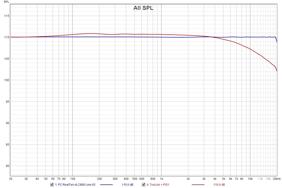

I did a few quick loopback tests to the the PC and compared it to the PC soundcard (ALC889). I would expect any DAC to manage 20-20Khz flat and I can excuse the performance w,r,t SNR or THD as these usually require better P/S and layouts. This one surprised me so I posted a few pics. I suspect most of its problems can be fixed for <$5. It will be taken apart soon as I want to embed an optical interface into my active filter box.
Pic#2 Compared to the PC's ALC889 using loopback. I can EQ the DAC flat but why start rolling off at 6Khz (unless its a reconstruction filter component error).
Pic#3 The THD with a cell phone charger. It's better than my speakers manage but not great for electronics, Sufficient for testing a speaker.

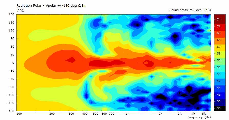

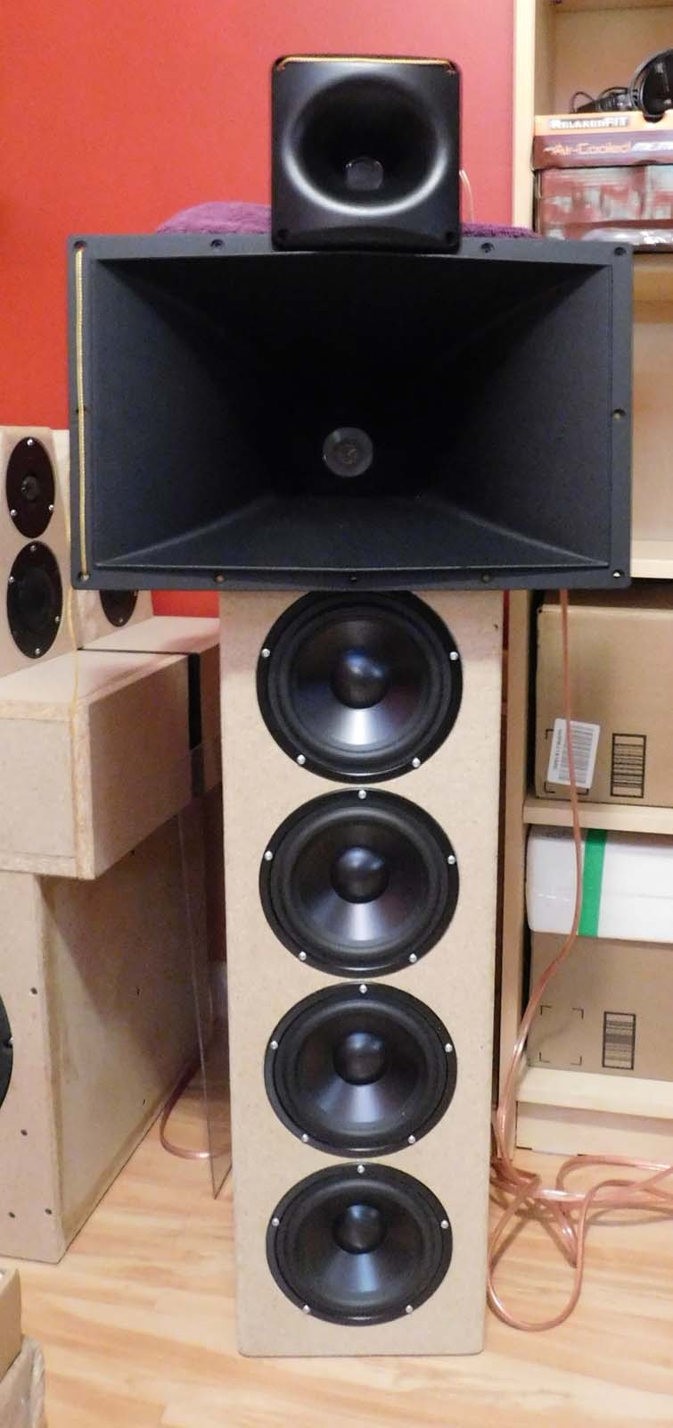

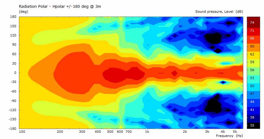

V11 - Quad woofers + ZXPC 11x17 + H07E
Finally, another version to try out. I was attempting to improve the midrange in my horn system by using a 2inch horn that was able to load and control to lower freq. The plots for these horns are in the previous posts. The ZXPC was advertised as 90x40 but realistically its closer 60x40. That's the narrowest polar I've tried, but it easily can handle a XO=725Hz as can the driver D2200Ph. The tweeter is a Dayton H07E with a Fane CD130. I was trying to understand why it behaves so differently from the other versions I have. That's easier to do in a simulator.
The AKABAK simulation uses LR4 XO [725, 4550Hz], some EQ (<+/-3dB), velocity curves from PWT CD measurements, and horn models based on physical measurements, the DSA175 motors were used with simple disc membrane. The polars are not normalized and the SPL curves show the driver contributions. The last graph is the ANSI-2034A (aka Spinorama) report.
This combination has a very different DI and power response from any of my previous versions. The midrange sounds very good as is the imaging (seperation and detail). What I noticed immediately is the power response difference compared to the cone+dome system. Initially it sounded unbalanced, like too much bass or not enough midrange (the system was EQ'd flattish with FIR phase correction). It could be that I'm used to something else or maybe the smaller temporary room I'm in. Still listening to it, and that's good.
The mid / woofer crossover seems like it could do better with some EQ and change of slopes, the vertical lobe gets pulled down with a peak dip combination around that area. Might be worth looking at it to see if it changes your perception at all.

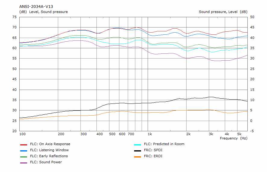

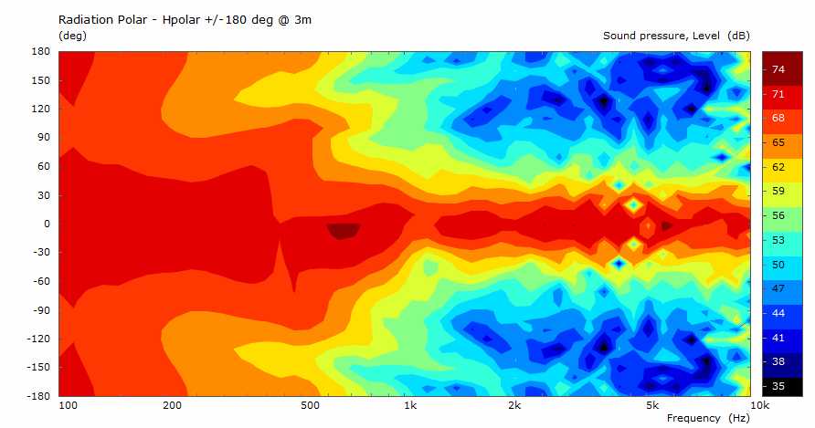

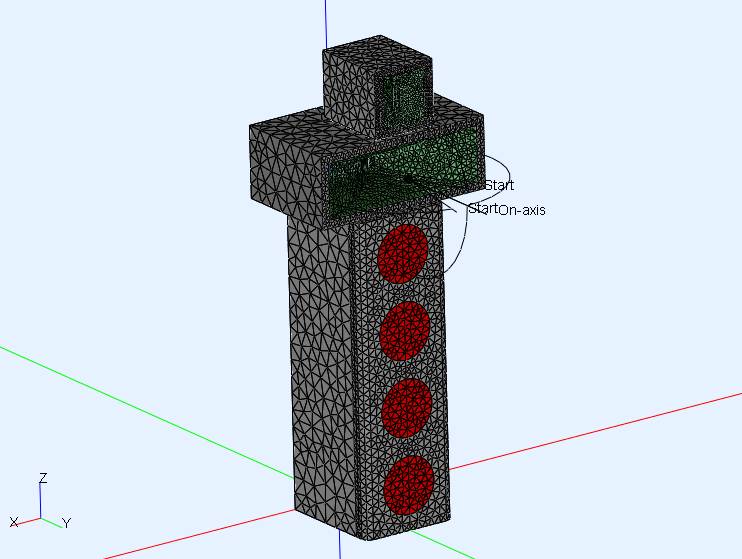

Pic#1 - the AKABAK model

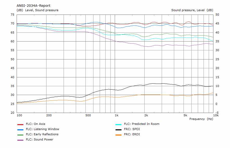

Pic#2 - spinorama report with no EQ applied, any ripples common to all curves can be EQ'd out
Pic#3 - spinorama report with EQ flattish. Power response changes a little, but DI is the same

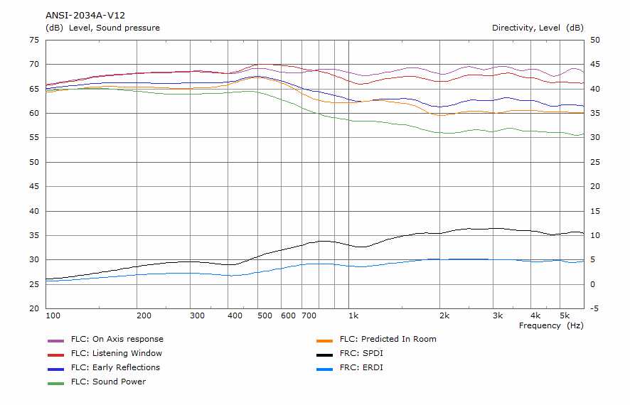

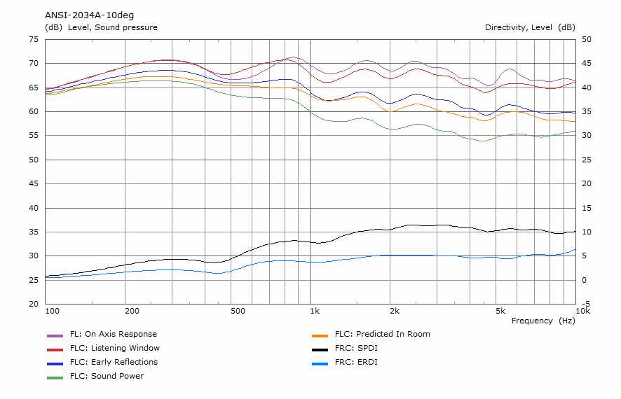

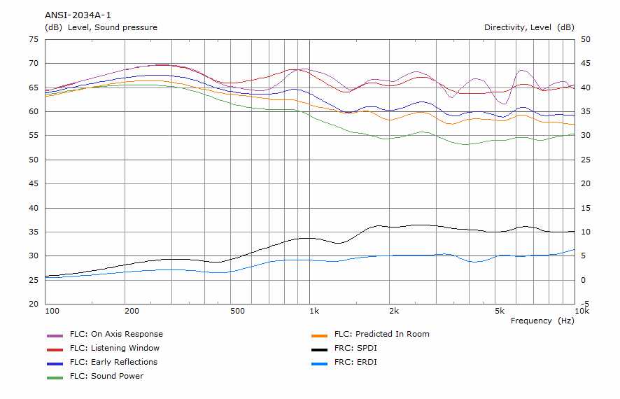

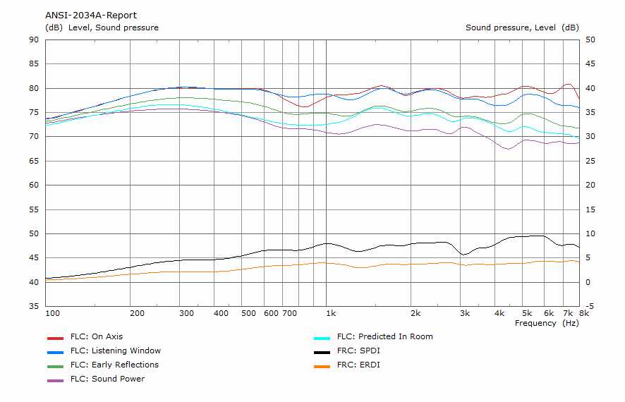

Wondering if a larger woofer (2x12inch) would help the power response. This sim had some problems at >6Khz but it still covers both XO points. The woofer polars are narrowing more but the power response is similar. Really no way around going from DI=1 to DI~=10. The DI slope in the transition from woofer to horn is a bit more shallow this time.
Don - Could you elaborate a bit on what aspect of the power response needs help? It does not look to me like there is anything to complain about.Wondering if a larger woofer (2x12inch) would help the power response.

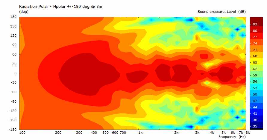

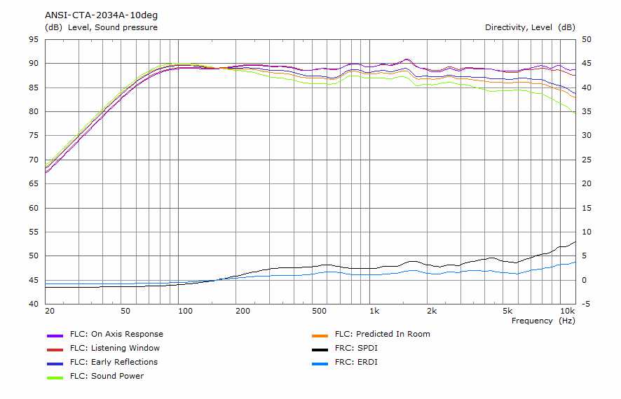

Compare these two speakers. The axial response is kept flattish is both cases.
V10 (built) has a smooth 5dB power drop across 200Hz-7Khz. It's at the expense of low DI, however it still images well and it sounds balanced.
V11 (built) has a 10dB power drop across 200Hz-7Khz, and most of that is actually across 500Hz-2Khz and it's noticable. The image and clarity are noticeably better than V10, but it's at the expense of sound power variation. So now I'm wondering how wide does that transition (DI=1 to 10) needs to be,?
Hence the V12 (sim only, above) which spreads (smooths) the transition (still 10dB, 500-2Khz) using larger woofers but maybe not enough.

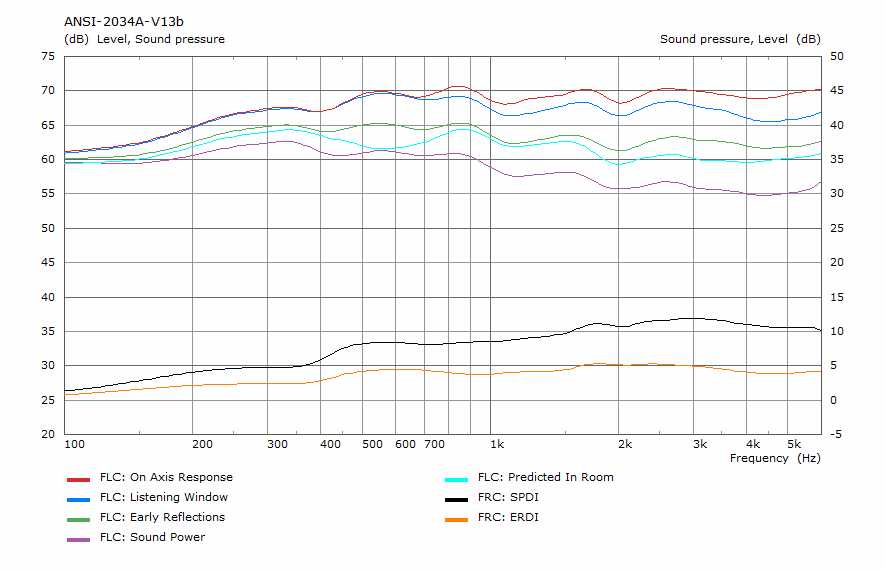

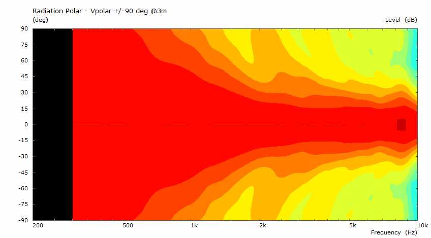

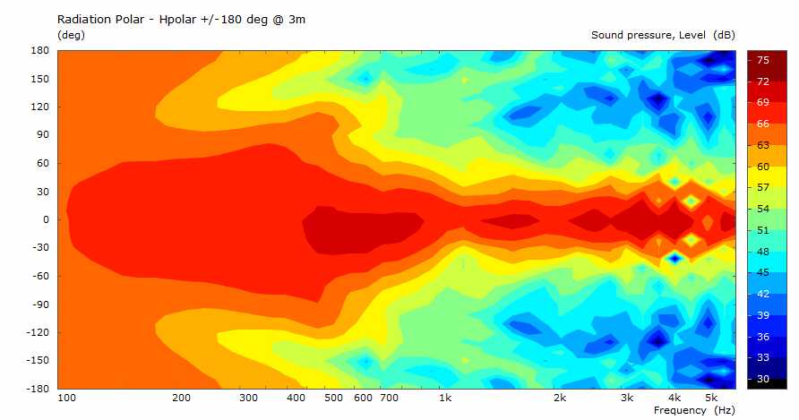

Digging up speakers from the past. This is V8 (built) with updated simulation model and EQ. It uses a SH402 (90x40deg, DI~8) horn for the midrange. The sound power response is more even (than V11) and the difference ~5dB. The D290 driver and SH402 horn struggle to hit 725Hz. The horn looses pattern control and both need significant EQ (+8dB total ) to get a flattish response at XO. However the wider pattern also means more sound power given a flattish on axis response.

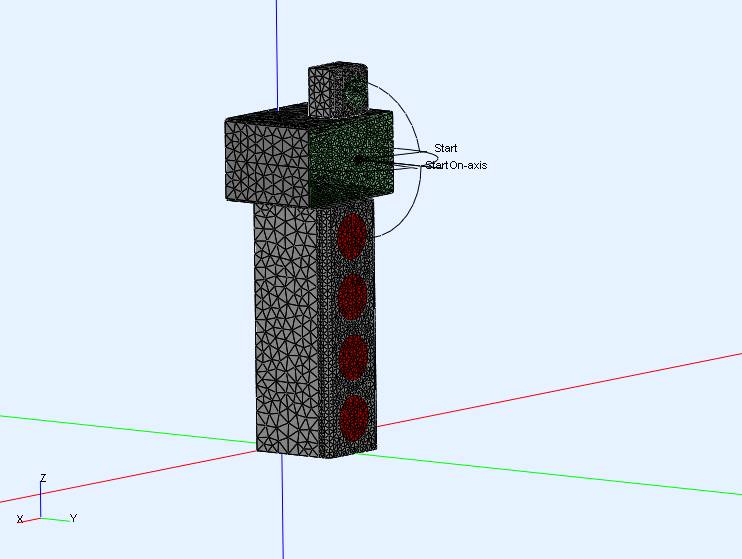

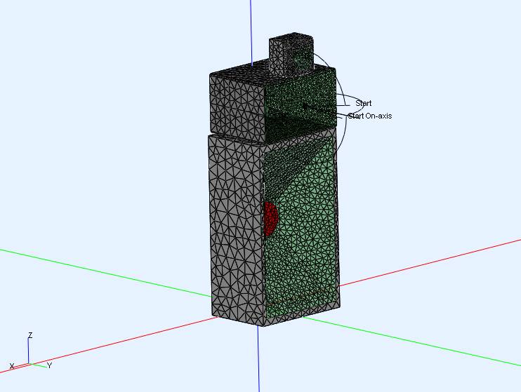

Adding a bass horn V13 (conical flare) to reduce the LF beamwidth and smooth out the power response down to Schroeder.
The LF horn is driven by a 8" Silverflute model. It's not the best fit, but I already have a pair. The horn depth nearly matches the midrange horn depth so no time delay adjustment required. There is no magnitude EQ applied, however the common ripples could be EQ'd flattish. This a better sound power response than V11 or V12 and would be easy to make. Ideally the bass horn would be rotated 90deg, but this orientation still works to reduce the total beam width and not make the speaker footprint too large.

The sim was in 4pi space for ANSI. It should also be checked with a floor (2pi) as it may require changing the horn shape or woofer position. Either way this is an idea worth exploring further.

The bass horn is a exponential (Fc~300Hz). The LF axial response has not been made flat in order to level out the sound power. It would likely need some LF EQ to sound correct
