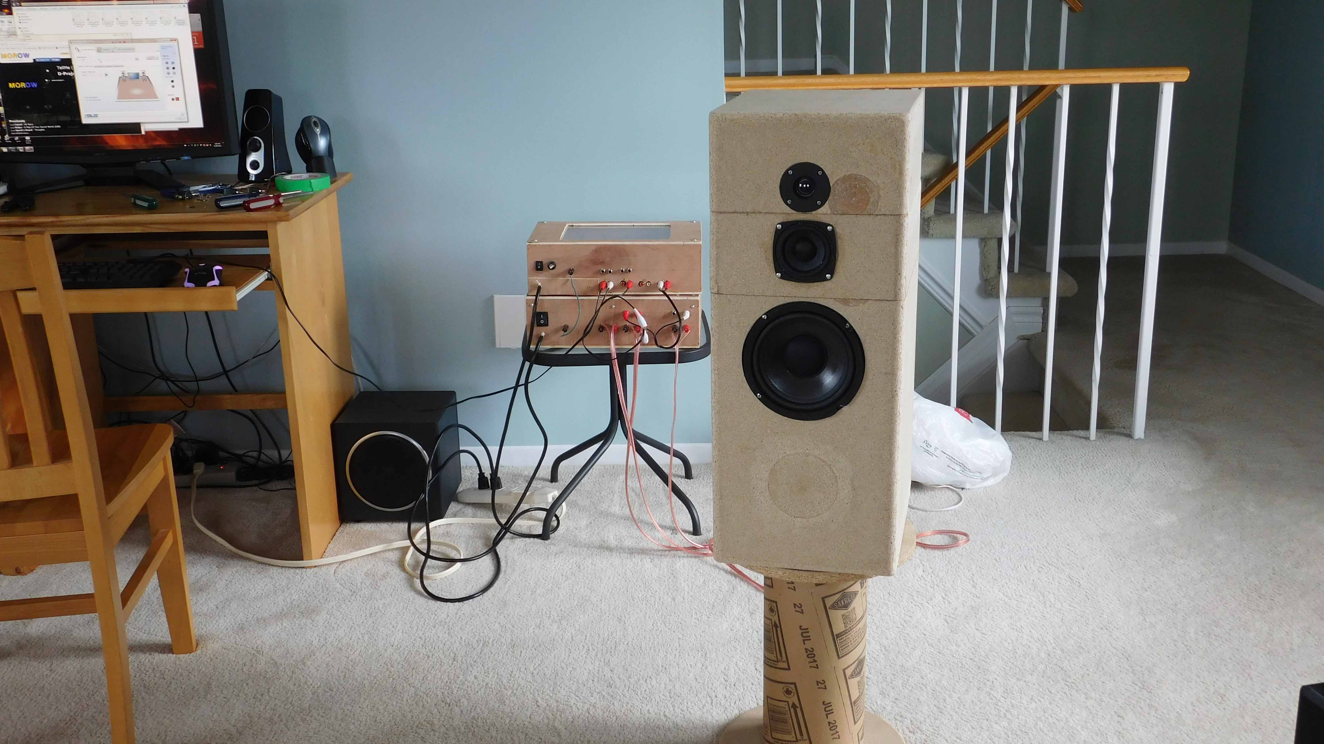

I've attached another pic of the speaker taken straight on. The numerous curves are giving an optical illusion when the speaker is rotated. Everything is symmetric.

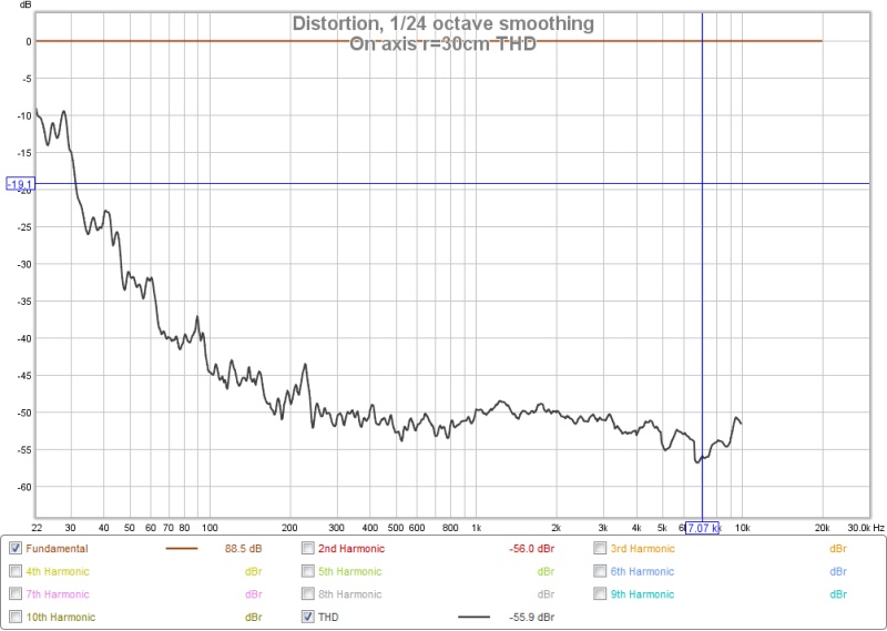

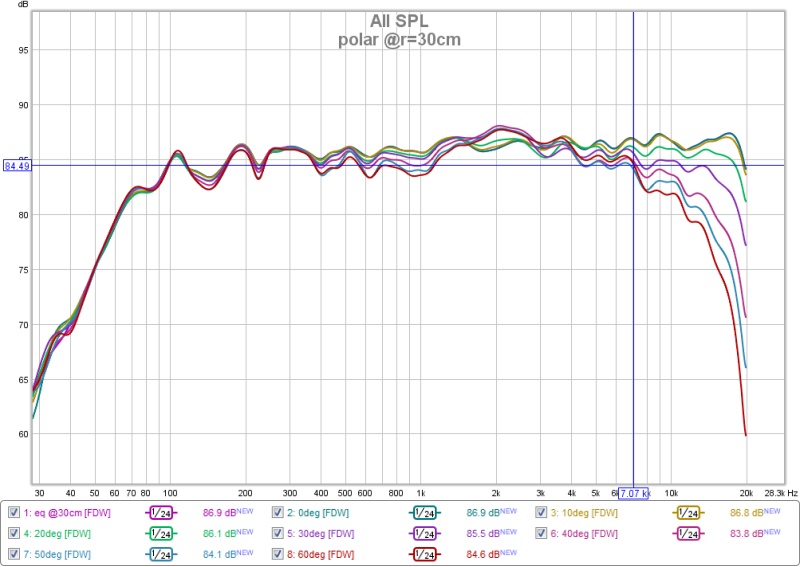

The XO was increased to 7Khz to reduce THD from the ST601. Pic#2 shows a smaller residual THD bump than XO@6Khz.
It appears (Pic#1) that the delay equalization holds until 20deg off axis. Starting somewhere between 20-25deg there is a dip around 7Khz which I'm assuming is XO related, but far enough off axis that I'm not motivated to chase it.
