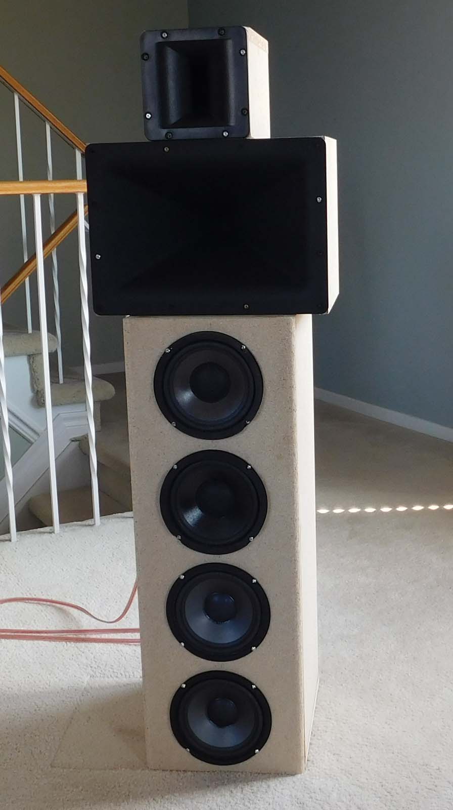

Thanks. The PHRN-1014 is a good neutral sounding horn and it had good reviews so I tried it out. The D290py was suppose to go low enough so it might be this horn (advertised to load to 600Hz). I had better low end on the larger SH-402 (JBL2370 clone). I could raise the XO point a little or as you suggested use a larger driver + horn, once I settle on what I prefer.

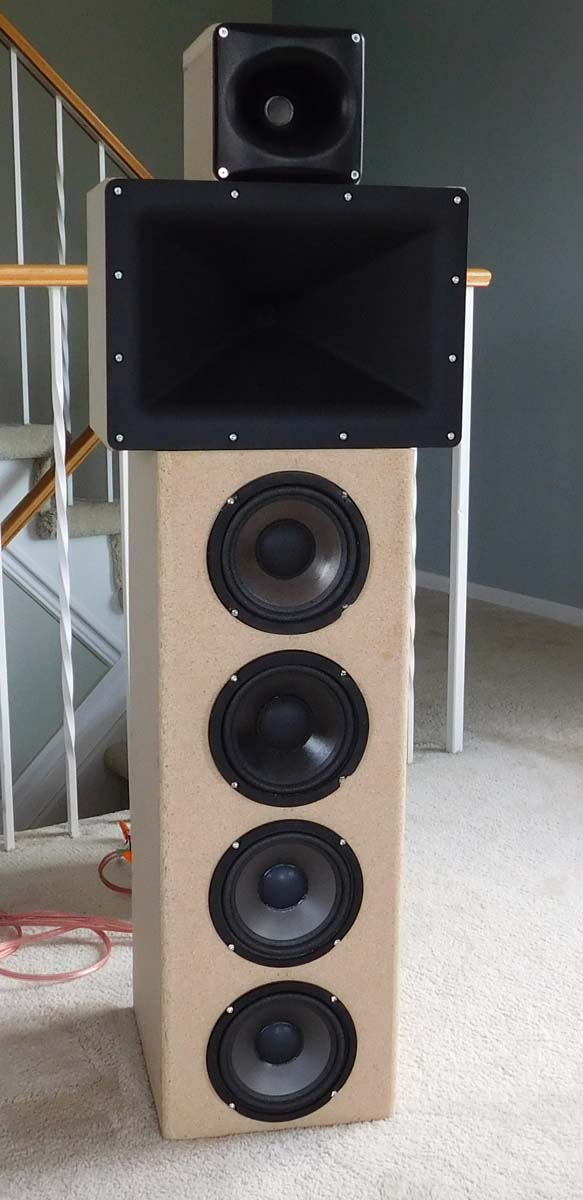

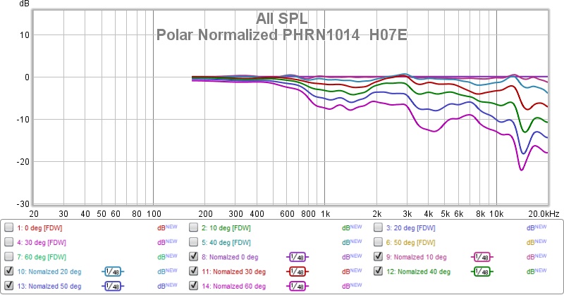

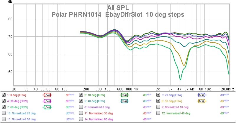

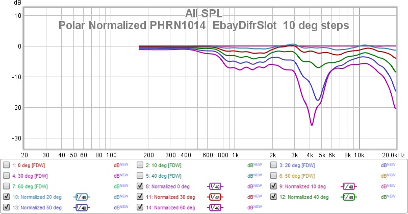

comparing polars 1
I'm satisfied with the sub and woofer arrangements so moving up to compare the polars.
The measurements are @1m @midrange height and gated 5ms. The raw measurement is provide then the "normalized to 0 deg" plot is provide to see the polar with axial variations removed. You can see exactly where the polar narrows from the midrange horn XO=725Hz.
The random ebay diffraction slot tweeter is OK from 0-40deg but at more extreme angles 40-60deg it looks like there is interference from the tweeter diagonal @XO=4550Hz. Both horns are relatively constant directivity. Some of this may be from shifting the horns to get proper axial time alignment. I might look into this to see if it can be improved.
The HE07 is rounded (elliptic) and does not show interference and I assume its because its diagonal pattern is better.

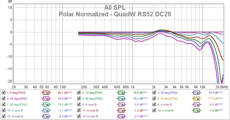

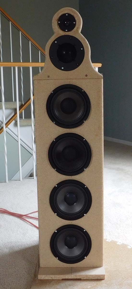

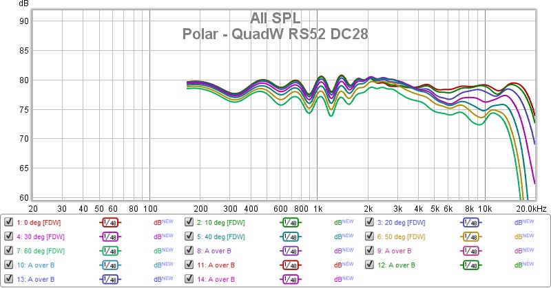

comparing polars 2

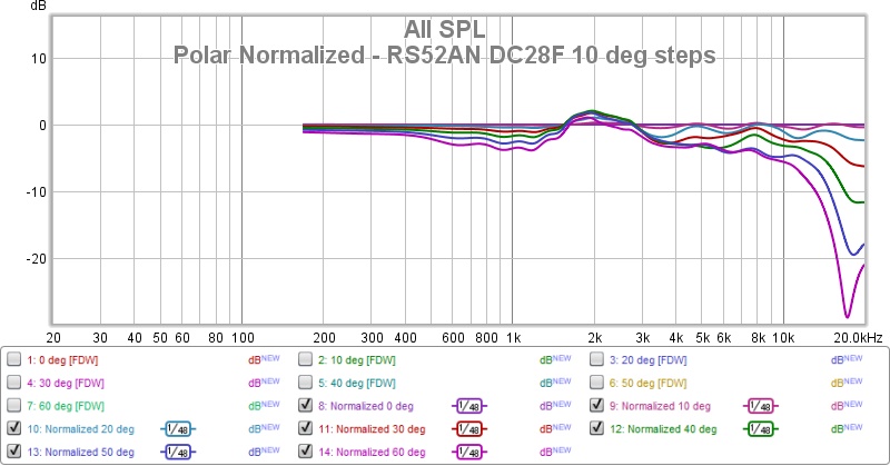

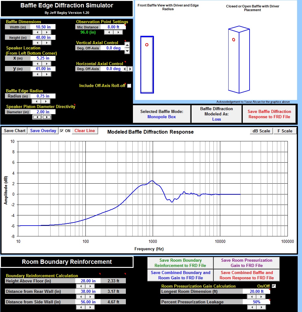

The cone + dome solution has less directivity control than the previous horns. It also has baffle diffraction to deal with.

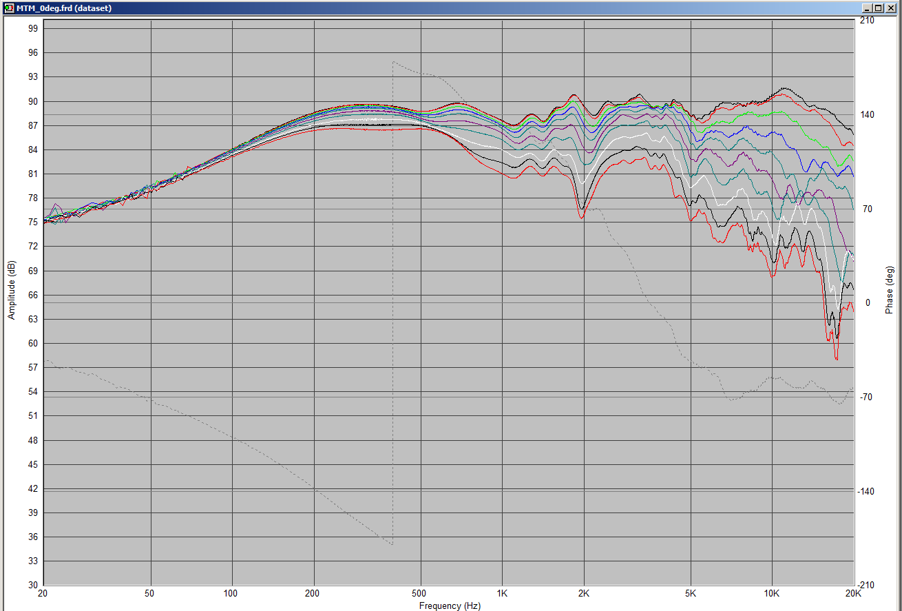

The on axis diffraction prediction (pic#4) was EQ'd flattish (on axis) by applying -3dB@1Khz and +2dB@2Khz corrections. However, looking at the normalized polars it shows that same correction came back in the off axis at 1Khz and 2Khz. The J.Bagby diffraction calculator is consistent with the ABEC BEM sim in post#186
The diffraction needs to be corrected physically by sculpting the baffle for both the midrange and tweeter. Something like the correction in post#186 Modular active 3 way - work in progress
That dip at ~4.5K is definitely odd. I assume if you measure just the tweeter it isn't there.... The H07E definitely looks a lot better.
Can you notice the off axis iregularities in listening in room?
The cone + dome definitely looks a bit amiss around 2K (is that where the crossover is?) It is making me appreciate even more how well my Mid's and tweeters work together. They are not without their problems but their polars are very consistent (not CD but uniform)

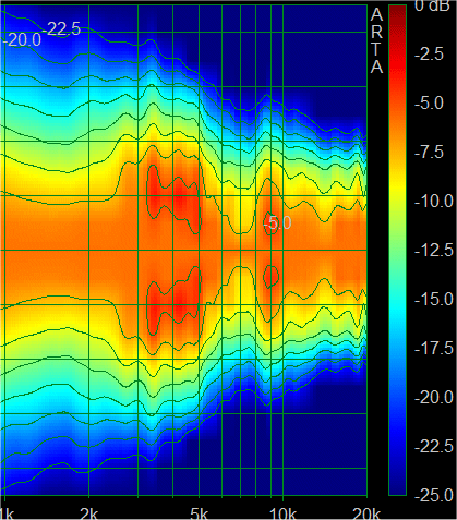

I've attached my polar it is 10deg off axis measurements of my MTM. it's using a semi horn loaded dome tweeter. The 2K dip is an issue with the mids/cabinet and I've never been able to fix it, but it doesn't seem to cause too much of an issue, not sure about the one a bit above 5K but I think it is a diffraction problem.
edit: note that in the graph below crossover is 4th order (acoustic) at 2.8Khz bessel.

The ebay slotted diffraction horn tweeter has the 40-60deg polar dip, IMO is because my measurement position is at the midrange horn and I'm catching the tweeter's diagonal field. It's a square mouth so diagonals are usually not good. It's also why the other H07E tweeter horn is better as it has no corner diagonal, its more rounded. I don't notice it when listening to them as I'm usually within the 40deg. However the horn solution sounds very different from the cone/dome even when they're EQ'd flat.
The XO points are BW2@80Hz, LR4@725 and LR4@4550. I think the polar variation in the mid/high is from diffraction. So a few experiments are coming.
Nice graph. I've always wanted to try Bessel filters.

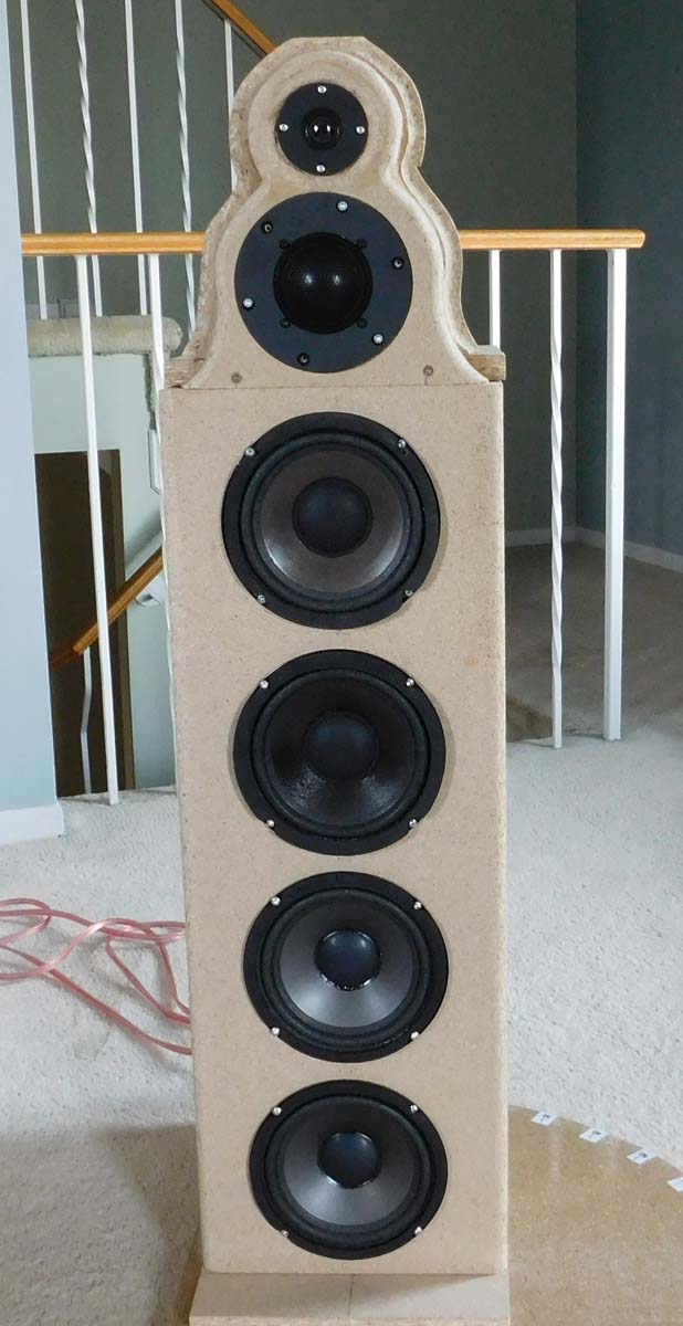

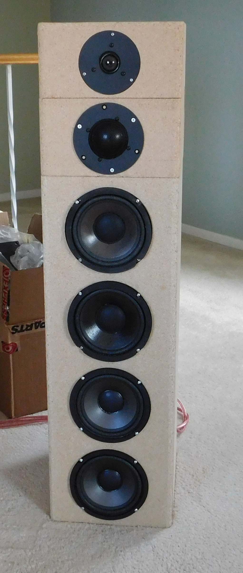

polar 3

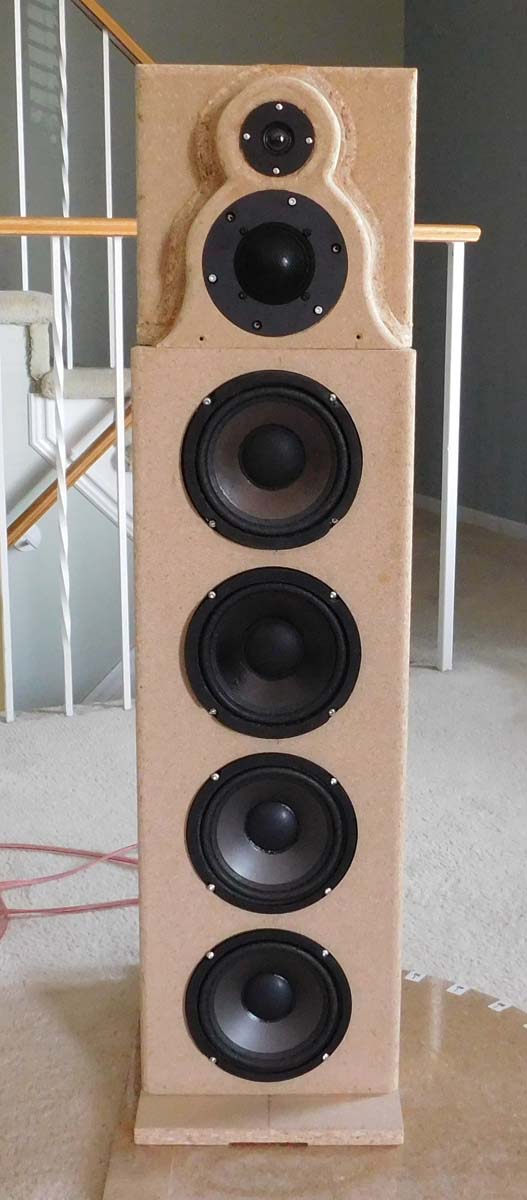

This is the start of sculpting the baffle for mid/high improvements. It's only the first layer so it should improve most of the MF+HF. Measurements @1m at midrange height gated 5ms.
There is more variation in 700-1000Hz because IMO there is change in width from the woofer cabinet. There will be more baffle layers added to widen the back for LF.
There is an improvement seen in the normalized polars. The baffle got narrower and the diffraction ripple is reduced from -3dB@1Khz / +2dB@2Khz to -1dB@2.5Khz / +1dB@6Khz. That is good enough for me.
I also replaced the DC28F (1-1/8") with a TD20F (3/4") hoping to improve the HF off axis. It actually does but it's still -3dB @30deg @15Khz off axis. I think the only way to improve the tweeter's offaxis is a shallow waveguide.

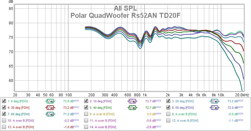

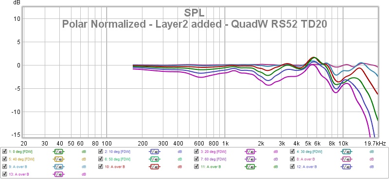

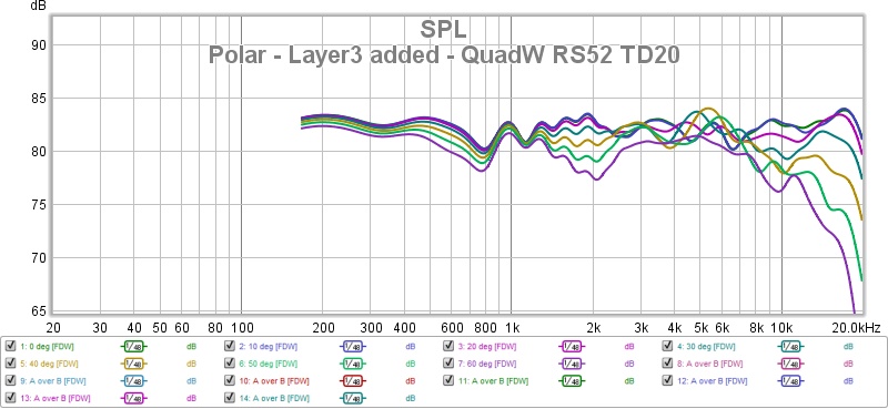

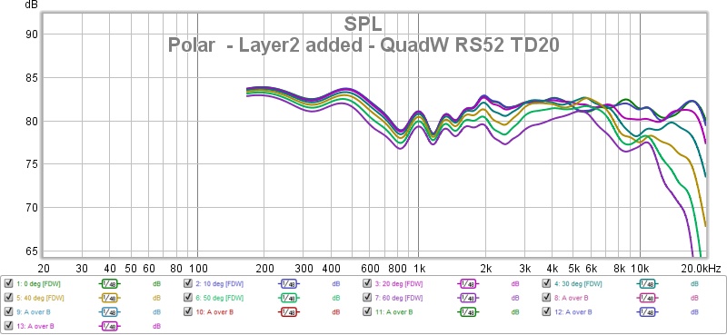

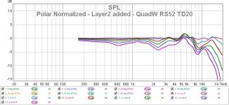

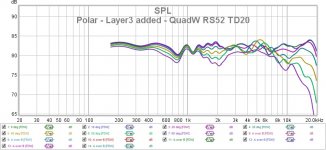

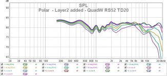

polar 4

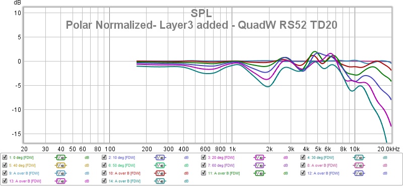

I was curious if adding a wider back, the same width as the woofer cabinet would help the low mid polar.
First pic is an additional layer with cove cut to transition to a flat surface. The second pic is the flat baffle surface, same width as the woofer cabinet.
Clearly more transitions are making the polar bumpier. I think I would be better off with a simple trapezoid with radius edge. 🙂

Interesting! great for really clearly showing how the effects of diffraction show up in a polar response too! My comment about diffraction on my own polars is clearly wrong! 🙂
Can you explain what you are doing for the normalized response graphs? Is it the response if it is eq'ed flat on axis?
Tony.
Tony.
Hi Tony,
I can EQ out the diffraction effects flat on axis but I can't escape them in the polars. Physical problems need physical solutions. 🙂
I EQ flattish (but not obsessively) on axis, take my measurements (gated 5ms + FD8 to smooth), then normalize by dividing all measurements (in REW) by the 0 deg on axis measurement. So the normalized 0 deg curve is now a flat line at 0dB. It's easier to see the polar variations in the normalized curves because it removes the driver's axial variations.

I have found that if the on axis response can be made fairly flat then normalizing to 0 works fairly well.
In your graph a flat axial response would be a constant color at 0 deg across the freq band. I see that it (colour) varies alot so I would not normalize to it's 0 deg because of adverse effects on the normalized curves.
I see your point. I think we mostly agree, but I think not all others would see the signs before making a normalisation decision. Earl Geddes does not normalise in preparation for inspection either, but goes through by hand the way I've learned to.

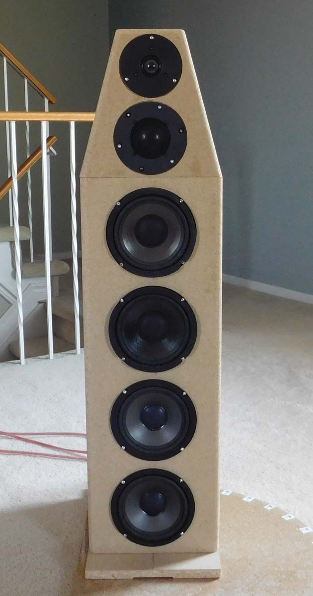

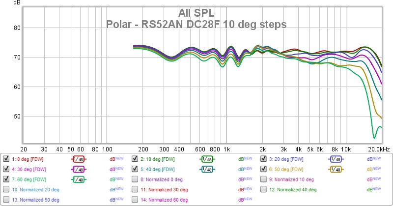

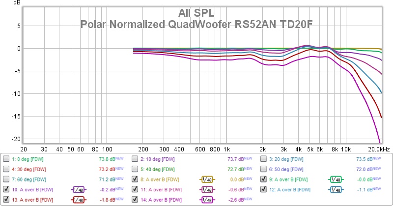

polars
Another kick at the can, trying for a smoother polar.
This trapezoidal design uses the RS52AN and DC28F. The sides slope in at 15deg (off vertical) and the edges are R20mm. Measurements were made at midrange height, @1m, and gated 5ms+FDW8.
There is still a midrange bump (now @2.5KHz) in the normalized polars, however it's moved higher because the avg baffle width has decreased. The diffraction peak has lower amplitude and has been spread out in frequency. I have a new 9Khz dip at >40deg off axis however the LF-MF XO region is similar to the box.
I think it would be better if I used the smaller TD20 because I could increase the slope from 15deg to 20deg (or more) to further spread out the bump. The TD20 also has better HF off axis performance.
