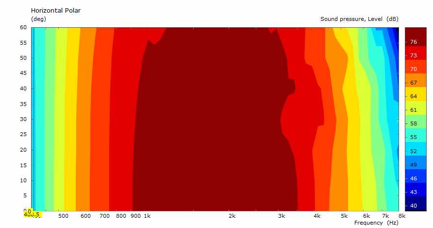

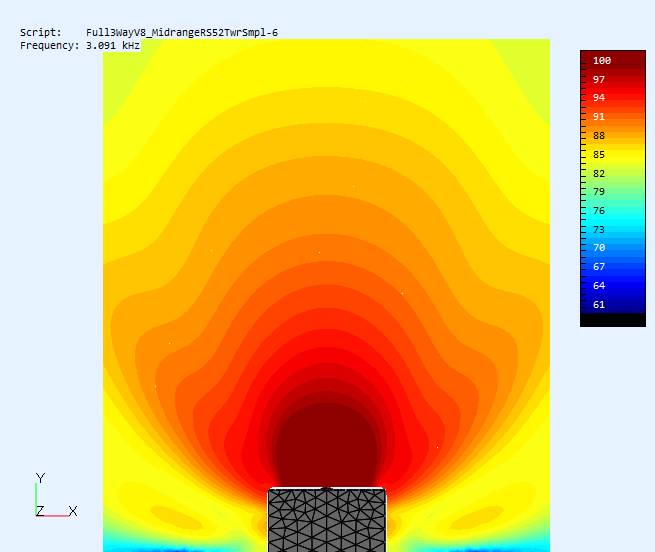

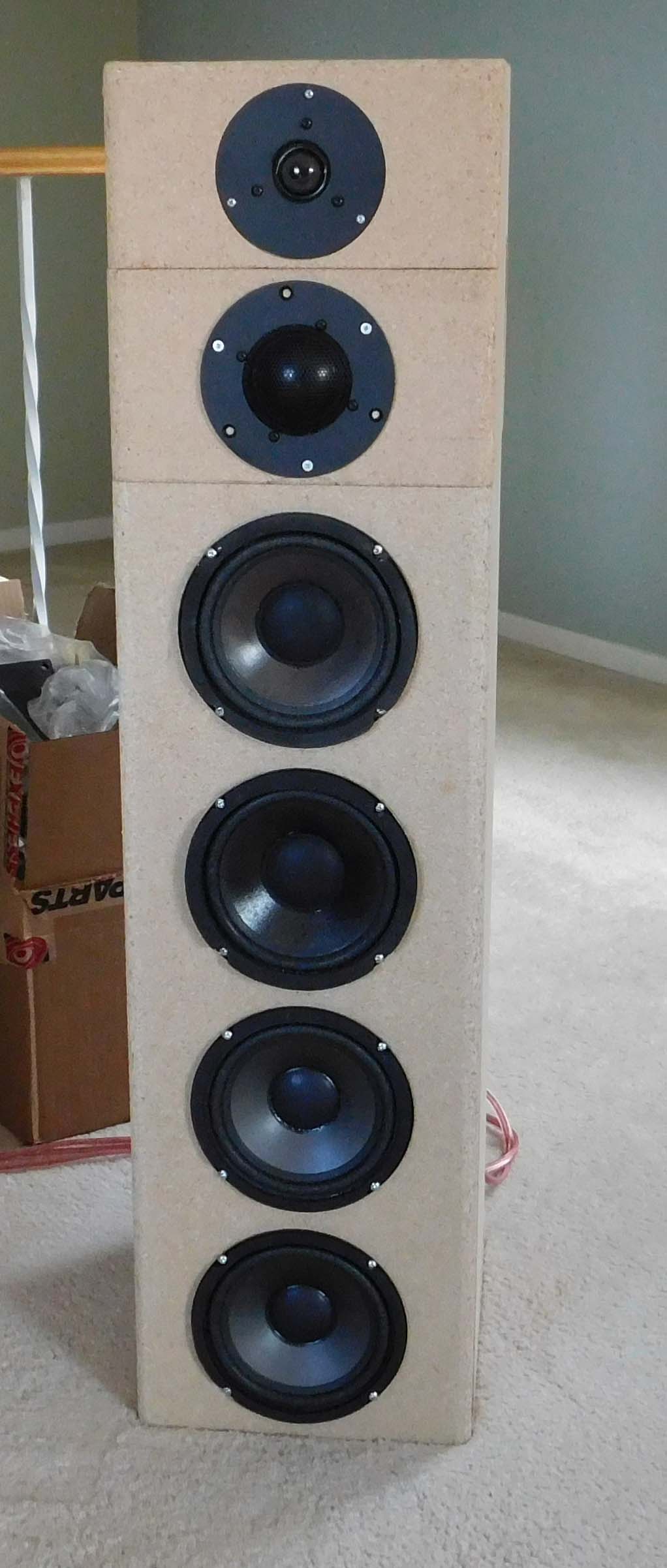

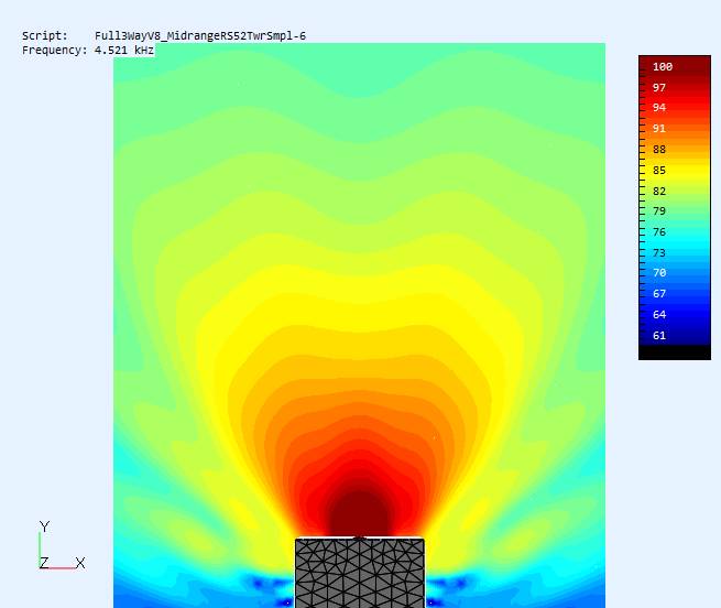

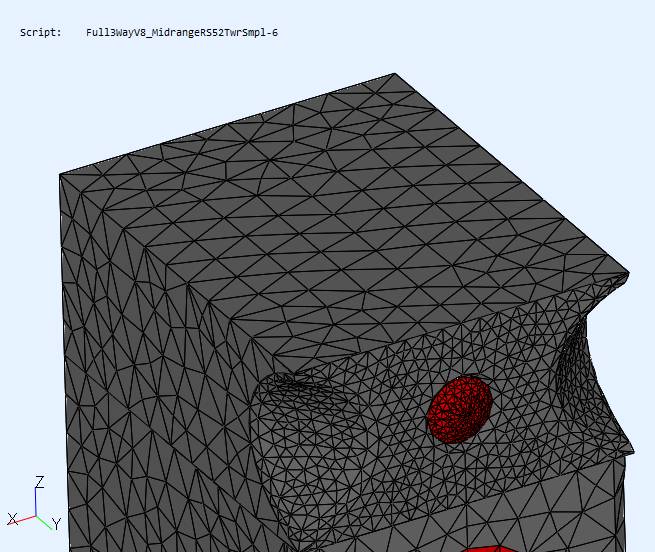

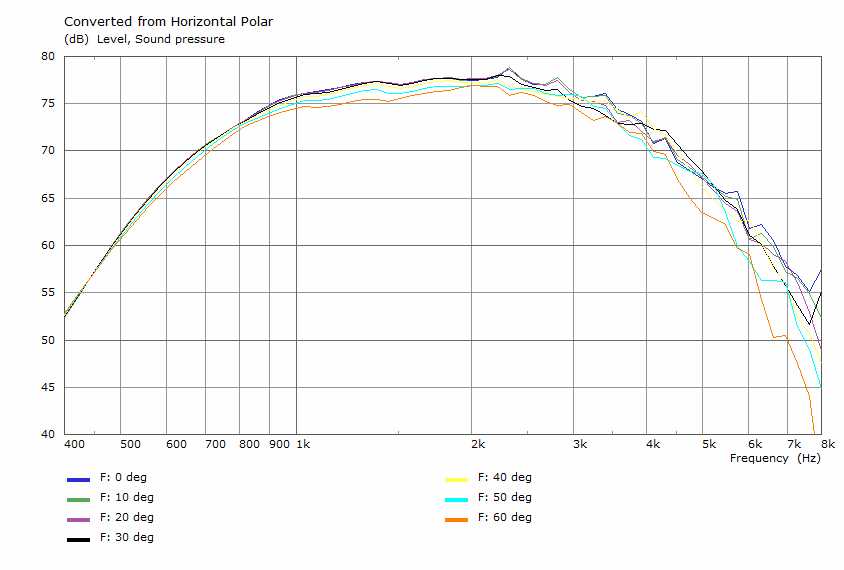

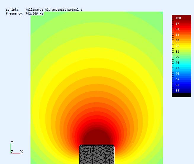

The sides were scalloped out, to reduce the baffle width. Its helps, but the wavefront starts to deform at 3Khz and there is some scattering by 4.5Khz. It think it could benefit from more rounding at the corners and a longer (Z>14cm) scallop. This was a simple cylindrical cut through the edges with some roundover. It's better than a flat baffle <2Khz but choppier above 2Khz.

In my mind I was thinking that you might use the scallop across all three drivers centered on the mid by taking out some of the baffle near the tweeter and woofer. I realise that this is a much longer sim but I think the result would be better.
A longer scallop would provide a smoother transition but would also interfere with a desire to make the speaker modular so I can swap parts. The scallop is not required for the woofers or other potential midrange solutions (cones or horns). So its preferred to have a localized solution.
The midrange sims were used to see how much dome related variation was inherent in the cabinet and whether it could be further reduced.

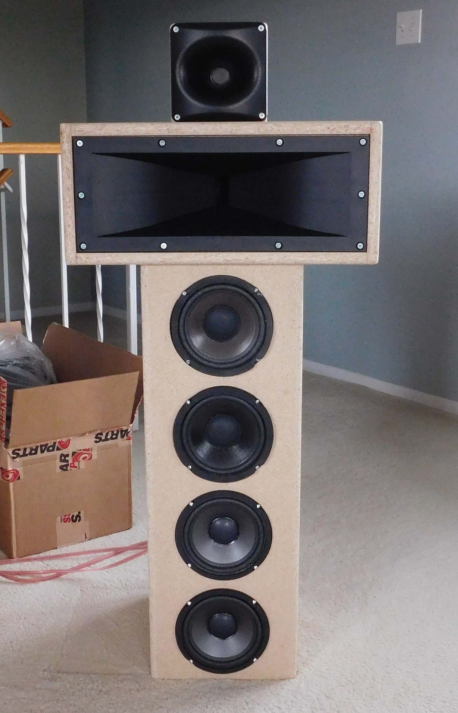

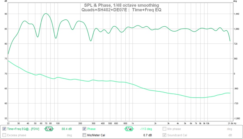

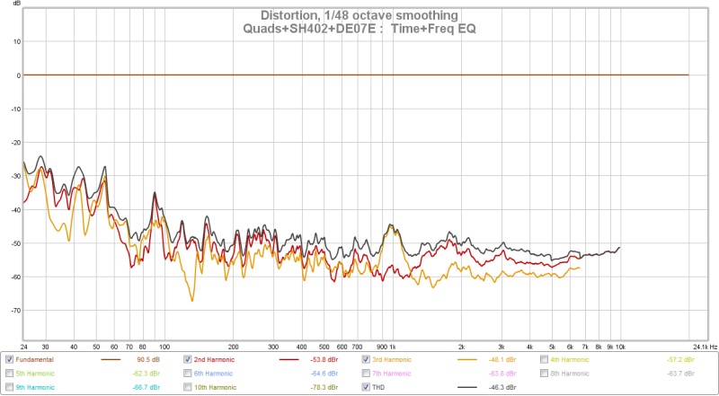

On to some more listening with the quad woofers setup and MF/HF horns replacing the domes.

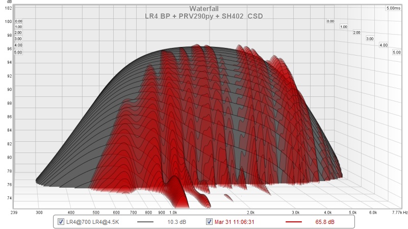

It is much more effort to get everything aligned because the driver coil positions vary so much due to the horn length differences. The horns are moved to time align the drivers and eliminate the MF and HF nulls. Then a bunch of EQ was applied to flattened the FR@1m until I have something that measures like the dome solution. A single BP6 sub (80Hz) is used and there are some LF room issues (nulls) showing up.

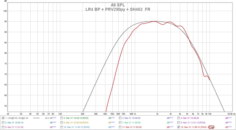

I should add that my MF driver PRV290py-B does not go low enough to cross properly at 725Hz. The SH402 horn is suppose to load to 400Hz so I think it's driver limited. I can EQ the FR flat but the intended lower MF slope (LR4) is not correct. I added a midrange CSD and FR graph to show where it falls short. The HF horn has no problems.
