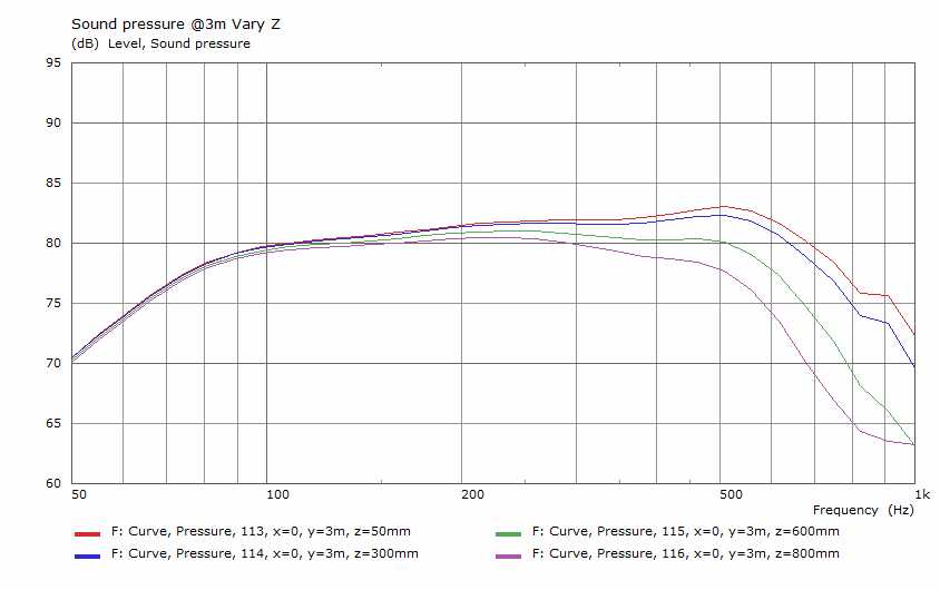

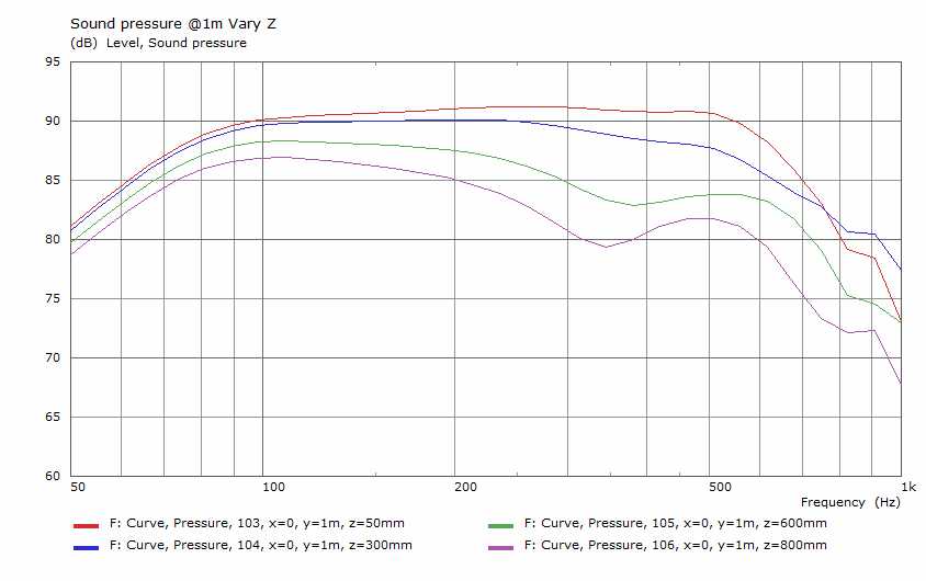

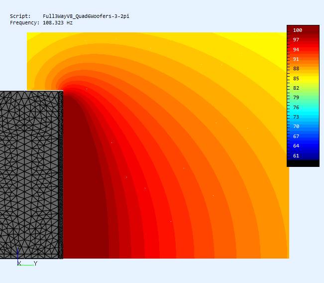

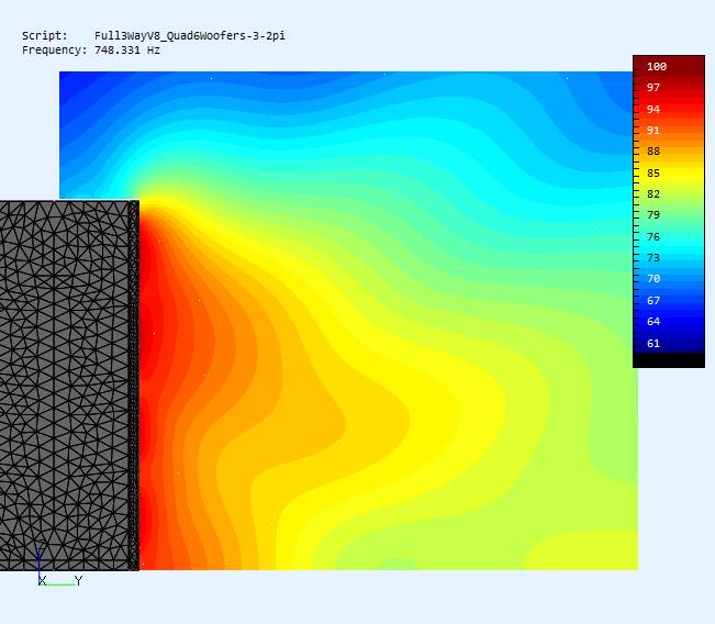

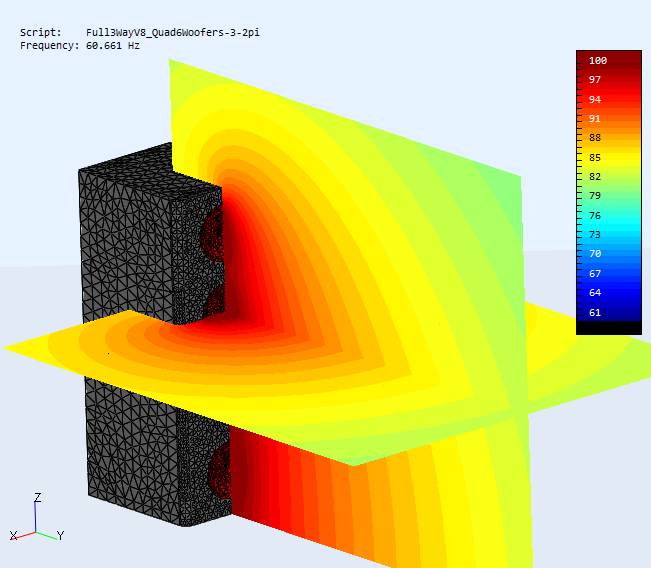

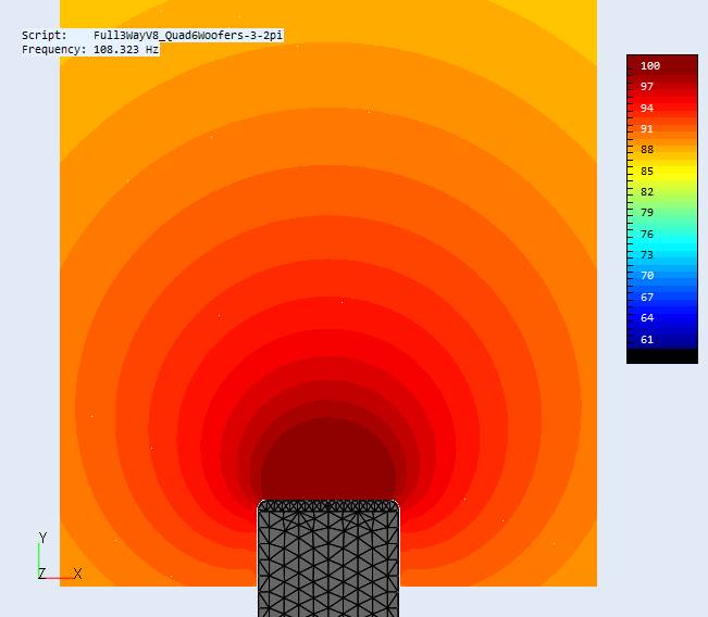

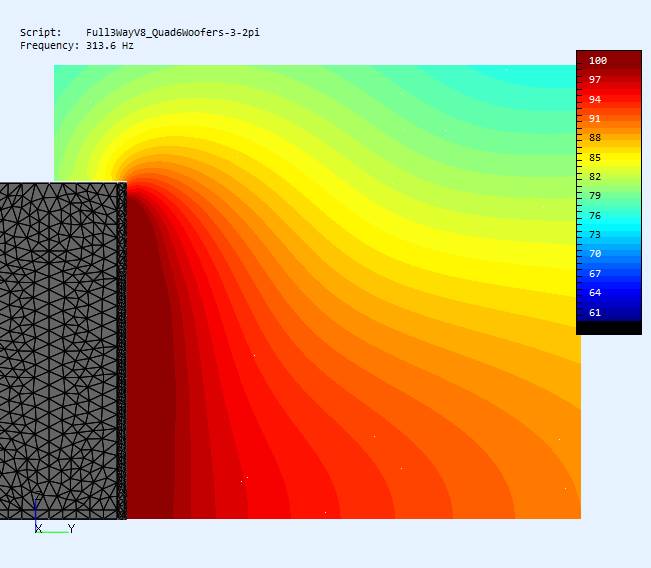

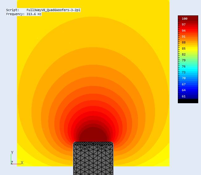

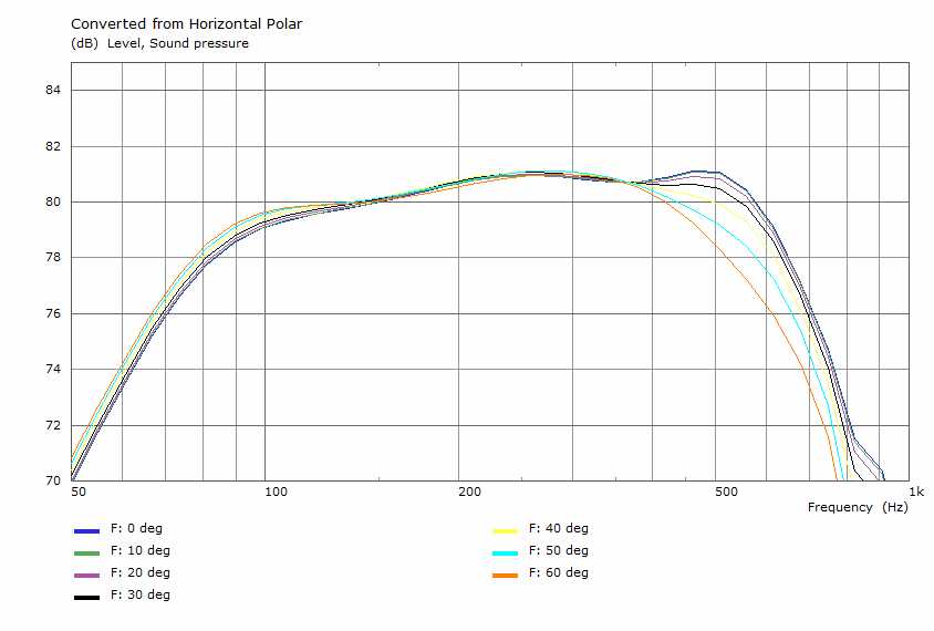

The simulation model can provide insight into the where and why of possible improvements. I already have an ABEC model of this arrangement (speaker sits on the IB floor, pic#1) modelling both the electrical (LR4 LP, driver model) and acoustic (driver membrane, rear chambers, case) components. The cabinet (model and actual) uses an R20mm round over on the side edges. The rear chamber uses moderate damping.
At 1m axial distance the woofer SPL varies a bit from floor (graph#1) but there are no floor bounce nulls. However as you move out from the speaker it evens out vertically (graph#2). I've measured this (earlier post) to confirm the model works properly. I also noticed this when I use different areas of this room from 1m-4m from the speaker.

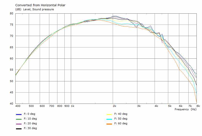

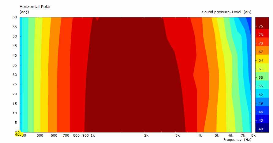

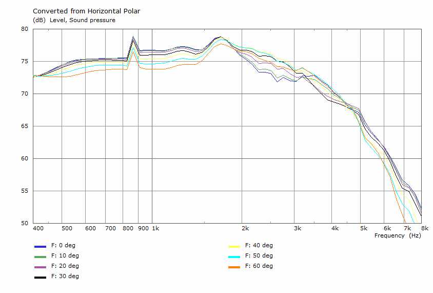

The horizontal polar curves (graph#3) are effected by the driver size, baffle width and round over radius. The baffle width (26cm) is 2x driver diameter (13cm). Based on the curves I don't see any point in modifying the woofer baffle to flattened the curves as they have very low ripple (1dB).

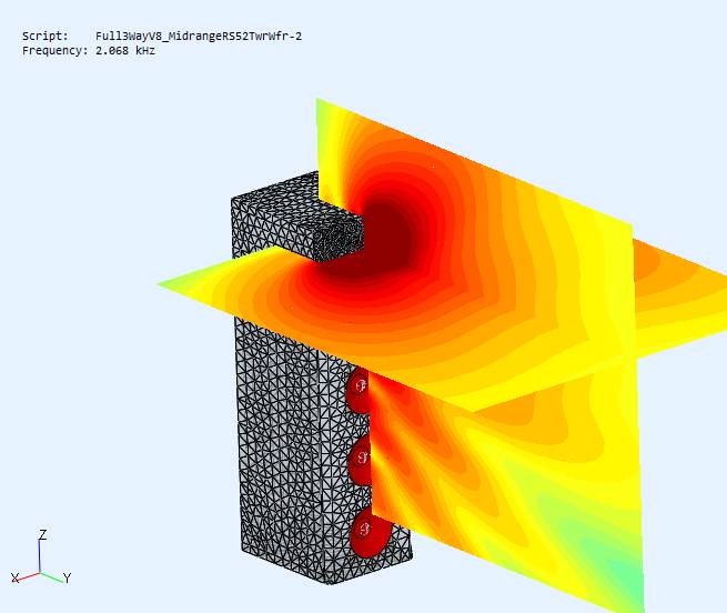

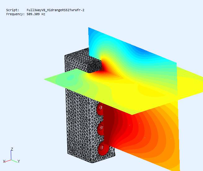

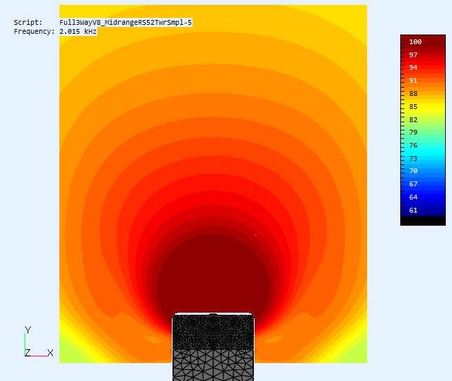

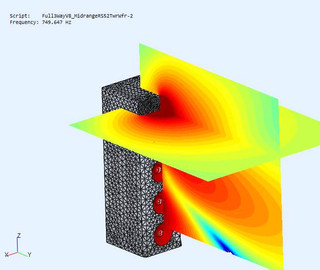

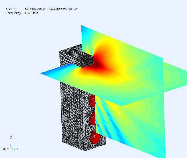

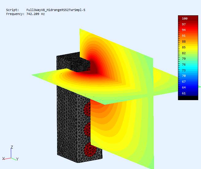

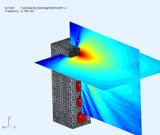

I added a few pics to show the horizontal and vertical fields and how they wrap around the cabinet.

Nice work
Thanks @adason.
We talked earlier about dome midranges with fabric/metal. I really enjoy the RS52AN, it's an excellent sounding midrange.
Your excellent results once more prove that with proper design and the proper processing tools it is possible to make a silk purse purse of a sow's ear audiowise.

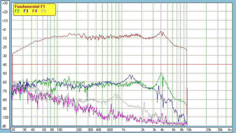

Usually I do not care much for lowend distortion, but the results @30 Hz are just great.
Keep on trucking!
Eelco

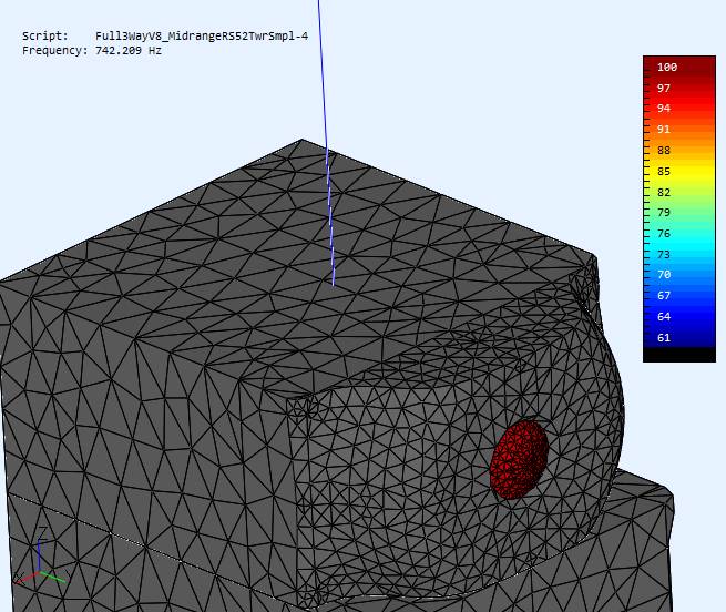

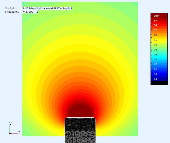

midrange improvements

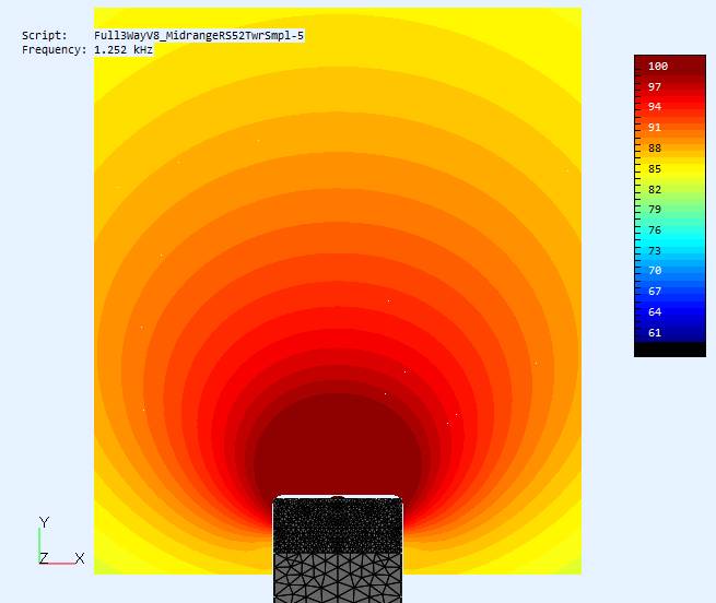

I was looking for a way to improve the midrange off axis performance. The ABEC model's polar response includes the LR4 BP.

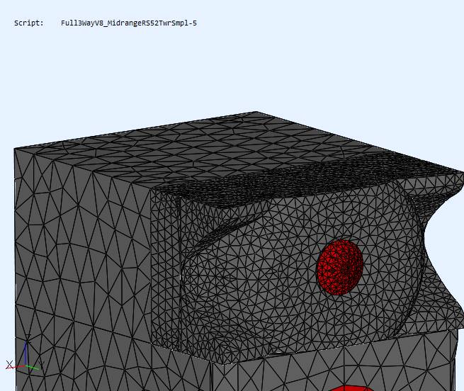

The first pic#1 represents what I actually built. The dome is 50mm, baffle is 260mm, and R20 roundover. So the flat baffle is approx 5x the driver Sd. It's not bad (graph #1), I was just looking for an improvement.
The baffle "wart" (pic#2) could be made from 3 layers of 20mm wood routed seperately "round over -> chamfer -> cove" then glued to form the shape. The midrange mounting disc is large (120mm) so it limits what I can do (...and I'm not removing it). The shelf lip caused by the lower woofer cabinet is still causing some diffraction at higher freq (graph#2) but the trend is improvement. It justifies a few more passes at smoothing this out. The idea was inspired by the Revel Salon2.
The 4x6.5 is more consistent (even) with distance, sounds cleaner and more detailed. The concept is good enough to invest in better woofers because these budget woofers start sounding muddy when pushed (>95dB@1m) which is OK for the test as I rarely play that loud.

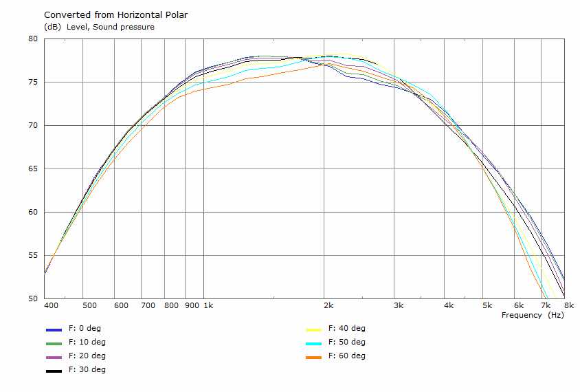

Is it possible to render a polar map for the whole speaker in it's latest iteration, horizontal and vertical?

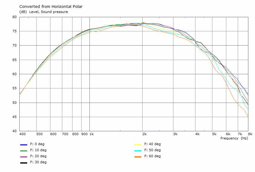

This is for 4x6.5" and the flat baffle midrange model. I use a LR4 BP XO and this is 4Pi space (no floor).
The Hpolar is 0-60deg there is a little variation as expected because there is very little beaming. The measurements are at midrange height @3m out, but these will vary based on where the "mic" is placed that's why I also like to look at the SPL fields. You can see diffraction and nulls off the woofer cones directed to the floor where (at these freq) can be absorbed by the carpet (but not in this model). There is a "sharp peak" (~805Hz) in the Hpolar due to limited samples in this freq range (3), it should be a bump with more samples.

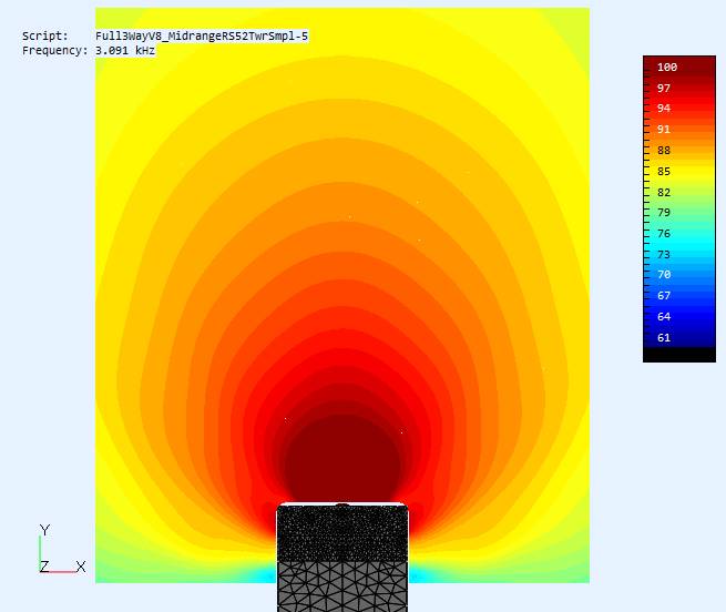

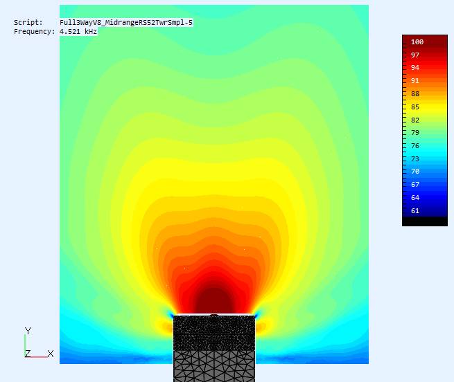

Another attempt to improve the midrange dome H-polars. Some more blending to match the lower woofer case and upper tweeter case (not present) and remove the step.
The polar is getting smoother and the horizontal fields are looking better. There just a little field deformation near the upper XO (4.5Khz). It's getting closer to what I want.

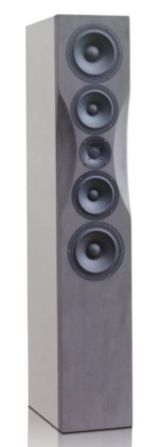

I quite like the scallop on the DXT-WAVE
Heissmann Acoustics | DXT-Wave | d appolito tower speaker
Some information here on how it was made
Diskussion zur DXT-Wave von Alexander Heissmann
Hi Fluid,
A good idea, thanks for the link. The scallop would provide the needed reduced baffle width at the dome. I would like to limit Z=14cm for my midrange section. A scallop would also be easy to fabricate. It's worth a try, lets see what it does. Should have something tomorrow.
