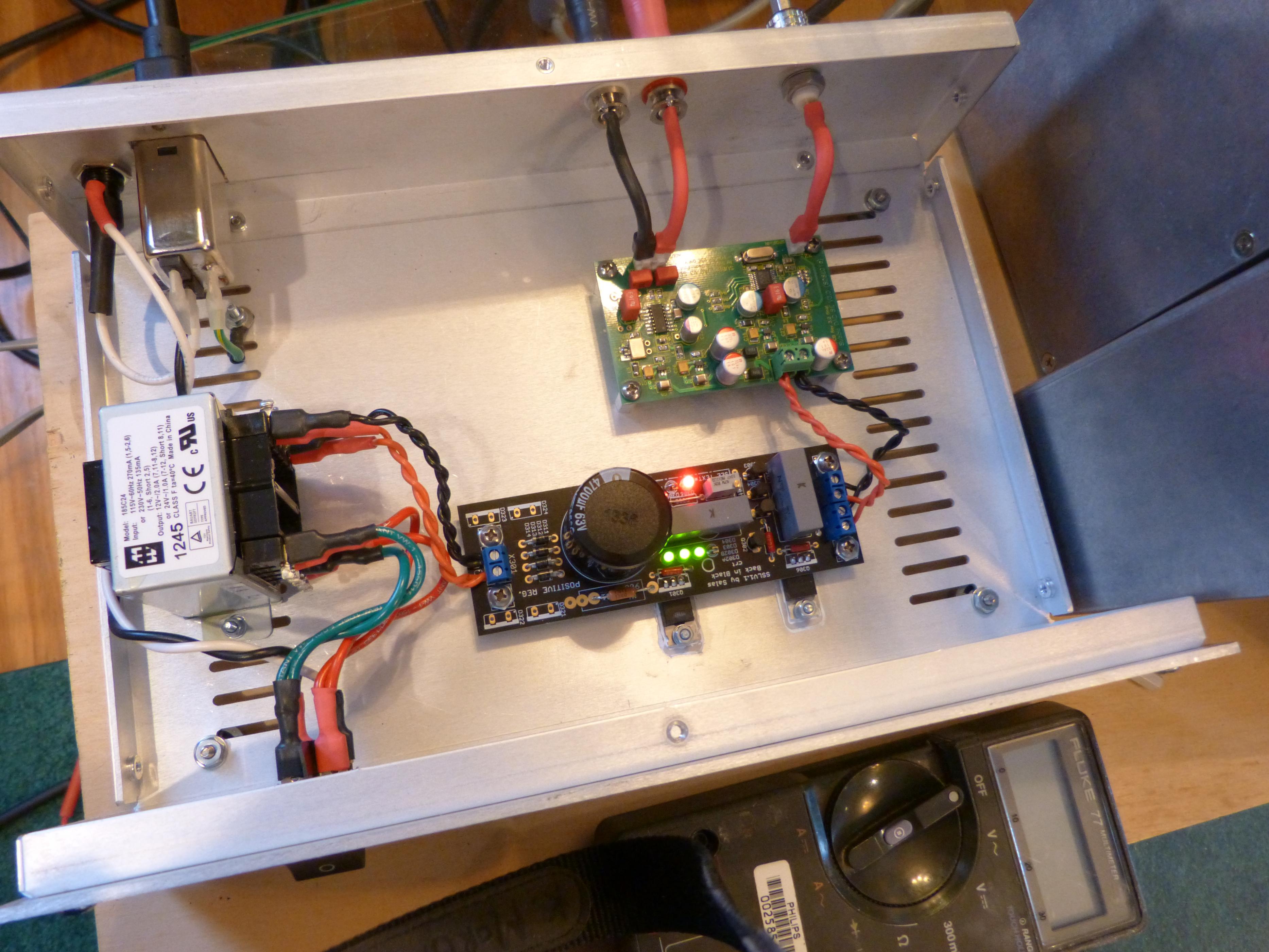

Hi everyone,
I just wanted to share my latest pictures of my favorite DAC.
I included photo of my bi-amped speaker system just for your reference. top unit is stock Nola Mini. Bass unit is TiVi M8a bass reflex crossed at 350Hz.

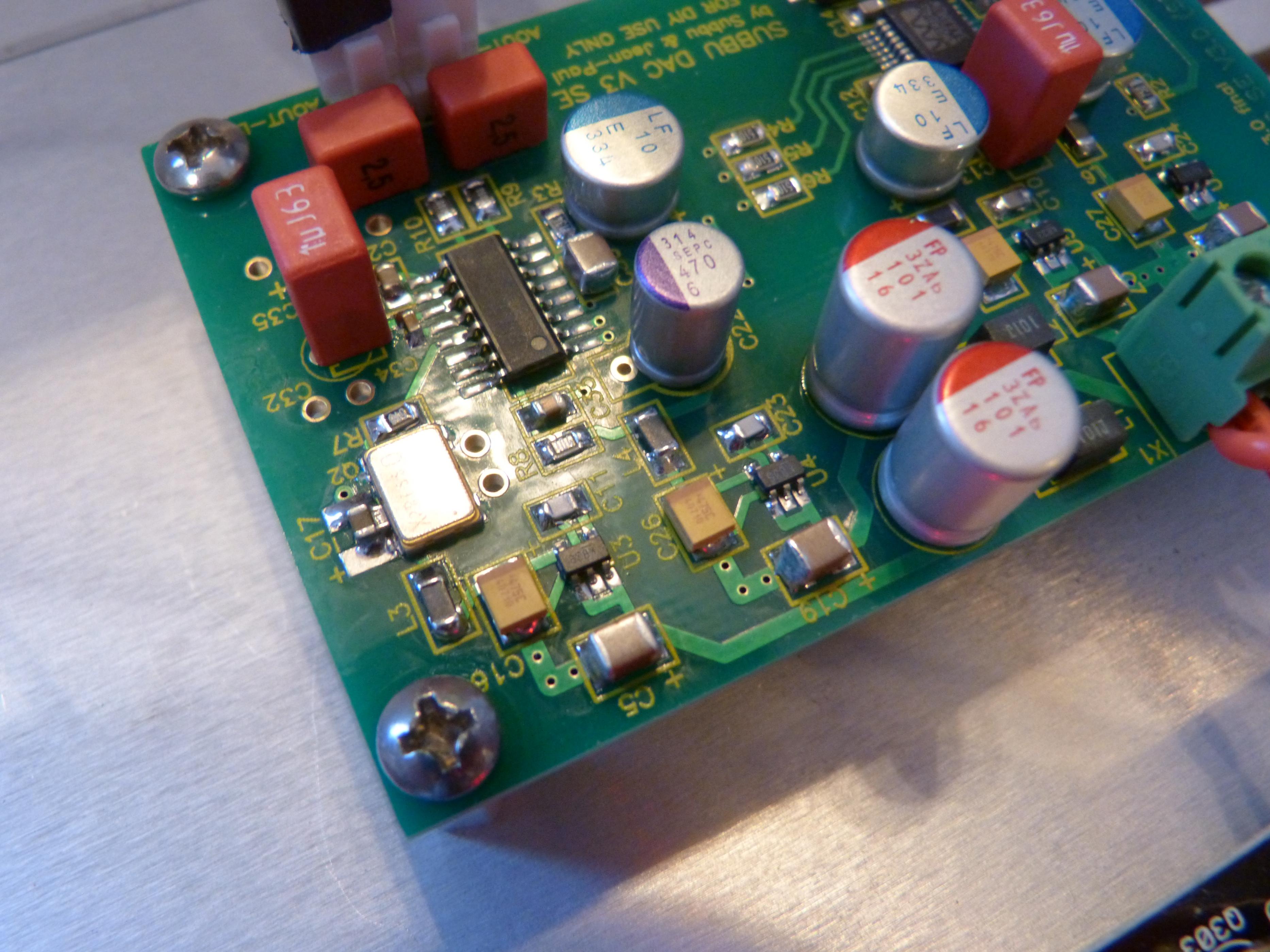

For C17, I have a 1uf X7R bypassed with 1nf. I hope you can see it. The 1nf is 0603. For C35 and C4 I use 1uf Wima. It seems the best set up for me. I think I've used every combination of mods on this thread. I think I ready to close the case. The PSU of course is the Salas BJT shunt. I think it is an improvement over the standard PSU. Bass has extra definition plus extra degree of smoothness with the Salas. Thanks everyone. 🙂

That is a beautiful build Freeman ! Exactly as I envisioned the placement of transformer and boards when the DAC board was designed. Since I like this build a lot I will mention some of the things that discern it from others:
1. Shortest possible connections.
2. Non ferro aluminum (aluminium) case.
3. PE connected to case, audio GND floating (uh oh, beware for comments!).
4. Solid mains switch.
5. Mains voltage connections safely insulated, something rarely seen in DIY gear.
6. Mains wiring far away from audio circuits.
7. Transformer far away from audio circuits.
8. I see you also use a mains filter. One question about that: did you listen to the DAC with and without the filter ?
9. SPDIF and L + R connector insulated from case.
10. PCB has been cleaned, no debri from flux.
I do notice some dry joints on the regs or am I mistaking ?!? I use physically smaller 10 µF caps but that is a tiny detail. I don't understand the double and twisted wiring but it sure looks good 😉

Thanks Jean-Paul,
I see the dry joints now too. I also tried the Subbu with and without my B1 preamp. There seems no difference. I haven't tried the JG buffer yet. Do you still prefer the Subbu without buffer?
Hi I never got hold of one. I also like my DIY stuff to be mounted nice, safe and aesthetically pleasing. Like you built your V3. Could not figure out to use the JG board in a neat way with our board. There was the option to design a "Subbu JG Buffer" PCB for the buffer combined with a symmetrical PSU roughly the same size as the DAC board but it did not materialize. The buffer design is not ours and it feels kind of awkward to get in the way of the people that designed and sold that design (even if they would have allowed that, who knows).
OK, good that the filter is an improvement. The original PSU has a common mode filter so with that one a mains filter won't improve matters as much.
Sorry folks, I could not resist. This a technically a very nice build and it can serve as an example of how to encase the V3. The mains wiring to the transformer could be a few cm further away from the low voltage secondary wiring but this is nitpicking. In true Spartan style there is not even a power LED, the "1" on the switch is all you need. Nothing that distracts from its function. No features but good sound. What else matters ?
