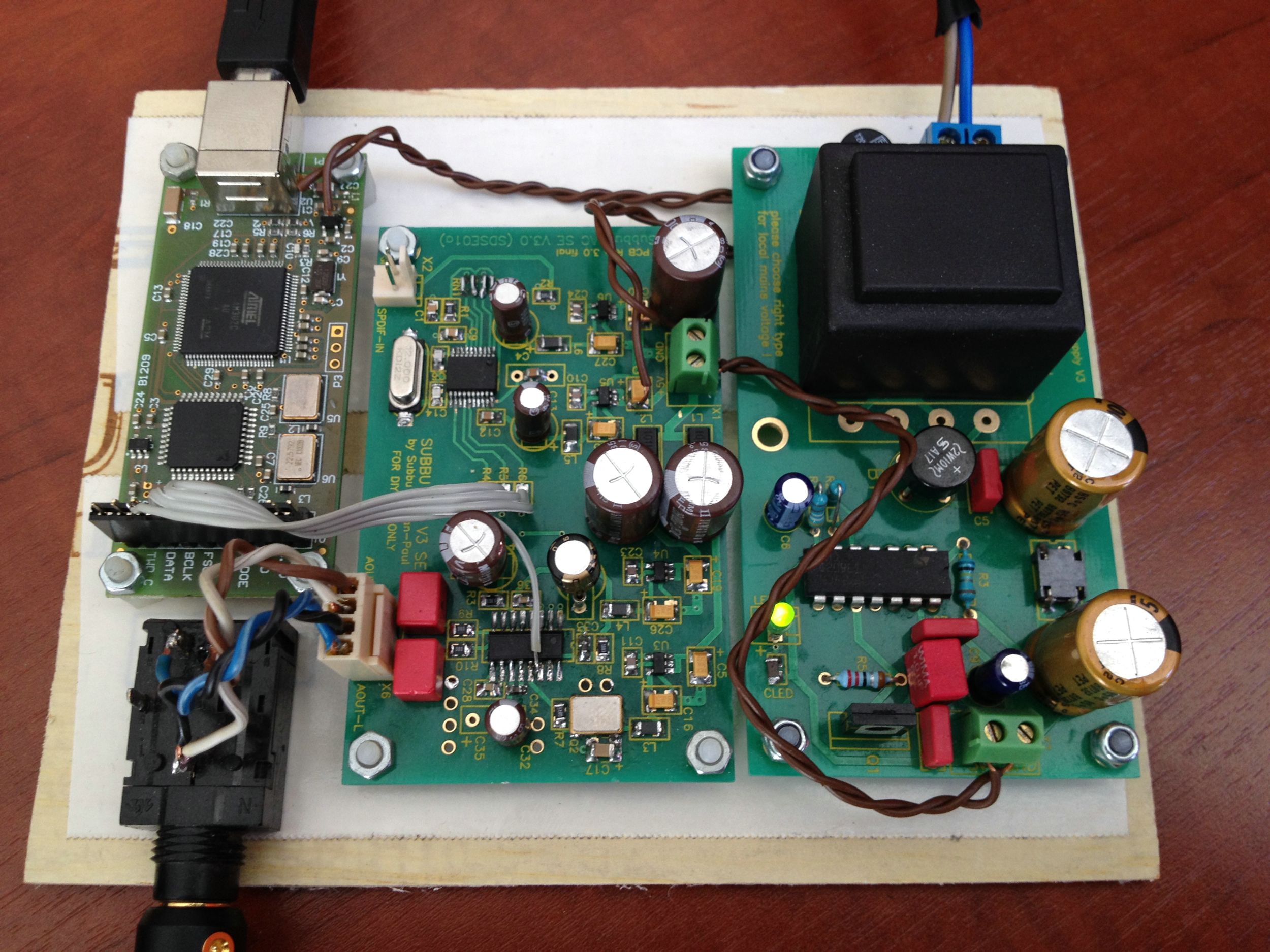

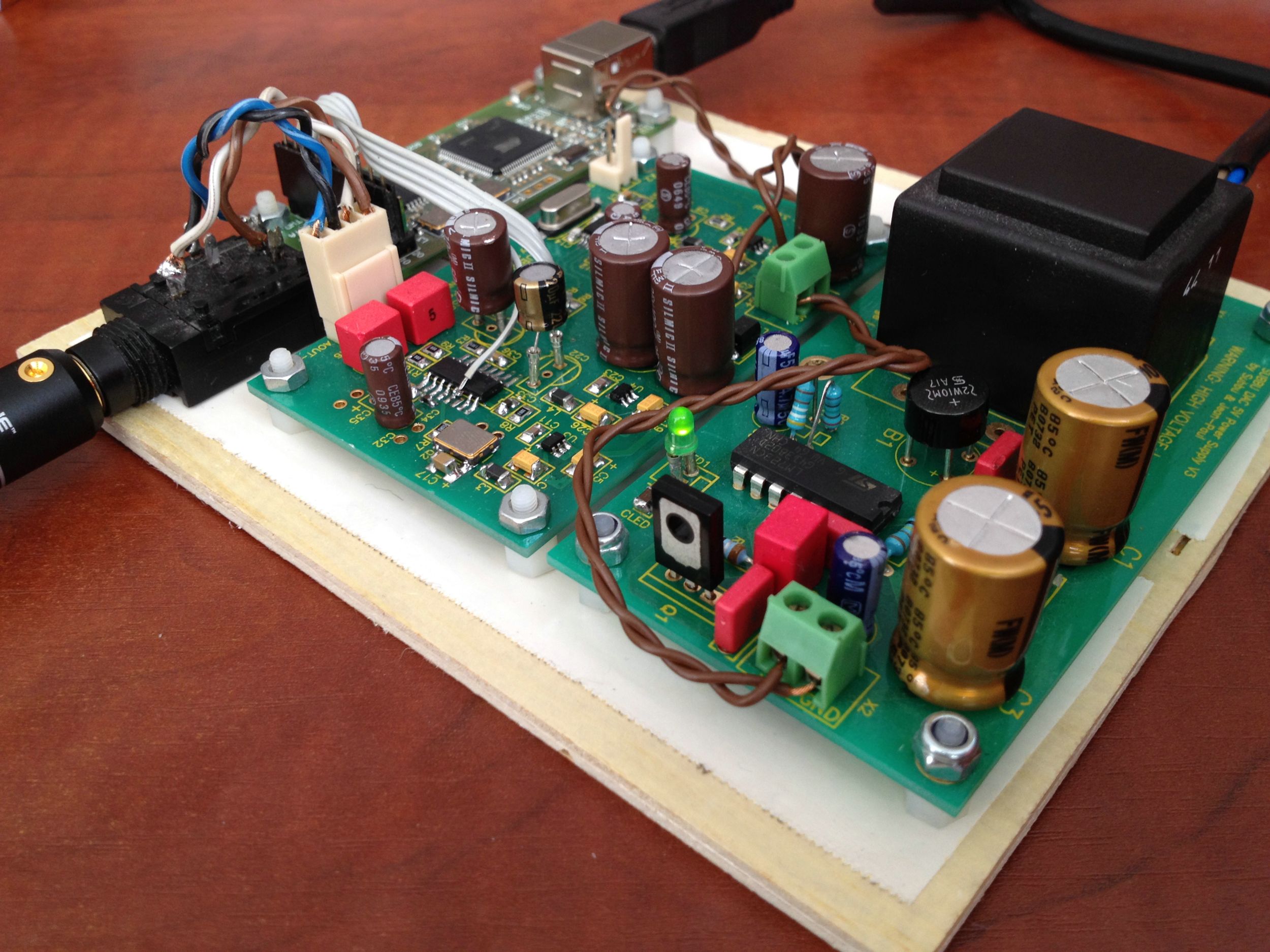

Done! Works perfectly! Compared to Benchmark... tried yesterday in the morning, afternoon and end of the day...well...i've got some very weird feeling 😕
There should be a reason of DACs sounding the same. If you don't hear much difference between the stock output of the SB Touch and the Subbu V3 then there is definitely something not going according the plan. Not wanting to be rude but it could also be your hearing. I have a hard time getting used to the need of wearing glasses while my brain thinks I don't need them. Still I have red eyes and a headache everyday 😉
In short, I hear close to zero difference between Subbu and Benchmark, is something wrong?!
Config:
-some usual office Dell %#$@# laptop
-Denon D2000 with pure silver cable and ViaBlue plug
-unmodified Benchmark (not yet 😀)
-1$ usb cable
-just pure Subbu with no preamp/ headphone amp
-Amanero is fed from Subbu PS
I was already tired from switching the cables between those two, but funny thing is that I'm not sure if there is a difference. If there is, it should be negligible small. For instance, I've compared Denons with Sony MDR1 (bloody expensive BT headset) in the morning and it was like day and night, I didn't even try the BT function as it was a complete waste with a cable 😀
Some time later I went to the dacs and was actually surprised with results. Need to say that a month ago or so I compared Benchmark and Subbu on my bookshelf speakers at home (Burmester amp, t+a cd, ASW speakers) and the difference was very obvious and clearly audible. So I though that it's ok for diy project that cost me 10(!) times less than the Bench. Anyway I understand that the Benchmark is not an ultimate dac and my modified t+a cd sounded better in comparison, but still DAC1 is one on the best moderately priced units available now as far as I know and so are the Denons I assume.
So the question is - where the hell is the difference?!😕 Is the Subbu that good pared with Amanero or perhaps headphones does not require that detailed and hi-endish sound as stereo configs?!
I'll make some more tests in a different manner, perhaps I should try some long term comparisons like listening for several days to one dac and switch then to another.
tested with metal music.
The first problem I can see is the I2S being transferred through the ribbon cable and the return (GND) connection. It is far from optimal and could cause far from optimal signal integrity, especially with the clock. The GND connection should be as close to where the signals join the board as physically possible. Each line would be better transferred as a twisted pair with the GND (return) joining at the closest point. If this is not possible, then the clock as the most critical signal should be in the next wire to the GND ; and that GND connected as near to the clock entry point as possible.

As you can see, Subbu DAC V3 isn't an I2S but a SPDIF only version.
BTW there are no GND return path from I2S lines on this PCB.
For me, the closest Digital GND is Pin14, near clock. (maybe I'm wrong)
Maybe you can point us a better location ?
Many thanks for your articles, takes some times... 🙂
Regards
Phil
C21 looks closest, interestingly the beta layout shown on the first page of this thread had connectors X3-X5 next to the resistors, which would have been perfect as they look like these sort of sockets:
1055688-1 Product Details - TE
so would have been perfect for utilising I2S.
The other option is to drill a little hole for the wire through the board, clean some resist from the GND plane and solder the lead to that.
Ribbon cables such as those that we use to use in their thousands years ago are the worse cables for EMC when used with digital, hence their appearance only in cut price products these days.
